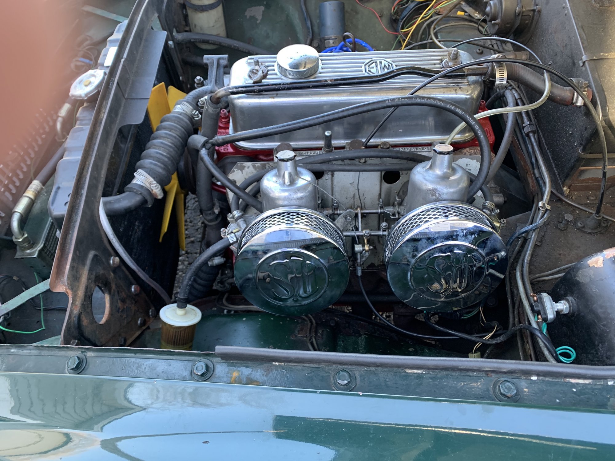

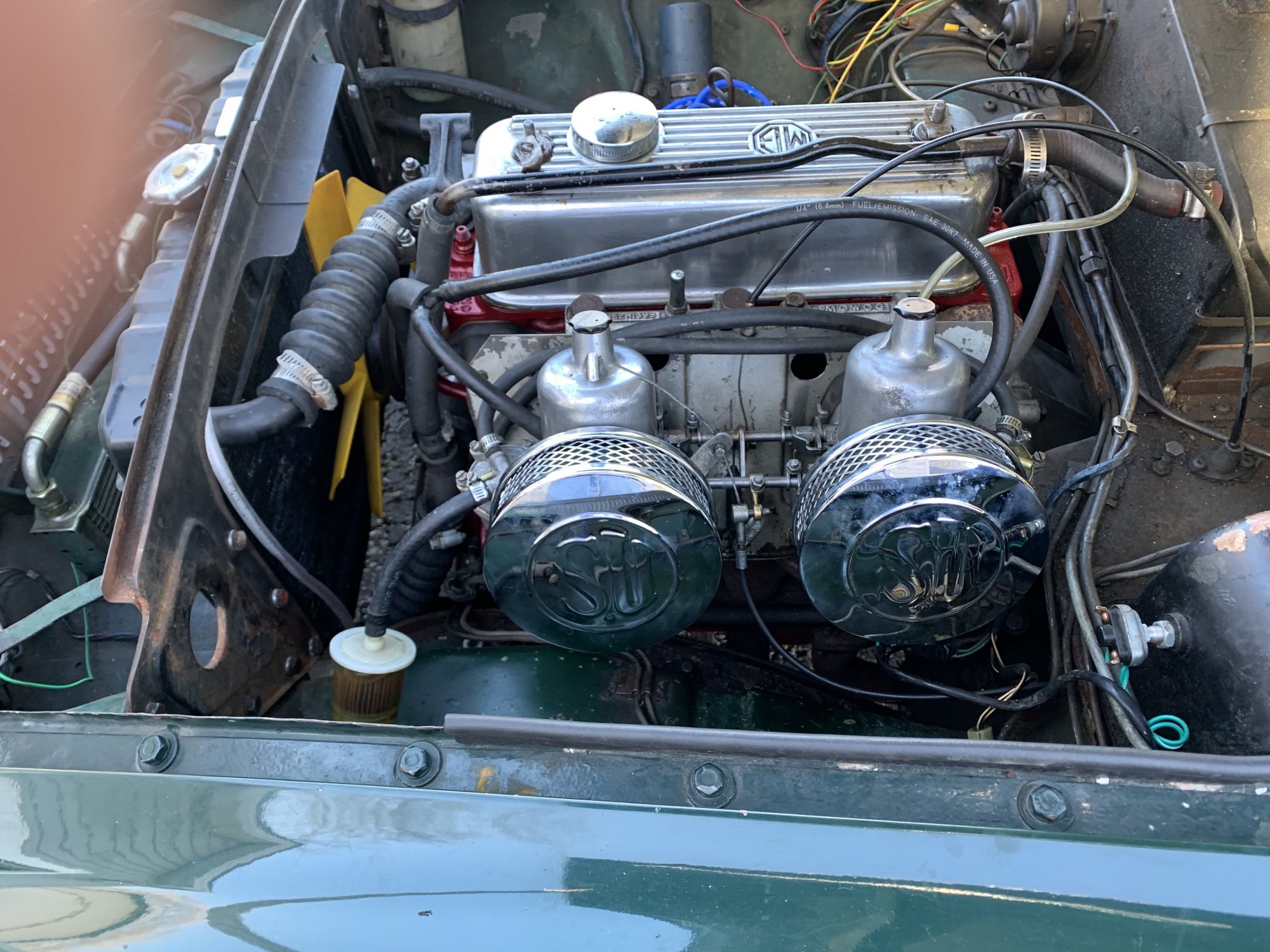

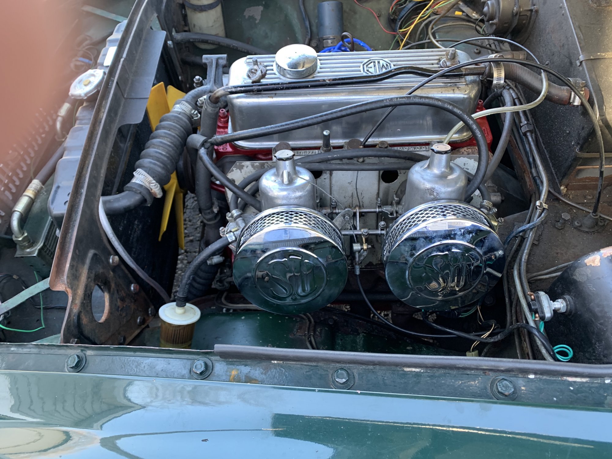

Also, this was another of my prizes yesterday. I'm not a big "bling" guy, but the stock air cleaners are a pain to put on and take off, but fundamentally are a sound design. These reuse the velocity stack from the stock cleaners, which guys with flow benches have tested and not found anything that flows better for street use, so I'm glad they stay.
The only real downside is the filter elements are foam(which are terrible), but I'm sure K&N or someone makes a pancake filter that will fit this housing. For a lot of reasons, I consider K&N and other oiled filters a bad idea for street use(their filtration efficiency is lower than paper until they load up, at which point the claimed flow advantages-which rarely even matter short of WOT-go out the window) but they're better than nothing and K&N does make a million and a half different filter configs.

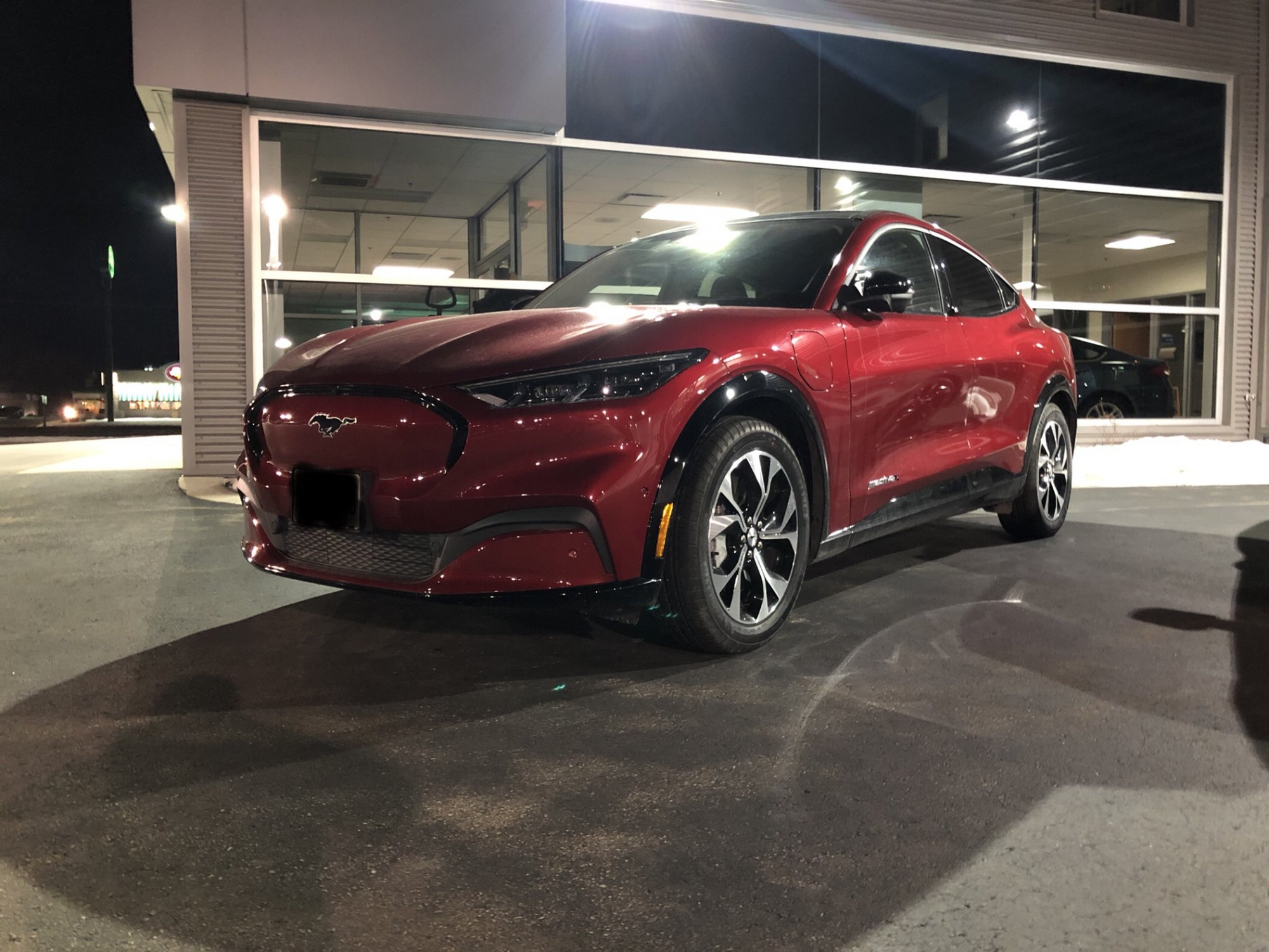

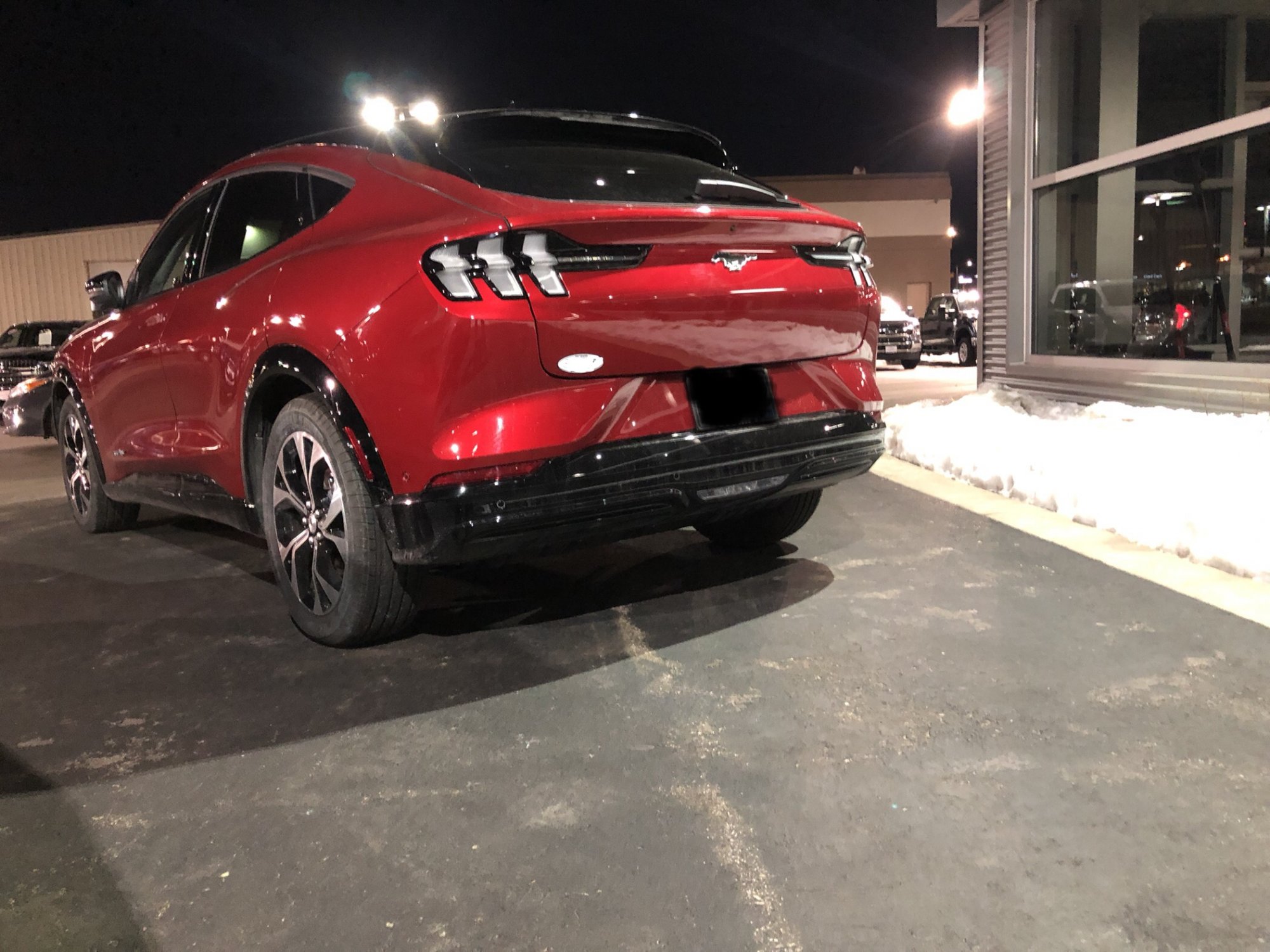

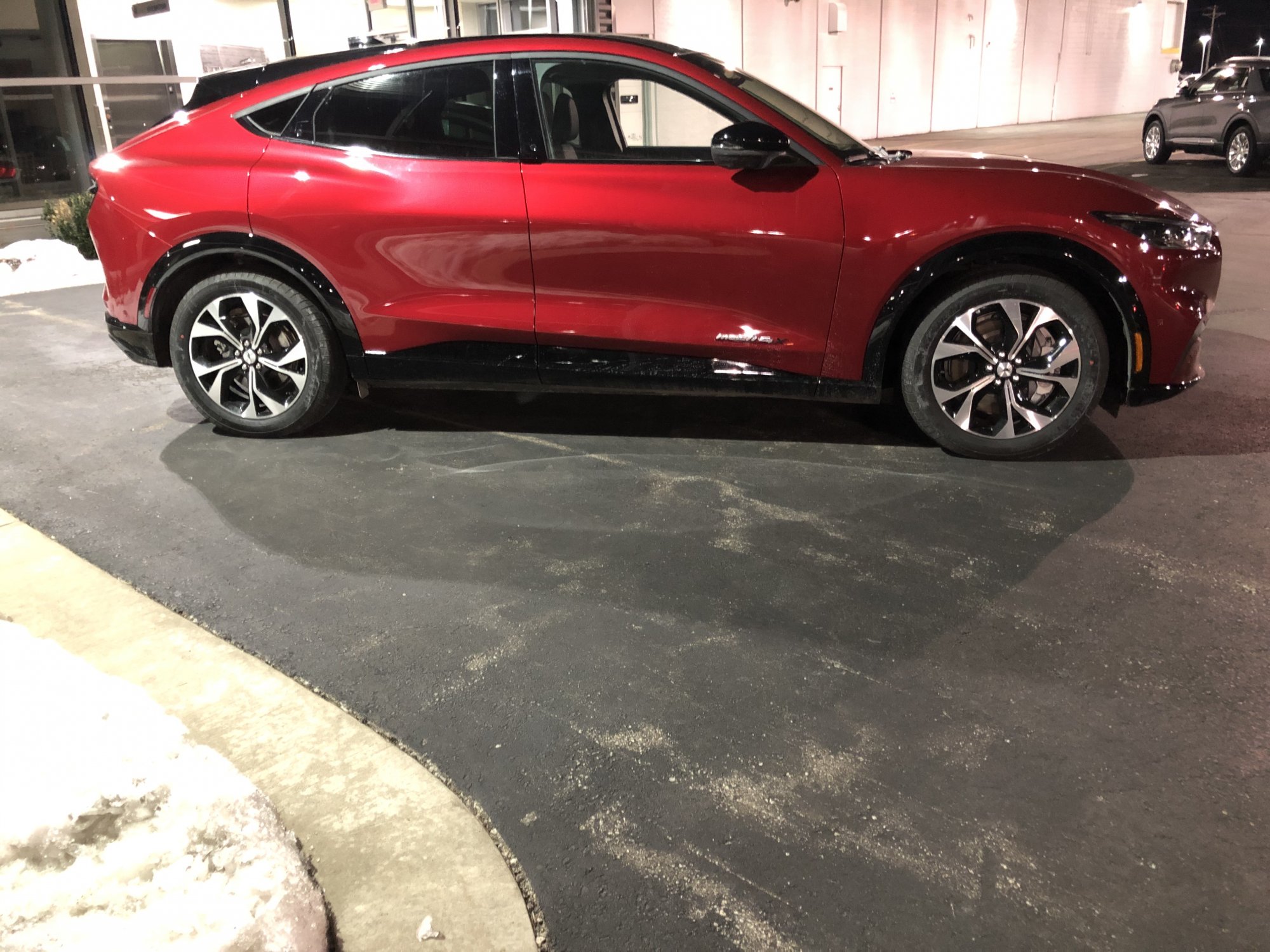

Went and picked up some seafood last night, and sure enough, there was another Mach-E (In ‘carbonized gray’, almost identical to ‘magnet metallic’) in the parking lot. I totally understand why EV’s really don’t have the appeal to a lot of people, but I think over time, you adjust and appreciate the overall aesthetics of what makes it so different from traditional styling.
Anyways, If I were to buy an EV tomorrow, it would be between the Tesla model 3 Perfm and Mach-E Perm strictly based on design elements.
