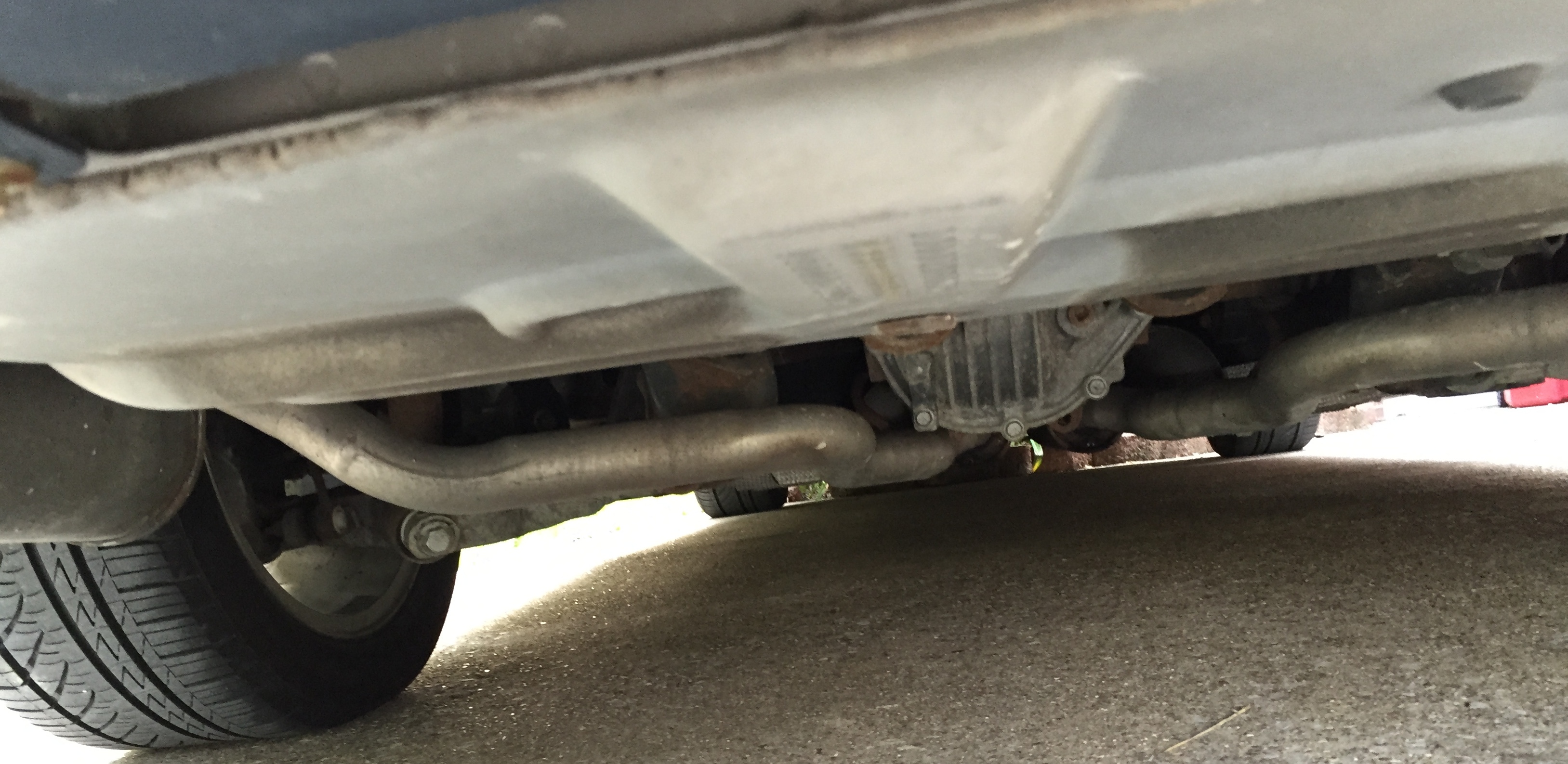

Someone had better tell my SEDAN that...
(yes, this is the Lincoln LS I mentioned in the other thread).
BTW, astute observers will notice the independent rear suspension. This was one of the first rear wheel drive Ford-group products to have this, as opposed to the live axle suspension used on the Mustang(up until a few years ago) and Panther platform(the two major RWD Ford group cars). On a live axle, it's actually fairly common to jack the back of the car by using the differential. This is a no-no with IRS. I've had arguments with tire shops over this :)

Your Lincoln (like most lincoln's i think) are ass-end drive ALL Ass-drive vehicles have diffs.
No currently manufactured Lincoln with the exception of the Navigator is only RWD. All others are FWD or AWD.
Besides that, your statement was that sedans don't have differentials...
Yes. In the general sense that Sedans are FWD RWD and AWD sedans aren't commonsake in the modern days
