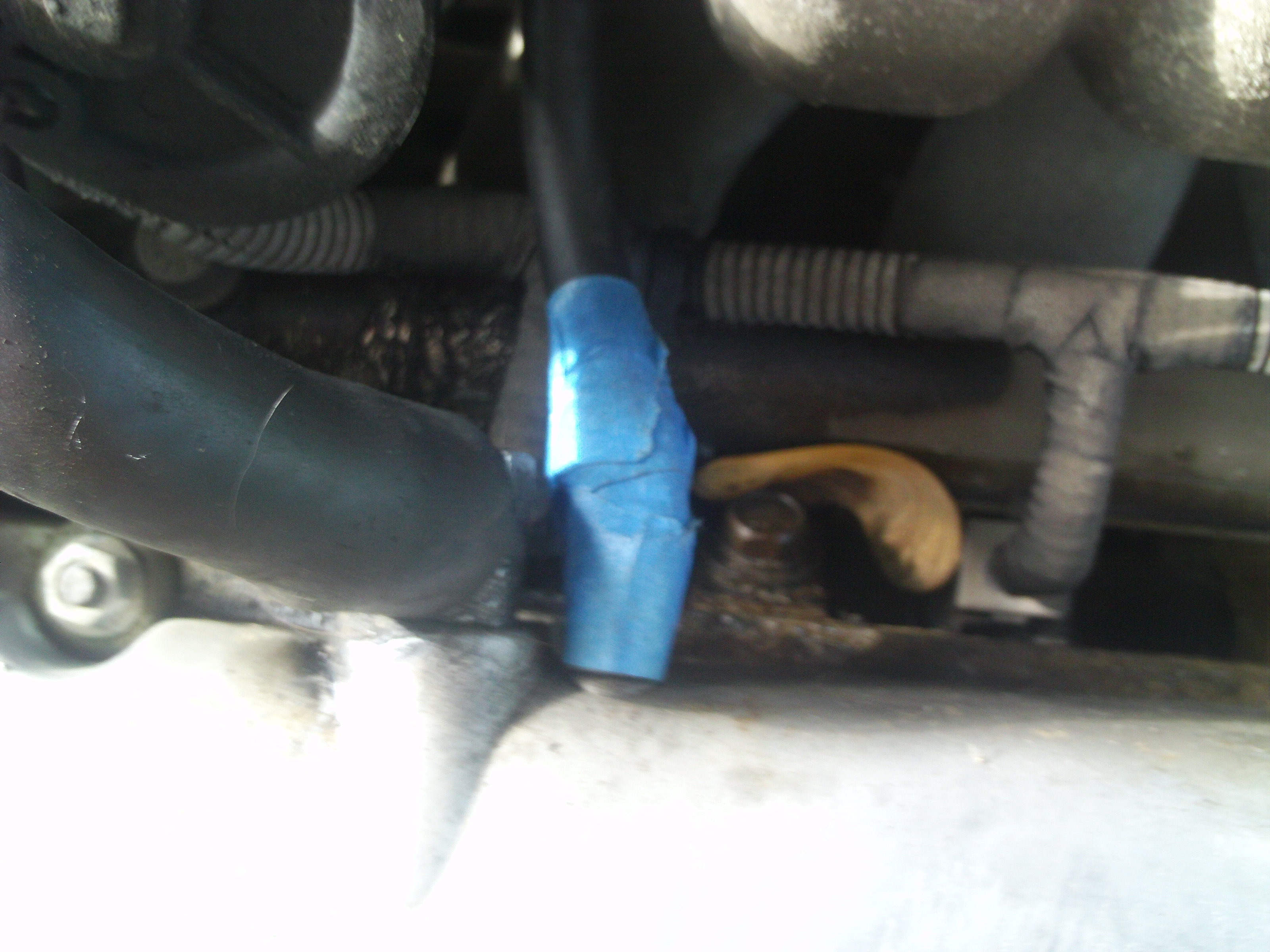

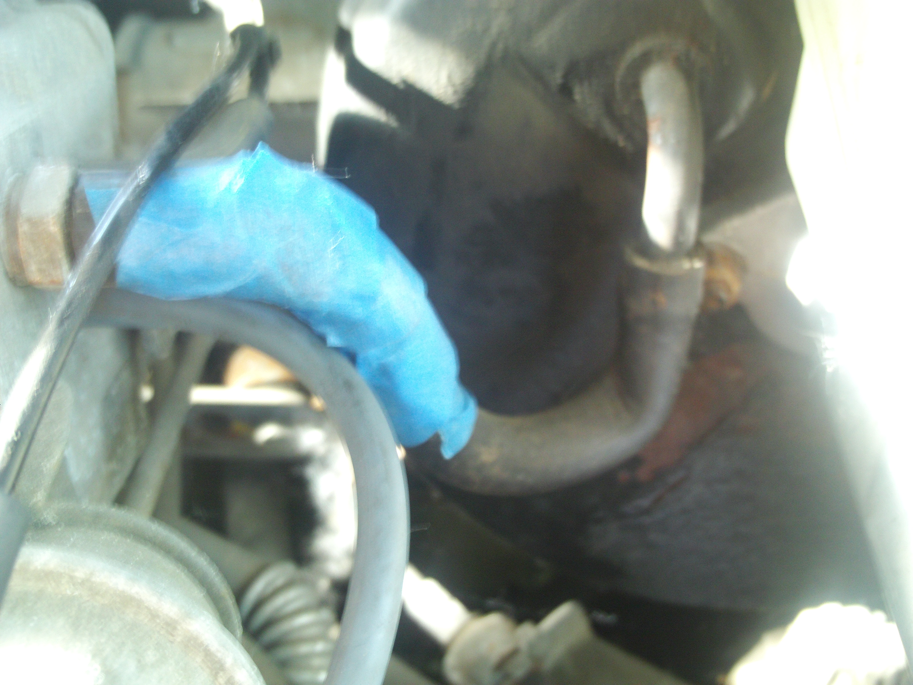

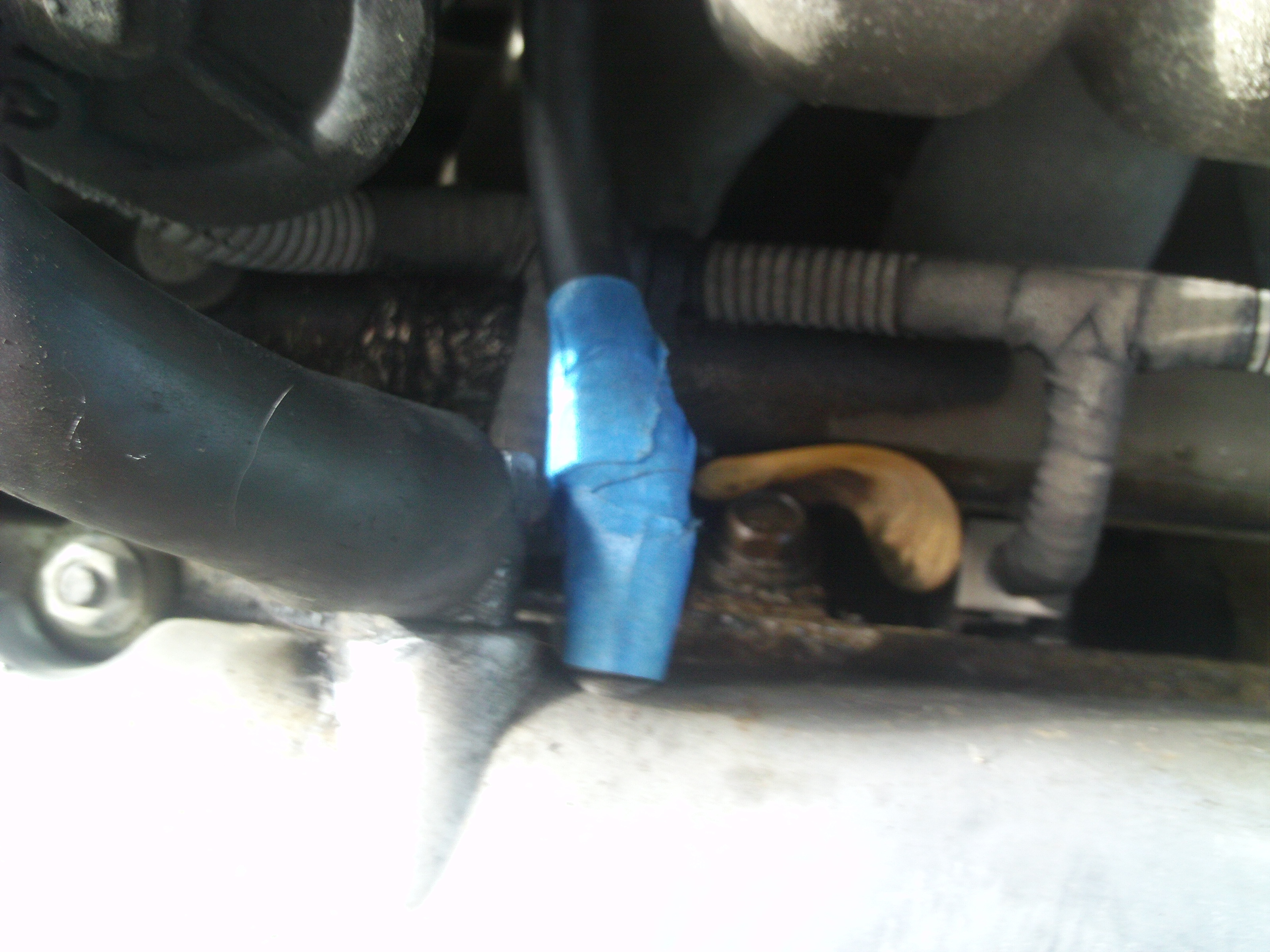

maybe you guys can help me out? I need to get a new vacuum hose, But where do i get one? it is a SMALL hose with the inner diameter close to the size of a #2 pencil. Here is a pic (Tape covers a small hole) I asked the shop to replace this hose while doing the brake work but they didn't (I assume because they didn't have one small enough.)
This hose goes between the TB and the Valve cover any idea what purpose it serves?

maybe you guys can help me out? I need to get a new vacuum hose, But where do i get one? it is a SMALL hose with the inner diameter close to the size of a #2 pencil. Here is a pic (Tape covers a small hole) I asked the shop to replace this hose while doing the brake work but they didn't (I assume because they didn't have one small enough.)View attachment 568048This hose goes between the TB and the Valve cover any idea what purpose it serves?

Any auto parts store should have vacuum tubing. You just tell them what diameter you need. Electrical tape should work better than masking tape.
It's for crank case ventilation - combustion blow can cause unwanted air (and positive pressure) under the valve cover, so it goes through a check valve, and is then recirculated (back in through the TB). As long as the check valve is working, this is mostly just an emissions issue. In fact, some cars use a setup with an oil catch can because the blow by has enough oil to cause the TB (and air metering electronics) to get gunked up. You can also just stick a little breather on the VC side and plug the TB inlet (though that technically violates emissions laws).

I tried NAPA AutoParts and AutoZone, neither store stocks vacuum hoses, I took the hose to them and they said they had nothing like that.

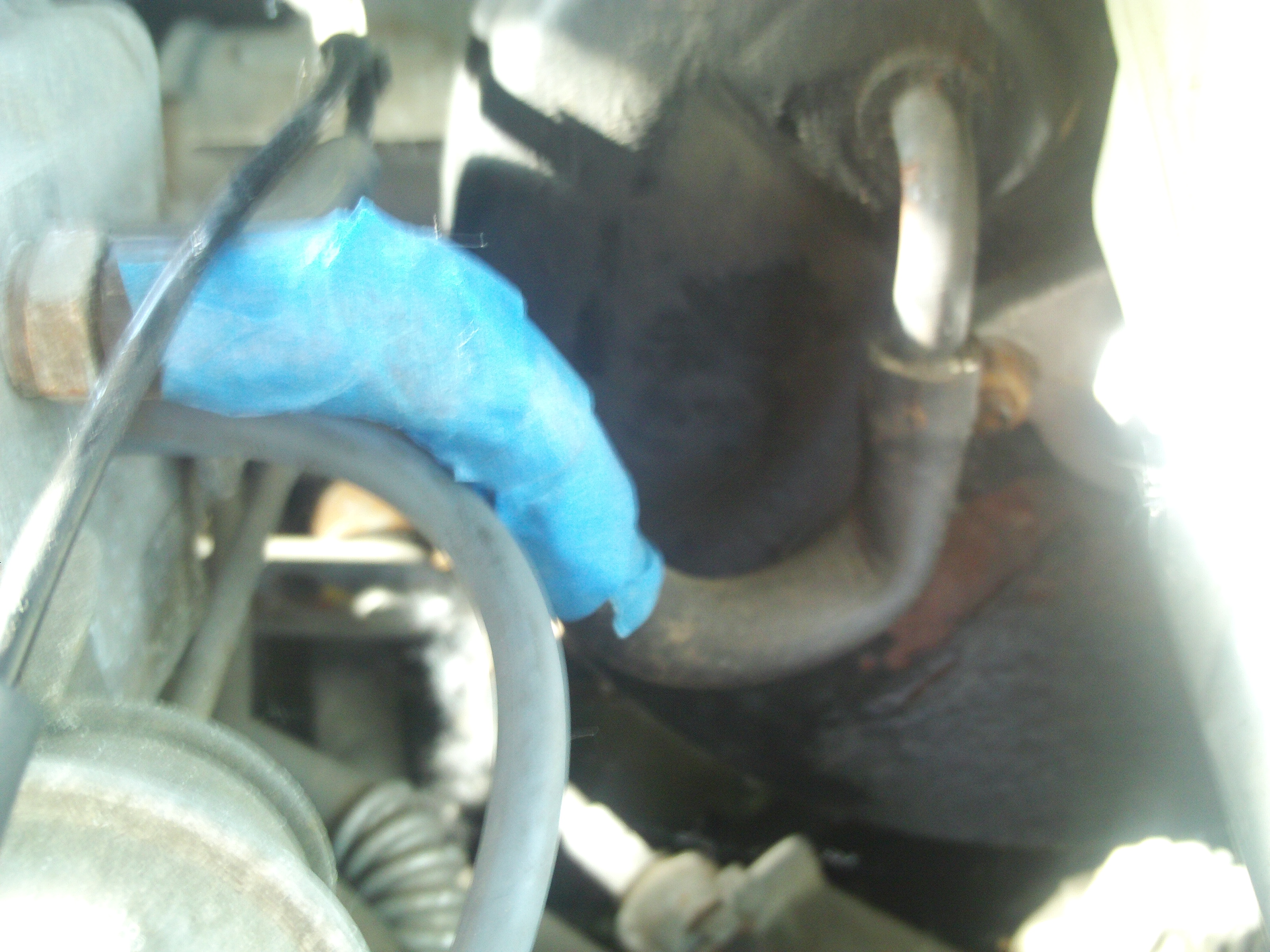

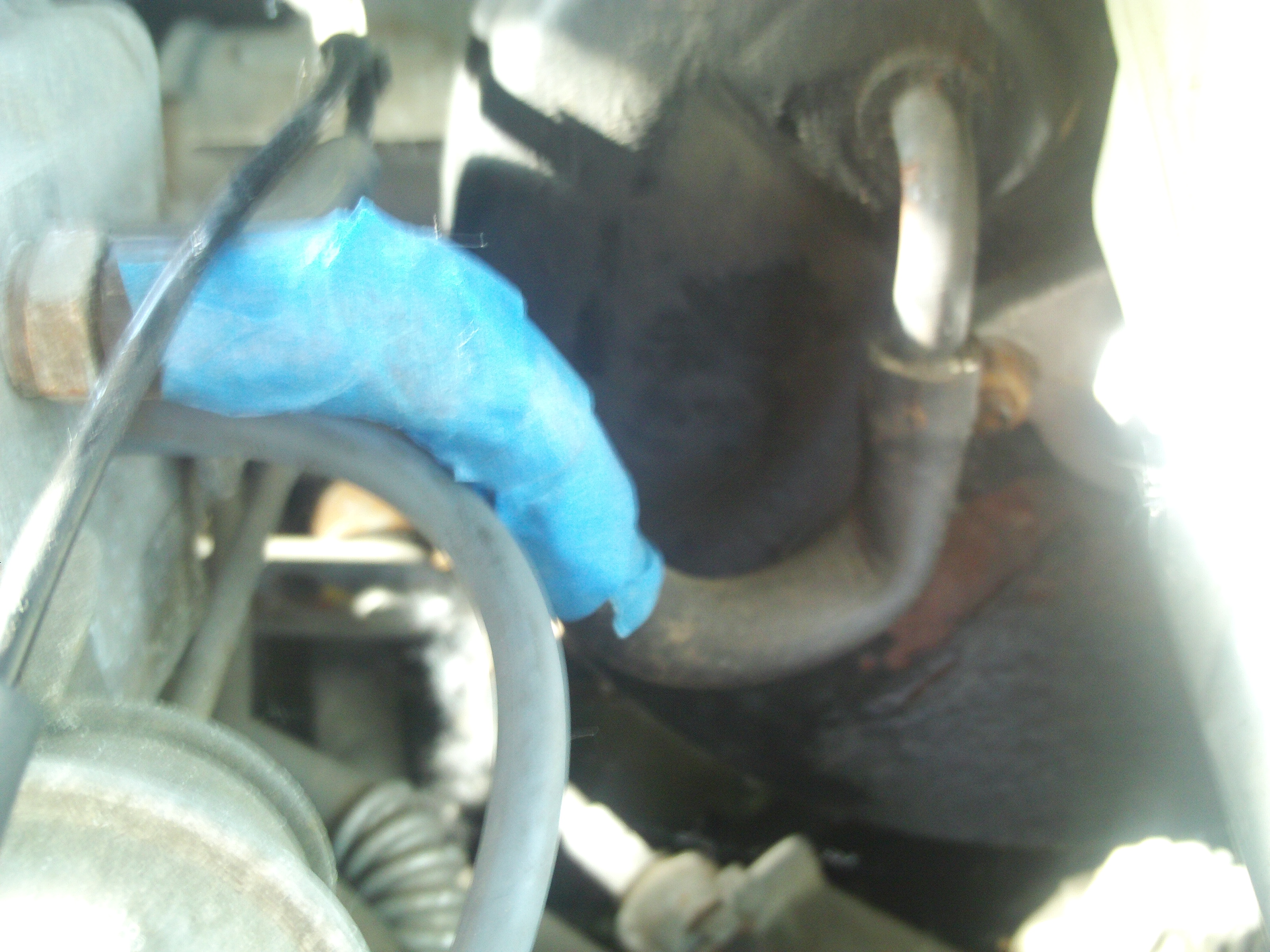

The hose to the left is the PCV hose,Here is a picture of the PCV hose:
As you can see the above hose is directly to the right. This (in this picture) hose was replaced 3 years ago when the brakes blew out the 1st time. AutoZone and NAPA also didn't have anything for this either. There is also this hose:
This one ALSO had a hole in it I replaced it myself 3 years ago using a hose i had on hand. (It was a drain hose used in junction with the drain tube on our clothes washer. I had to cut this hose last year (at the top) as it got another hole in it. It is of much bigger diameter but it does work fine. Here is what was (left) of the original hose:
Is this a EGR hose?
Is this a EGR hose?
It's hard to tell what your talking about, as I see a number of hoses and tubes. Can you label them.
If they're large in diameter or shaped in a specific fashion, they're probably a specific part. Try your GM/Chevy dealer as your engine is similar to other GM motors. If not, I'm sure you can order the part.

The hose in the center of the picture
