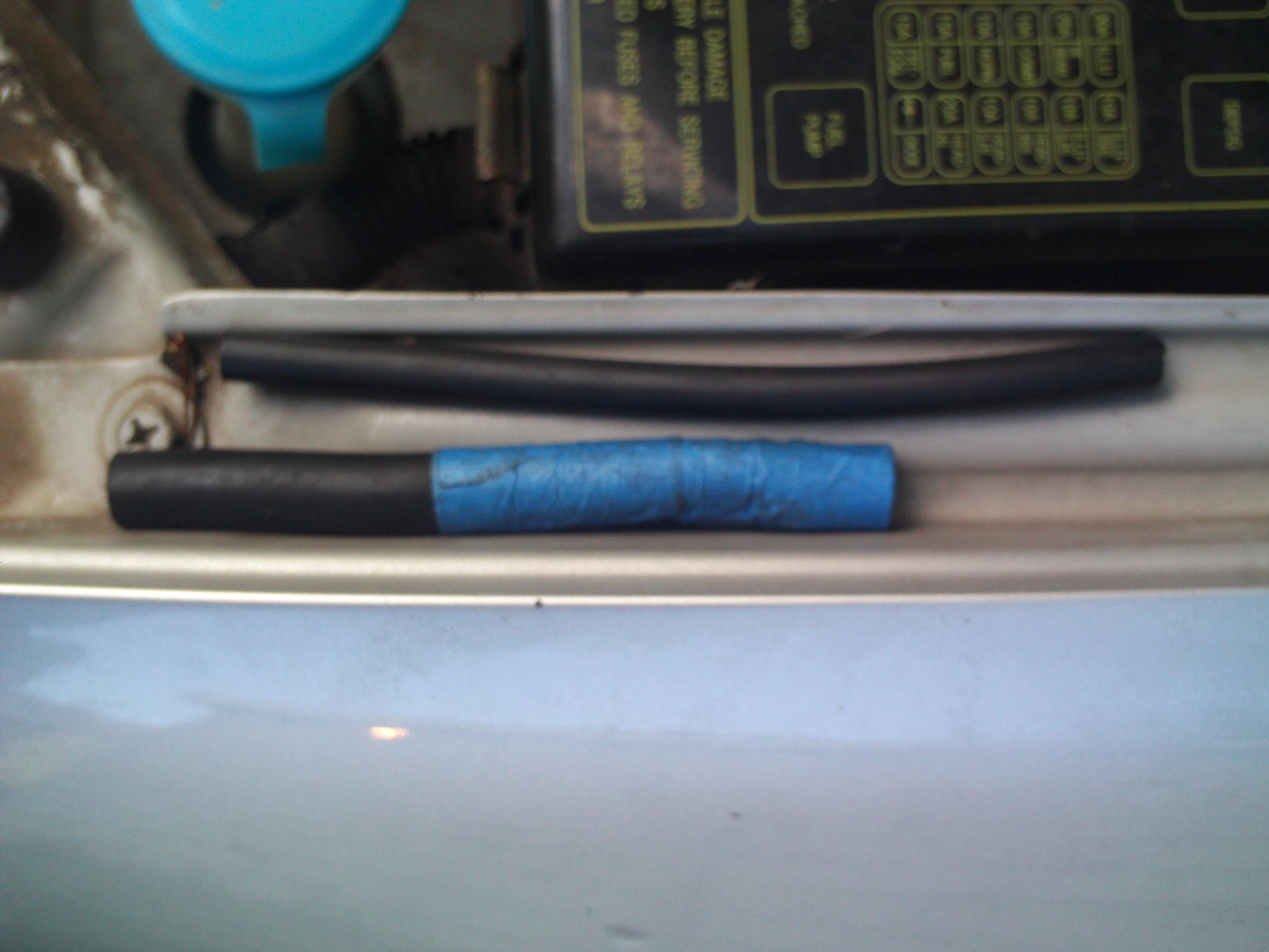

Thanks for the tip. I'll first try the hardware store (as that is closer than the nearest auto part store) and if they have nothing i will goto a auto part store. 3 hoses i pictured all got hole from the leaking valve cover. Oil hit rubber. Other than the power brake booster vacuum hose being replaced for prevenitive maintenance (last think I want it that hose to leak an losing power to my brakes), which was dry rotted, the other vacuum lines (that are visable) look to be perfectly fine. I had the shop replace the power brake vacuum hose because i could not get the damn hose off. THIS hose fits so loosely that i think i should get either a hair smaller inner diameter or tiny hose clamps.
EDIT: Made my own solution, here is pictures.

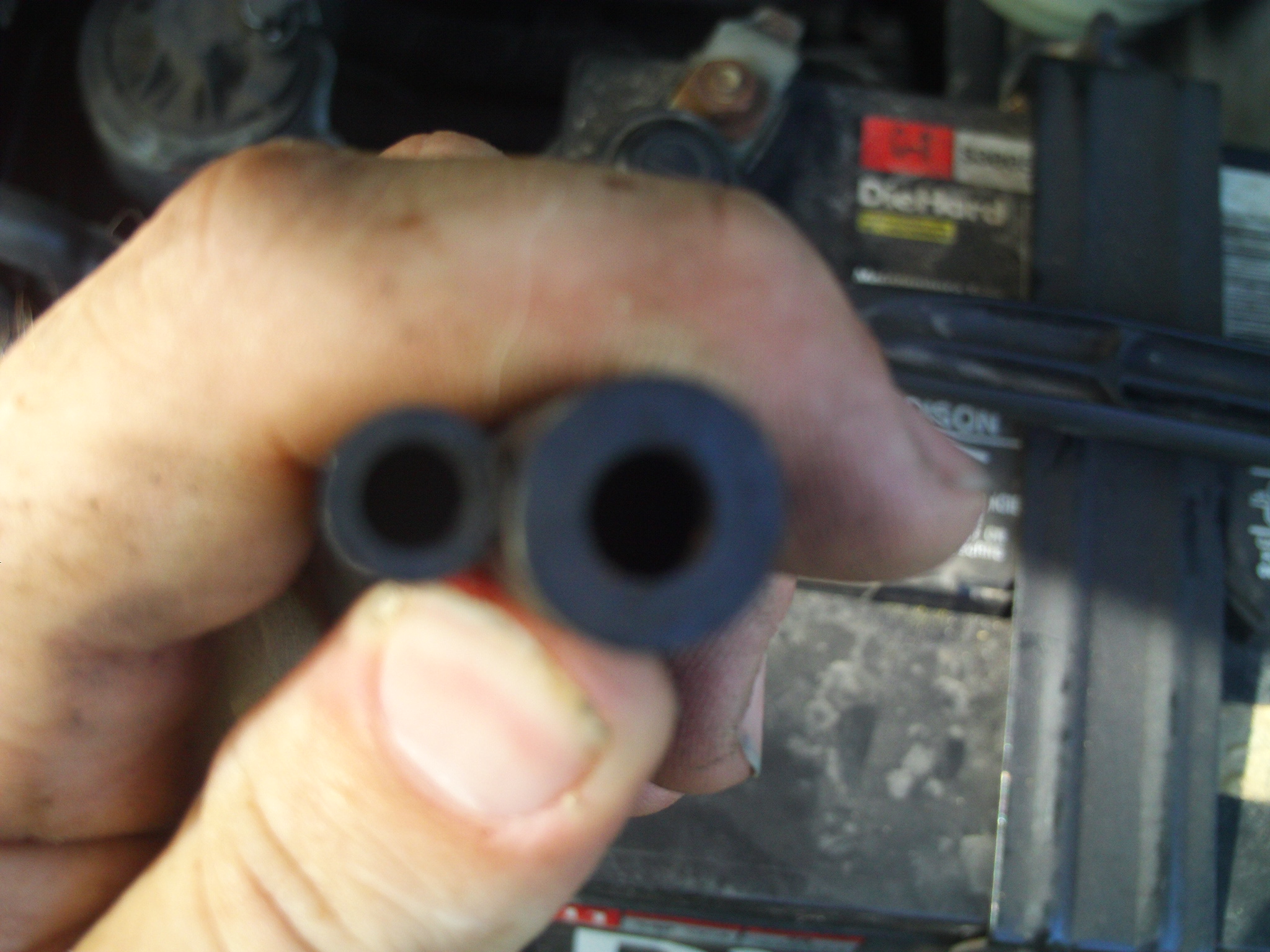

This is my tranny vent cap/tube. This tube was the exact diameter needed
Left: transmission vent tube, Right: Vacuum hose.
Cut with excess length in case it gets a hole later.

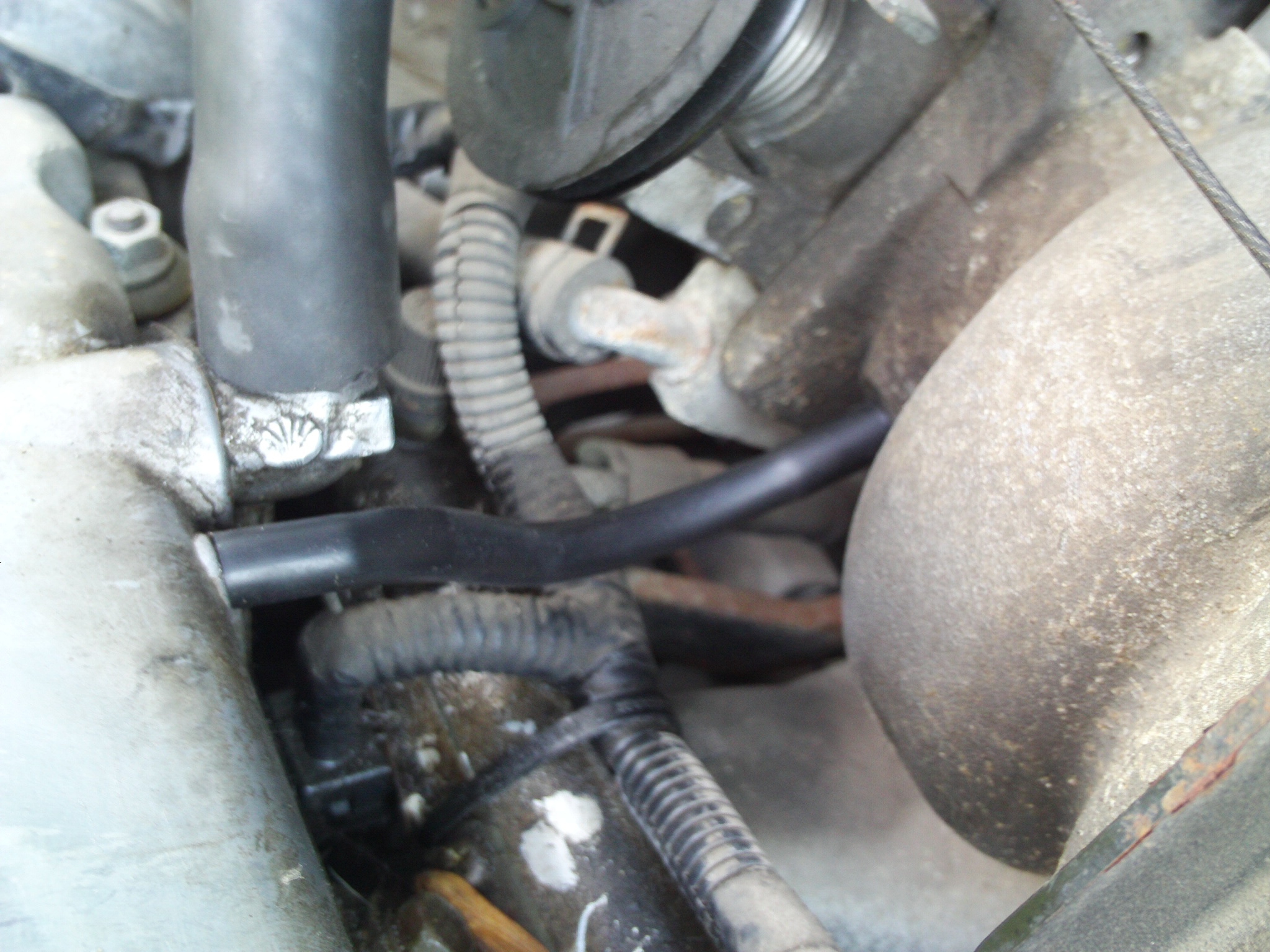

Installed!

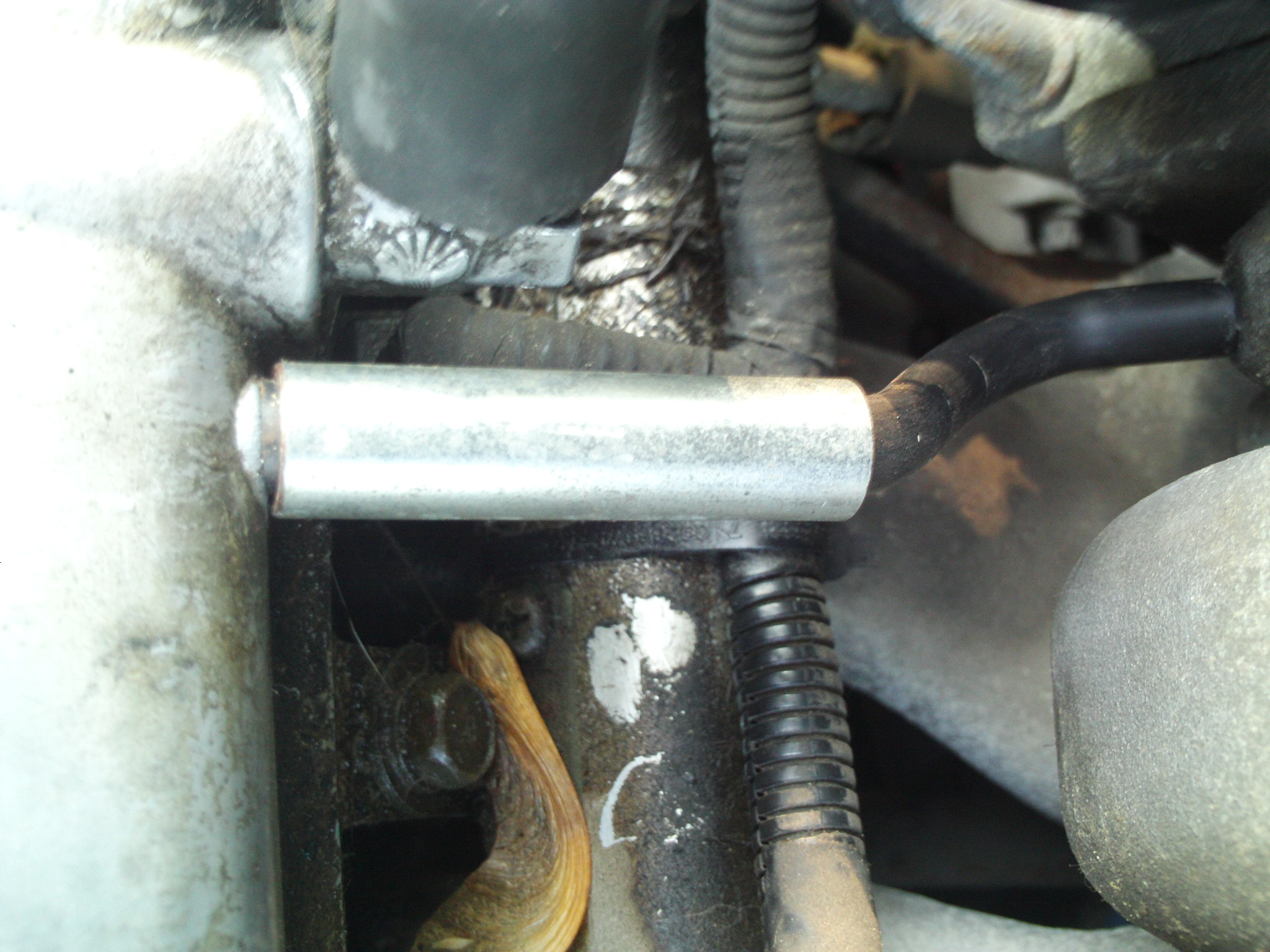

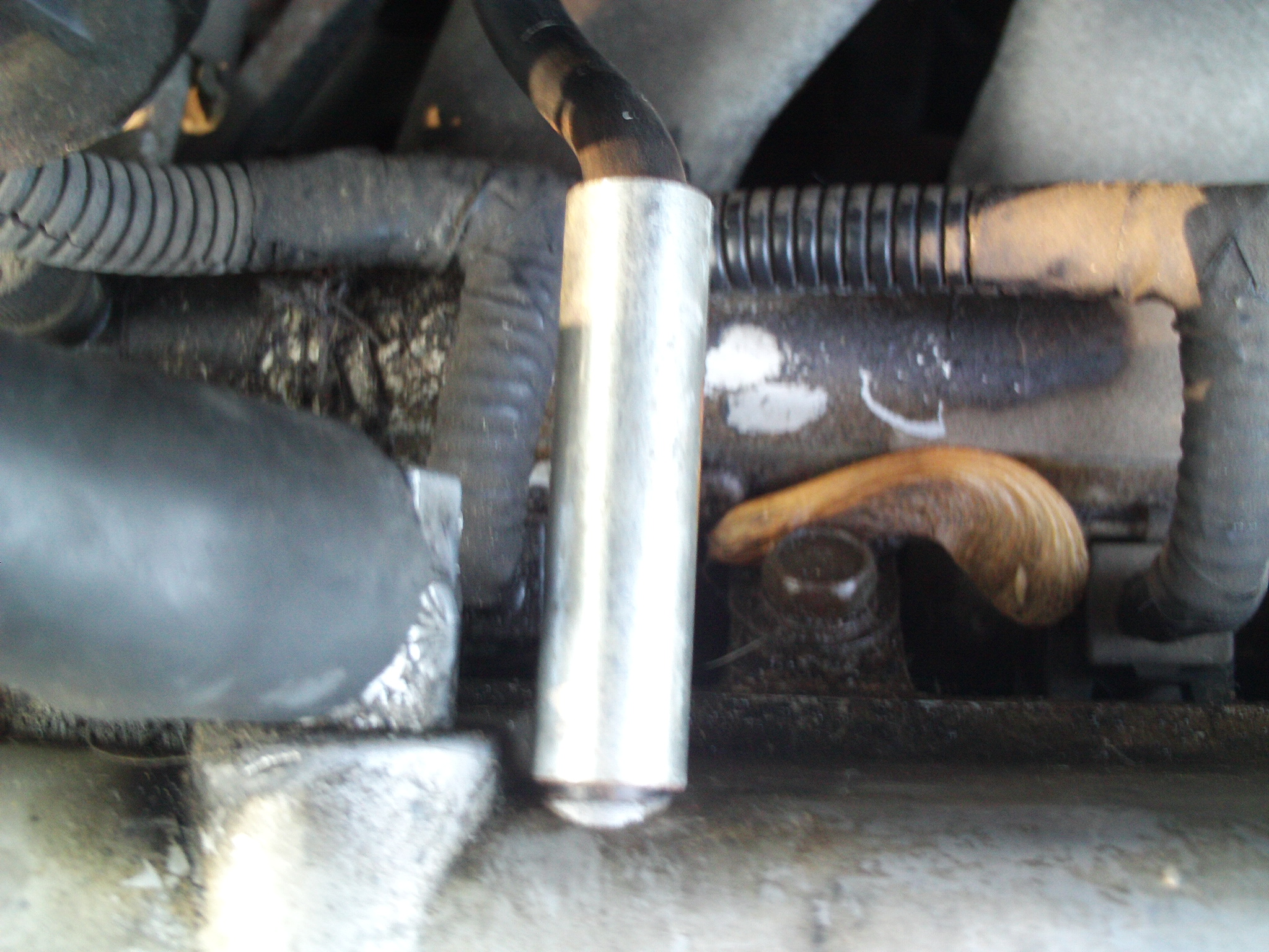

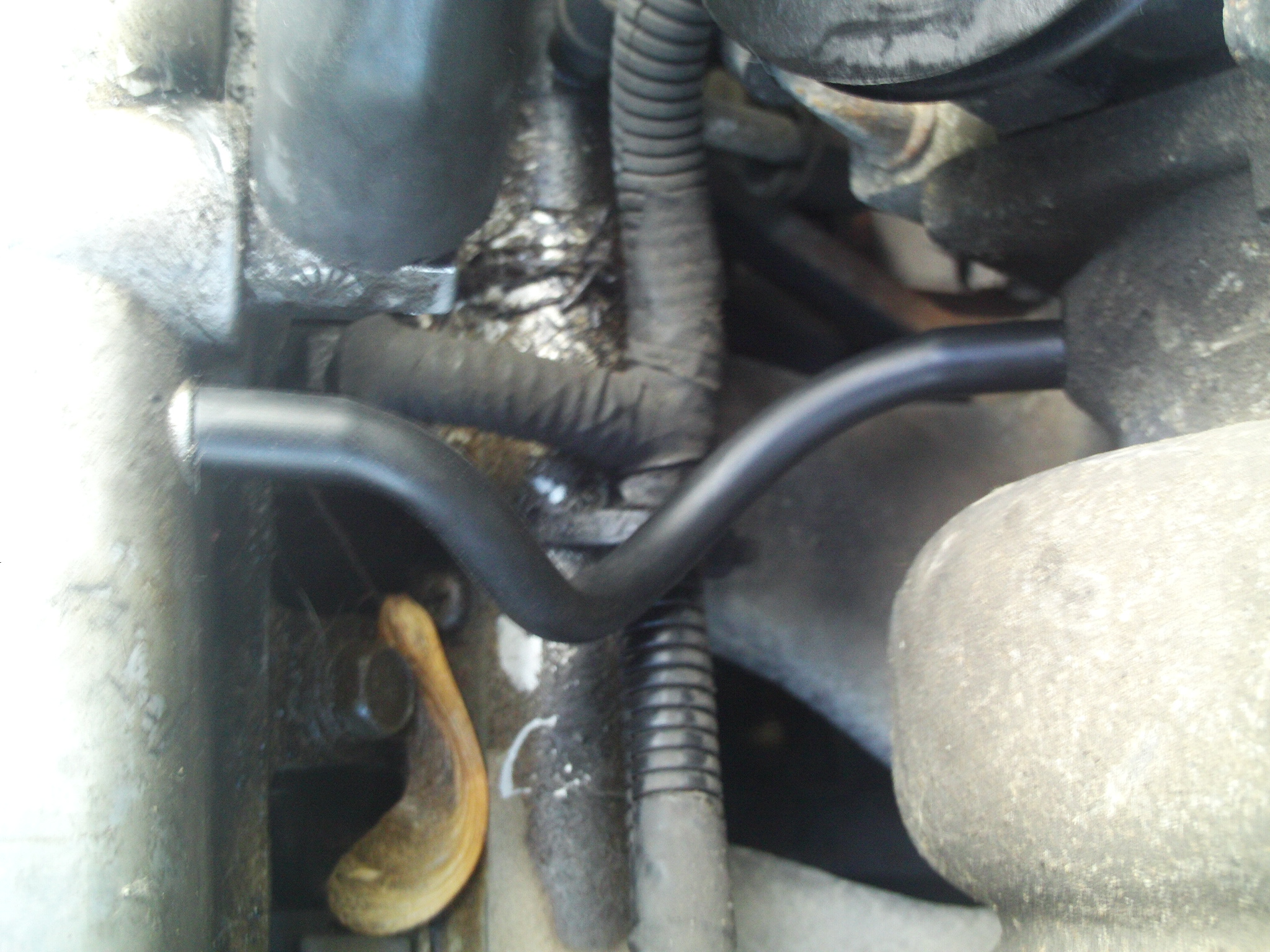

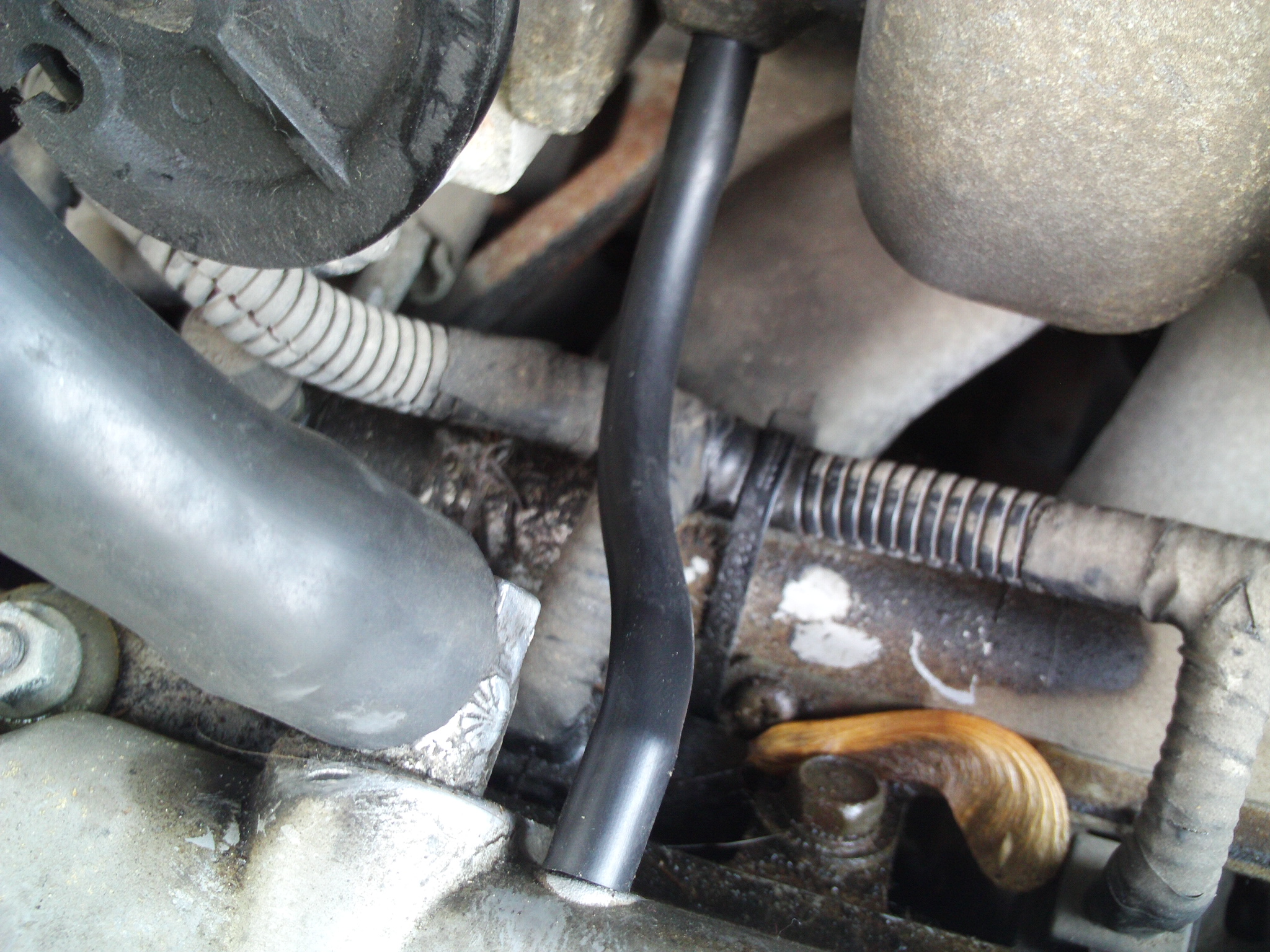

Well, After replacing the vacuum (vent?) hose. I noticed the extra length was a downfall, as when this hose heated up it kinked due to it's thin wall. So I cut about 1" off, here is the results:
For extra stability I added this to the hose:
not sure what this is... I think it's a spacer. The hose fits right through it and Outter Diameter of this spacer matches that of the original hose. I may get a hose clamp just so it stays in place.

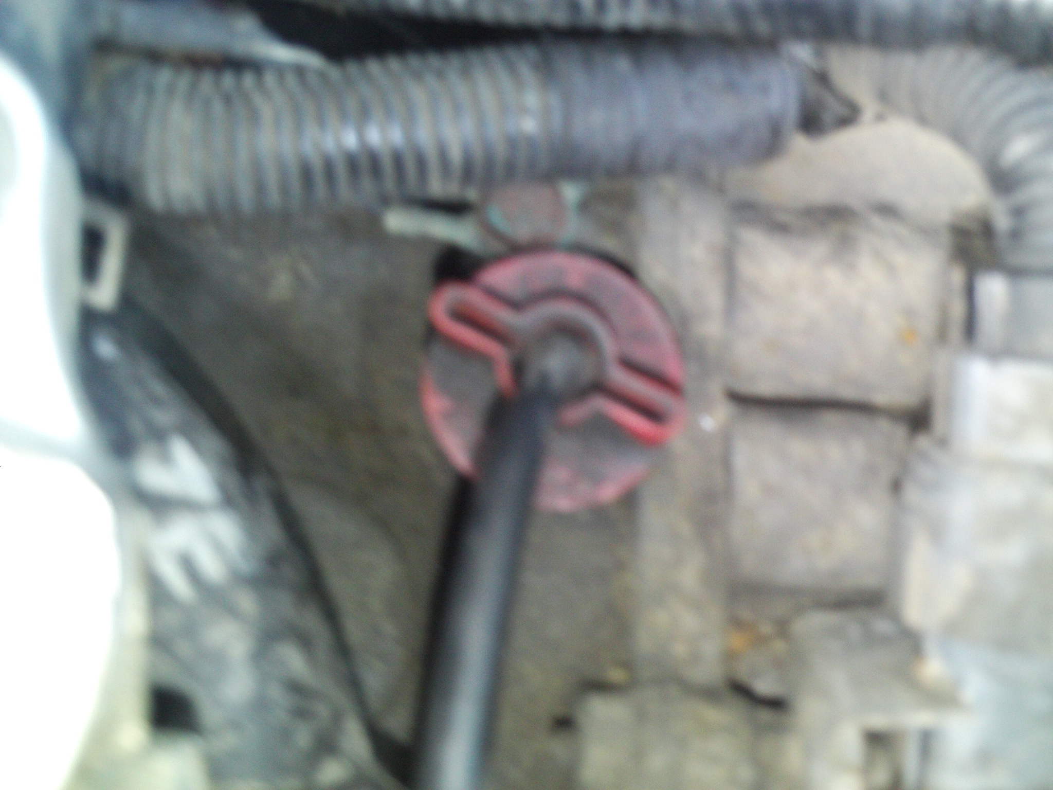

And just so it is stated, I DID NOT remove the tranny vent tube it's right here:

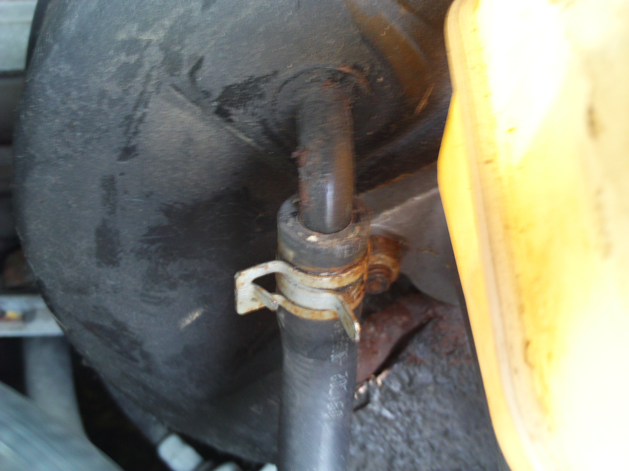

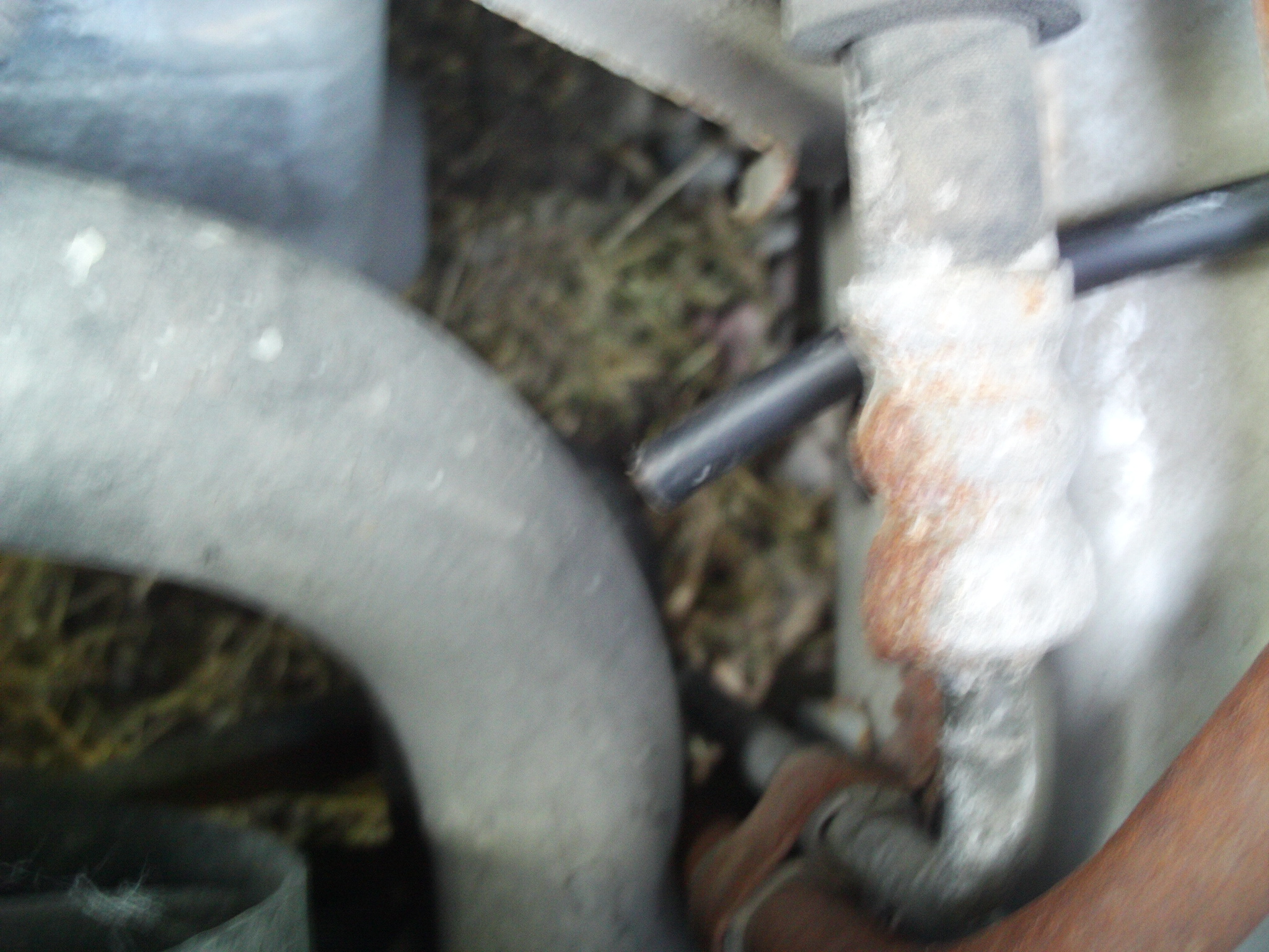

AND after the shop replace the vacuum hose for the brake booster, I noticed one thing I never seen on a vacuum line before, a hose clamp:
