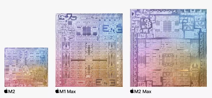

Short No, what Apple could do is repurpose m2 max or pro with defective CPU cores or other defects that don't prevent at least a usable 1:16 CPU: GPU ratio and PCIe bus access, load on these chips an firmware to convert it into GPU peripheral without CPU capabilities but capable to tether on main CPU as an GPU/tpu accelerator.

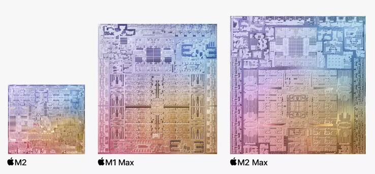

note the wider-taller M2 Max is relative M1 Max (the photo dont include its UltraFusion edge interconnect, likely dual (top and bottom) for a 4P M2 Extreme, so the M2 Max Chip likely wont fit in M2 Ultra 2P inside the Studio chasis. likely an M2 pro - Ultra (2P) should be indicated to fit the same constrained area in the Mac Studio M2 logic board,
Hmmm…I would have thought they would have limited the Ultra-s to 6 memory blocks instead of 8…so 600 GBs bandwidth to give the full fat ultra some breathing room 🤔
I really appreciate the possibility of ultra fusion at both ends, as it’s a lot more logical than adding it to one of the sides since that wouldn’t work over symmetry. So another question 🙋‍♂️ would it be possible to close the open ultra fusion ends at the top of the M2 Ultra-p with M2 Pro chips…? Seems like it would work but it would just be for showing off.
