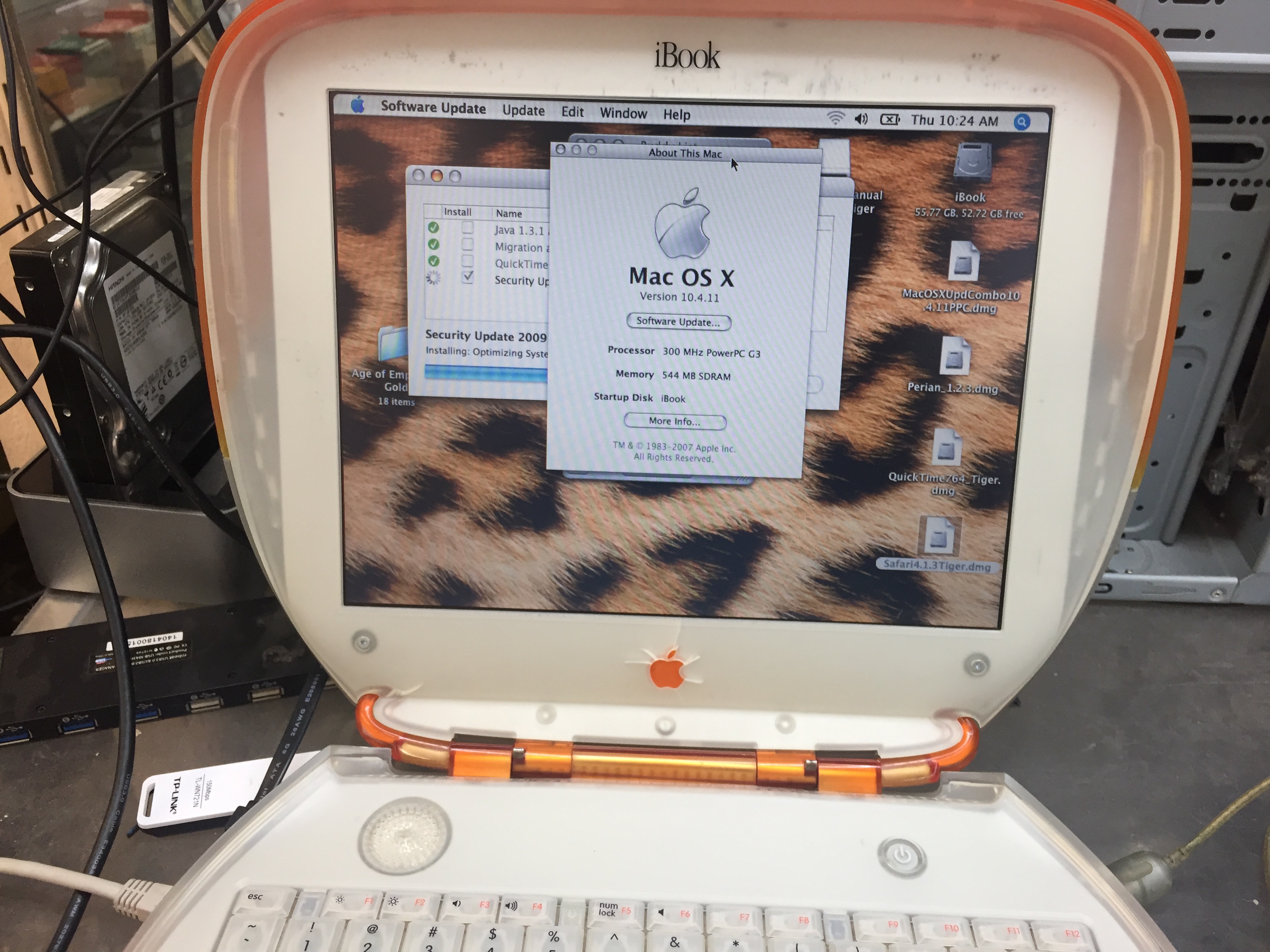

without hijacking the thread too much i want to ask, how will you install tiger? with xpostfacto? i tried using it and mine says "xpostfacto does not work with this model: powerbook2,1"
GetToDaChopa
macrumors member
Nov 20, 2016
33
32
so i stayed up till 3am and got my g3 running Tiger. Had to modify the tiger install cd and replace the failing cd drive with a dvd drive from an old windows laptop (not a perfect fit). What a pain that was. as it kept failing to install and before i got the modified tiger disk going i had to keep typing in open firmware code maybe 20 times over every time it failed to install.
How did you go with yours?

dont give up yet! it took me 3 days and maybe 50 burned CDs to get it going. i can help! once you get a modified CD of tiger going every hing else is easy. As long as you cd drive isn't failing like mine.
you can do it!
