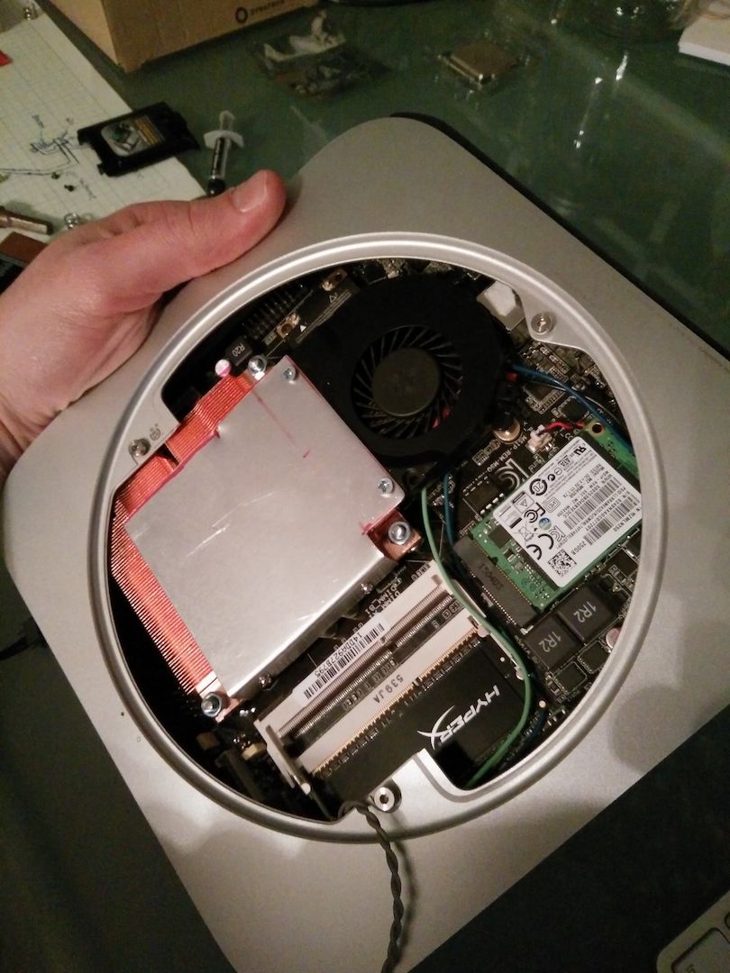

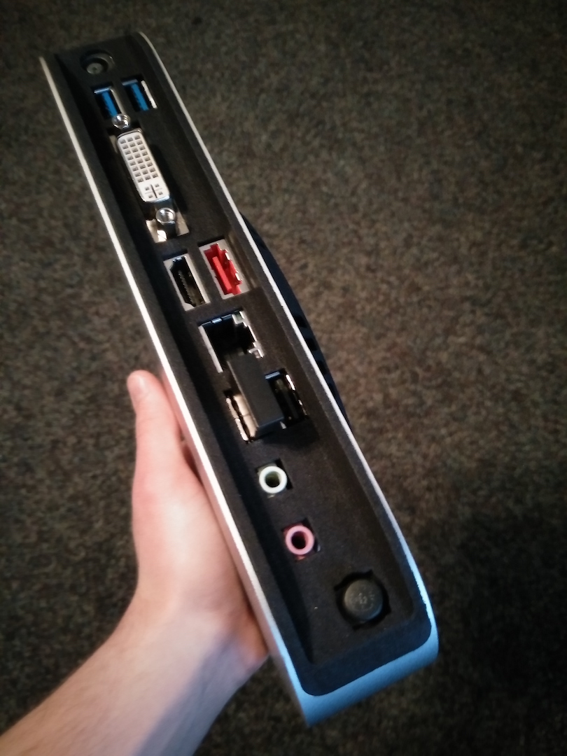

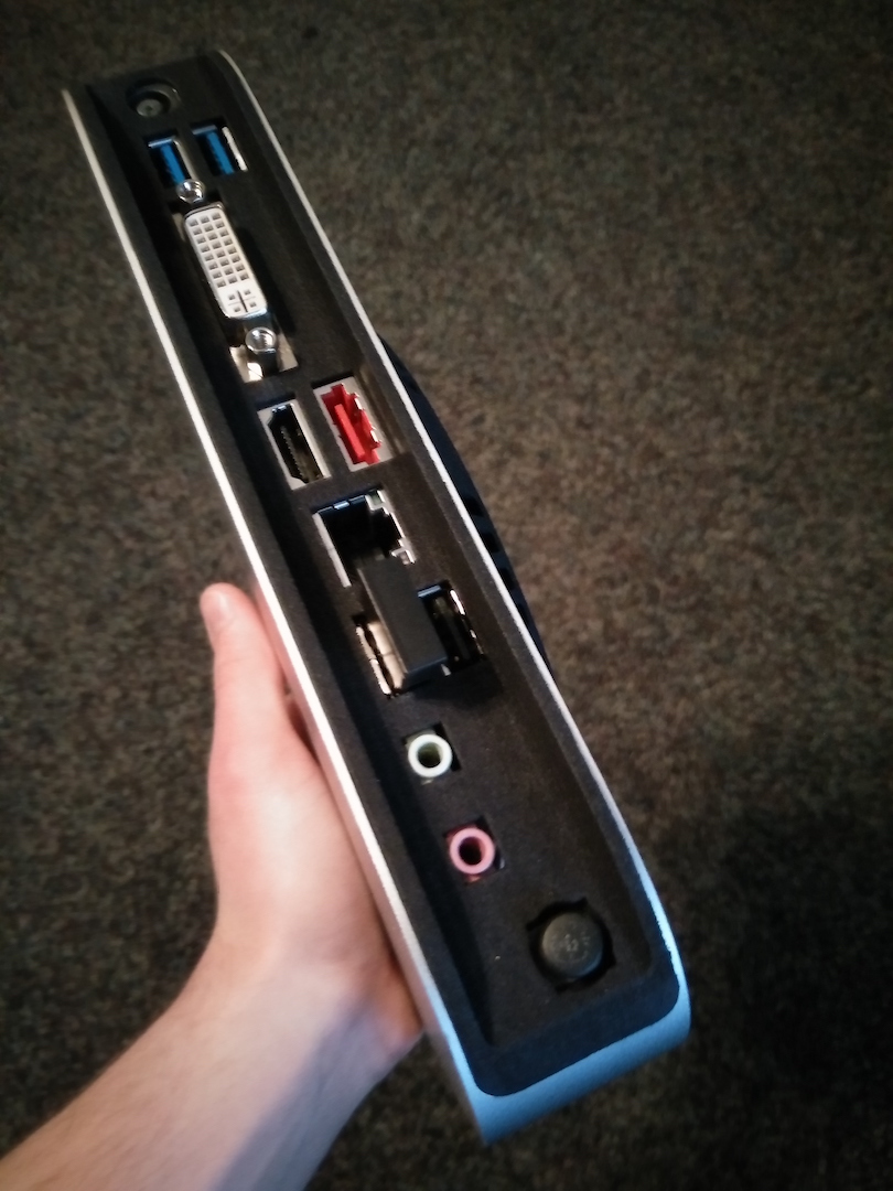

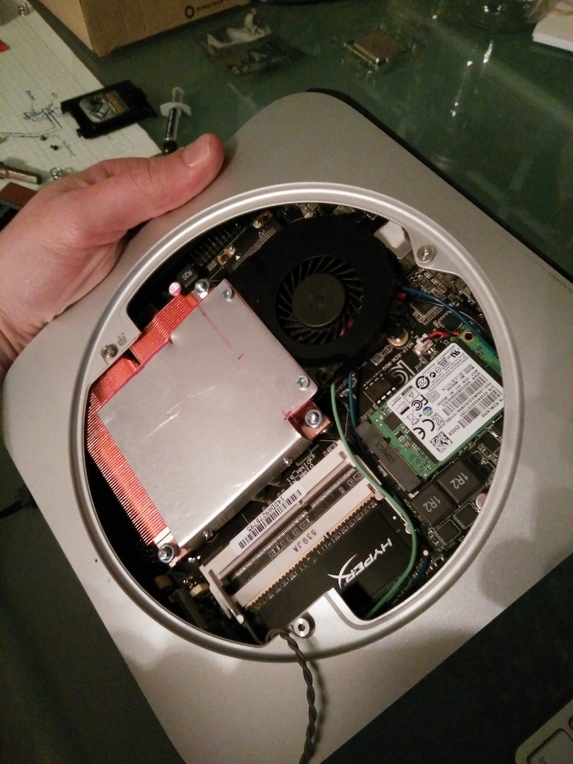

Figured I would post up as well. This is my Mac Mini hackintosh.
Mod is mostly done with the exception of cooling and wifi.
Cooling: Replacing the Macbook Pro fan with the 12v mac mini fan and repurposing the MBP fan as a secondary case fan
Wifi: Attempting to internalize the wifi antennas
Specs:
Asus H81T/CSM thin mini itx
Haswell Core i5 4570T
12GB ddr3 1600
250GB evo 850 SSD
