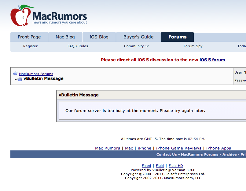

It's not just apple, seems like MacRumors' servers are overloaded too :D
