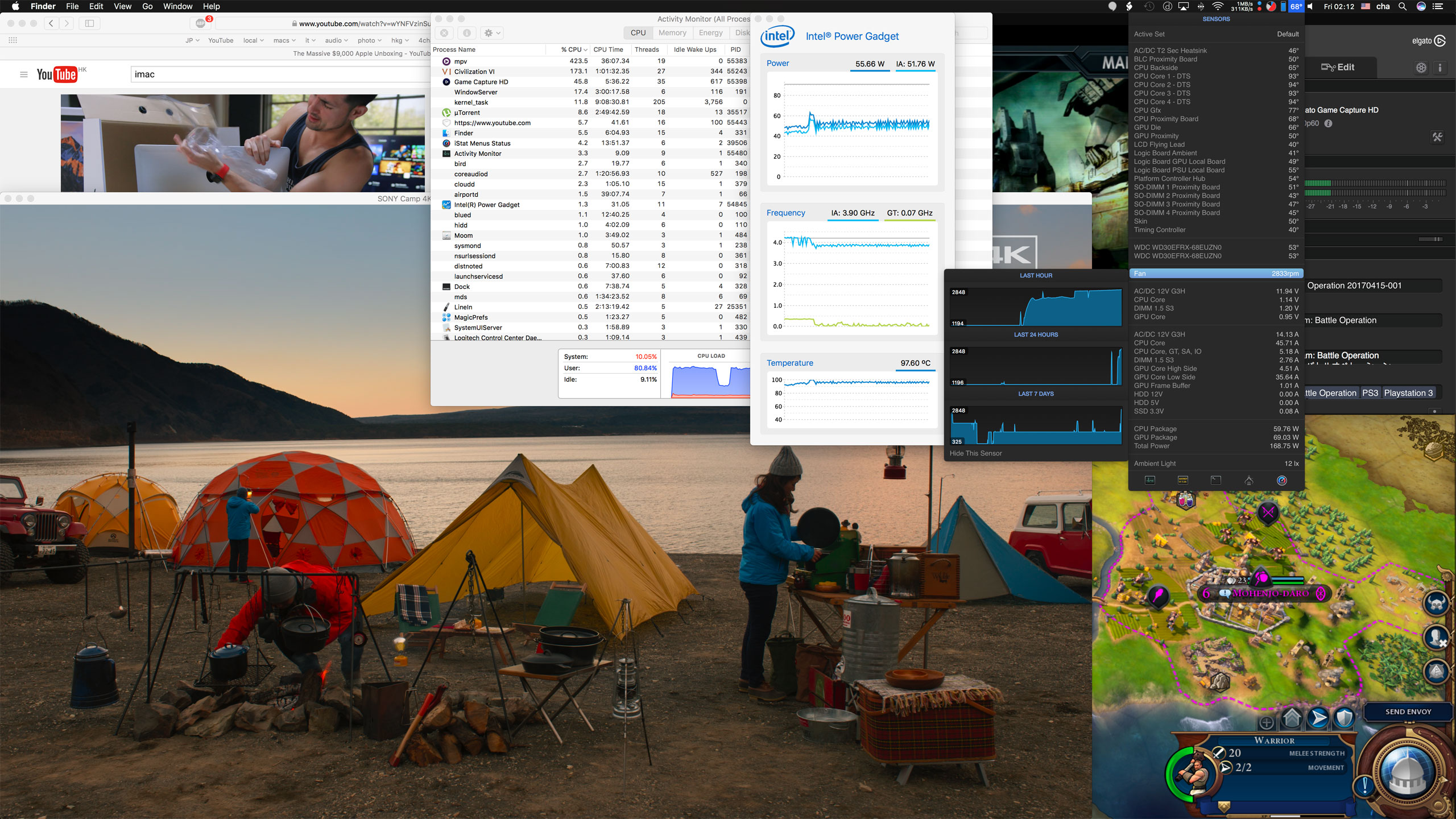

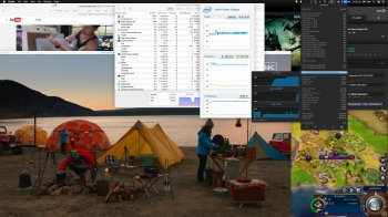

After using my i7 for 10 days I came to this conclusion:
The fan can be noisy more often than most people are used to, but it is bearable if not negligible (for my case).
Ordinary browsing, video watching, and file management:
fan always at 1200r-1400pm, except if a 4K+ video is played which is still rare.
Lightroom:
Library module culling at ~1600rpm, but once in develop module with RAW processing involved, all cores are called, after a few minutes fan is at 2000+ which starts becoming audible. Batch processing, preview generation, exporting etc of course fire up all hyper threading cores and fans at 2400 or so but the temp increases only gradually, probably after half an hour.
Gaming and video encoding:
Easily go into 2700rpm+ in under a minute, which is expected.
Throttling:
Starts happening after throwing unreasonable loads, I had to playback a 10bit HDR 4K video, capture HDMI video, playback a youtube 2K video, running 20 streams of BT, and have Civ VI running max setting at 1440p, all these at the same time to get clock down to 3.9Hz or so when the CPU average at 97 degrees. It seems the "trigger" of throttling is when 60W/100 degress is reached for prolonged period, say 30 seconds or so, then it got dragged down to 55W.
I have used thermally constrained Macs before, like the Mini 2012 and MBP 15" 2015, they both have noisy fans at max speed, these machines throttled even harder but somehow they had less fan noise, and their fans would kick in relatively later. I suspect this iMac is quite more efficient than the other Macs at cooling but at the expense of having the fans much more aggressive.
Now as to why I think this is a non-issue:
I am staying in Hong Kong where the average room temperature can easily reach 30 degrees in summer, which can be unbearable indoors. If the iMac is in a room being ran at heavy CPU load without turning on air conditioning it means I am not in the room to hear the noise. And then if I am sitting in front of the machine I definitely will leave the AC on, which "cancels out" probably half of the fans noise up to I'd say 2400rpm. In the odd events the fans have to be maxed at 2700-2800 rpm it means I am pushing the iMac to do a lot, I have no problems dealing with just a little noise if it means work are getting done at great speed.
When it gets to winter the room temperature go back down to 20 or even 15 degrees, then it effectively is the same as if I had the AC if not better, in terms of cool air supply for cooling intake. By then maybe the fan noise would be more audible without the AC noise canceling, but I am hoping the air intake is so much cooler then it means much more efficient cooling for the machine. I am thinking that if some users around the world living in cooler place may be the ones who are irritated by the noise issue the most, as their rooms are typically dead silent where most computers usually have no need to fire the fan up at all, whereas this iMac does it more often.

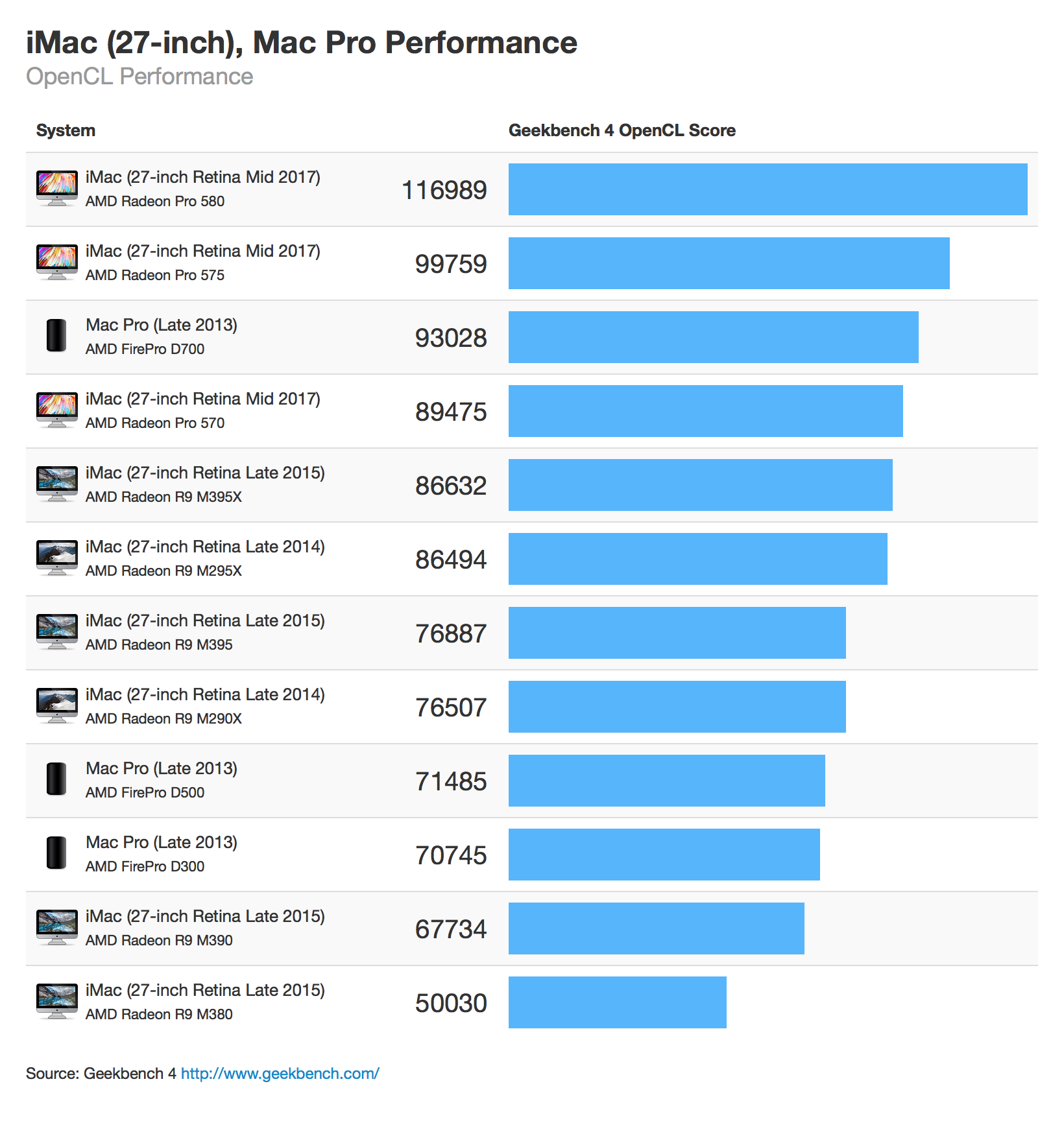

EugW, propower and smoothie. Wow! I have analysis paralysis trying to study everything that has been posted in the last 2 days. I'm sure all this data will help those on the fence decide which tier to order and whether or not the i7 warrants the extra cost. Now, I'm beginning to think that I should spend the extra $110 and step back up to the top tier i5 just for the GPU should some killer VR app comes along not too long from now. Geez. You guys are not making this easy!
Thanks for the review.
Interesting that it throttles at 3.9 GHz. That just happens to be the exact normal multi-core clock speed of the i5-7600, albeit with HT on the i7.
I am not sure you need to throw all that load at the i7 to make it throttle. I suspect h.265 video encoding for a prolonged period would also make it throttle, esp. in a hot room.

As you already know, the 570 entry level is actually more powerful than the top CTO tier of the last generation of iMac GPUs (M395X).
