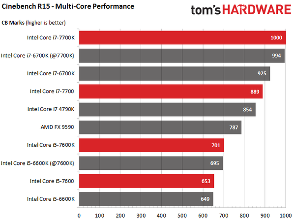

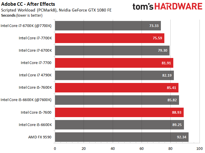

It should be noted that all-core Turbo for the 3.8 GHz i5 7600K is 4.0 GHz.All-core Turbo for the 3.5 GHz i5 7600 is 3.9 GHz, which is a 3% difference. This reflected in all-core multi-threaded work, which shows a 2-8% difference between the two.

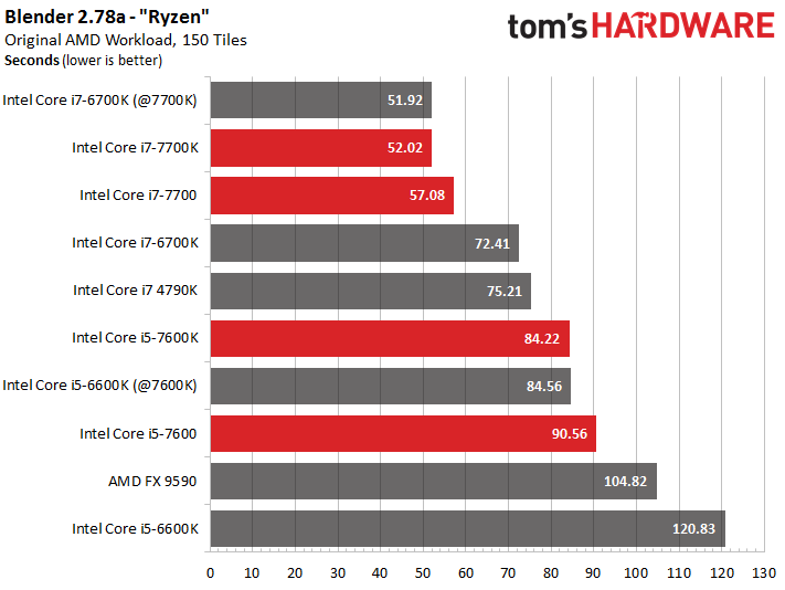

For Blender, note the similarity of the 7600 vs the 7600K (7.5% difference). However, there is a huge difference of both of them vs the i7 7700K as you are well aware.
http://www.tomshardware.co.uk/intel...-i7-7700-i5-7600k-i5-7600,review-33752-4.html
