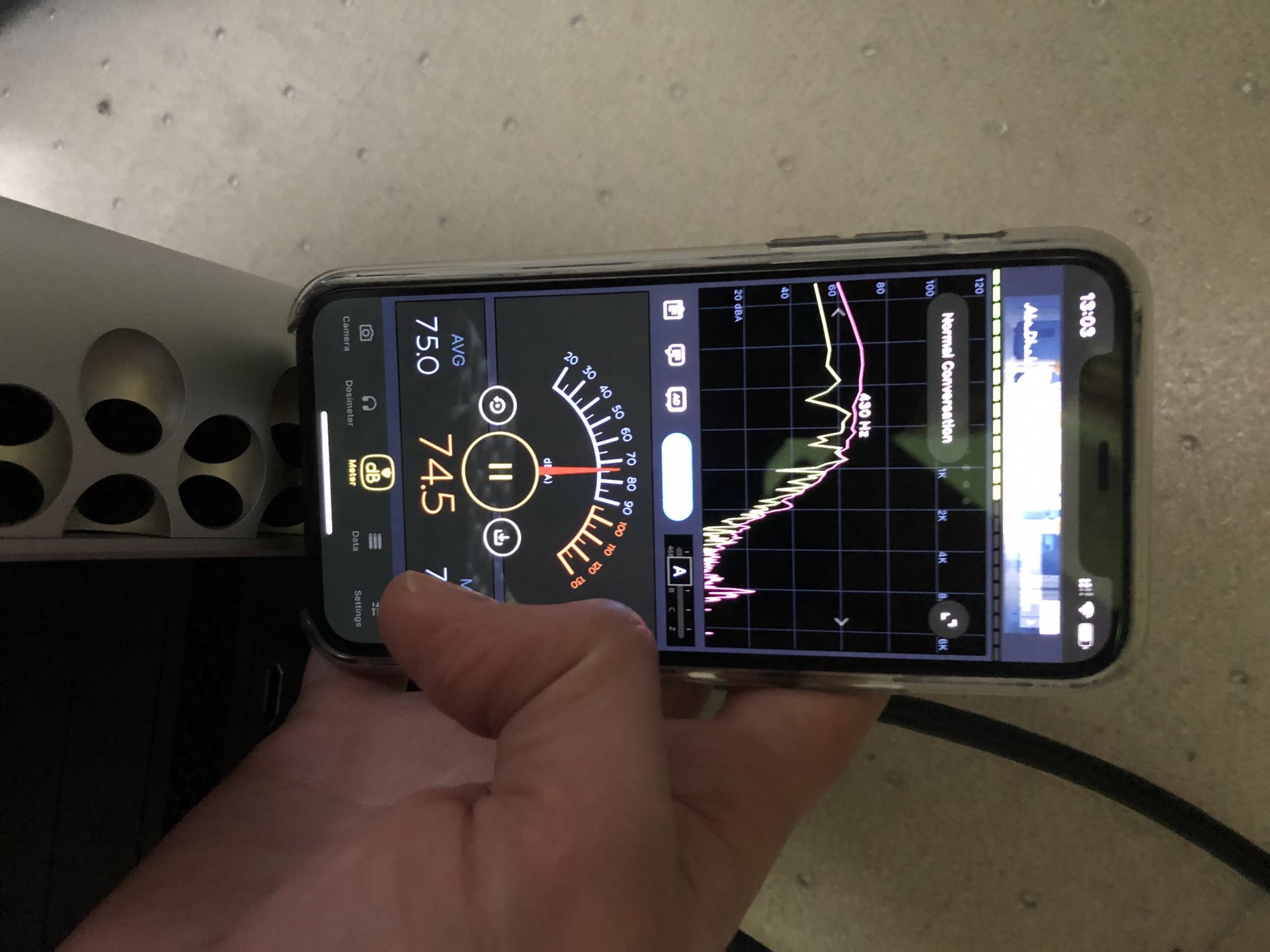

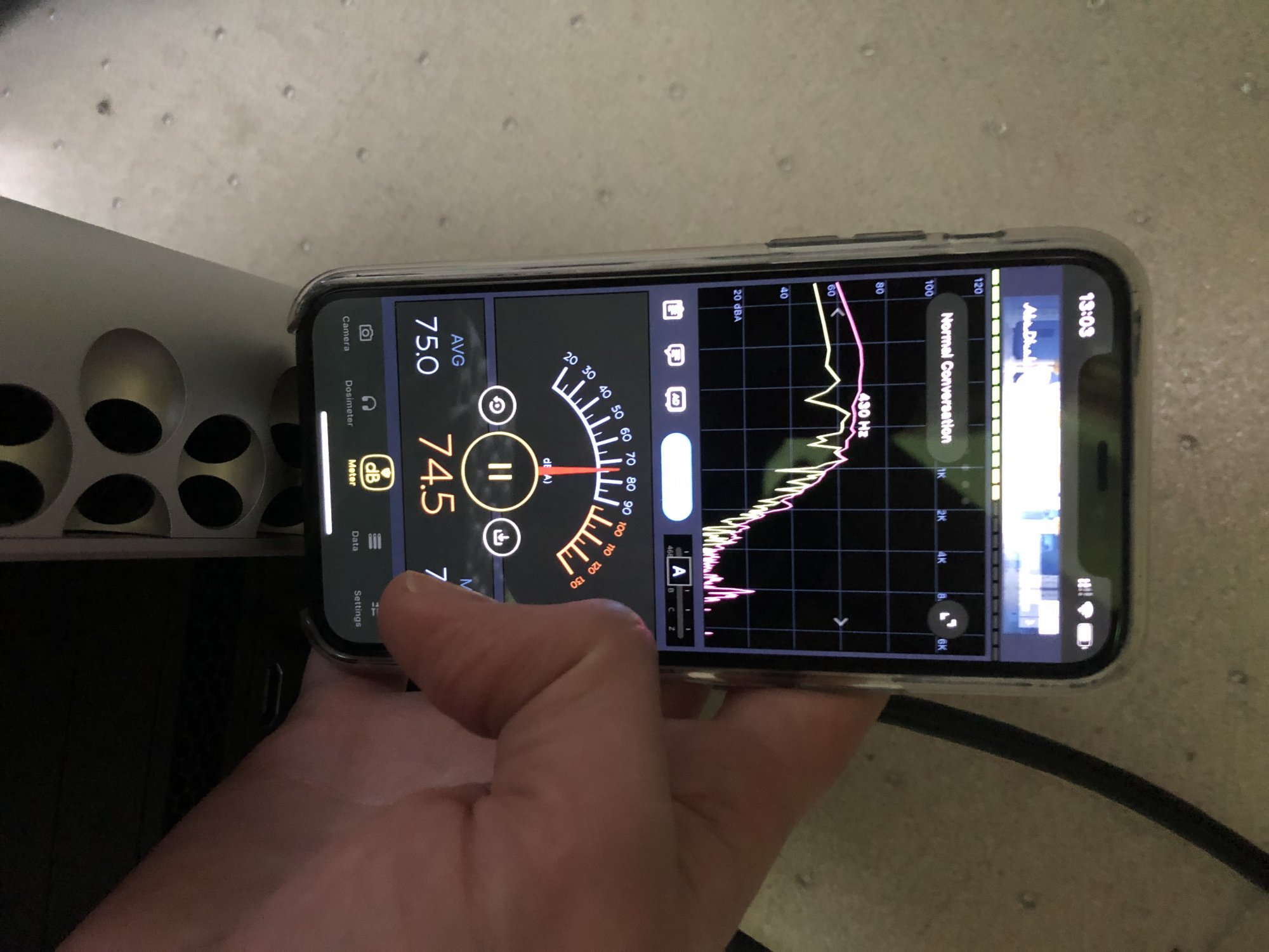

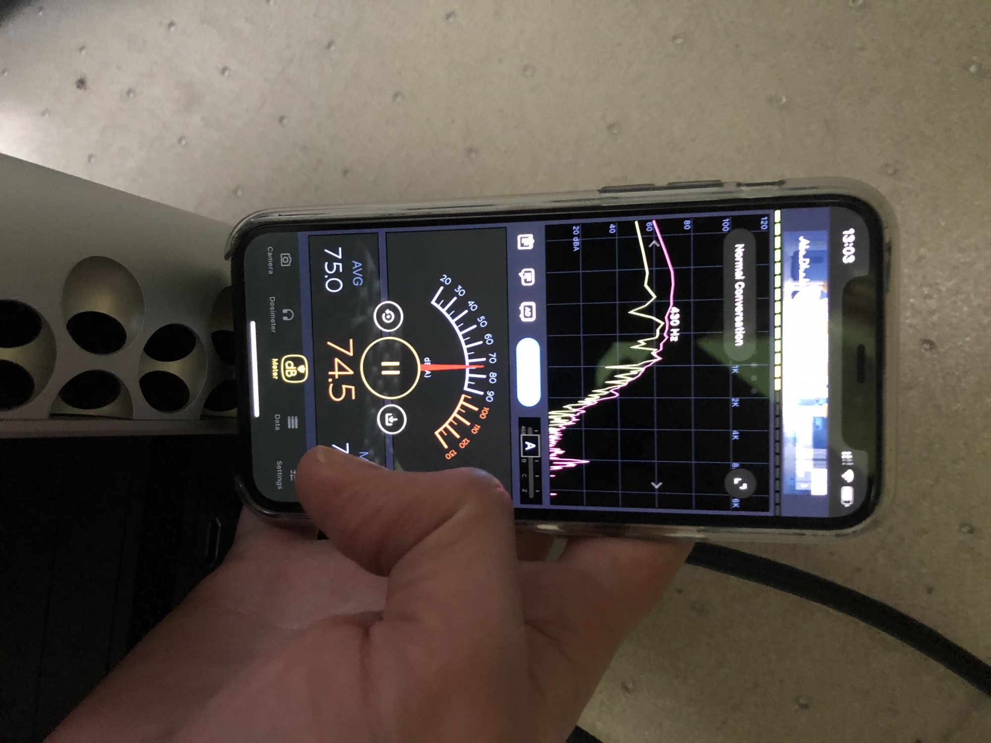

Blower - 75db

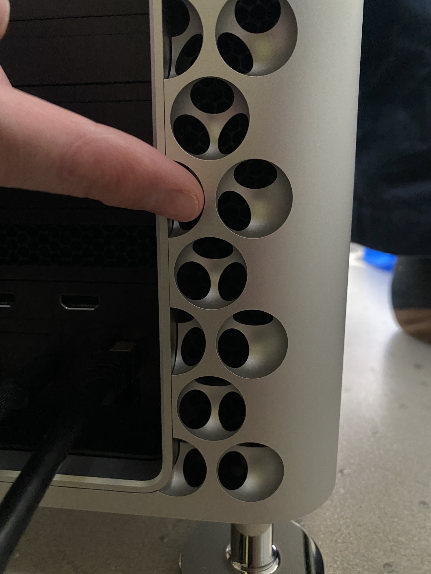

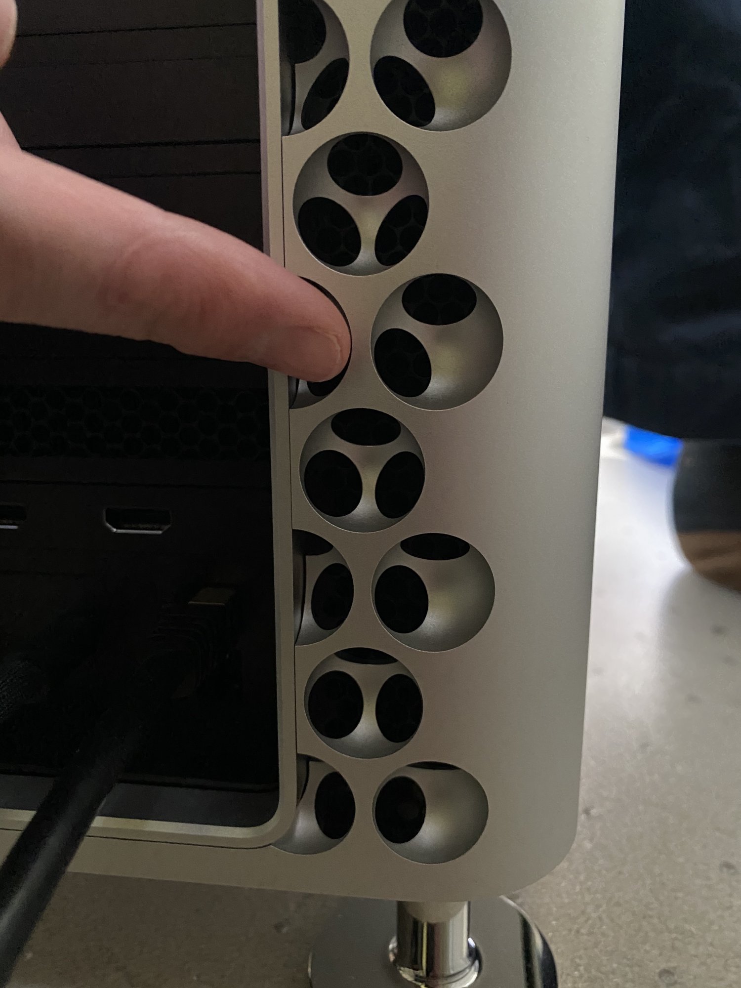

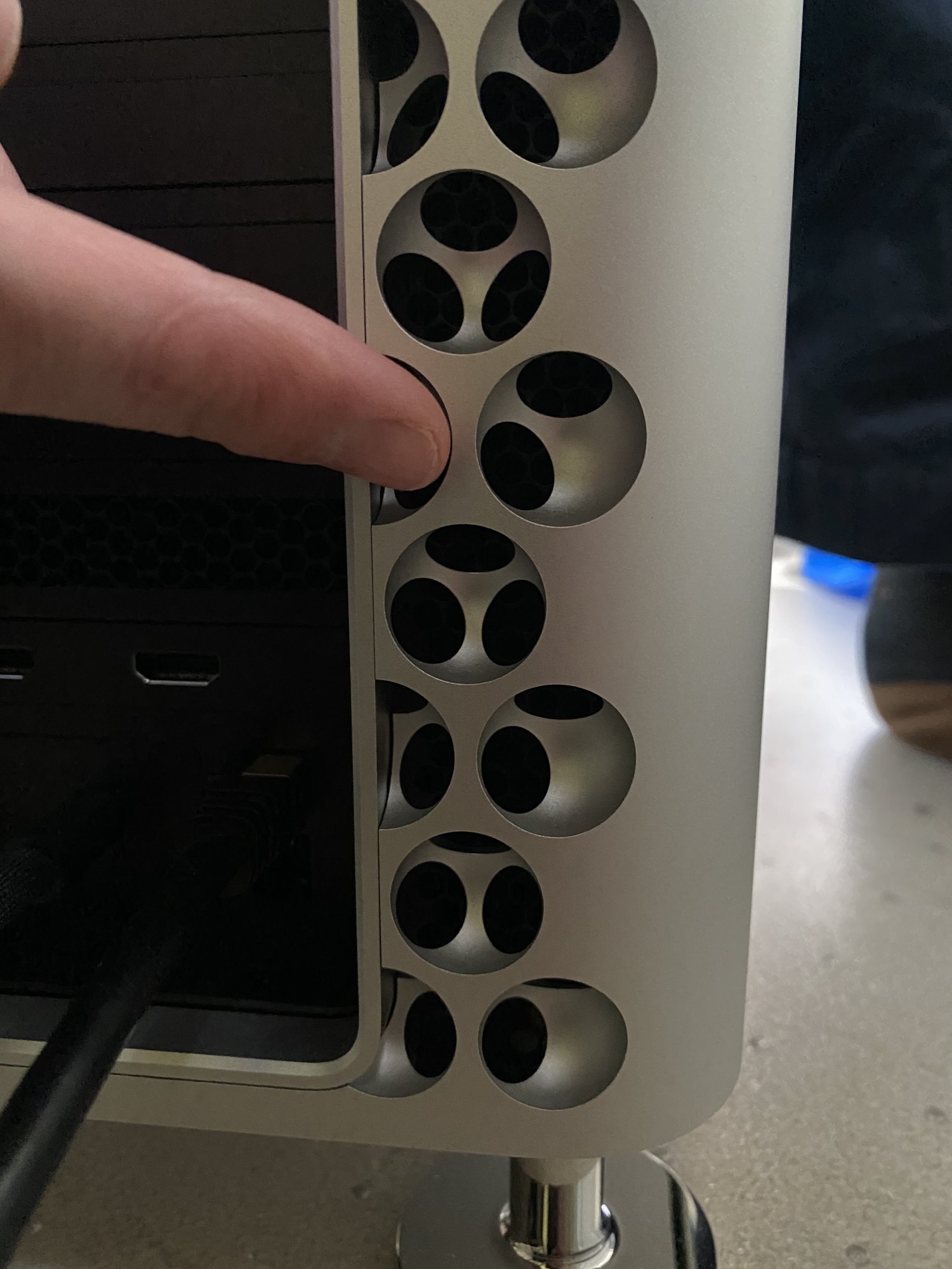

Place it as shown in below 2 pictures (almost touching). You're trying to aim to find the loudest consistent output so you may need to move your phone a little to achieve that.

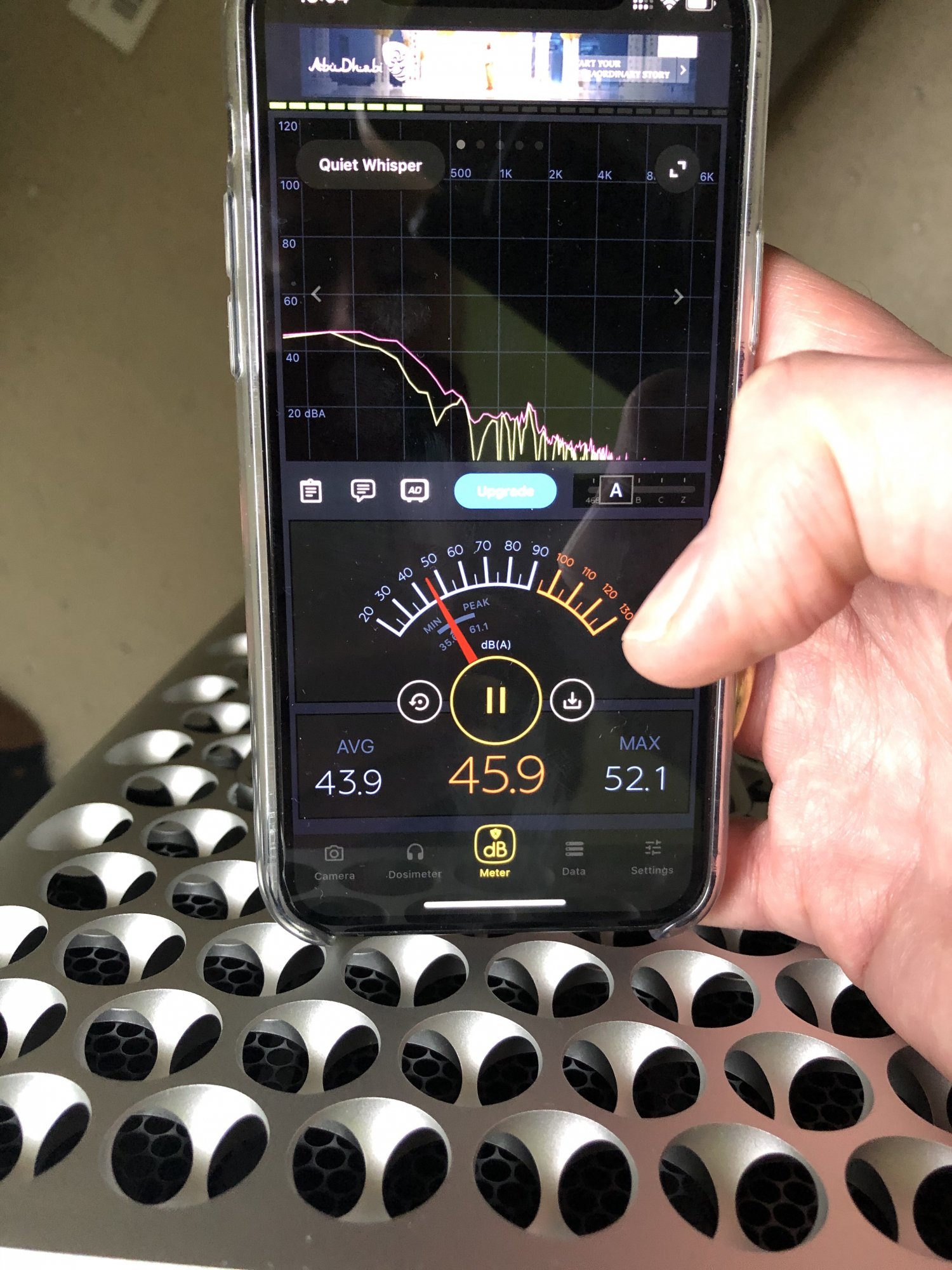

This is where I tested it from, 5 circles up:

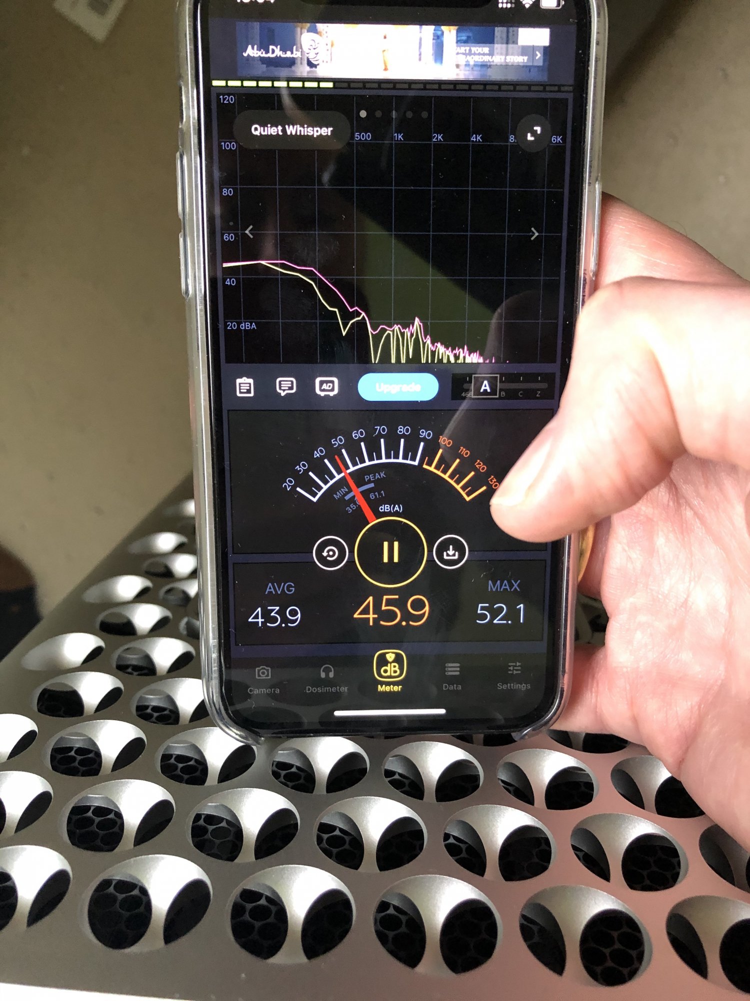

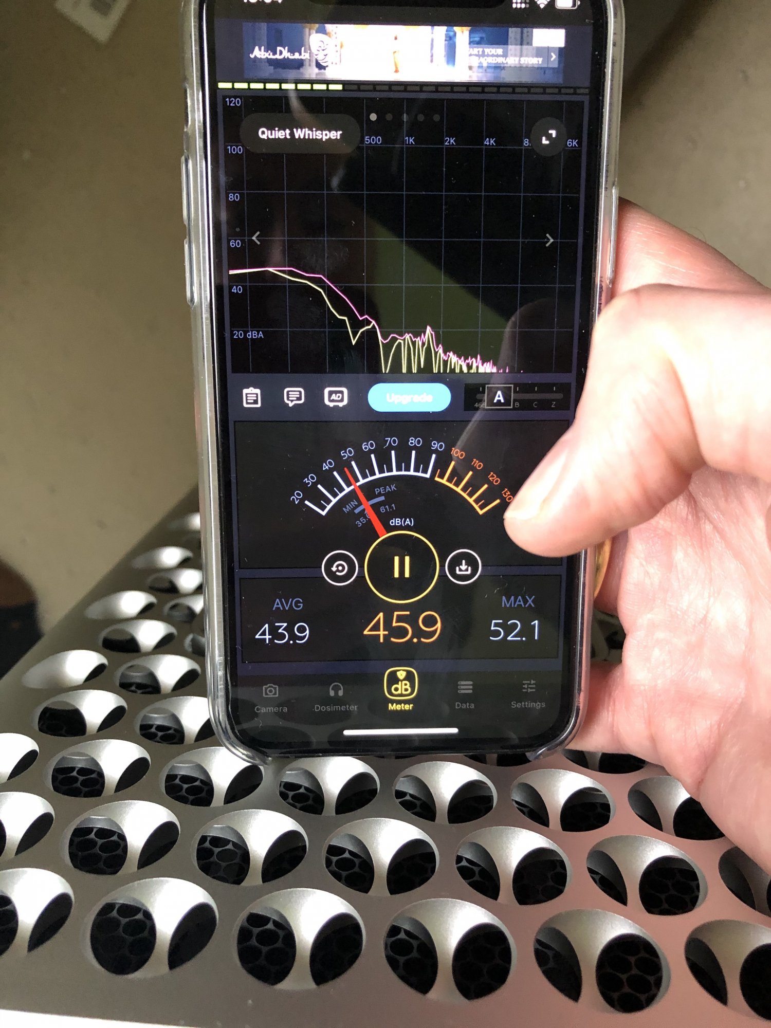

Back - 44db
Place almost touching between 3 circles and 4 circles down from the top, center.

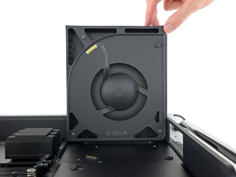

After spending a lot of time with it this evening, the noise is coming from the blower. With the blower off, it sounds substaintially better. Here is the sound difference:
Swapping the memory back to default made no difference. All fans are running at nornal speeds: 490-591 RPM.
The problem is, the iMac (non-pro) is quieter than the Mac Pro.

Measurements should be made at 1m as thats the standard test.
This. As close as possible to a fan outlet partially turns that meter into an 'airspeed' meter, not a noise meter.
It’s a standard for all dB measurements so you get consistent comparison readings. I work in an industry where we have to take readings if all plant and equipment, the readings have too be a 1m and compared with standards for health and safety.
I do understand that the test is inaccurate, but it's been incredibly useful to find out where the problem is and what's caused it without having to try and setup an accurate test environment.
