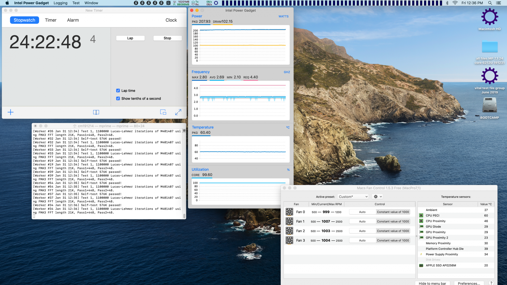

My 28 Core MP7,1 is currently undergoing a long term stress test with its processor upgrade .
All its cores and threads have been at 100 percent continuous load for the last 24 hours , using a prime number calculating program .
Factory SMC wasn't rotating the system fans fast enough to cool the W-3275M properly , so I bumped up all four system fans to 1,000 RPM using MFC . The processor is as cool as a cucumber now . Around 65 degrees Celsius at the Tcase using Intel's Power Gadget for Mac .
I can't hear a thing from the front of the Mac . The rear has a slight hum . I'll see if I can get some sound pressure readings later today . But even for sensitive music editors , I don't think it'll be a big deal .
Apple got it right with the cooling system , so far as I can tell .

OK , I have the results from my System .
MP7,1 ( 2019 )
28 Core W-3275M Xeon
96 GB ( 6 x 16 GB ) 2933 MHz DDR4
580X factory graphics
256GB factory SSD .
macOS Catalina .
She currently has all her cores at long term continuous load and all the system fans are at 1000 RPM using MFC .
Meter is a Beha 93-20 . Meter only goes down as low as 40 dB on its analog scale .
Ambient is less than 40 dB .
Fan side ( front ) = 42 dB @ 6" ; 40 dB @ 12" .
Blower side ( rear ) = 50 dB @ 6" ; 44 dB @ 12" .
To my ears , it's a quiet machine . I'm more than 12 inches away , though .

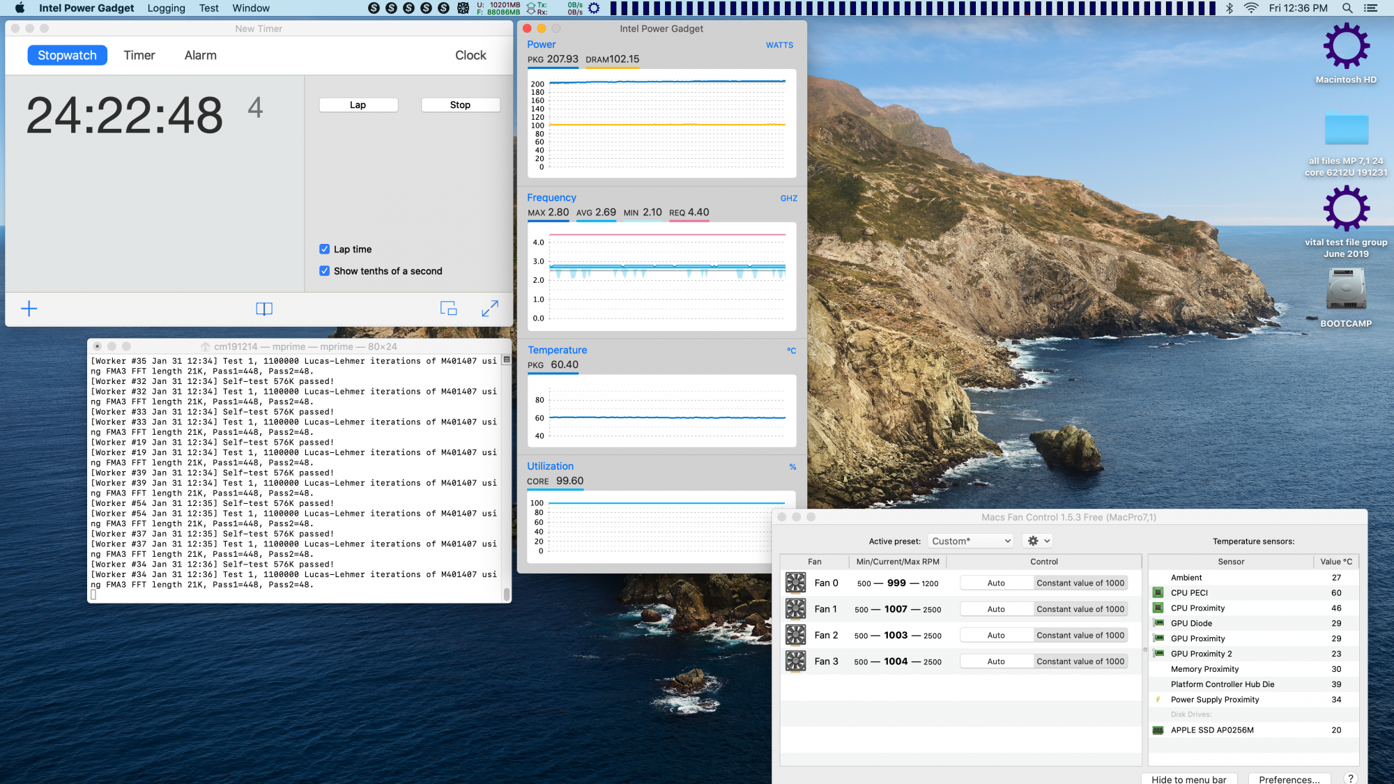

MP7,1 ( 2019 )
256GB factory SSD .
macOS Catalina .
