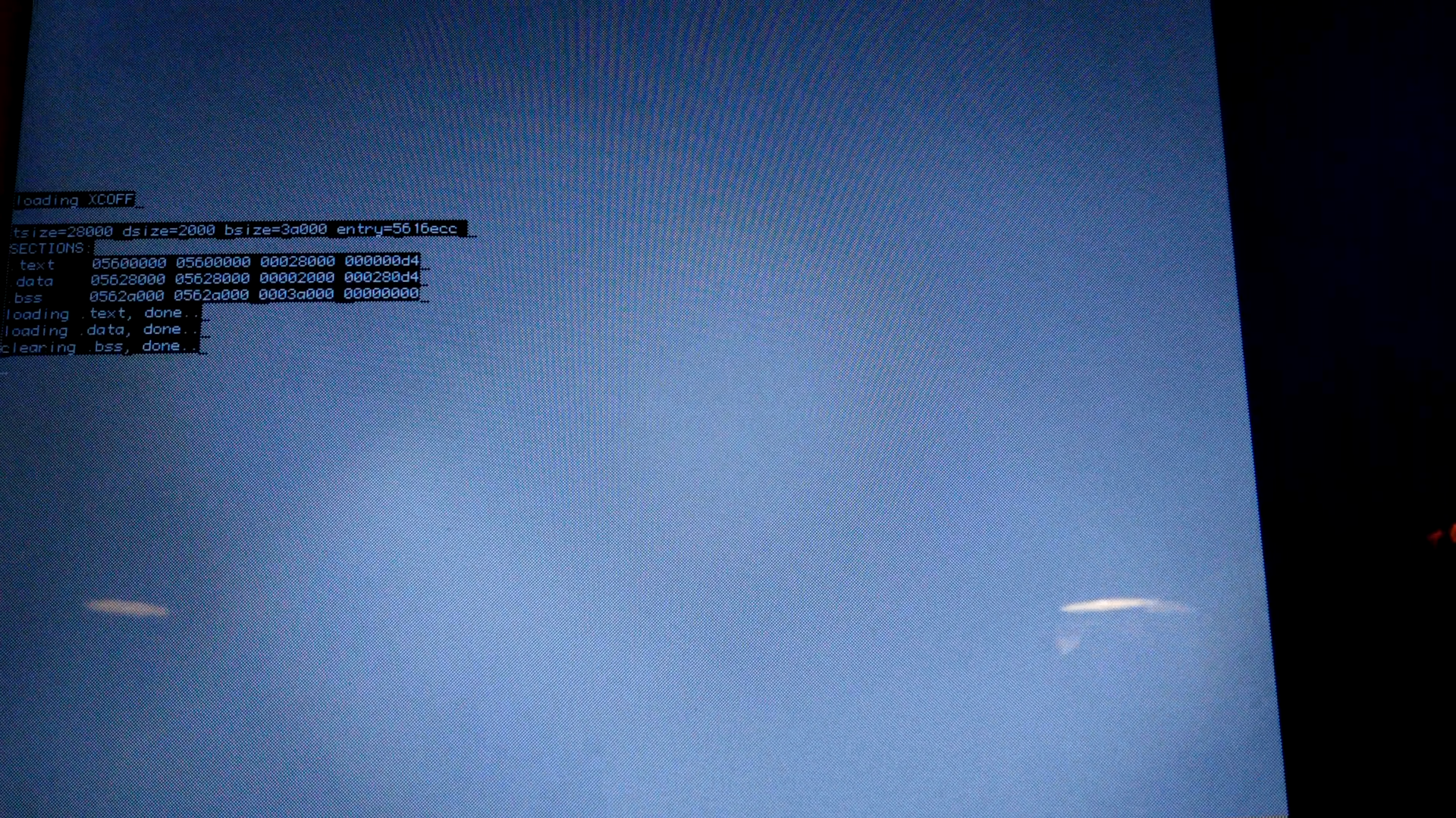

The situation I’m facing is right in the starting gate with PowerBook2,2 (the Rev. C iBook G3) and being unable to successfully reach yaboot.
After reading this entire thread and returning back to the top to follow the wiki installation guide painstakingly closely, the path I chose was to try the Debian 10.0 (Buster) netinstall ISO — opting not to try a Sid build just yet, since that would take me astray of the above how-to (and installing linux isn’t really in my wheelhouse of experience). I copied the ISO to different media.
I’ll describe the three media sources I tried separately:
First go: burnt the ISO to a disc (once from Toast and once, separately, from Disk Utility)
Second go: dd’d the ISO to an install partition on the internal drive (an SSD). (also tried image restore in DiskUtil as an alternate)
Third and final go: dd’d the ISO to a USB flash drive.
As for yaboot boot attempts:
The first method, the “C” OF command when booting from a disc, skipped the disc entirely and usual OS X boot took over.
The second method, to “Opt” to see all bootable systems (whether using the burnt disc, the internal partition, or the USB drive), displayed an option for a generic linux boot (i.e., a tiny penguin). When selecting the Linux boot, the screen flashed rapidly, displaying a tiny block of text, followed by a return to the same “Opt” boot-select screen — though this time the screen appears visibly garbled.
(As for this “tiny block of text”, I’m getting to that.)
The third method was go into OF and try booting from the above three media sources (using, respectively, the boot cd; boot hd; and boot ud, commands, appropriate for the above media sources — followed by their appropriate path info, i.e., “boot ud:,\install\yaboot”, etc.). With all three, I verified that OF’s date was set to today.
With each of the three media sources, the screen flashes briefly to what looks like yaboot taking over, displaying the same tiny block of text, as with the above, but for maybe a split second longer, followed by the 🚫 sign.
As with the above, the boot fails. You can view this in the attached a 10sec clip at the end.
By filming this (booting from the USB drive), I was also able to pull a frame from the moment the block of text appears. The text are parameters such as block size. No obvious errors, though.
After all this, I tried the same (though this time, just to the USB flash drive) with the 8.11 (Jessie) netinstall ISO and the same thing occurs.

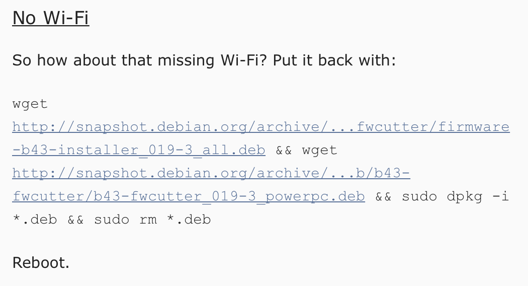

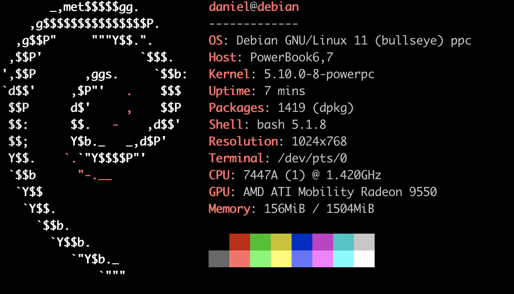

Hi All,
Trying to get WiFi (AirPort Extreme) working on my iBook G4 1.42GHz running Debian 11 Sid.
I have the BCM4318 chip
Following the instructions. Seems these links are dead (see attached)

The items in the first attachment. Download them, then run sudo dpkg -i *.deb as instructed. It is not apt install.
I can't read and you just wrote that they're dead. Hold that thought.
e~ I just tried the links and they work fine.

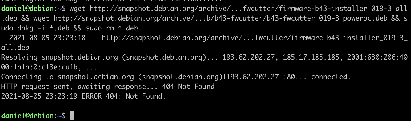

Well this is what I get, see attached.
Code:
daniel@debian:~$ wget http://snapshot.debian.org/archive/...fwcutter/firmware-b43-installer_019-3_all.deb && wget http://snapshot.debian.org/archive/...b/b43-fwcutter/b43-fwcutter_019-3_powerpc.deb && sudo dpkg -i *.deb && sudo rm *.deb
--2021-08-05 23:23:18--  http://snapshot.debian.org/archive/...fwcutter/firmware-b43-installer_019-3_all.deb
Resolving snapshot.debian.org (snapshot.debian.org)... 193.62.202.27, 185.17.185.185, 2001:630:206:4000:1a1a:0:c13e:ca1b, ...
Connecting to snapshot.debian.org (snapshot.debian.org)|193.62.202.27|:80... connected.
HTTP request sent, awaiting response... 404 Not Found
2021-08-05 23:23:19 ERROR 404: Not Found.
Code:
Ah, I see.
MR Forums shortened the links to make the post look cleaner. You should copy the link instead of the text. On PowerBooks, I believe this is either F11 or F12 on the keyboard to simulate a right click. Not applicable over SSH.
