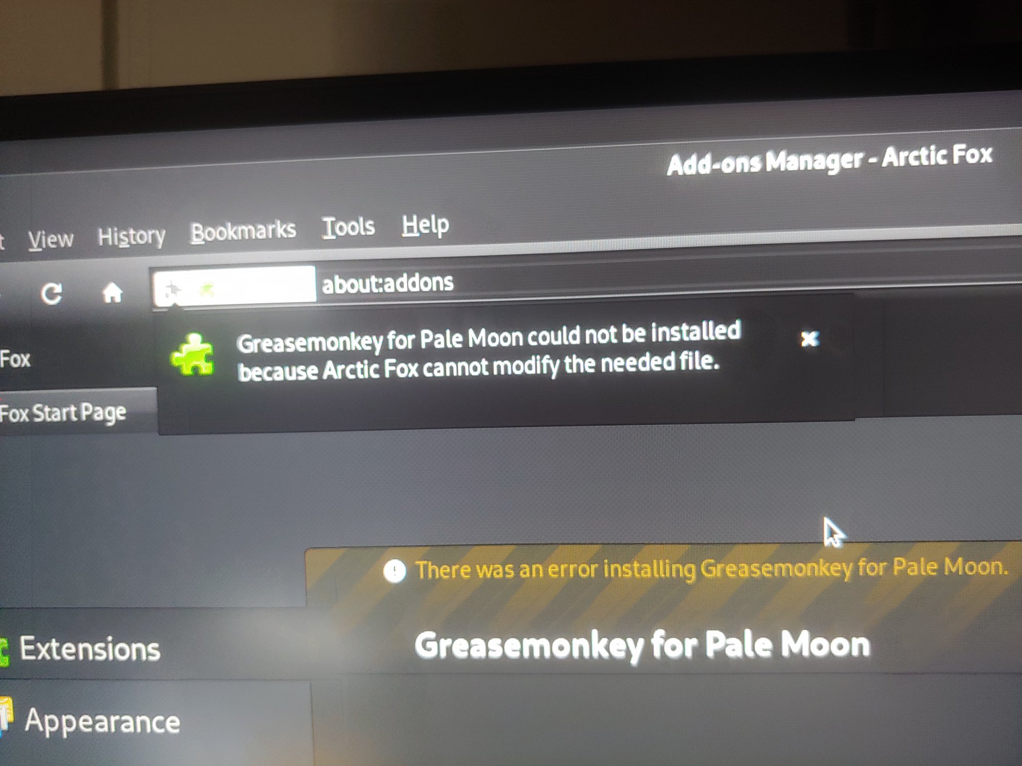

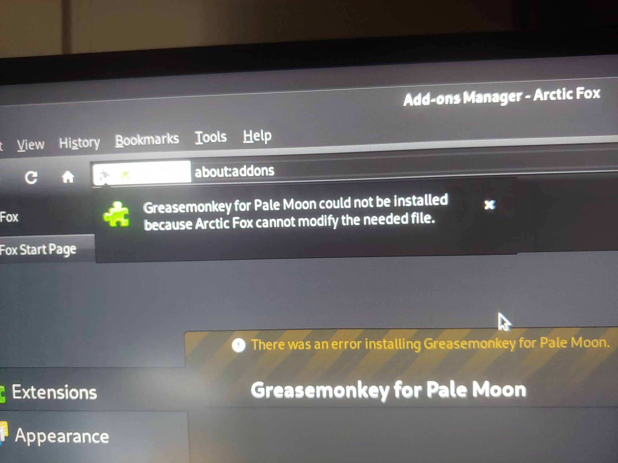

Arcticfox is quite only one usable browser on Debian. So the question is: How to install ublock Origin? Even when I found compatible version - it can't install because extension installer can't modify some file.

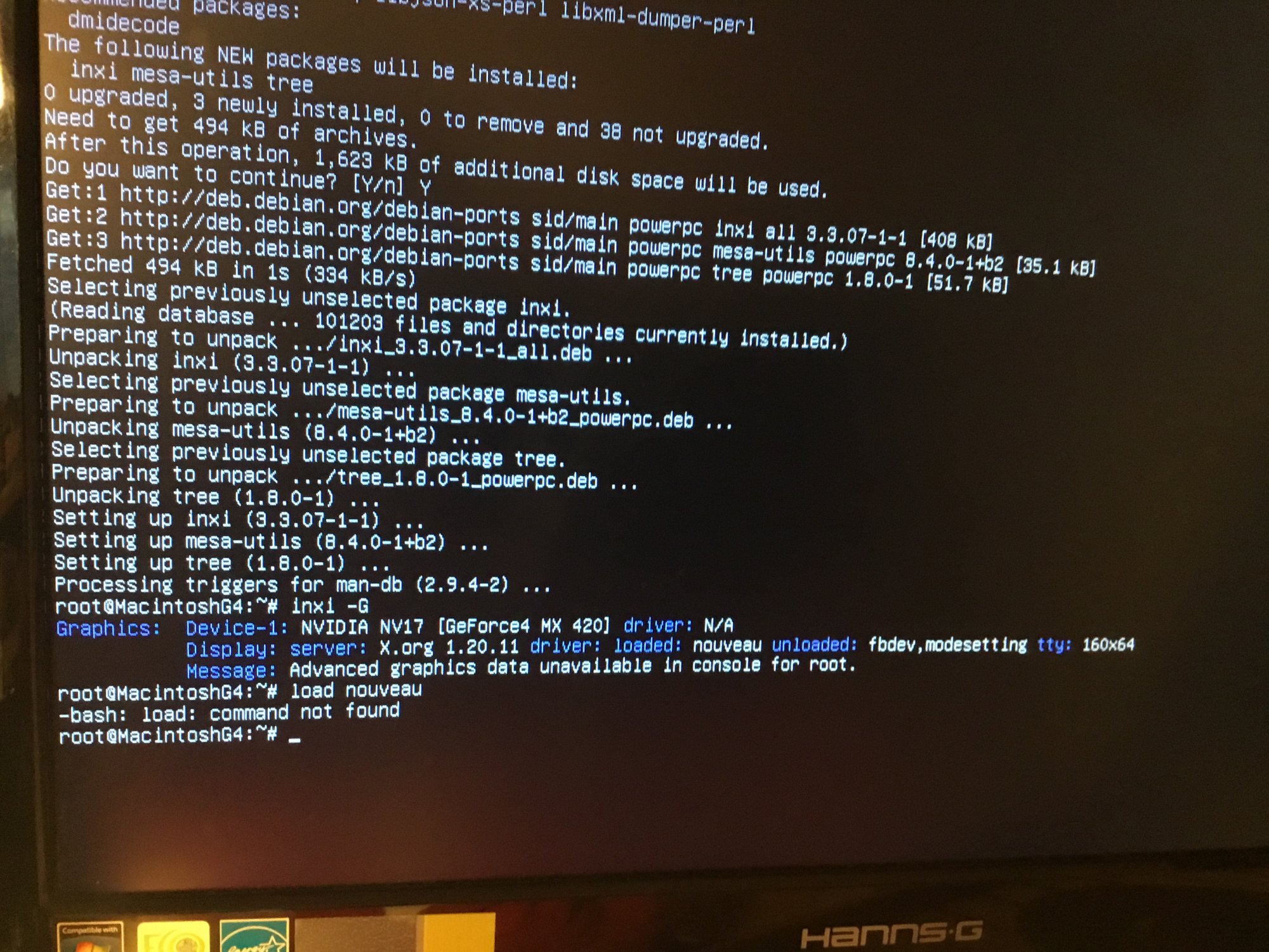

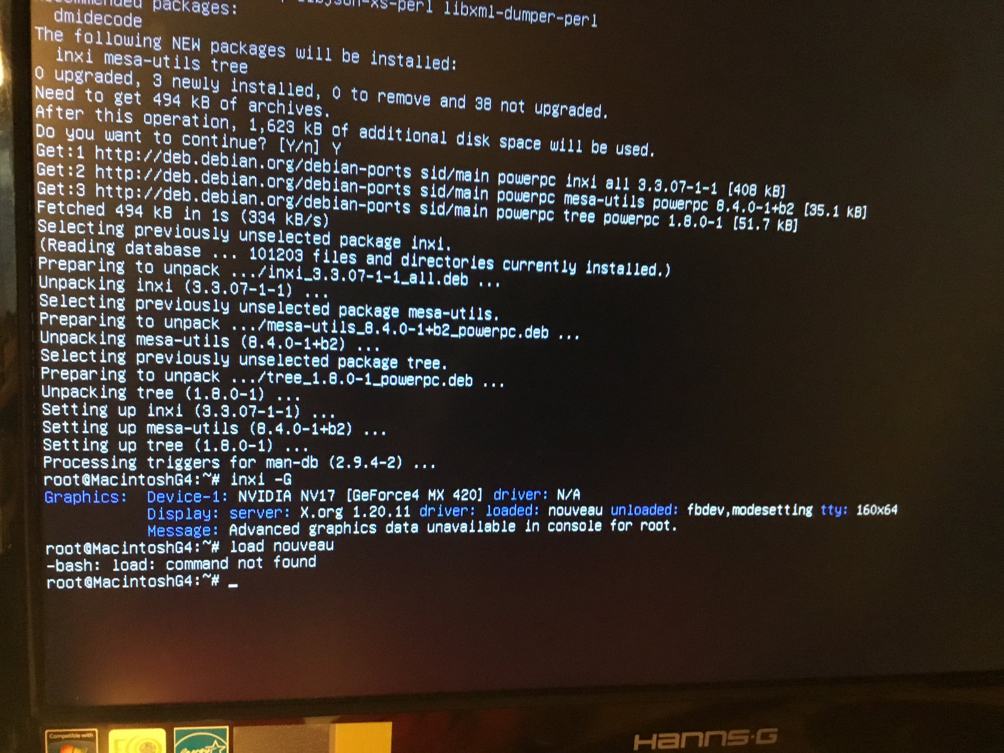

Just a quick update. I loaded Deb 10 kernels 5.14 and 5.10 on my 867Mhz G4 and was able to get to a the Grub screen. After that all I can do is get to a terminal, no GUI desktop. I add “nomodeset” in the boot choice to get there. My eyes are rolling back into my head trying to figure out how to get the graphics card, Nvidia GeForce 4, to work and haven’t found a solution yet. While in terminal I did a modprobe Nvidia fib, rivafb, etc but it says neither are found in /lib/modules/5.10-3-powerpc, so I went to edit that but there isn’t anything in there.
Can /lib/modules be modified to “see” the graphics card?
Still trying…

Getting console display is good. At least you know the OS booted and is working. By default Debian doesn't come with a desktop. You have to install that manually. Just for kicks, can you install inxi?
sudo apt install inxi
Then once installed type: inxi -G
This will tell you what driver your graphics card is using.
Cheers
Thanks for that, I’ll definitely try that. I also used your instructions to try and install Feinix thinking that would give me a desktop but, I’ll try those other things first.
During the installation process, I left Debian Desktop environment and Xfce selected along with standard system utilities. I thought that keeping those selected would provide at least one if not two desktop environments. Also, in doing the Feinix install, it stated the MATE desktop environment would be loaded so I’m not sure why (other than the GPU having issues) I wouldn’t have been presented with some sort of desktop GUI.
So, below is the output of “inxi _G” on my ppc32 G4. Two disturbing results are the graphics card driver:N/A the other is the entry where is says Xorg driver loaded: nouveau: unloaded. And I’ll need to research what fbdev modesetting means. So if I am interpreting this correctly, it looks like no GPU driver is available for the Nvidia card. And that I need to rectify that somehow.

@MacMaverick855
It seems that kernel driver for nVidia card is loaded (nouveau). There is no such thing as nVidia proprietary drivers for PPC64 linux, so anyway you have to use this 🙂. As for X11 - make search for x11 driver, or most easy command - "aptitude search ~nnouveau". (I don't remember details of package name). You need something like "xorg-driver-video-nouveau".

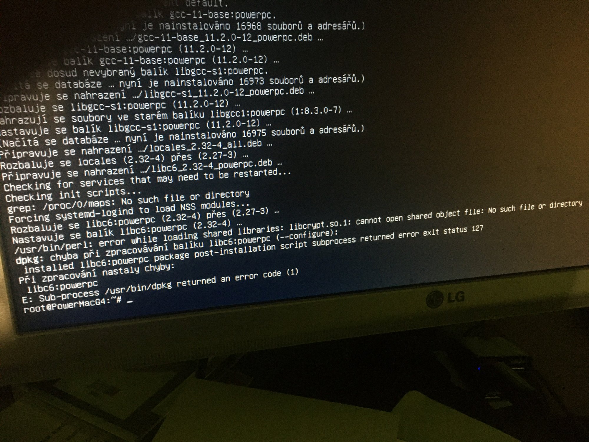

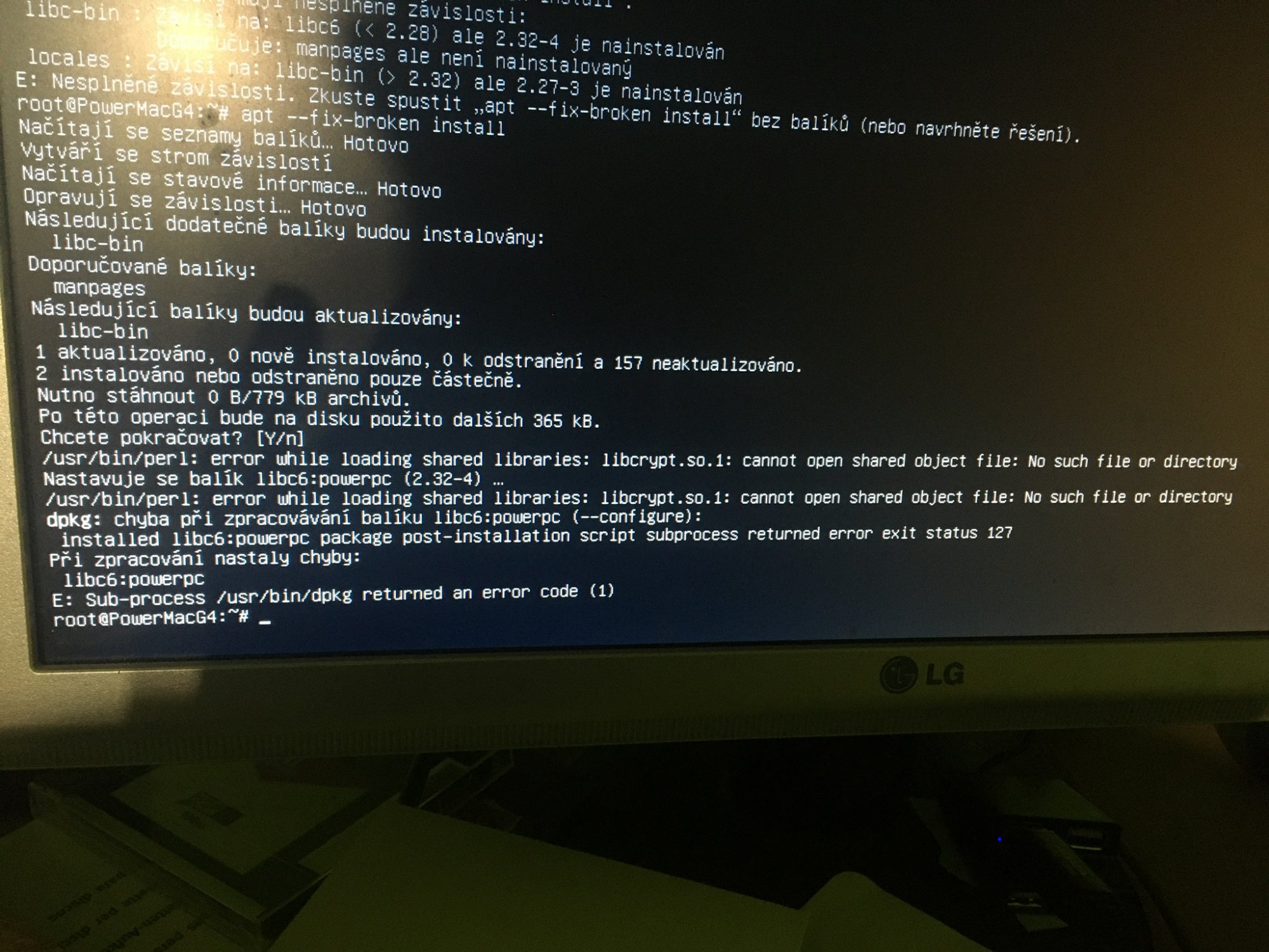

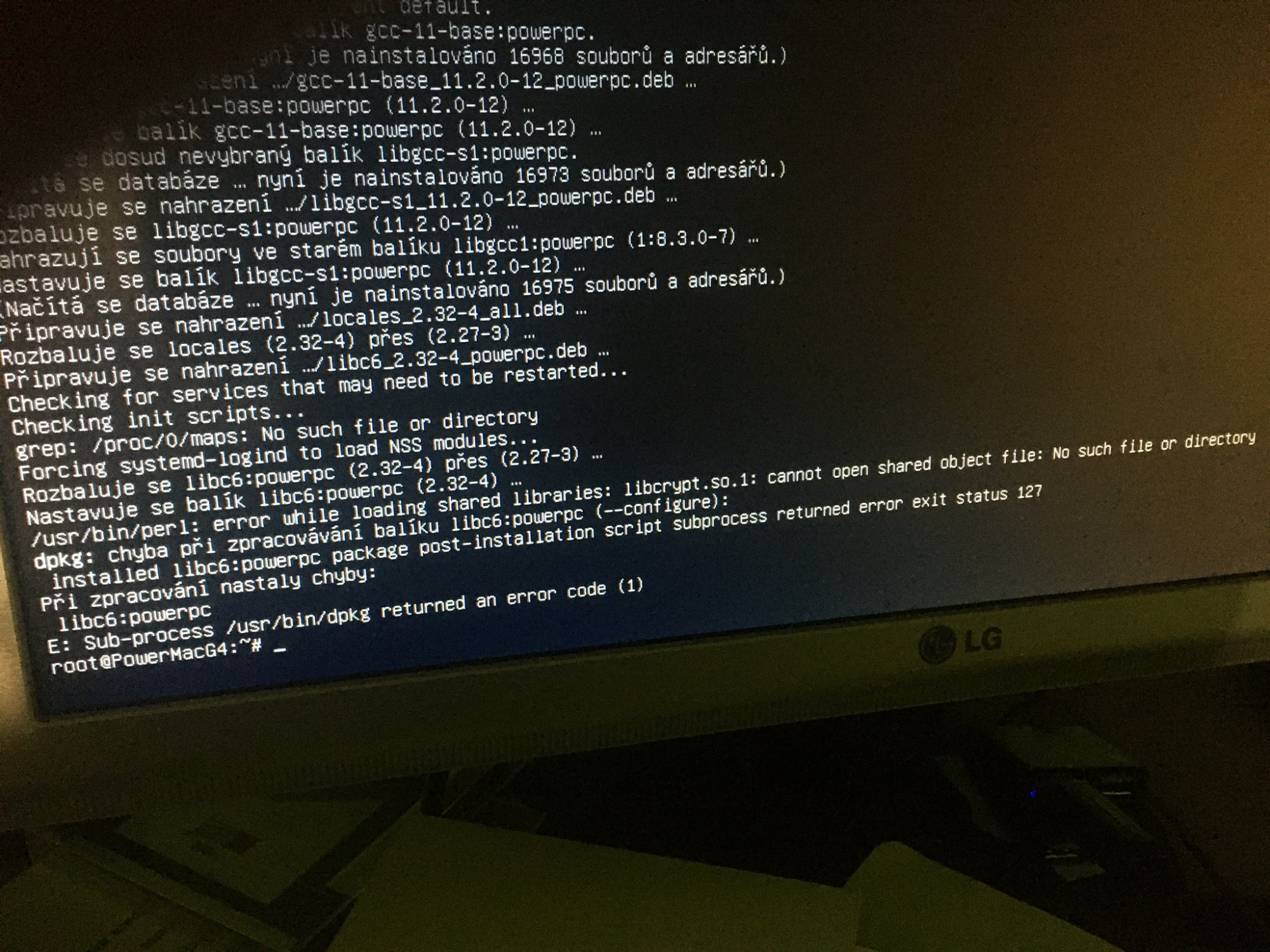

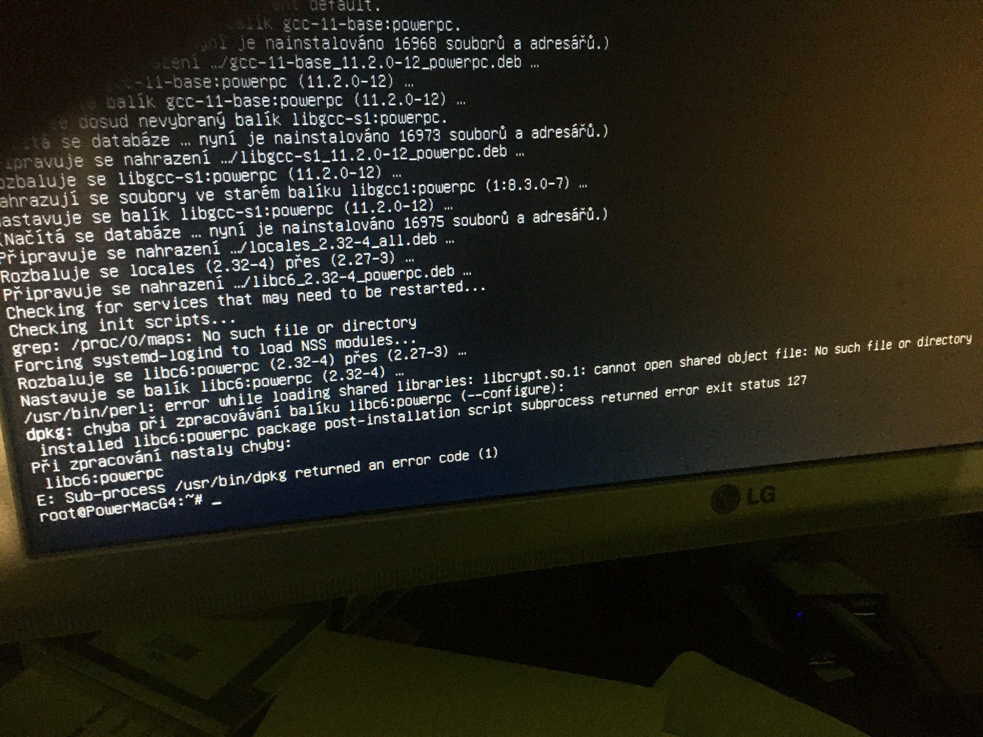

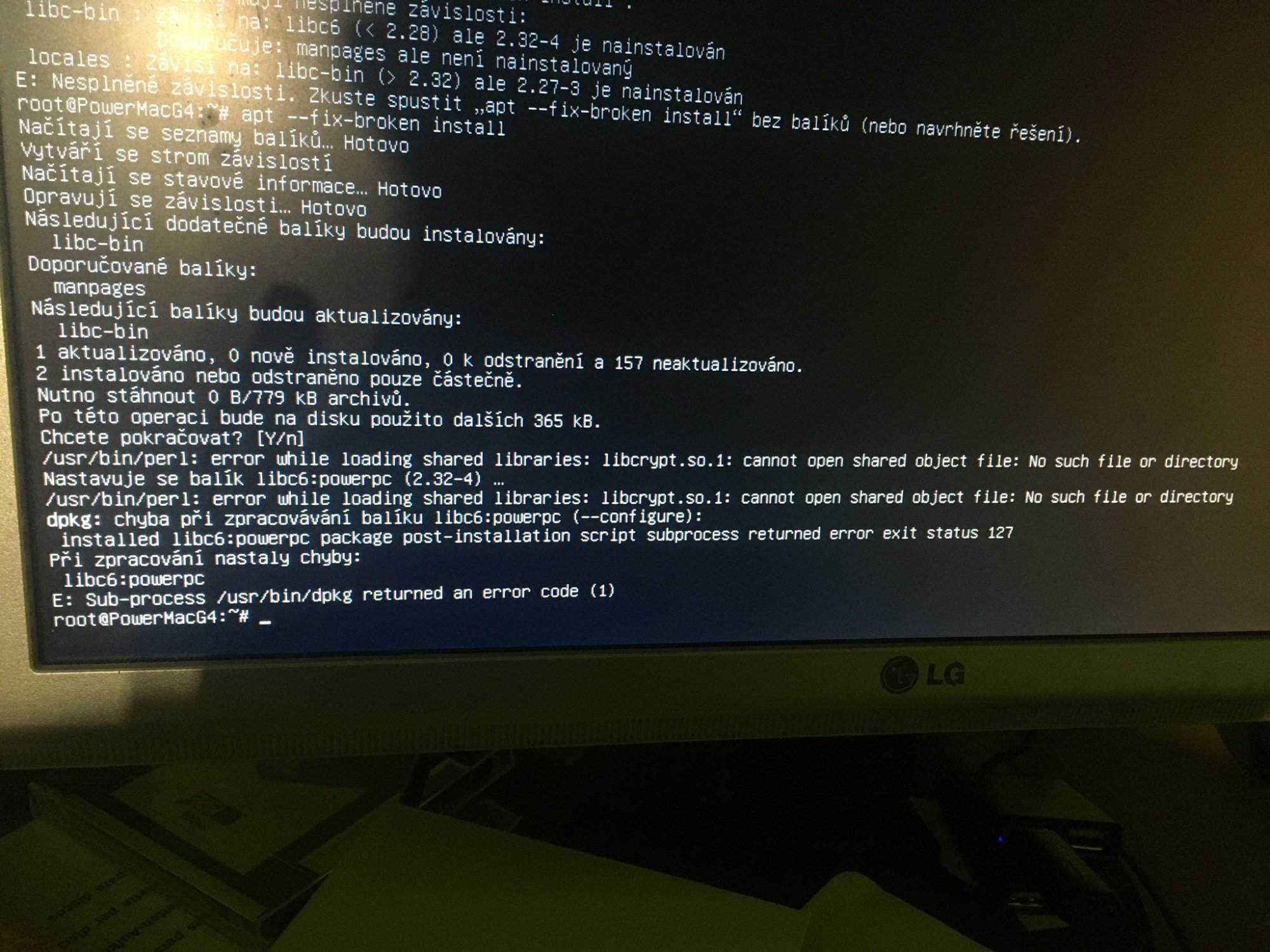

Anyohe has solution for Debian Sid broken by libc6 2.32-4 after update, please?
Tried to reinstall it 3 times and always the same messages.

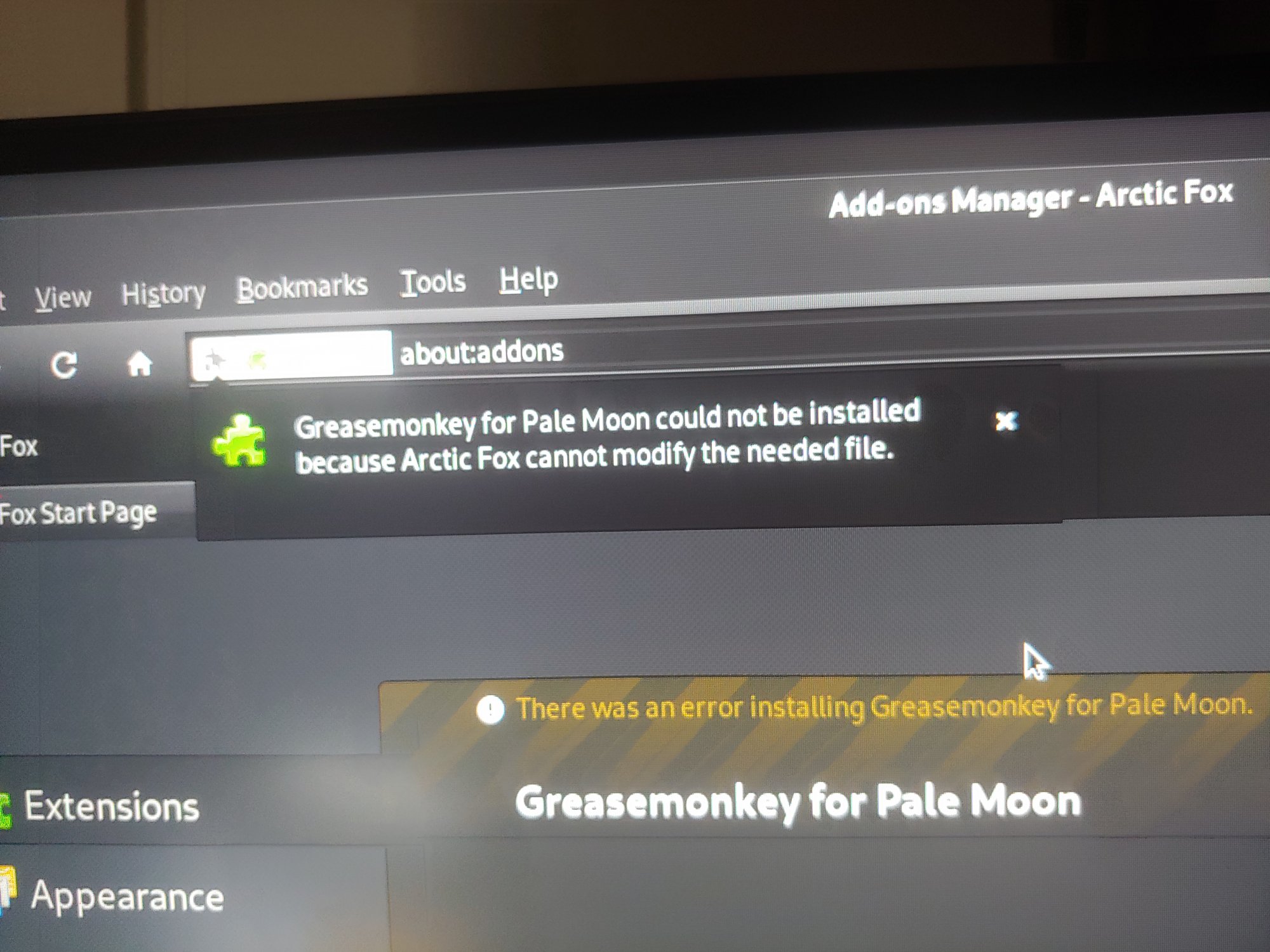

I'm trying to install Greasemonkey extension in Arctixfox 39.0 on Debian Sid bookworm (kernel 5.15.0-2 powerpc64) and 32bit userland but no go. No problem in Fadedorb and Interweb. Everything on PM G5 2.3. Any hints?
Regards,
Kristoffer

Hi,
Regards,
Kristoffer
PS
On G4 without any problems.
I manually moved the extension and it now works. Why this happened? I have no idea....
