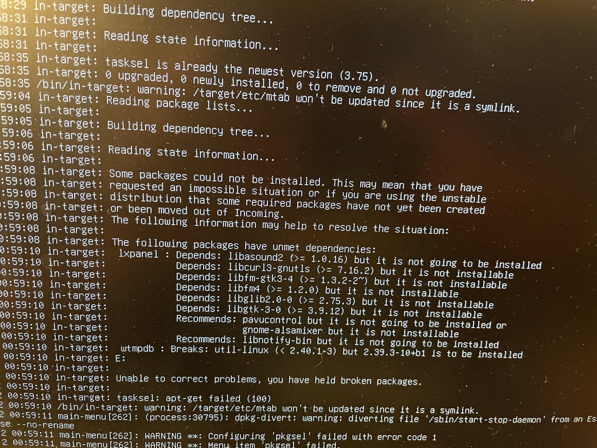

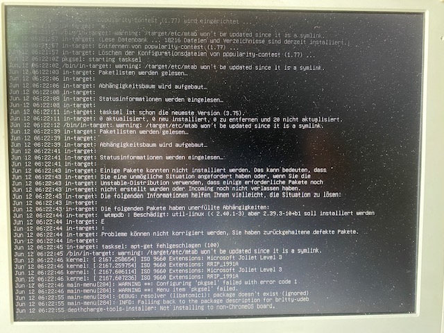

Now I tried to install Debian 12.0 (Date 2024-02-25) on my old iBook 6,7 from 2005. I deleted all partitions with Disk Utility from the 10.5 BootDisk, then I dd'ed it completely. with dd if=/dev/zero of=/dev/disk0 bs=1m count=1
I used the guided install, all went well, until I anted to install the desktop environment and the software. it quits with errors, on my console there were following lines:
Grub, too, couldn't be installed.
So I'm stuck atm. is it due to the 2038 bug that the decencies cannot be resolved?
btw: logs are in English/German.

Grub is broken and it needs to be installed manually. I found out that this guide (intended for macppc gentoo) works great on Debian.
About the missing dependencies… The repositories are broken. I had problems installing stuff because of missing packages a couple months ago too.

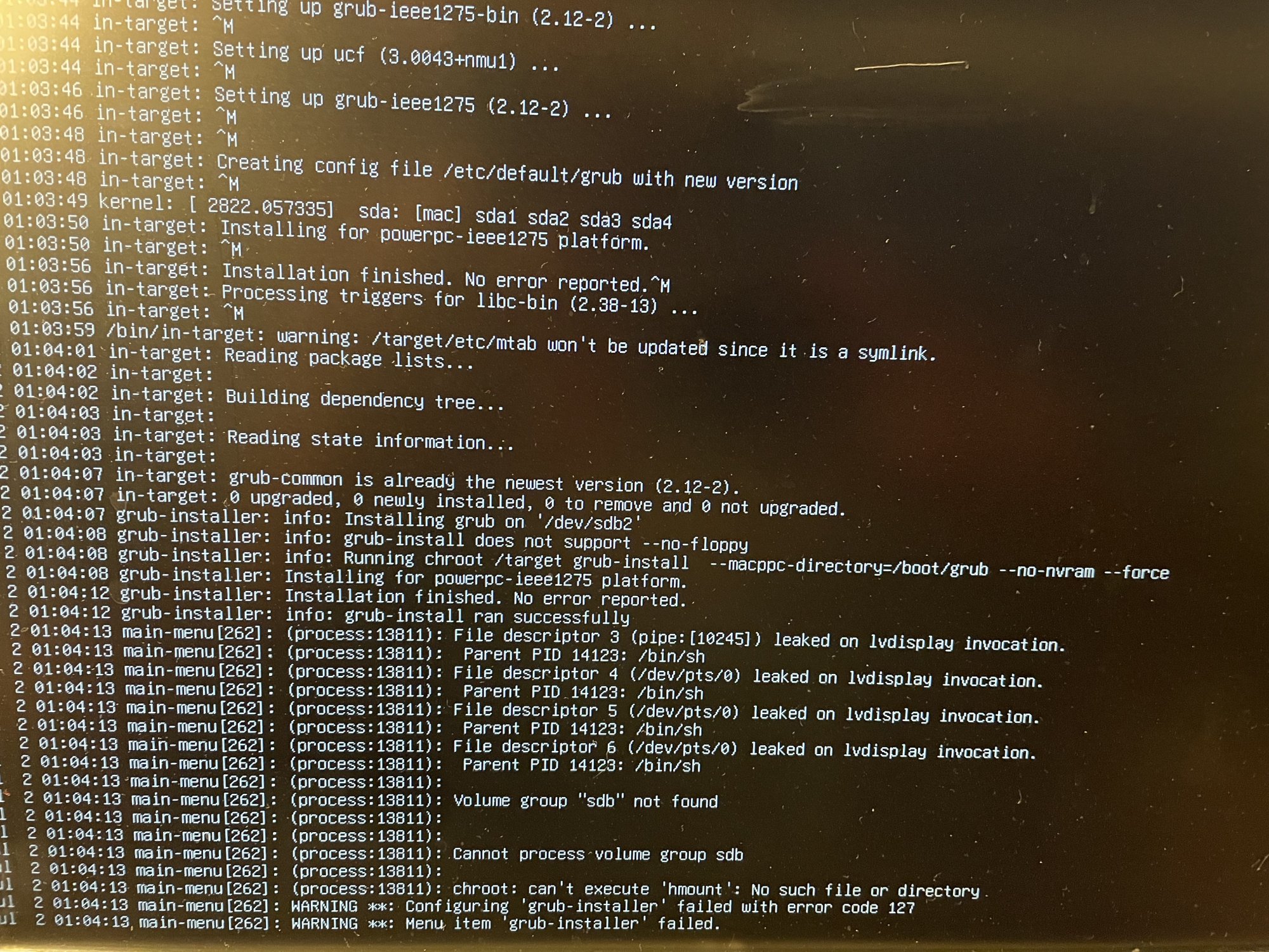

Have tried to install
with no success on a QuickSilver Mac G4, 2 GB RAM, Nvidia GeForce4 MX GPU, 20 GB ATA hard drive.
The following occurs on every attempt, at 15% "Select and Install Software" as shown on tty4
I don't know what to do to resolve this. Also attempting to install the GRUB boot loader results in this:
The hard drive IS sdb, with sdb2 being the /boot/grub partiton with a Boot Flag ON.
And what the heck is "leaked on lvdisplay invocation". Never mind, I'll research that one myself.
The above ISO is supposed to be for a ppc32 Newworld Mac, which my G4 is. This should not be this hard.
I love the line about "grub install does not support --no-floppy"
MacMav
