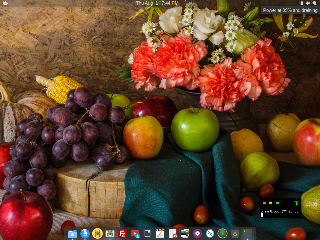

I have done it, but it is still not detected. The only way to be able to monitor the battery is to read the "/proc/pmu/battery_0" file. So I am writing a simple script to display the battery percentage based on the contents of that file.
You are using a battery plugin, like xfce4-battery-plugin, right?
In any case, we can append this script to the battery sector as a fallback.
Good luck. 🙂
Reactions: juancarlosonetti
Good luck. 🙂
I don't use XFCE, so I am not using the xfce4-battery-plugin specifically. But upower detects no battery, and powertop does not either. This happens with multiple kernel versions. So I think I'm SOL here.
Download the file below, then install the dependencies (detailed in the README), make the script executable and move it to /usr/local/bin, then create battery.desktop with this code:
Code:
[Desktop Entry]
Name=Battery Applet
Comment=Mac Battery Applet
Exec=/usr/local/bin/.mac-battery-applet.pl
Icon=
Terminal=false
Type=Application
NotShowIn=KDE;
Name[en_US]=Battery Applet
Save then store this desktop file in /etc/xdg/autostart/. Reboot. Boom. it should work for any distro with GTK2.

No Battery Indicators
Running on a portable? You may notice there's no way to check the battery status in the OS. That is, until now.
Code:
1. sudo nano /etc/modules
2. Add:
pmu-battery
3. Ctrl + X ---> Y ---> Return
4. sudo reboot
Code:
[Desktop Entry]
Name=Battery Applet
Icon=
Terminal=false
Type=Application
NotShowIn=KDE;
Didn't see this until today. Thank you! Another question: That Arctic Fox icon is very nice. Is there any place in which I can find a copy?
I installed Arctic Fox using the Fienix repo, so it comes with the icon itself. If you installed AF using the tarball, and if you look in the AF directory, you can find the icon in one of the folders. You'll just need to edit/create a .desktop file to show it. If the icon you find is different, then it must be that the Deepin icon theme (deepin-icon-theme, the one I use) has that particular icon within the theme.
Thanks again!
