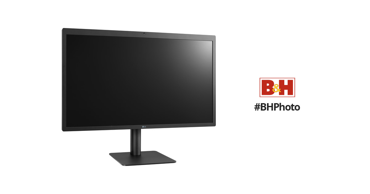

Happy to help. If it's within your budget (~$1300), and your Mac is new enough to drive it, I believe the best-performing option (other than the super-expensive 6k Apple Pro display) is the 27" 5k LG. I've not used it myself but, in addition to being retina resolution, I believe it has the same panel used on the 27" iMac. Essentially, if you like how Catalina looks on a 27" iMac, then you should like this as well, since the two should look the same (unless there are calibration differences, which you can adjust yourself).
Apple actually sells this on their website, but it can also be obtained from other sources, like B&H photo:

That's an extremely expensive budget :/ I've been a PC gamer all my life and I've never spent so much on a screen.
Yup. The Ultrafine is quite pricey, IMO.
