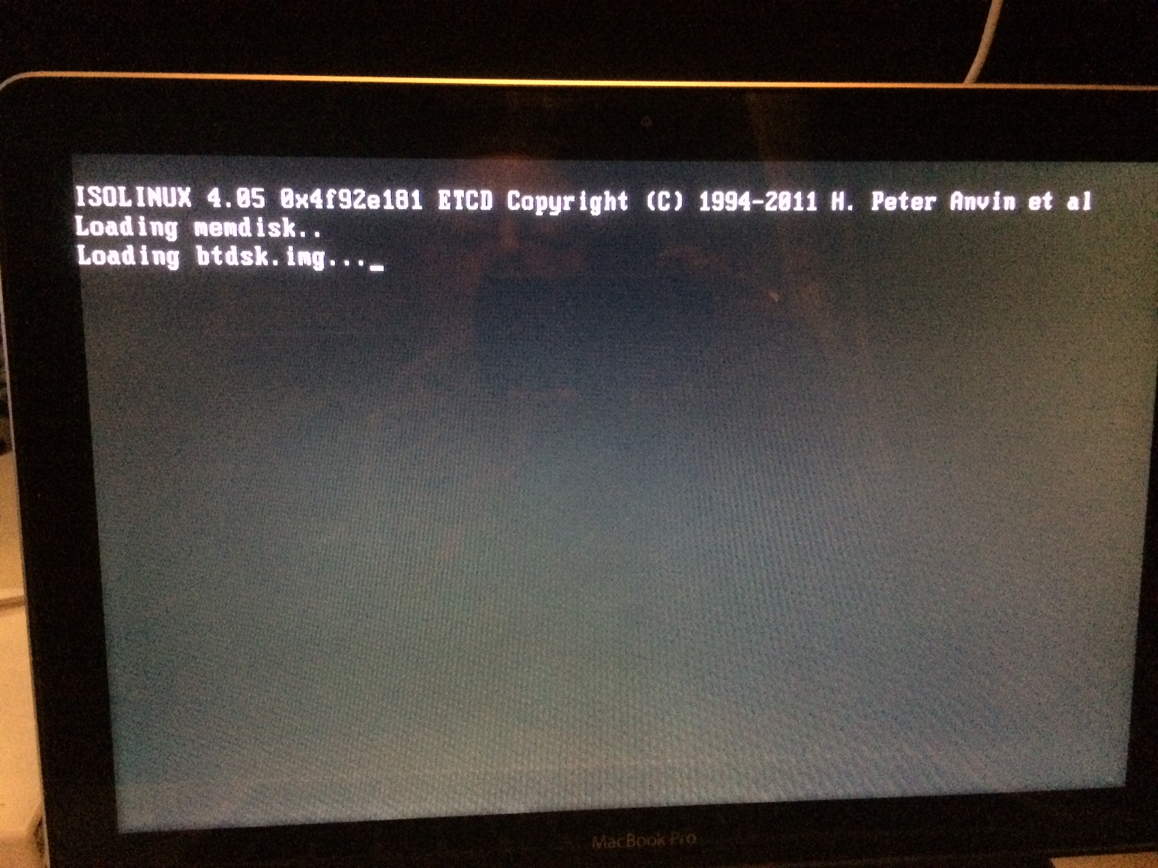

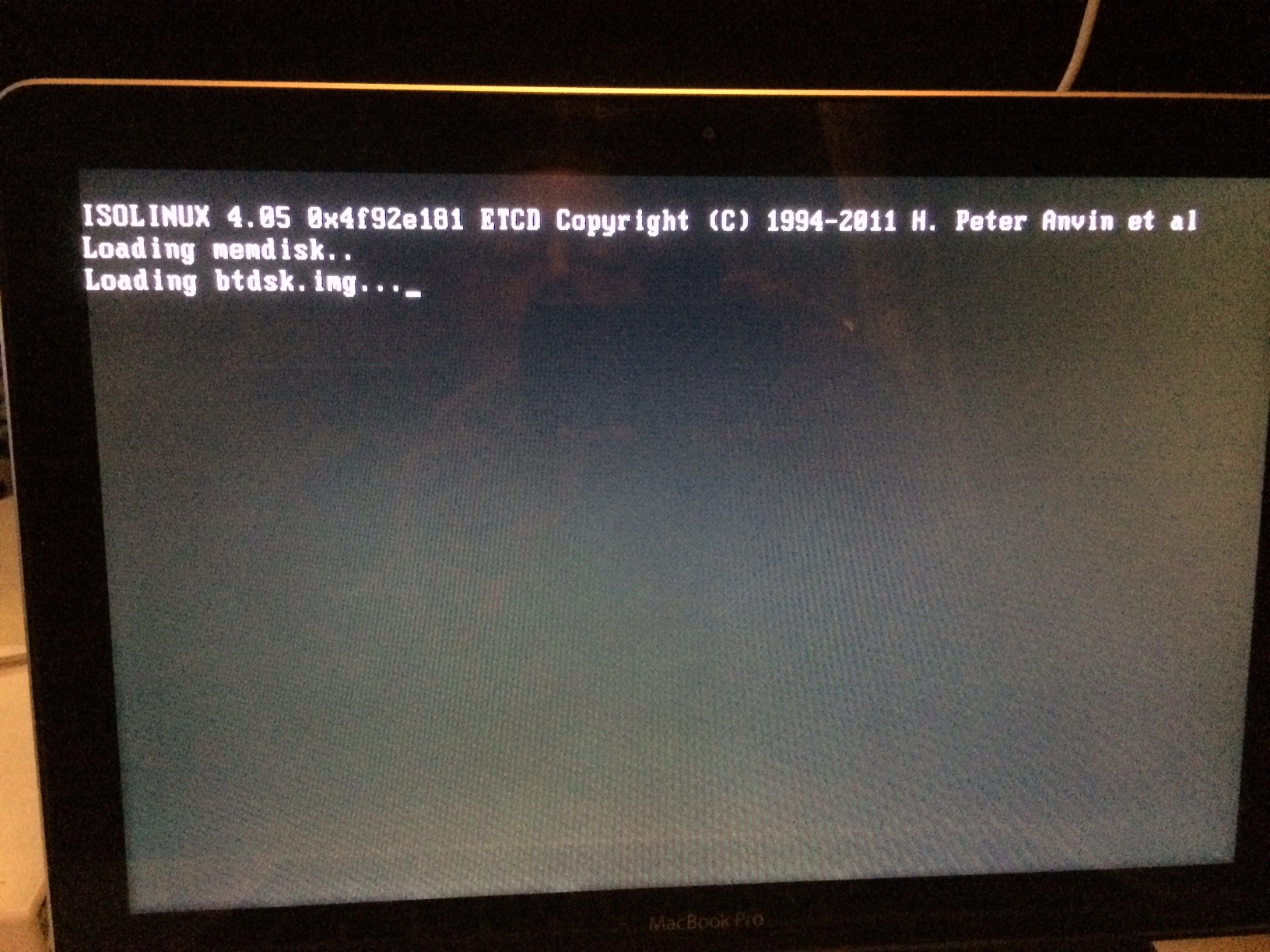

Are you able to burn the Samsung DOS boot CD from the downloaded file using the Disk Utility program?
I burned two DVD's with Disk Utility, one was a ISO and the other with a converted ISO to DMG.
Both of the dvd's only booted up to the attached "screenshot" below. It says loading Btdsk.img and stops there 🙁
Any clues?

So I wonder if the problem is using the original internally installed SuperDrive in a external CD/DVD case is the problem.
Would finding another generic external CD/DVD drive allow me to update/install the EVO Performance Fix? or is the problem my Early 2011 13" Macbook Pro..?
Any clues, IAN

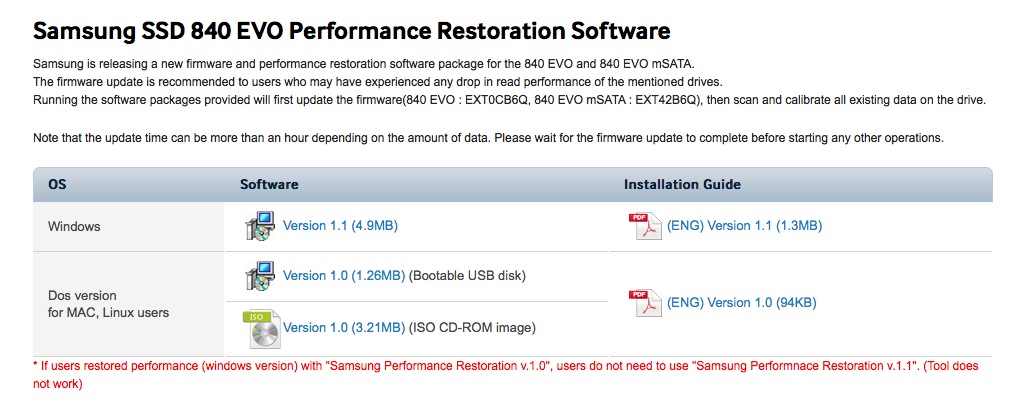

So can I open up the MB Pro, and take the SSD out and connect it to a Windows laptop (via a SATA/USB connector) and use the Samsung ISO to update it that way?
So which ISO would I burn, I attached the Samsung download page below.
Thanks for any reply. IAN.

If its a windows laptop that can see the ssd, install this
