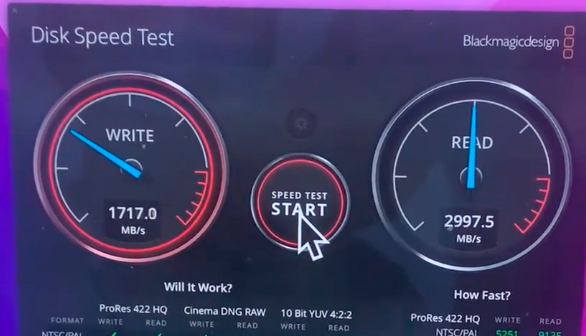

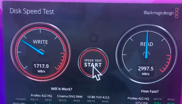

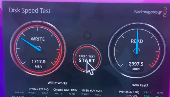

When paired with a M2 Macbook air, the ASM4242 write performance with the SN850x is abysmal.
A good breakdown on the state of USB4

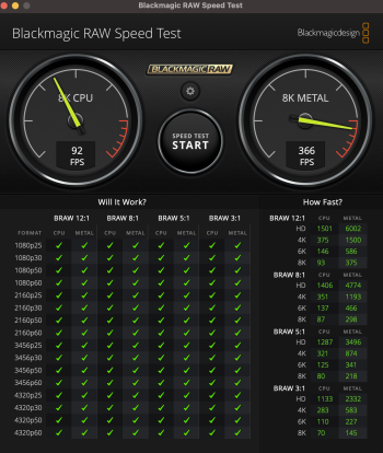

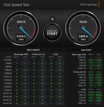

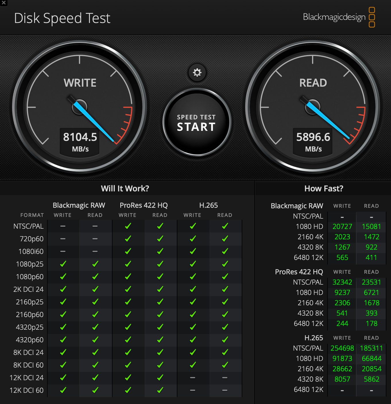

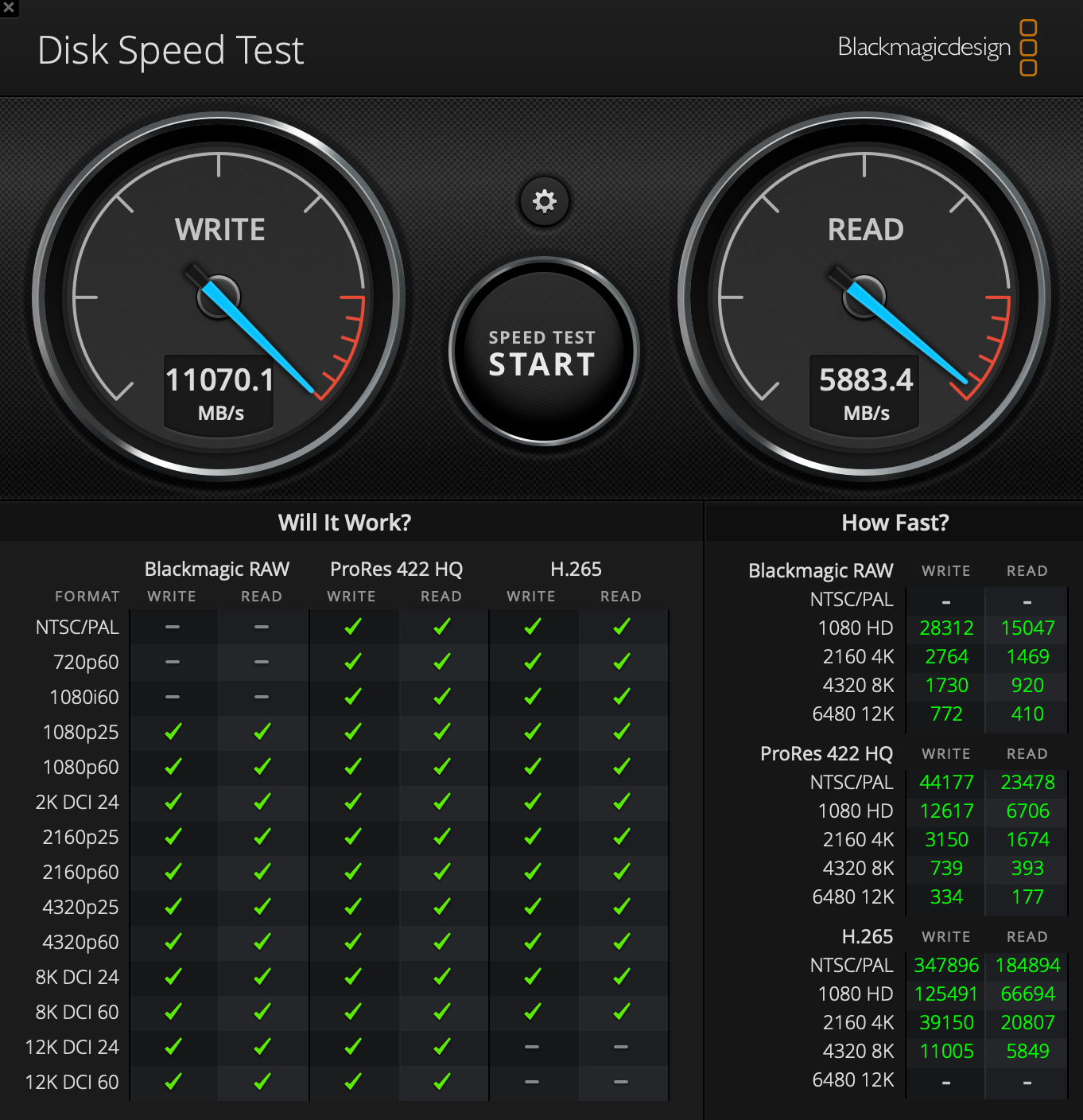

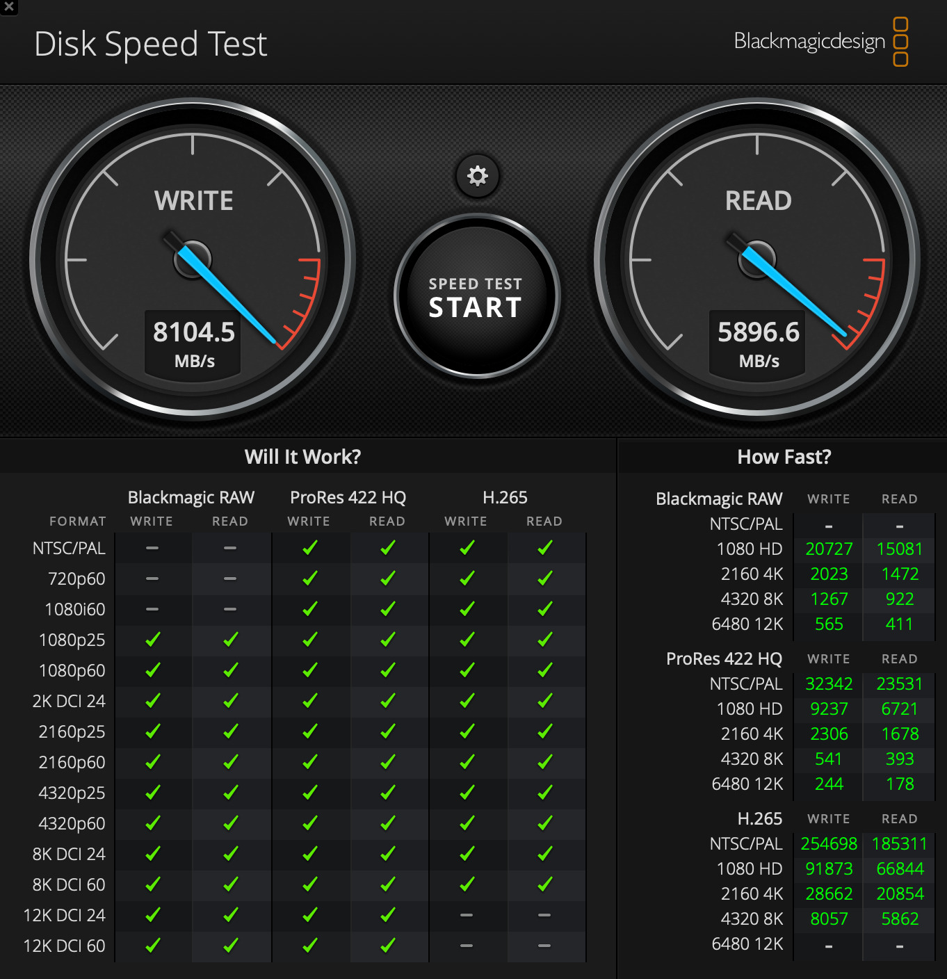

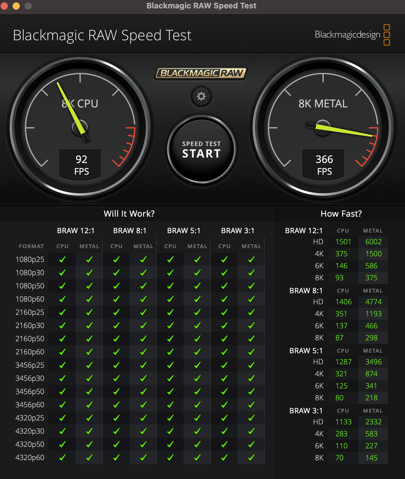

I have 4 Thunderblades in Raid0 connected each of them to a Thunderbolt4 Port of my Mac Studio M2 Ultra and I'm getting 11.600 Mb/s WRITE & 5.800 Mb/s READ. Crazy!

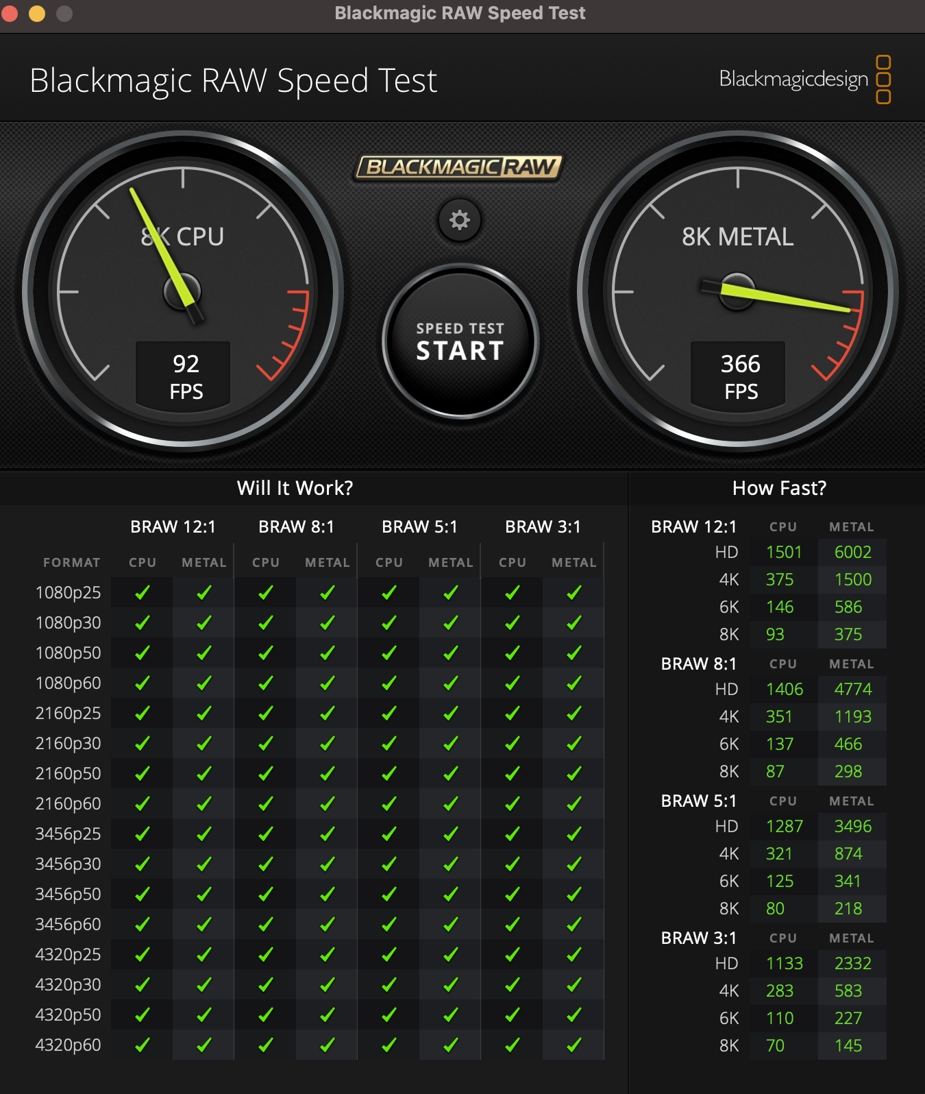

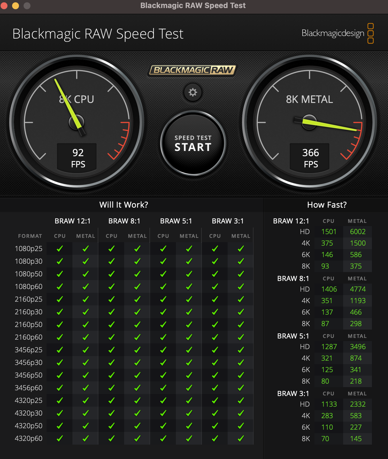

To compare with the internal 8tb of the Mac Studio I attach results and also 8k RAW FPS.
My model is the maxed out M2 Mac Studio with 192gb RAM, 24-core CPU, 76-core GPU.
Great speed, but your one drive away from a total data loss. Read speeds seem much lower than they should be. What drives are you using?

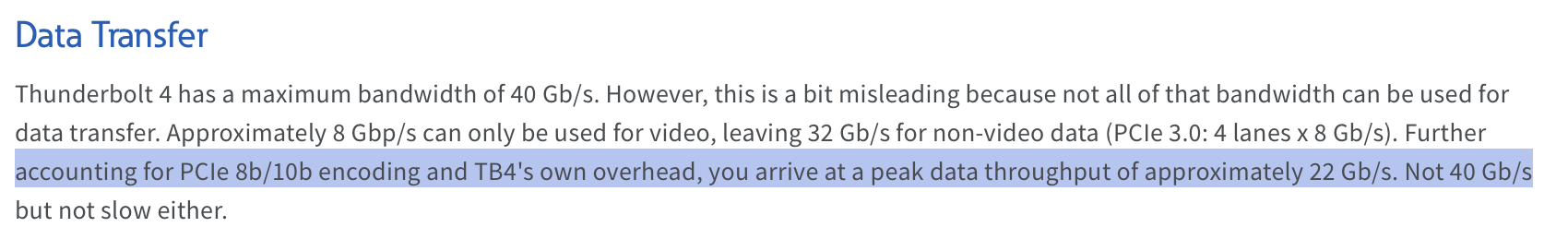

As you can see, data bandwidth is capped at 22 Gb/s or 2750 MB/s in all configurations.
I understand TB4 allows PCIe tunnelling with rates up to 32 Gbps. The TB4 SSD enclosures that use the Intel TB4 chips use PCIe tunnelling.
Is there a specification you can reference?
I believe the 32 Gbps and the 22 Gbps are the same thing, where the former is raw bandwidth, and the latter is actual data transfer speeds:
From: https://tripplite.eaton.com/products/thunderbolt-4
oh. i was looking into getting the ASM2424 for my SN850X (or maybe the 980 Pro i have in a TB3 enclosure) but this looks worse than the now 5 year old TB3 enclosure i already have.
I tried the SN850X in the TB3 enclosure, and it got consistent 2.5-2.7 both R/W.

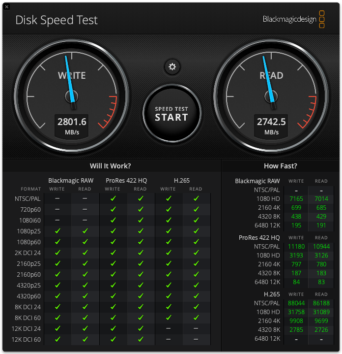

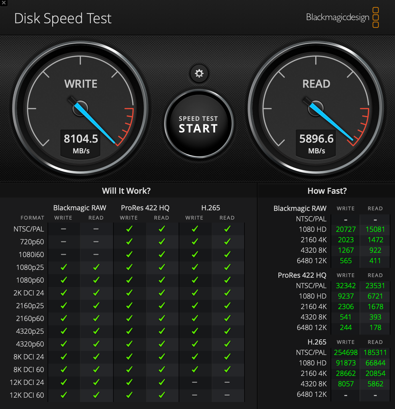

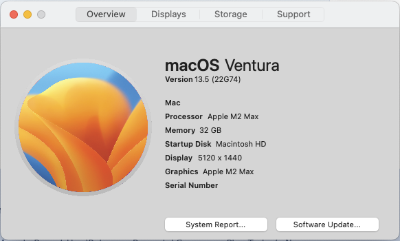

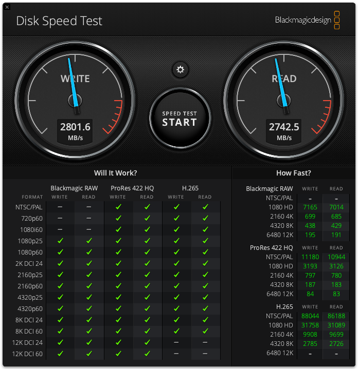

Bought this.
Put a Samsung 990 Pro 2Tb drive in it and plugged it into one of the ports on the back of my M1 Mac Studio Ultra.
This is what I get.
That's alright isn't it?

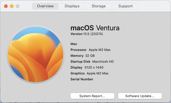

I ordered 2 of these last night to work with my M2 Max Studio

unless you have it in raid over multiple TB4 ports, the maximum you can achieve with a single TB4 cable is 3000mbs
Bought this.
This is what I get.

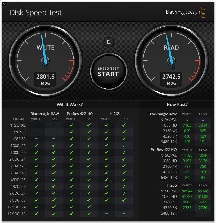

I've got two of these with 980 pro 2TB. One I use for TM, one for storage.
I updated the firmware on my Studio Display months ago with the drive plugged in (to the Studio, not the display), and it bricked the drive case.
The 980 in another case was fine. Maybe a coincidence ? I'll never update firmware again without unplugging first.
