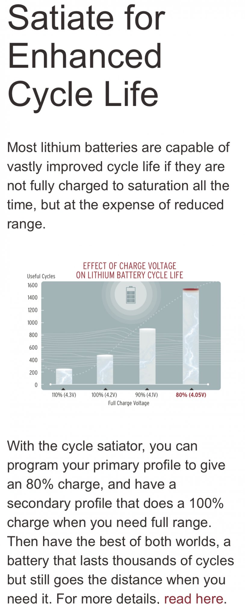

One interesting graph about an unrelated product but related to the subject and this was actually what I was planning to do, only via automations and I believe I did it now.
