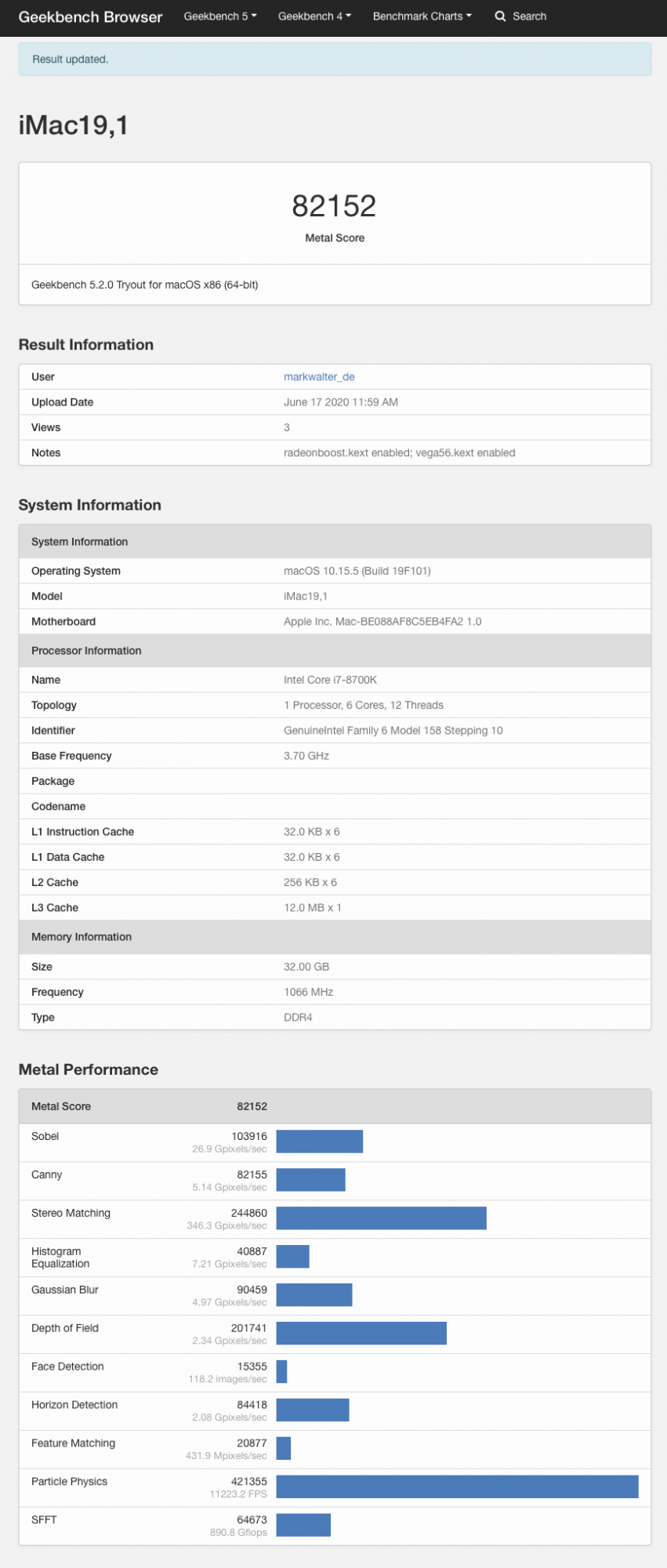

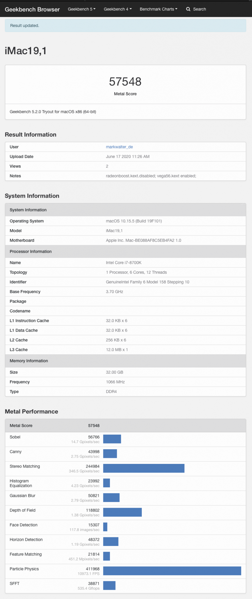

Now this is where my RadeonBoost Kext comes in. It makes sure that SMU firmware is loaded again, removing the memory bandwidth limitations, making sure the GPU can be used to its fullest potential. The results really speak for themselves.
Radeon VII Geekbench Metal (1st with Radeon Boost, 2nd without)
View attachment 906795View attachment 906796
Radeon VII Geekbench OpenCL (1st with Radeon Boost, 2nd without)
View attachment 906797View attachment 906798

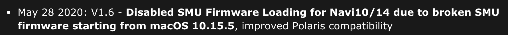

  • May 28 2020: V1.6 - Disabled SMU Firmware Loading for Navi10/14 due to broken SMU firmware starting from macOS 10.15.5, improved Polaris compatibility

I want to see if I understand the functioning of a Radeon VII with RadeonBoost v1.6 and Catalina 15.5.
With the latest release of Catalina, RadeonBoost v1.6 disables SMU Firmware loading for the Radeon VII . This means that the Radeon VII will have poorer performance under Catalina 15.5 + RadeonBoost v1.6, then if the Radeon VII were run under Mojave with RadeonBoost v1.4. If true, this implies that Catalina 15.5 is a step down in performance for a Radeon VII?
And no matter whether a Radeon VII is used under Mojave or Catalina, WEG is not necessary? Is WEG discouraged under these conditions?
Thanks for your input.
No. Where did you read that?!

Hi Chris,
I have a question. When I shared my result with the radeonboost.kext in the tonymac forum, the TO couldn't explain why my geekbench metal scores are so high. I score 82000 with the radeonboost.kext enabled and 57000 without it. They said that 57000 with a vega 56 card was good anyway, but 82000 is really astonishing. Maybe you can help me to clear things up? After all, it's just a synthetic benchmark. (By the way, when I boot with OC and the radeonboost.kext enabled, there is very little difference to if I disable it)
ATB Mark
