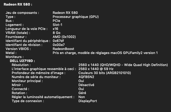

I make new test with 1.5 and OC 0,57 NBK from @h9826790
Then
Lilu.kext 1.4.3 (but test with 1.4.4 same freeze and auto-reboot)
WhateverGreen.kext 1.3.8 (but test with 1.3.9 same freeze and auto-reboot)
It start and RadeonBoost enable

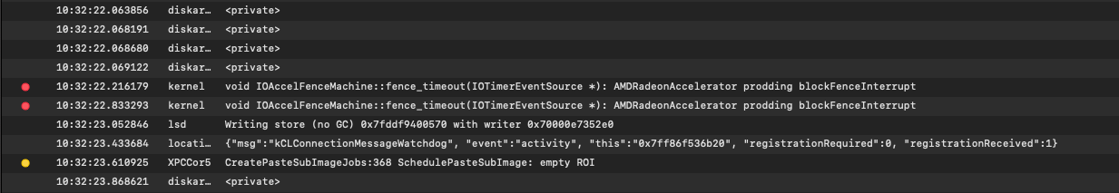

I have still freeze and auto-reboot cMP with RadeonBoost installed
and I have these error in console
@CMMChris
Then
