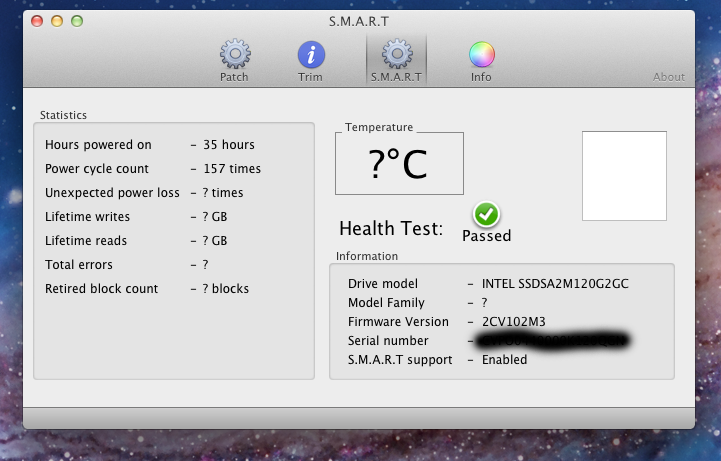

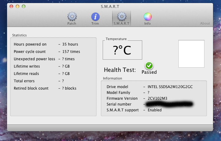

need to rework alot of stuff that is either not working or solution is ugly as hell.
some features can be tested as of now:
http://cindori.se/ssdutility/SSDUtility.zip
Notes:
  • "Enable Trim" button does not enable trim, it creates a patched version of your current driver at the desktop. you can install it with Kext Helper to verify it's working. *
  • "Disable Trim" button does nothing.
  • The icons for Patch Enabled/Trim enabled are static, ignore them for now
  • Disk name and info for SMART is taken from 1st hard drive, will implement so you can choose between drives
specifically SMART info would be nice if people could test and screenshot
* if you do this in SL, make sure you have Time Machine backup or another install to boot from and restore kext if something go wrong. in Lion, you can just boot the help partition and restore the kext, I'll post instruction when somebody ask
Screenshot
