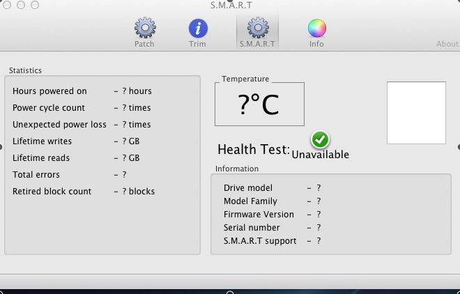

S.m.a.r.t.
Any thoughts on when the next release is coming?
Two SSD M4 RAID0
Work with SMART Utility.
SMART stuff needs rework
