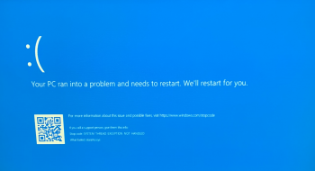

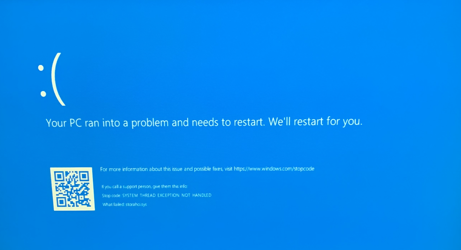

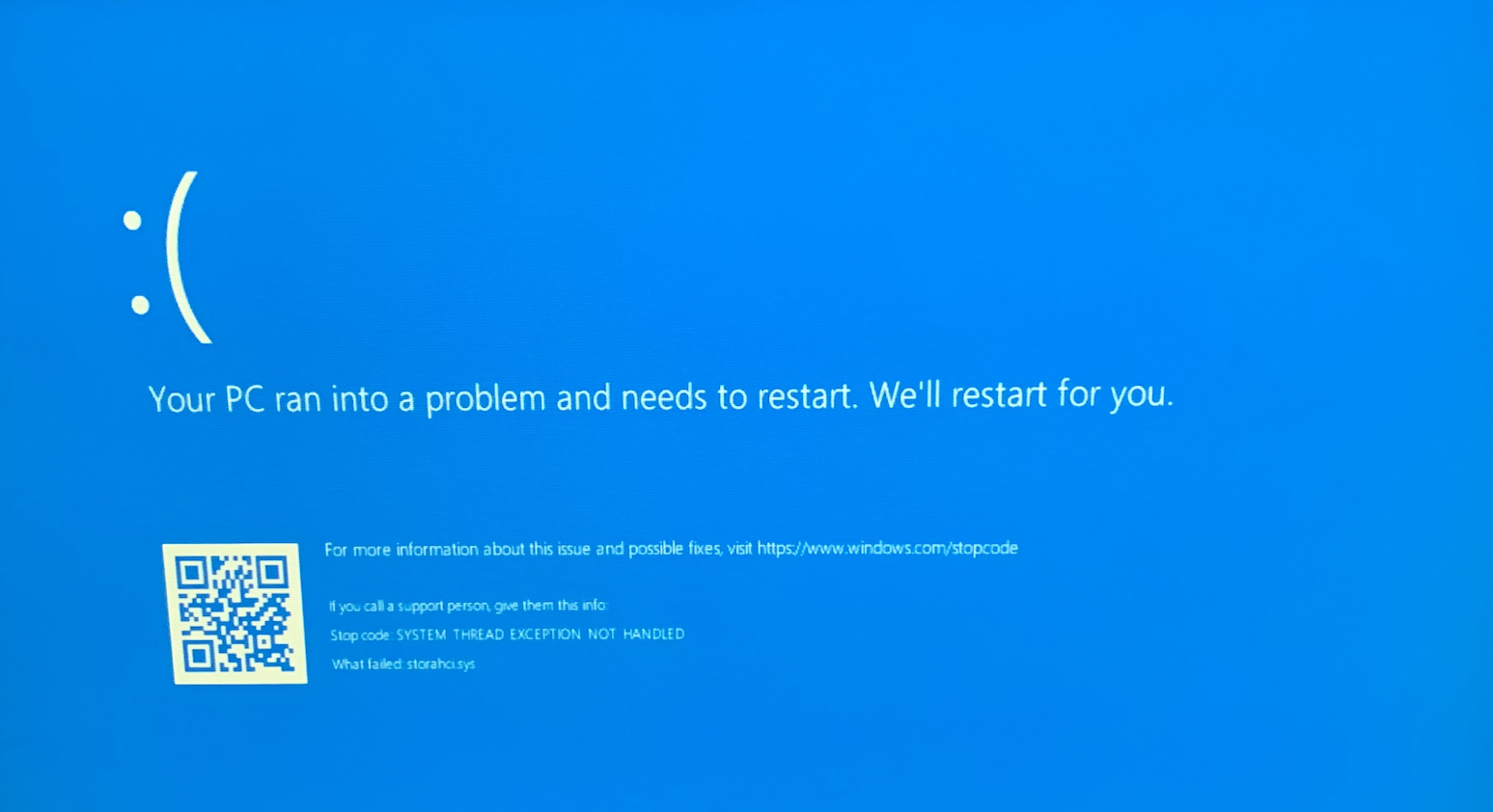

Didn’t work for me – now I get a blue screen with a sad face when attempting to startup Windows 10. :(
I take it there's no easy way to recover from this (see attached screenshot)?
didn't you make a clone image before starting this? I always make a bootable backup or a clone image of my drives before tinkering.
I know I should have, but I didn’t have anything important that I couldn’t lose and it sounded like a relatively straightforward thing to do, so I decided to take the risk. What I will lose is the time it takes recovering, which is bad enough I guess... :-/
Should be possible to reset Windows by starting up in from the recovery environment, right? Maybe I’ll learn a thing or two from this. :D
Edit:
A Windows reset from the recovery environment with "save my settings" made me come back pretty quickly.

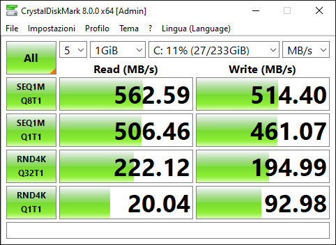

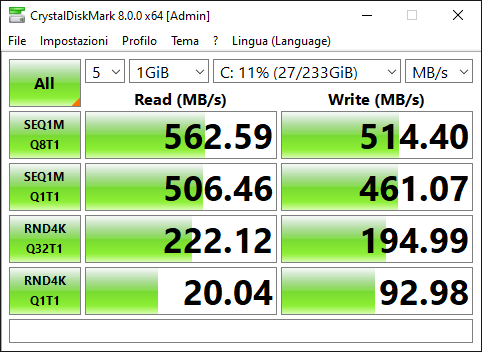

Thank you . Crucial MX500 works better then before (350B\s in ide mode) in Imac 2011 21" with k2100m.
Tested on Windows 10 Home Dic 2020 H2
Reupload patched MBR + BootICE
In Dic 2020 you can: (quick summary for fresh win10 setup)
-Flash fixed mbr
-apply reg fix only in :
iastore avc override (start default is 0) to 0
iastorv override (start default is 0) to 0
storeahci override (start default is 0) to 0
-Unistall from device manager: Intel(R) 6 Series/C200 Series Chipset Family 4 port Serial ATA Storage Controller - 1C00 (can leave driver without delete)
-restart
