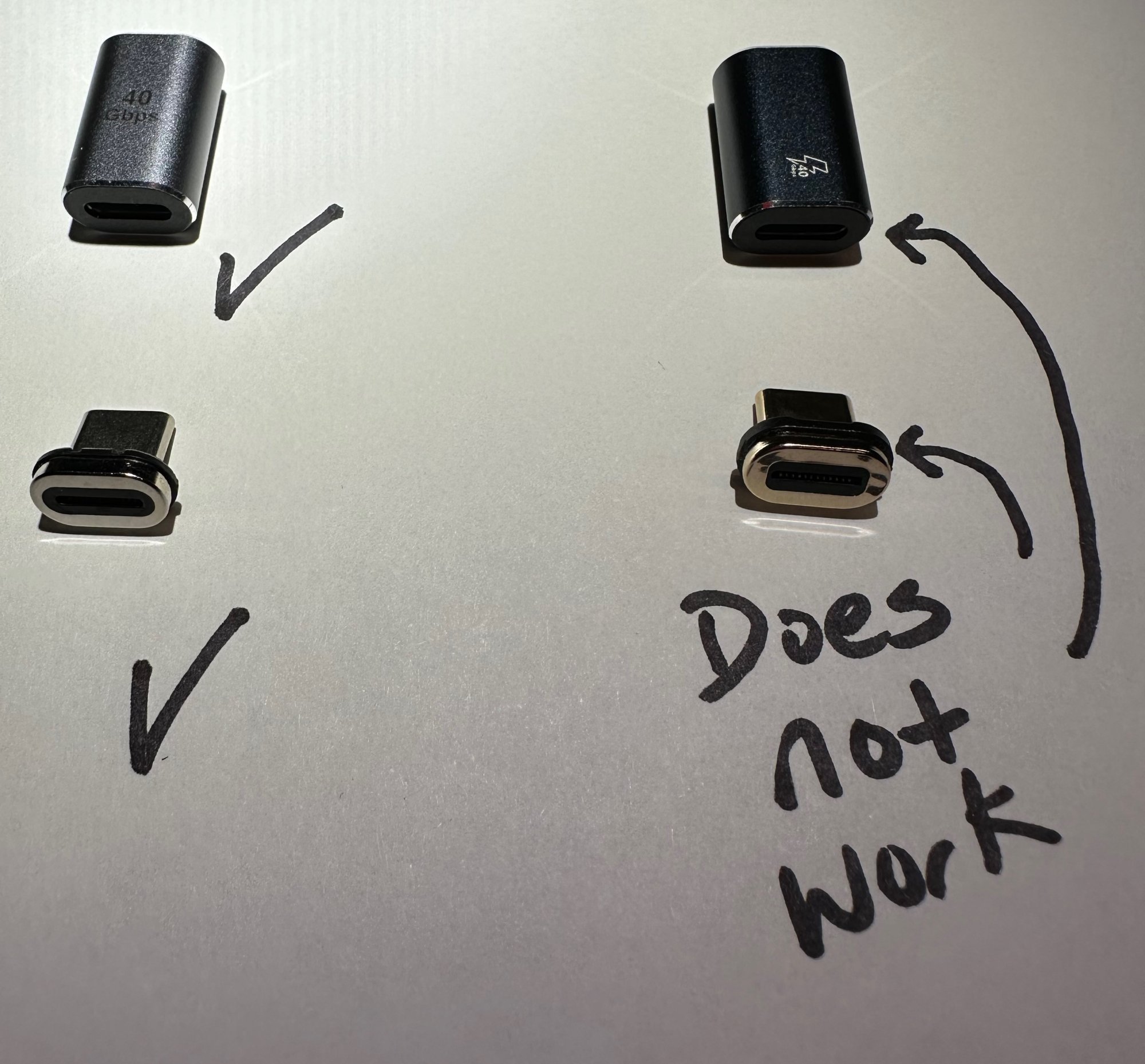

I've got some bad news to report for anyone considering using USB-C magnetic connections to switch between your Studio Display (or Pro Display XDR) and source components. Many people have previously had success using connectors from Amazon, normally about $10 each.
I had ordered from at least two different product listings/sellers in the past. I tried to order from each of the same two sellers/product descriptions I'd used previously, and received a different variation that no longer supports video output to the Studio Display or other USB-C monitors I own.
You'll notice the product itself is different, not just the labeling. The new connector has a different female end (more rectangular vs. oval), and has a gold tint vs. silver.
I sent back one set to Amazon as 'item not described' because well it doesn't work. I ordered a second set via a different listing, and received the same new/non-functional product. I will probably keep this, as I do use these connectors for charging-purposes only, and will keep my "good" old ones specifically for video support. Kinda bummed, but I hope this helps someone.
These are the product pages that previously were working versions, but are now sending the ones on the right (not working):
