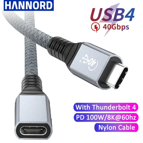

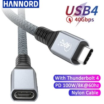

It appears, from the provided photos, that you have a certified USB4 or Thunderbolt 3 or 4 extension cable (male to female) connected to your ASD, that then connects, depending on your usage scenario (personal, WFH) to either of the 2 Thunderbolt cables shown. Given that Thunderbolt extension cables are not supported by the applicable specs, I am wondering about 2 aspects of your solution/setup:
What is the brand of the USB 4 extension cable that you are using?Related, where did you obtain the cable?
Second, given reported, elsewhere, connectivity issues when using extension cables with Thunderbolt connections, is your setup continuing to function smoothly?
Thanks.

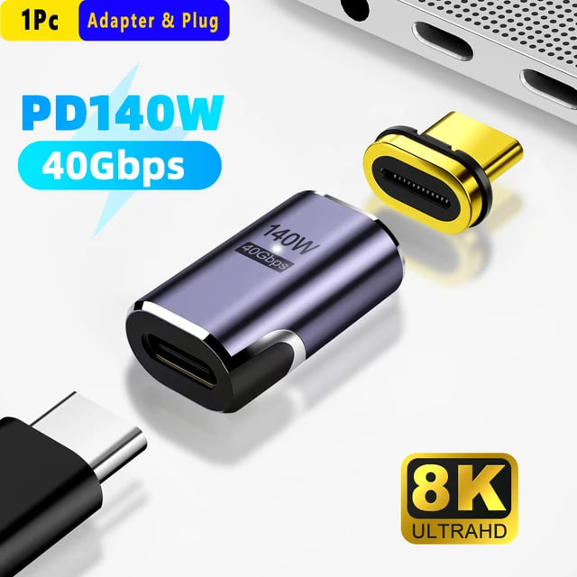

And I came up with an idea: still switch different computers to Studio Display manually, but using Type-C magnetic adapters, so as not to spoil the Thunderbolt port on Studio Display and simplify/speed up the switching process
In my case, this will not be something very annoying, because... 90-95% of the time I will use a macOS/Windows laptop from my employer. A cable will be plugged into each computer (Thunderbolt cable from Apple to the laptop and WJESOG/Belkin to the desktop Windows-PC). Each cable on the Type-C connector will have a magnetic adapter, in the Studio Display there will be a plug sticking out - one cable is magnetized, and the second is magnetized
UPD2: on the forums people write that magnetic mounts do not comply with USB specifications and can be dangerous - then I can use an Type-C - Type-C (male/female) extension cable that will be inserted into the monitor and into which computers will be plugged in turn, so as not to damage the TB/USB ports in monitor, laptop and PC
Do you think this is a normal idea?
