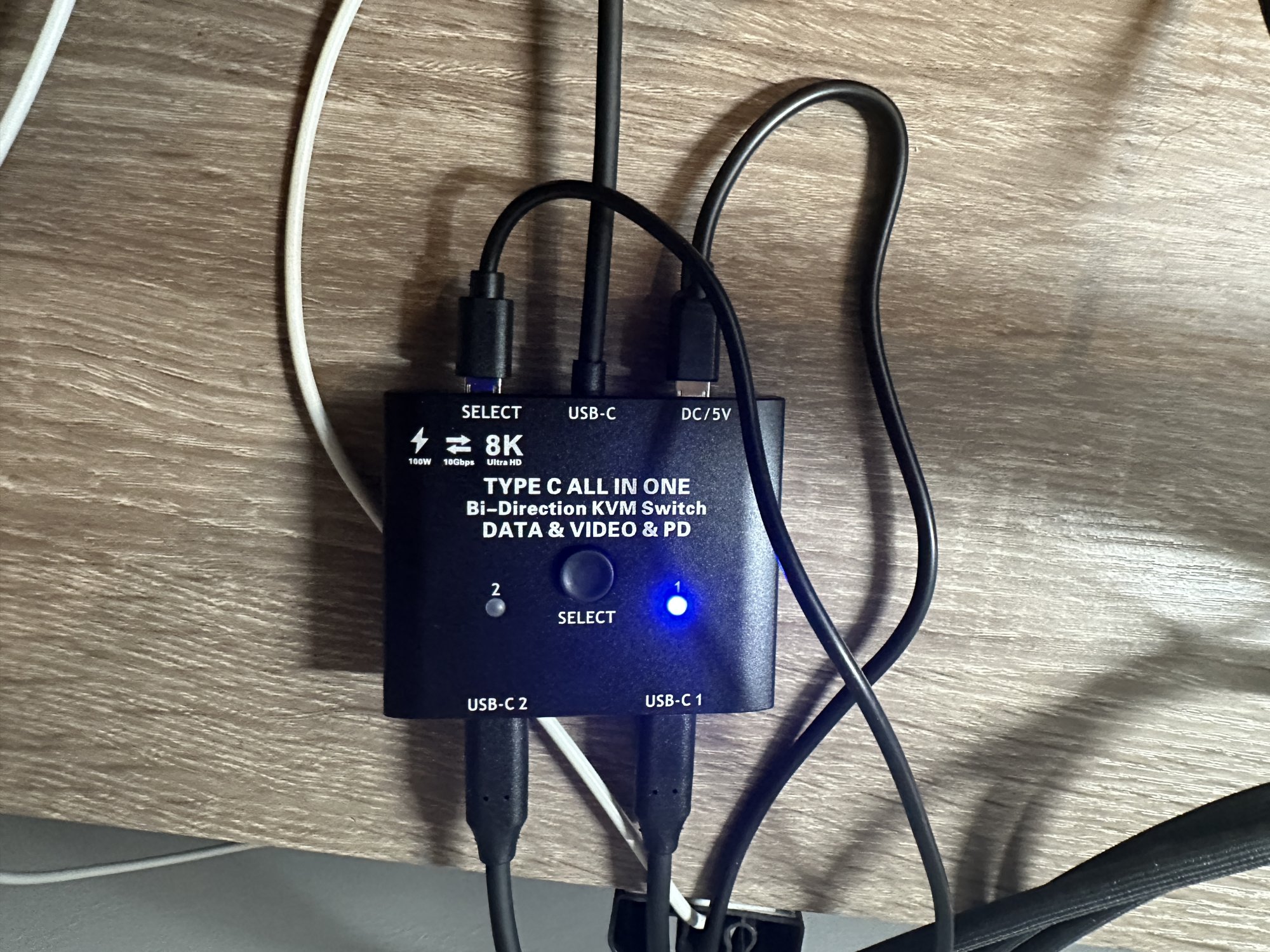

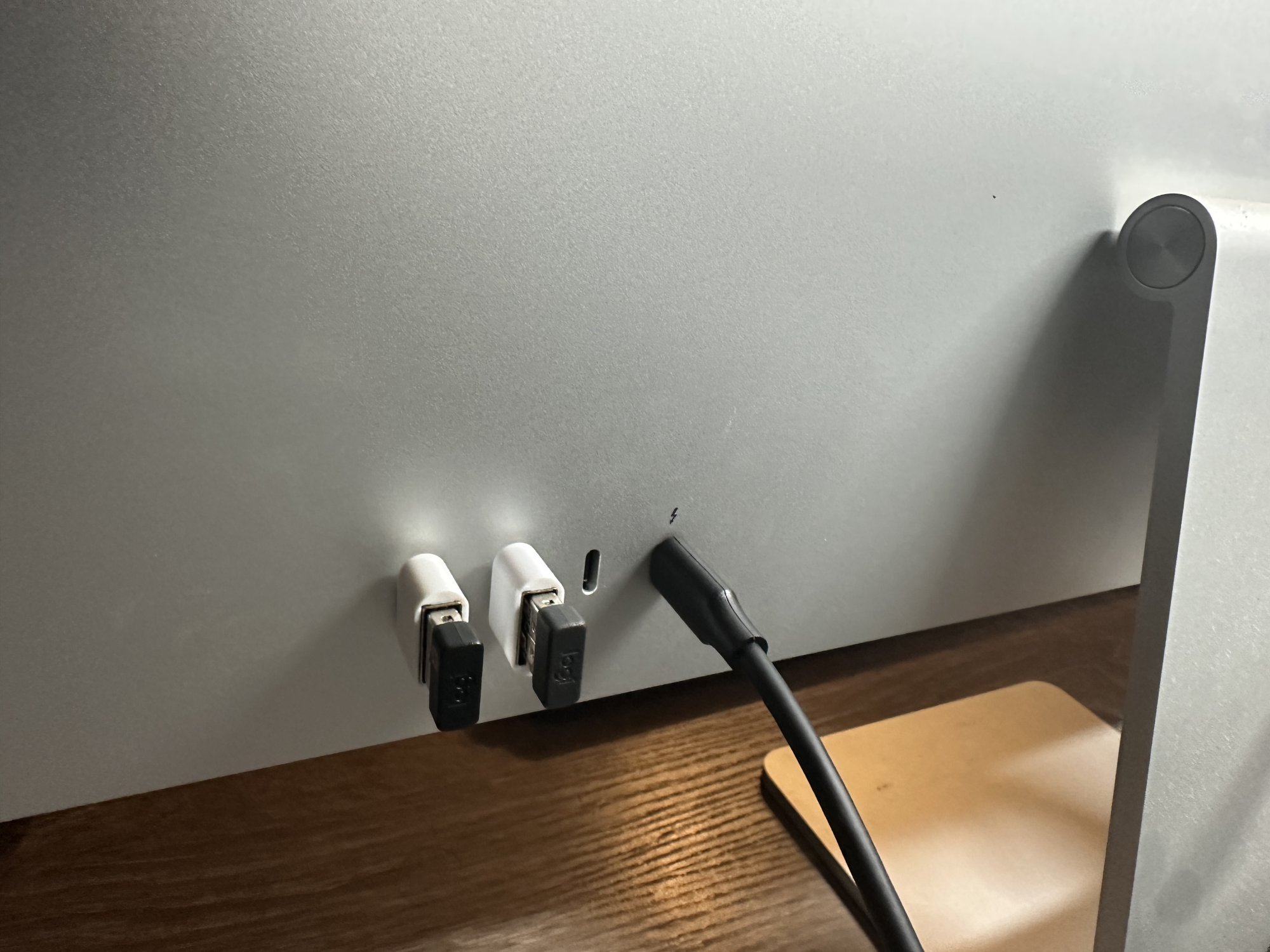

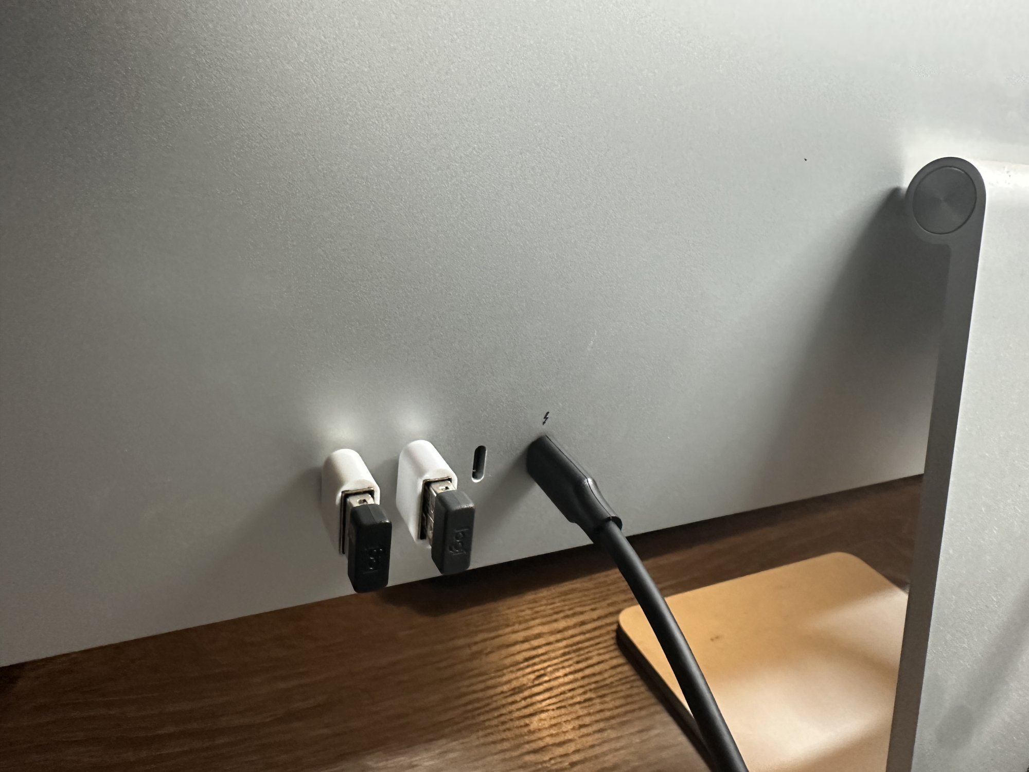

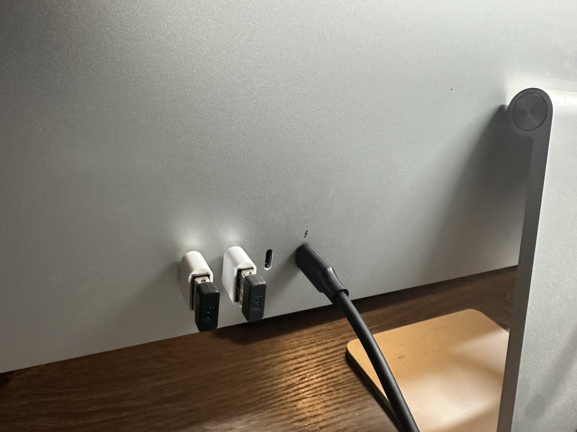

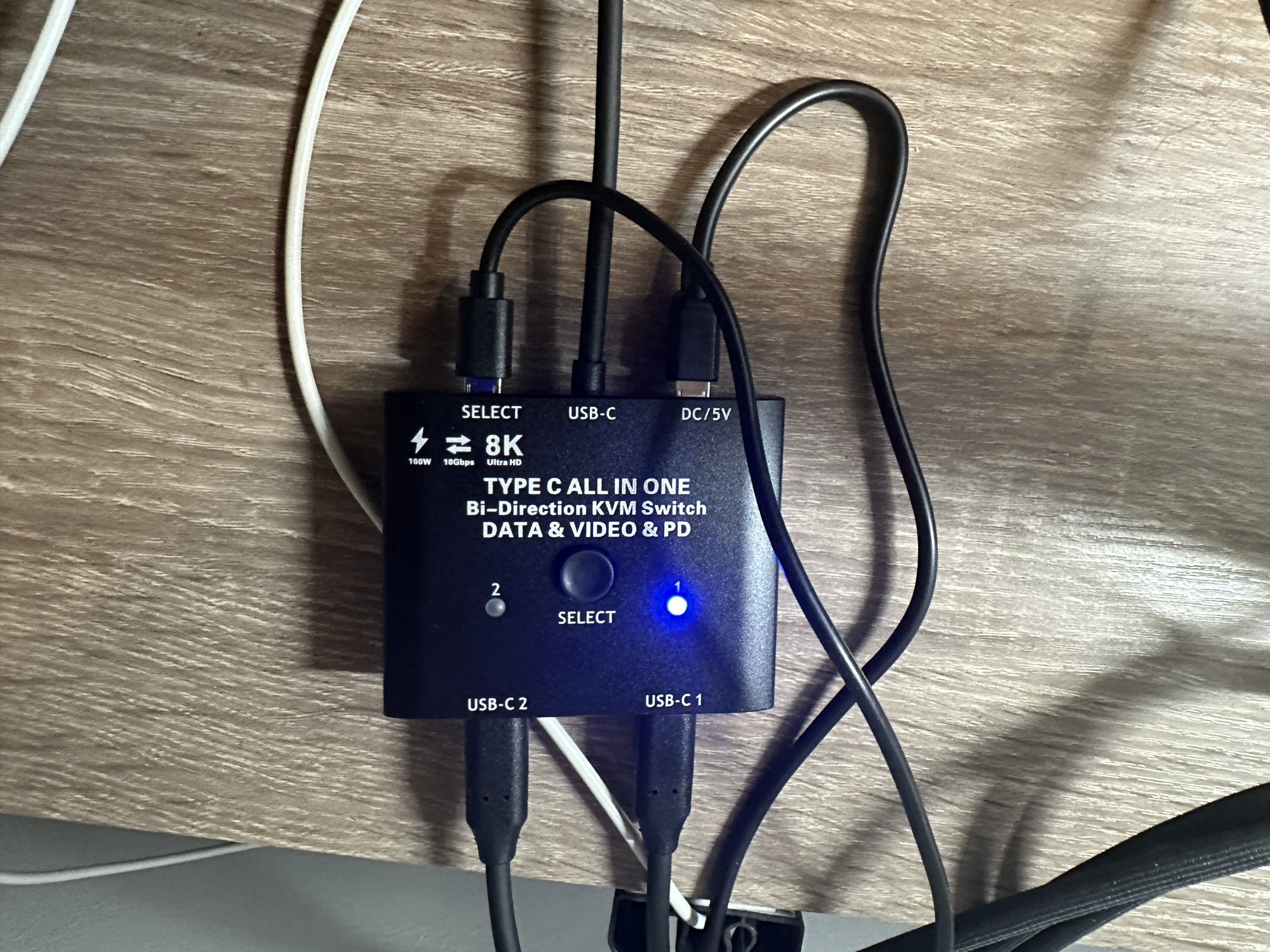

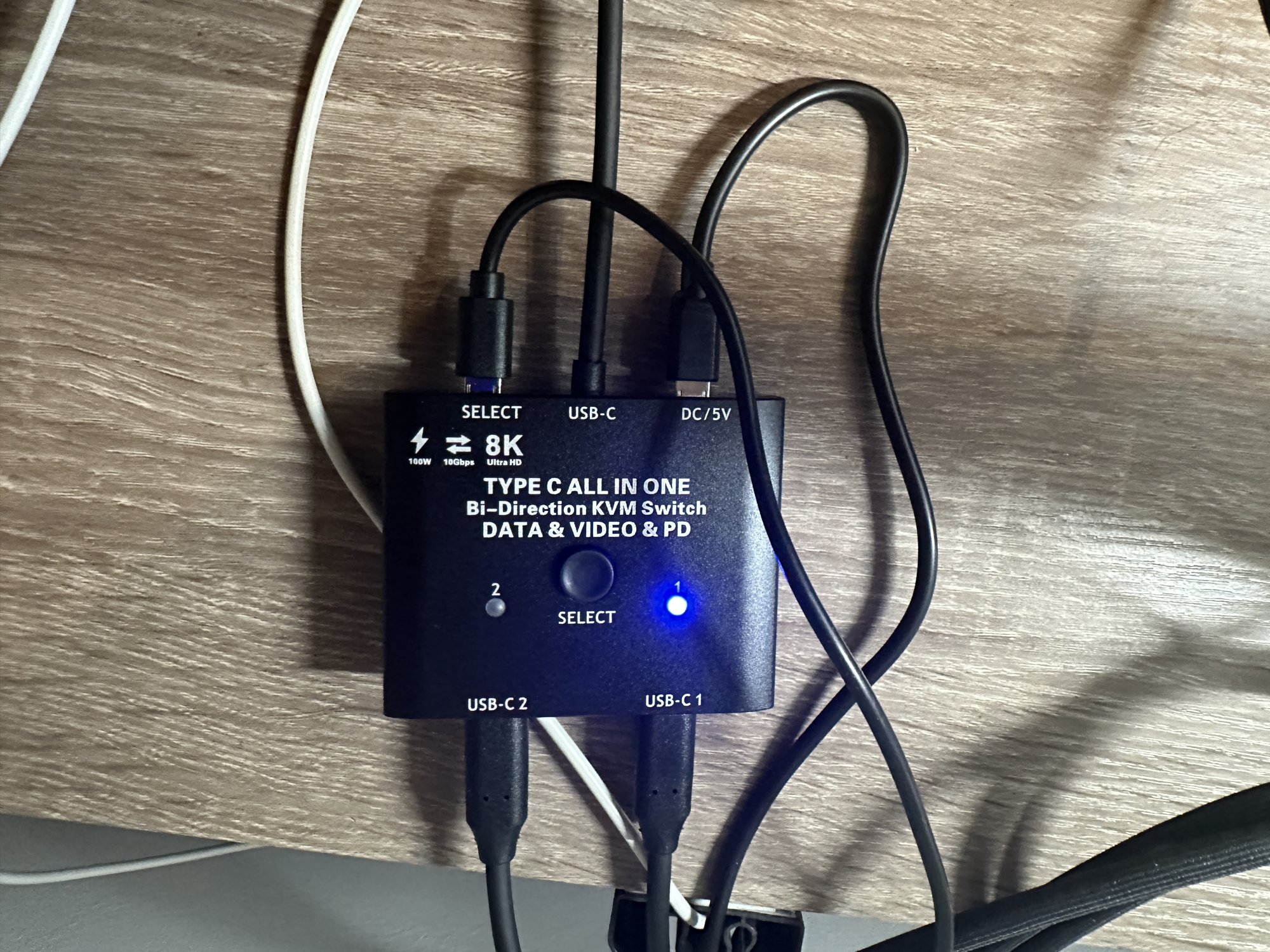

First, this is my current setup: an Apple Studio Display at home with my personal MBP and a work MBP. I wanted to switch with one button the ASP from personal to office MBP. I also have a logi MX Keys keyboard (not the S model, more later) and a logi MX Master 3S mouse. So, very similar to what everyone is trying to acomplish here.
I ended up buying the Type C All In One Bi-Directional KVM Switch Data & Video & PD, C201 model (https://es.aliexpress.com/item/1005...t_main.23.7dec194dylddIM&gatewayAdapt=glo2esp) and it works. Sometimes.
After seting up everything, including changing the position of cables (to ASP or to a Mac) and only using the provided cables, I had a kind of working setup. My only problem is that to change from MB1 to MB2 sometimes the screen goes black and I have to try the process again (re-click) for a couple of times in order to get it to work. But when it works, it really does: ASD camera and USB ports are fully functional (the keyboard and the mouse requierd 2 differents usb receivers).
I’ll be testing the setup for a couple of weeks. If you have any ideas to try, I’ll be happy to test.
Se the attached video/img for reference
