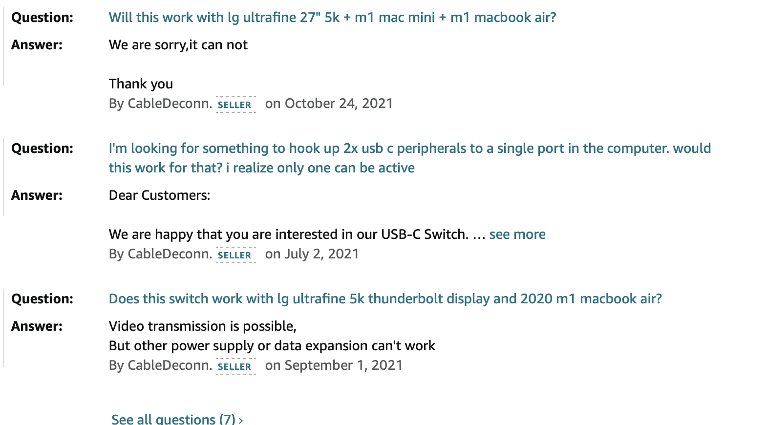

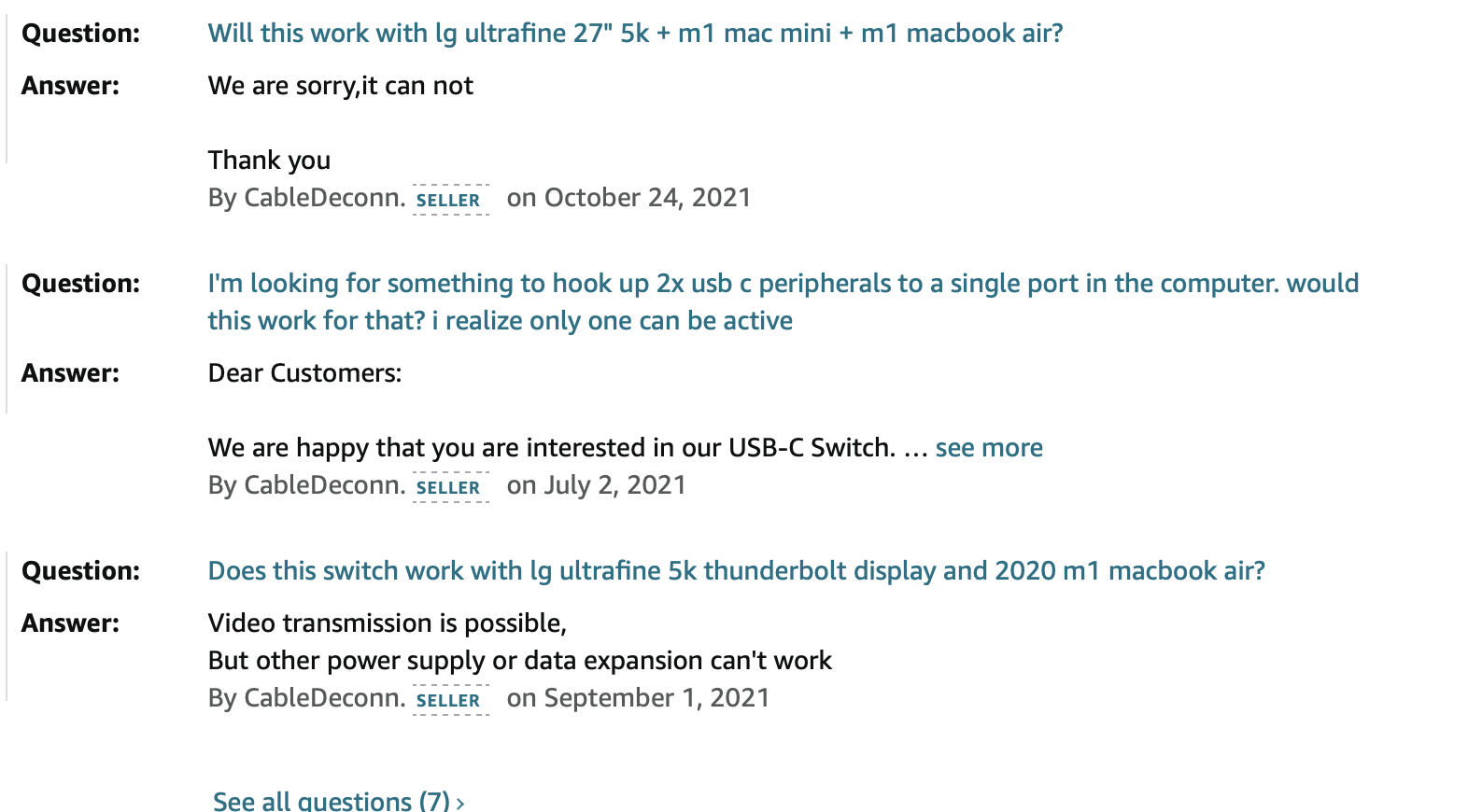

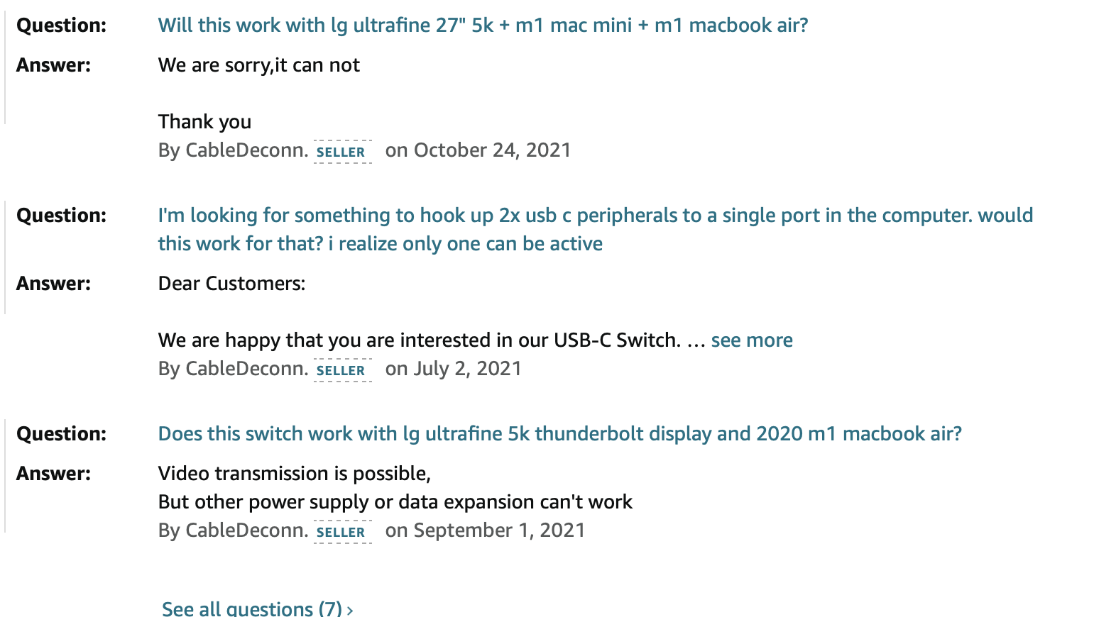

I found two answers in the Q&A on Amazon that make it seem this will not be ideal. See first and last questions:
I saw this too, which turned me off from it, despite Ars Technica (I think) mentioning that the Studio Display worked just fine via a USB C 2.1 cable that supports 10 GBPS. I think it all boils down to the interface using Display Port 1.4 at the end of the day. The extra throughput then allows the connections on the back of the monitor to be used for, well, higher throughput things. So it all depends upon people's use cases.
Now the question is, who wants to test out this switch to see if it works knowing that the monitor allegedly does just fine with a USB C 2.1 10 GBPS connection, lol.
For some reason, I'm getting the vibe that the seller says "no" mainly because they haven't tried it/confirmed it will work with that exact use case.
If no one here has any direct experience, I might just have to order one myself...
Unfortunately, some of the reports from buyers in the reviews show they tried it with the ultrafine and it didn't work. With both the sellers and buyers reporting it doesn't work I think we can be pretty certain it doesn't. :(
Ah. But I wonder, "why"?

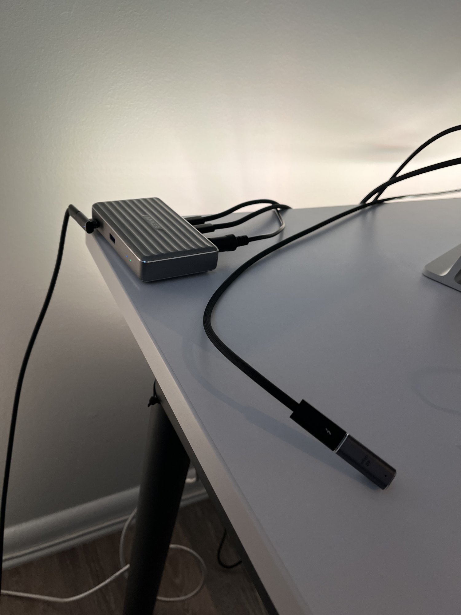

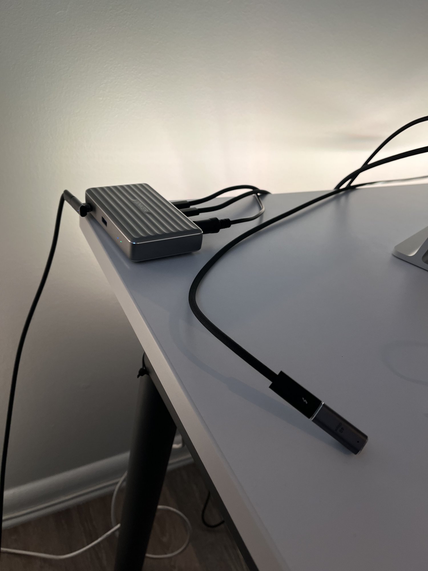

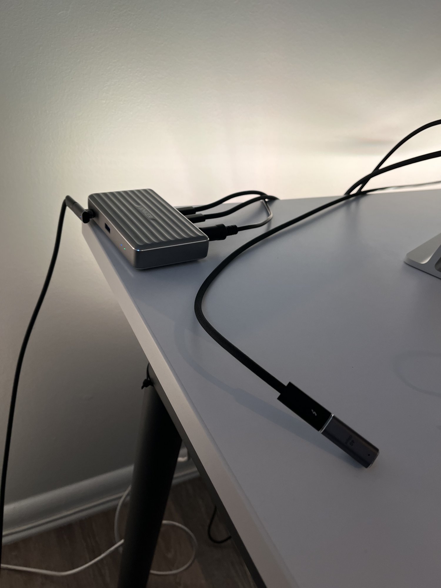

I intend on mounting this Anker hub under my desk with some hefty double sided tape once I get everything set up. Once mounted, I'll be able to do the switch between work and home with minimal effort and it’ll look nice and neat. Right now work is plugged in (MacBook Pro will live elsewhere than the desk, currently on the floor lol) and the wire with the other magnetic connector in the foreground is home (Mac Studio).
Swapping them is near effortless. I guess this might be the best solution for me. A button (a la KVM) would've been nicer.
