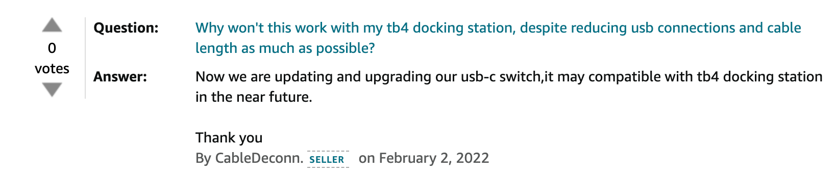

Hello everyone,
I was going to buy this to connect my mac mini and macbook at the same time, it seemed perfect:
But in the comments it says that it doesn't work, strange... does anyone have it?

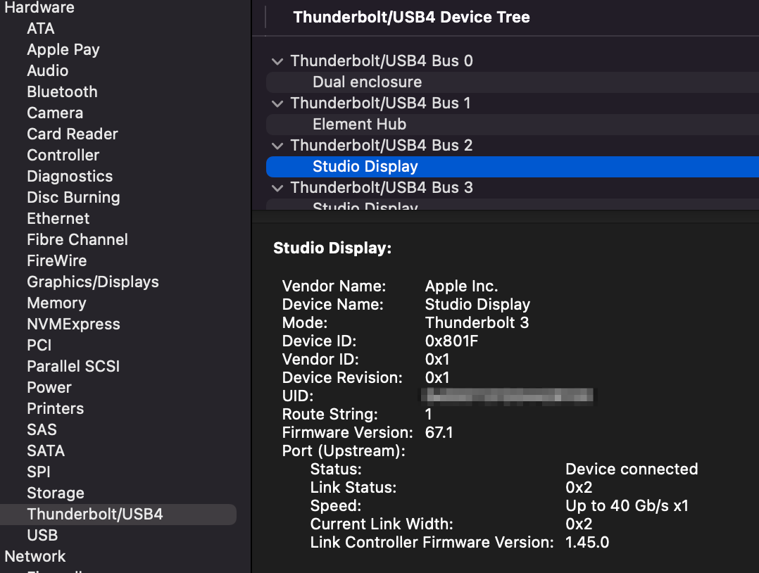

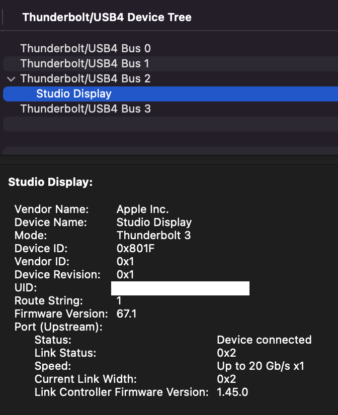

What does System Information show? Are the monitors listed under the Thunderbolt tab and if so, what appears? If it's using Thunderbolt, it will look like this:
Similar, but not exact (speed is 20Gb instead of 40). I'm using a single Studio Display and switching between two Macs. No hub/dock/etc.
Reactions: maverick808
Is that the Mac Studio Max or the MBP? It's definitely doing Thunderbolt video, if it was doing DisplayPort it wouldn't appear in the System Report in that section.
It's the Studio, but the MBP looks identical.
