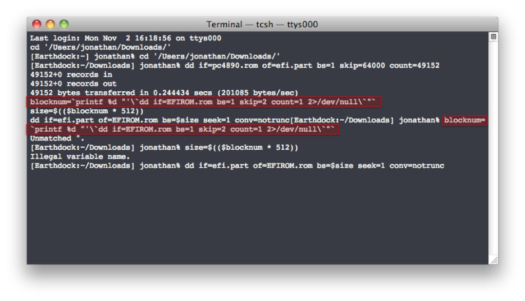

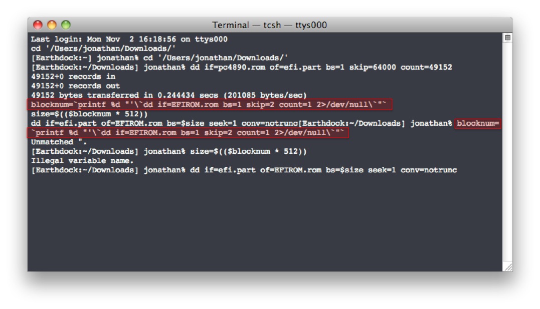

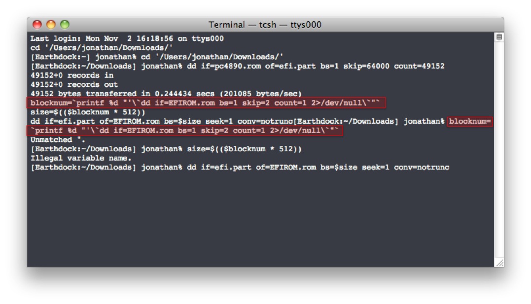

Using Peloche's new writeup I'm running into a brick wall. When pasting the dd code block into Terminal I get the following attached results. The instructions are also slightly off. When it says to change Number mode it's under the Edit menu, not File. It's Find, not Finf. 😛
Why it puts twice "blocknum=`printf %d "'\`dd if=EFIROM.rom bs=1 skip=2 count=1 2>/dev/null\`"`" ?
In fact it's its home made wall
Why it follows instructions so lightly ?
Instruction doesn't say copy line by line and in double, instruction says:
Copy the TEXT located in the right box and paste into terminal, hit return:

When copying the block of text located in your text to paste attachment and pasting into Terminal as instructed yields those results. There was no line by line pasting or doubling.

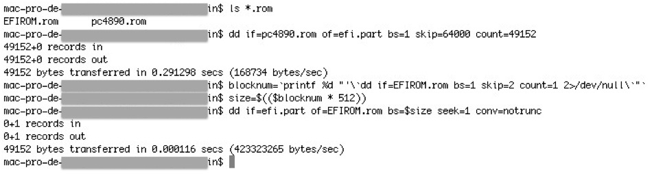

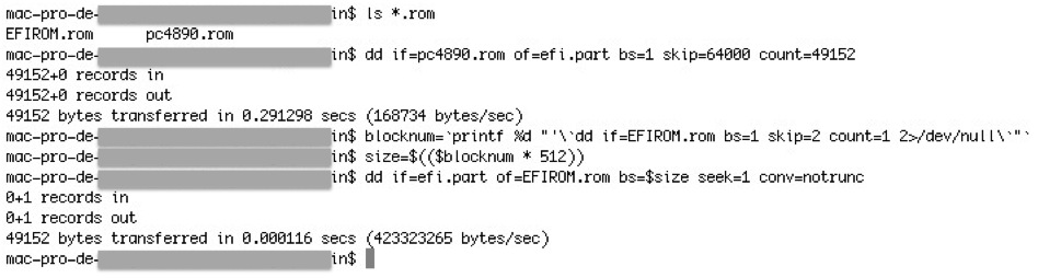

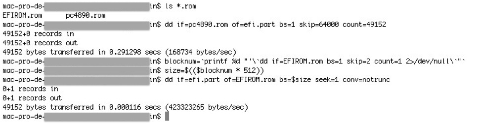

If you copy the block of text you must get something like the first picture, the second picture shows that you have twice the same command which are nor in the script wrote by Pipomolo42 neither in the file "Text to patch".
What else can I say Peloche? I'm following the instructions as given and that's what's happening. I'm not the first to have this odd behavior using Pipomolo42's method but he/she never got a resolution to the matter.
Hi Treskdot,
Could you please make available the original rom you've used to get these results, i would like to have a look, if you could md5 it.
