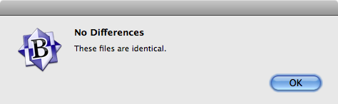

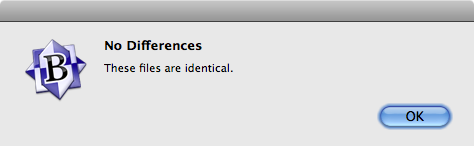

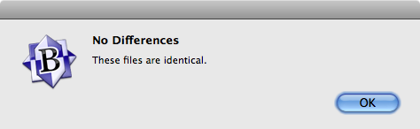

I made the necessary modifications (displacing MCuC, changing MCuC address, etc..), ran Pipomolo42 4 lines script in one block in terminal (without problem), ran fixrom.py and the result is attached.
If you have the means (pc) to test it and go back to your existing without any problem, it could be good for the communauty since i couldn't test a 7D length rom. It's up to you.
md5
e23941999b483b8675780f1e38224614

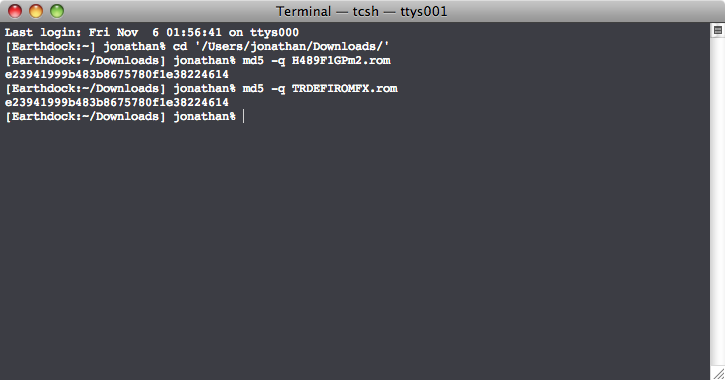

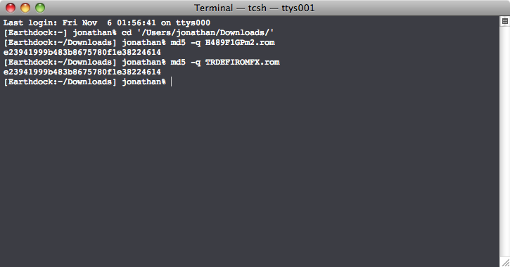

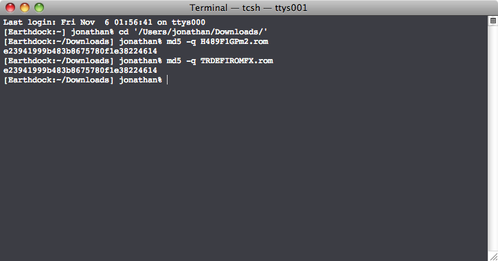

Actually I can already tell you it will work since the one you made is the exact same as the one Rominator posted here, bit for bit and checksum for checksum. Nevertheless thank you for taking the time to roll the ROM and especially for your guide so people can make custom ROMs for their cards. Hopefully no one else runs into the oddity I did.
Just confirming that a working custom ROM has been made for the HIS H489F1GP 4890 cards.(Hint hint Cindori.)
