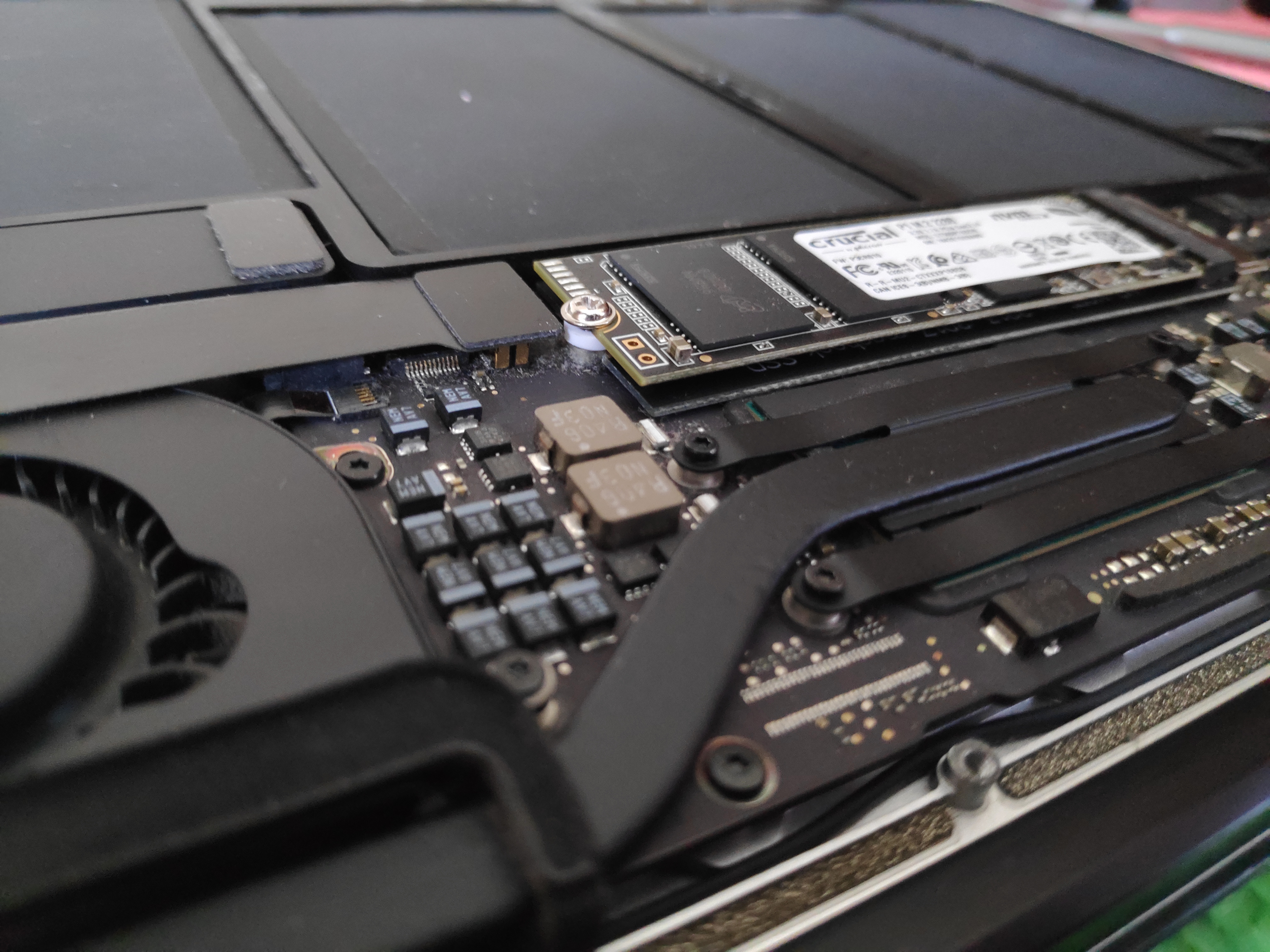

Hi All,
Looks like I'm late for the party? I think is the best time to upgrade to NVMe SDD now that the prices are down and most of the problem are known (thou not fixed just yet).
My setup:
Macbook Air 2013 13"
- Sintech Adapter - https://www.amazon.com/Sintech-Adapter-Upgrade-2013-2015-MacBook/dp/B01CWWAENG
- Crucial P1 500GB (aint cheap from where I got it, but still cheaper than elsewhere here in .AE)
The adapter does not fit MBA well, I made some modifications on it to prevent the SSD from sagging.
1. I made a plastic washer (out of spent gel pen refill barrel), check the photo for reference.
2. I made the hole on the adapter bigger than the retention screw
3. I put plastic tape on the back of the adapter to prevent unwanted electrical contact to the motherboard

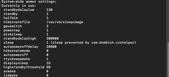

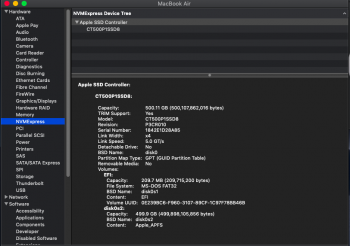

I had success in installing Mojave, with very good battery life (my pmset settings attached, was able to have 3% battery drain from 11:00PM to 7:00PM the next day)

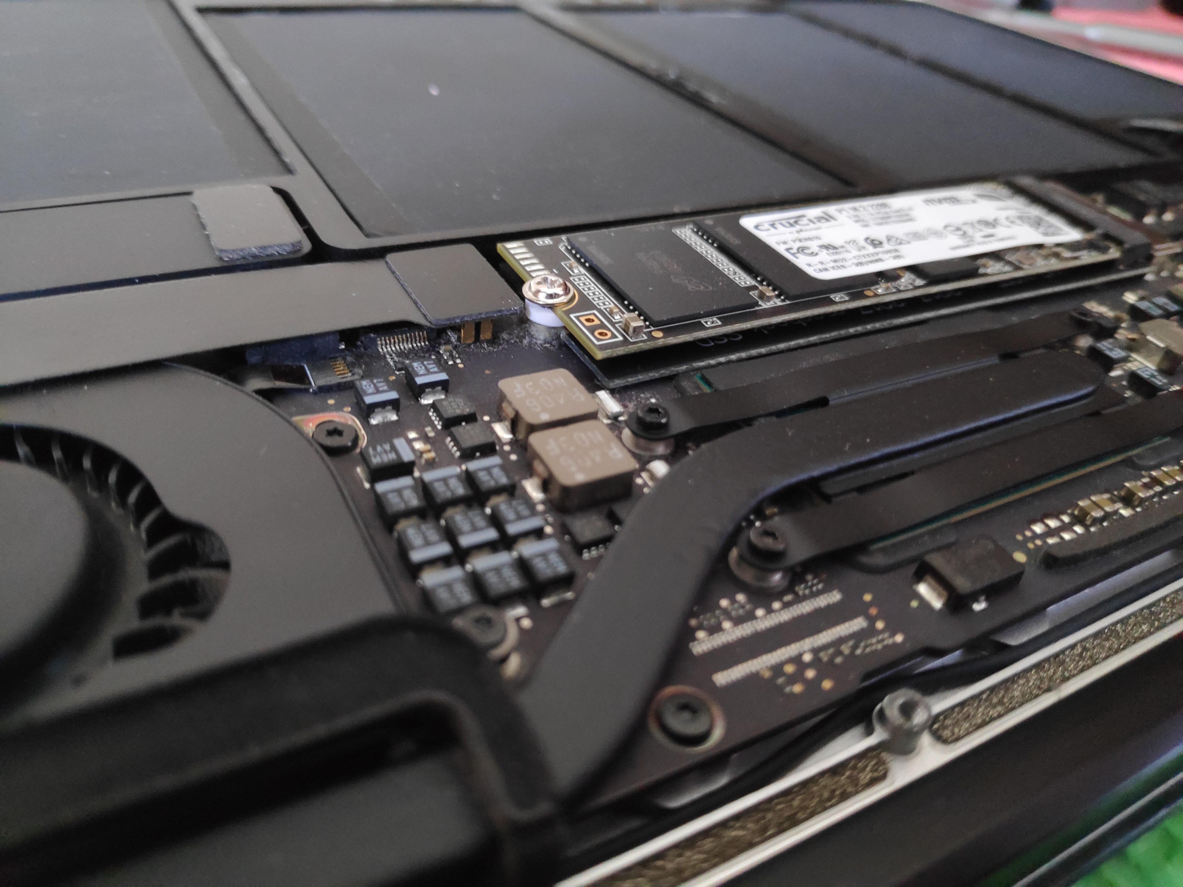

I made a post a page or 2 back enquiring about this sort of potential fit issue - or at least that's what I intended to ask about but maybe I wasn't really clear.
Thanks for posting your picture - nicely done with the washer workaround.
I'll go for the longer adapter as I think that may help with the problem you had.

With pmset configurations I was able to have get 3% drain for 20 hours with the lid close test on my MBA 13" 2013.
I think the decision you have to make is whether you need higher R/W speed that comes higher battery consumption or good enough (better than SATA 600) R/W speed and good battery life. It's just how law of physics works.
