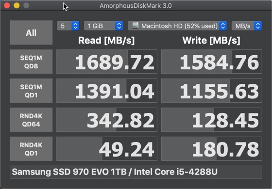

Hello everyone. I recently bought a MacBook Pro 15" Late 2013 2GHz. I'm running the latest version of Catalina 10.15.7
I swapped the 256GB Apple OEM SSD (Samsung chip based), and replaced it with a Samsung 970 Evo NVMe 500GB along with the gum stick M.2 adapter. I'm noticing 1675 MB Read / 1523 MB Write. It's definitely an upgrade from the stock 820 R / 665 W I was getting before. But the speeds are not up to spec. Is the motherboard for late 2013 PCIE 2.0 ?
Also when running bootcamp along with Windows 10, I installed Samsung Magician, and it also gives me the same read/write speeds. Regardless if I use the Samsung NVMe Driver or not.
Either way, I'm happy with the result, just trying to get the most out of the drive, or as optimized as it can be.
That speed is about right, 2013 model only support 2x4 . Only 2015 15" model can do 3x4, so nothing wrong with your setup

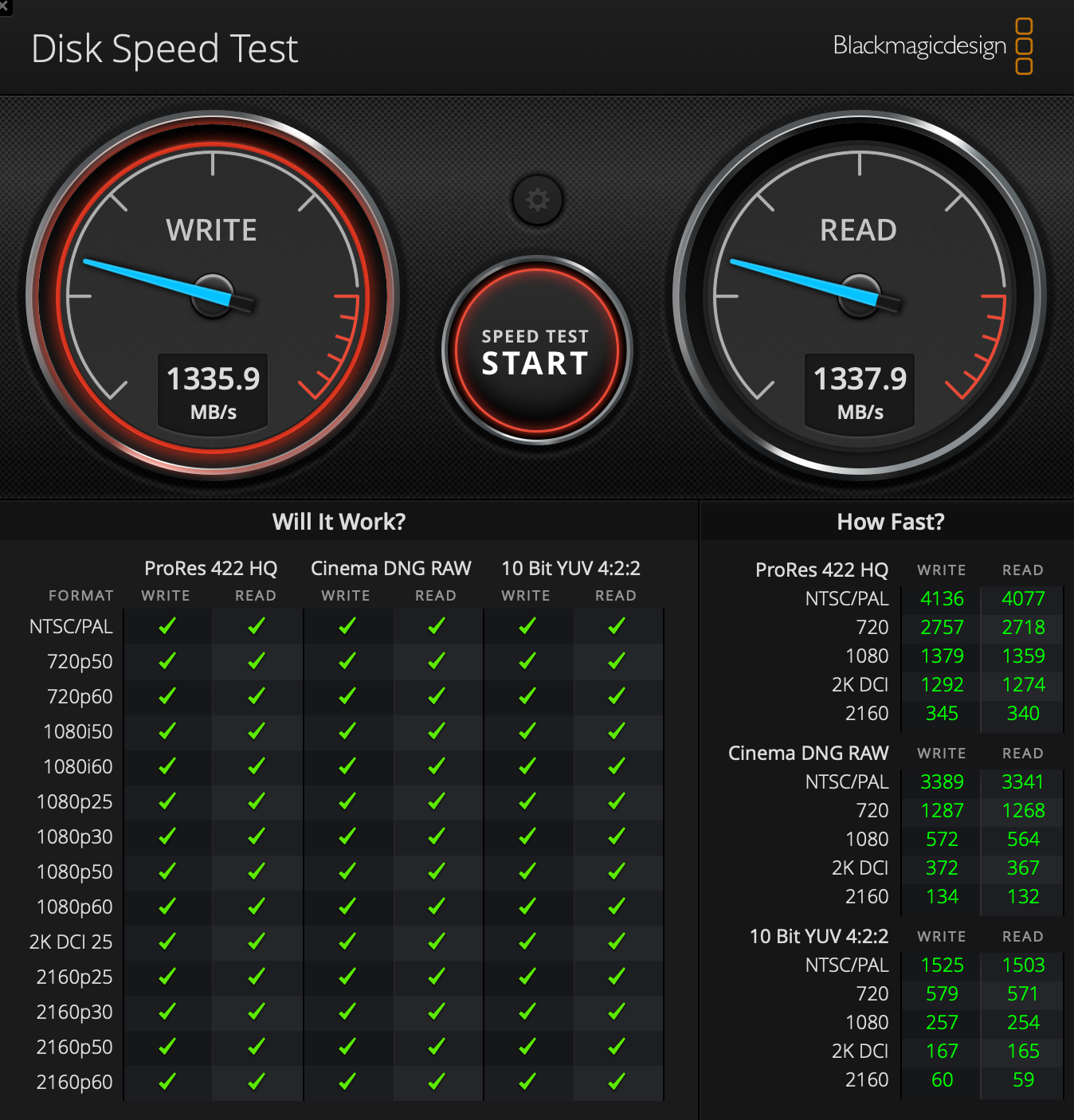

Howdy @pimu96! When you start Black Magic, it will cycle over and over automatically until you press the Start button again. Sometimes what's being read and written changes. I notice that one test run will check all boxes and the next run will not, then the following run will check every box again. I don't know why this is, someone else with more knowledge of the program may better serve you.
As for the iMacs, yeah, those are some pretty slow speeds, especially for the HDD. Have you run the benchmark from a fresh restart?

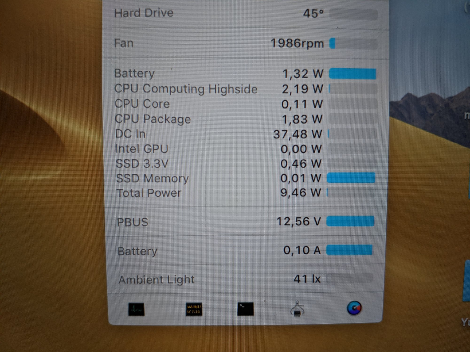

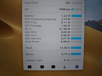

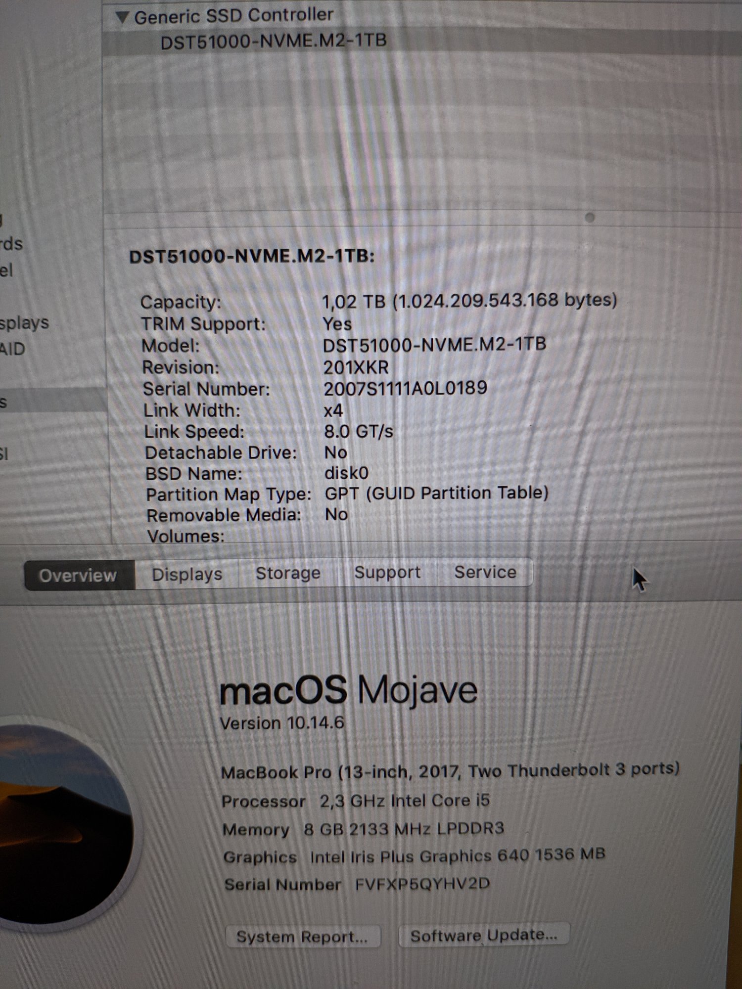

Seems like latest NVME fix working great
Idling on 0.4x W
Memory on 0.01W

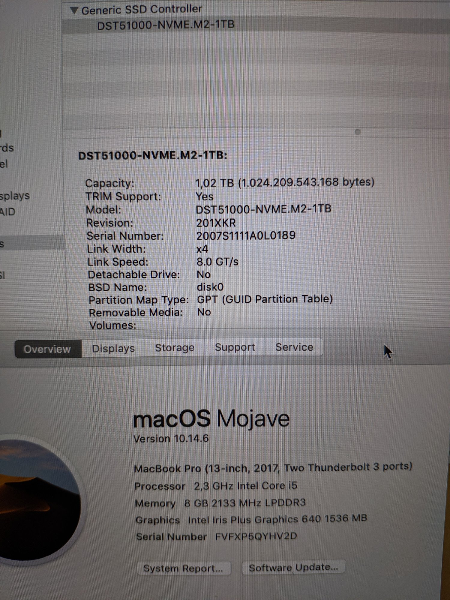

A1708 - 2017
DST5100 1TB

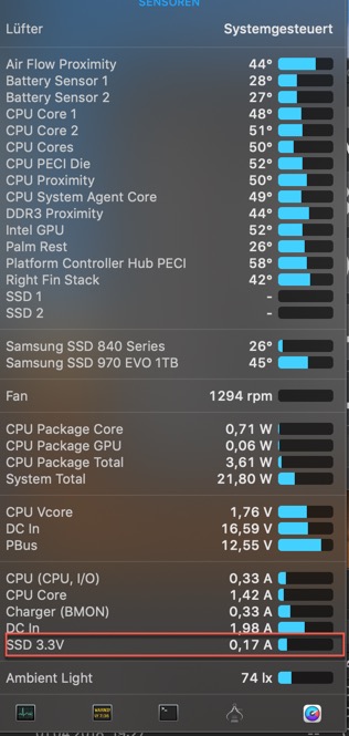

I can confirm that NVMeFix work properly on my MBP11.1 with EVO970 1TB and the IDLE power reduce from 2,5 to 0,4-0,5 W.
