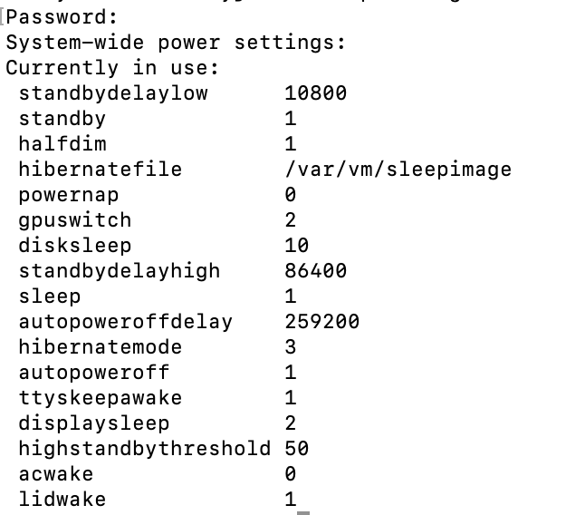

I have a MacBook Pro 12,1 and just installed a Samsung 970 Evo Plus 1tb which is working great so far. A while back I turned off hibernation through:
  1. disable hibernation by typing "sudo pmset -a hibernatemode 0 standby 0 autopoweroff 0" in the terminal
What settings should I use now to turn it back on? What were the original/recommended settings here?

Your MacBook is a 2015 that doesn't have the hibernation issue that the 2013 and 2014 have.
Thanks for the response. Yes I know but I disabled it a while ago hoping it would help with another issue and would like to turn it back on. Do you know how I can revert to the original settings?

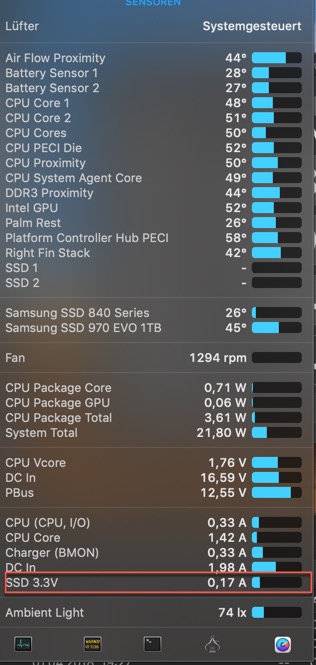

I have today install both kext ( Lilu & NVMeFix ) with Hackintool but on my Mojave System ( its current up to date ) both kext will only load if I installed them in L/E in S/L/E there will not load on booting the system !!
I can confirm that NVMeFix work properly on my MBP11.1 with EVO970 1TB and the IDLE power reduce from 2,5 to 0,4-0,5 W.

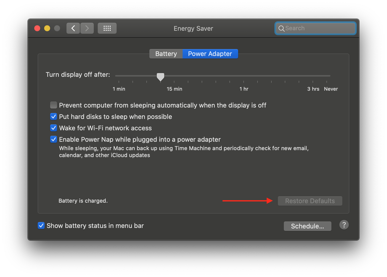

The simplest method would be to undo the changes you made via terminal if you recall the previous settings. I attached a screenshot of the stock settings for my mid 2014 13".

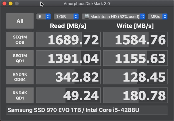

Thanks to this post I was able to upgrade my Late 2013 Retina 13" Macbook Pro to a 1tb Adata SX8200 Drive from a measly 128 GB Apple drive. I used the NVMe adapter and it worked perfectly. I disabled hibernation thorough the Terminal as well. Thank you for this post, it saved my Macbook Pro.
Do panics happen with other applications?
It still shows as lane width x4 in system report?
Consistently with Zoom. It's quite stable otherwise. Maybe a bit slow to quit some apps occasionally that requires a reboot but nothing extreme like a KP.
And yes, 4x in system report.
