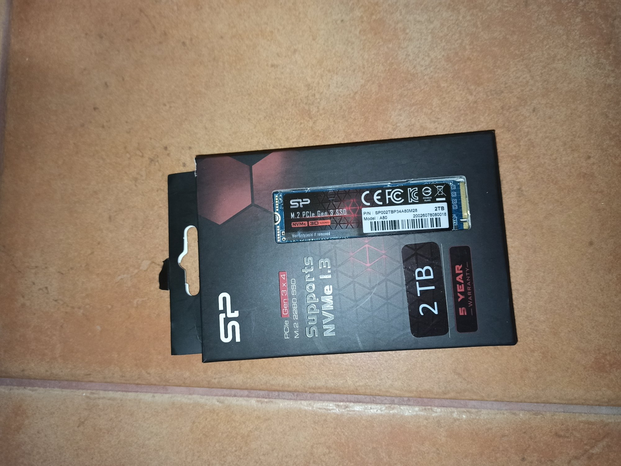

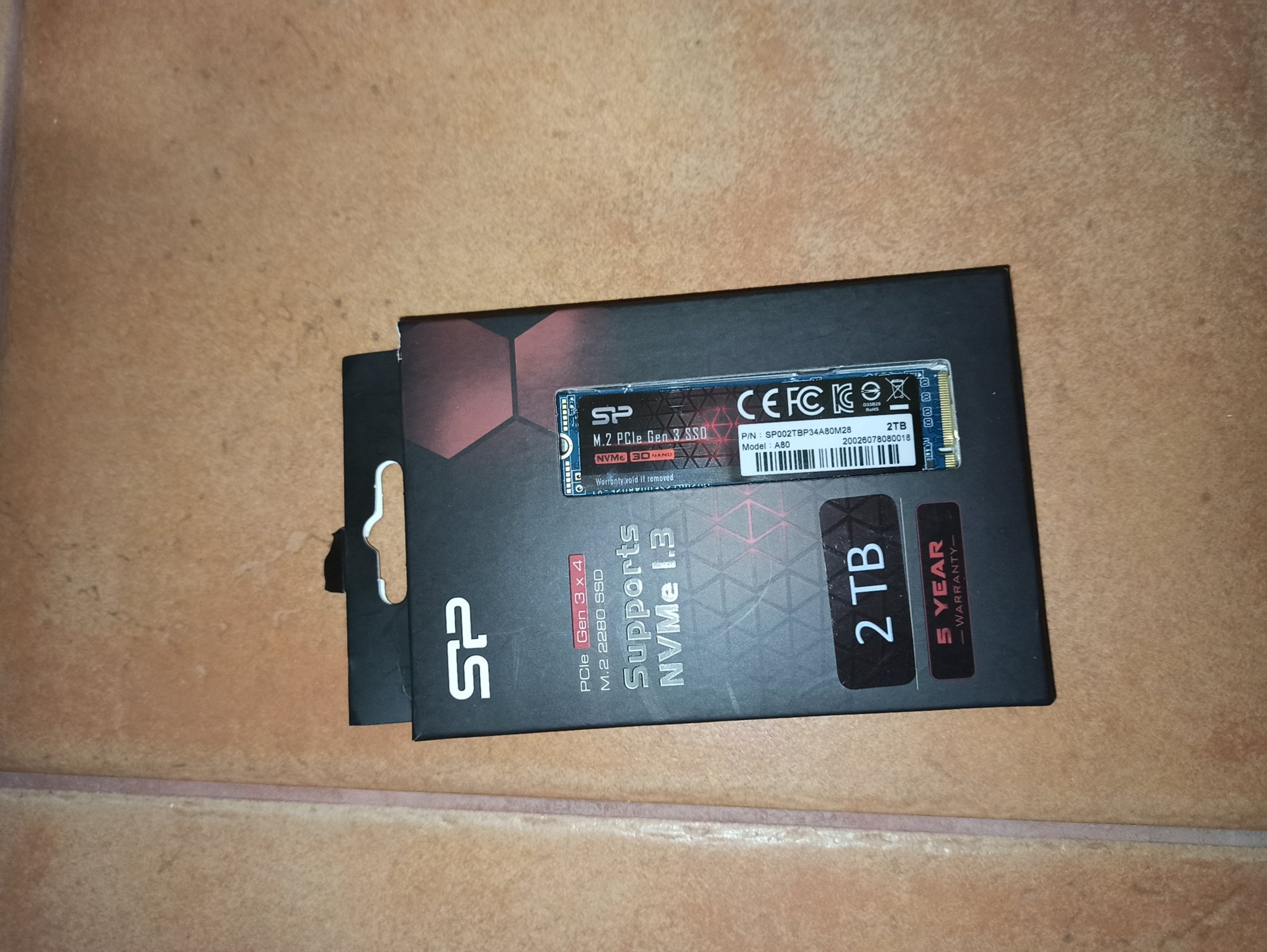

My 2TB Silicon Power NVME arrived!
Monday I'm picking up from the post office my Sintech Adapter as well!
