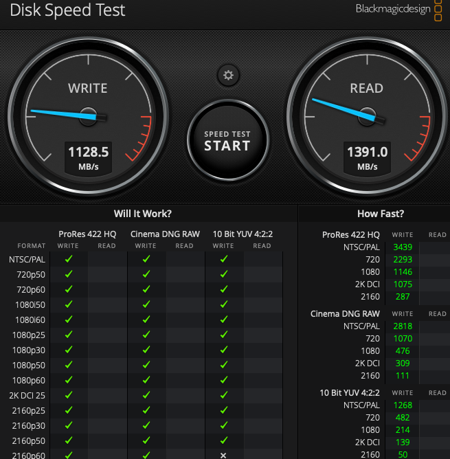

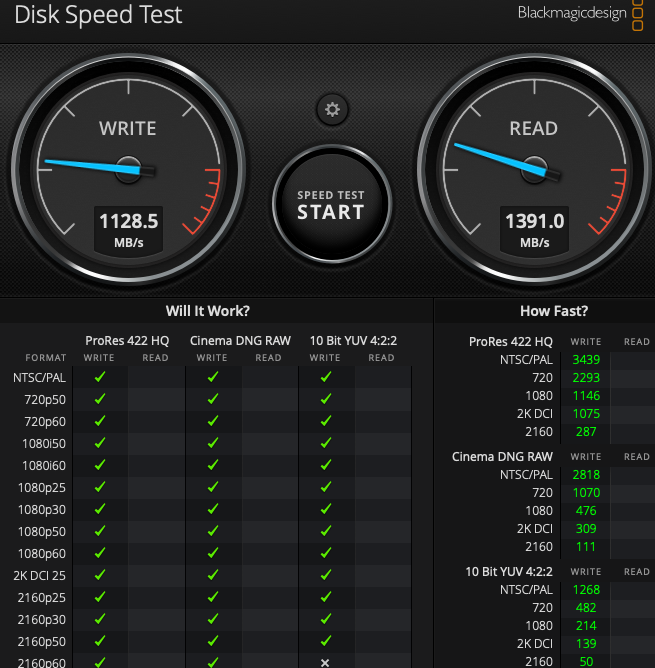

I've already selected the startup disk as the 970 EVO but loading times are still the same, maybe a placebo effect of few seconds faster.
Maybe could be a problem with ssd the adapter? I'm using one bought on Aliexpress (now I'm waiting for the Sintech one) and I covered the connector with Kapton Tape.
Also I'm thinking about that because in System Info under the NVME Express device tree, instead of "Apple SSD Controller" I got "Generic SSD Controller"
Speed test disk are fine compared to other online (around 1300MB/s in write mode and 1500MB/s in read mode). No other issues related to hybernation and sleep.

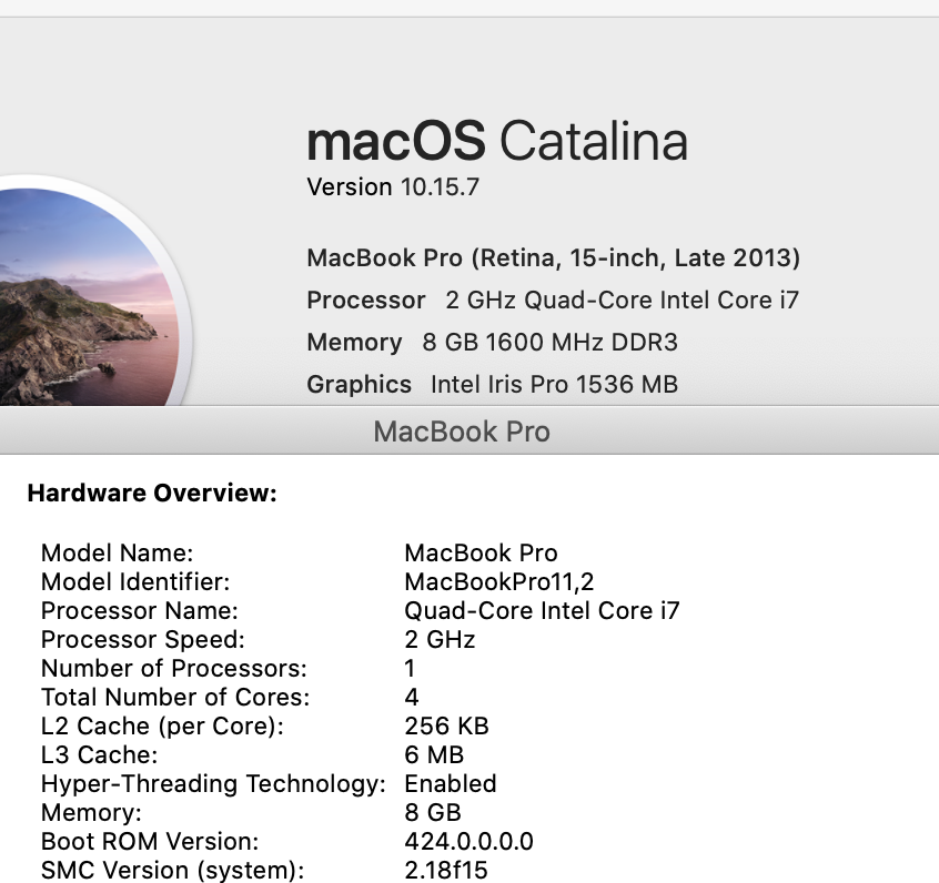

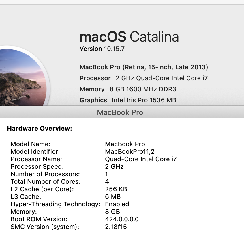

I just saw few comments up here talking about the BootROM of Big Sur so i decided to update Catalina to Big Sure just to have the latest BootROM (424.0.0.0.0) and then reinstall Catalina on 970 EVO and well... it fixed all my boot issues and now it boots with the same speed as the original SSD.
Now I have to investigate if i have to change hibernation or sleep settings via Terminal because I've never really tested if anything works good. Anyway the problem seems to be solved.
Thank you
Reactions: pimu96 and otosan
