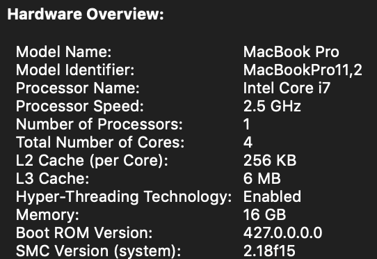

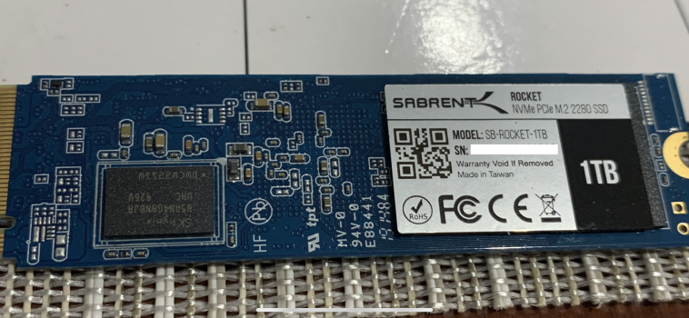

I have 10.14.6 Mojave. Is that high enough? I noticed some people have Bootrom versions very high numbered. Mine is: Boot ROM Version: 199.0.0.0.0. Is this high enough?
That's actually 427..
I believe it is fine. I have used the Sabrent Socket with the BootRom 191, and it works fine. I did not see any noticeable difference between 191 and 427.

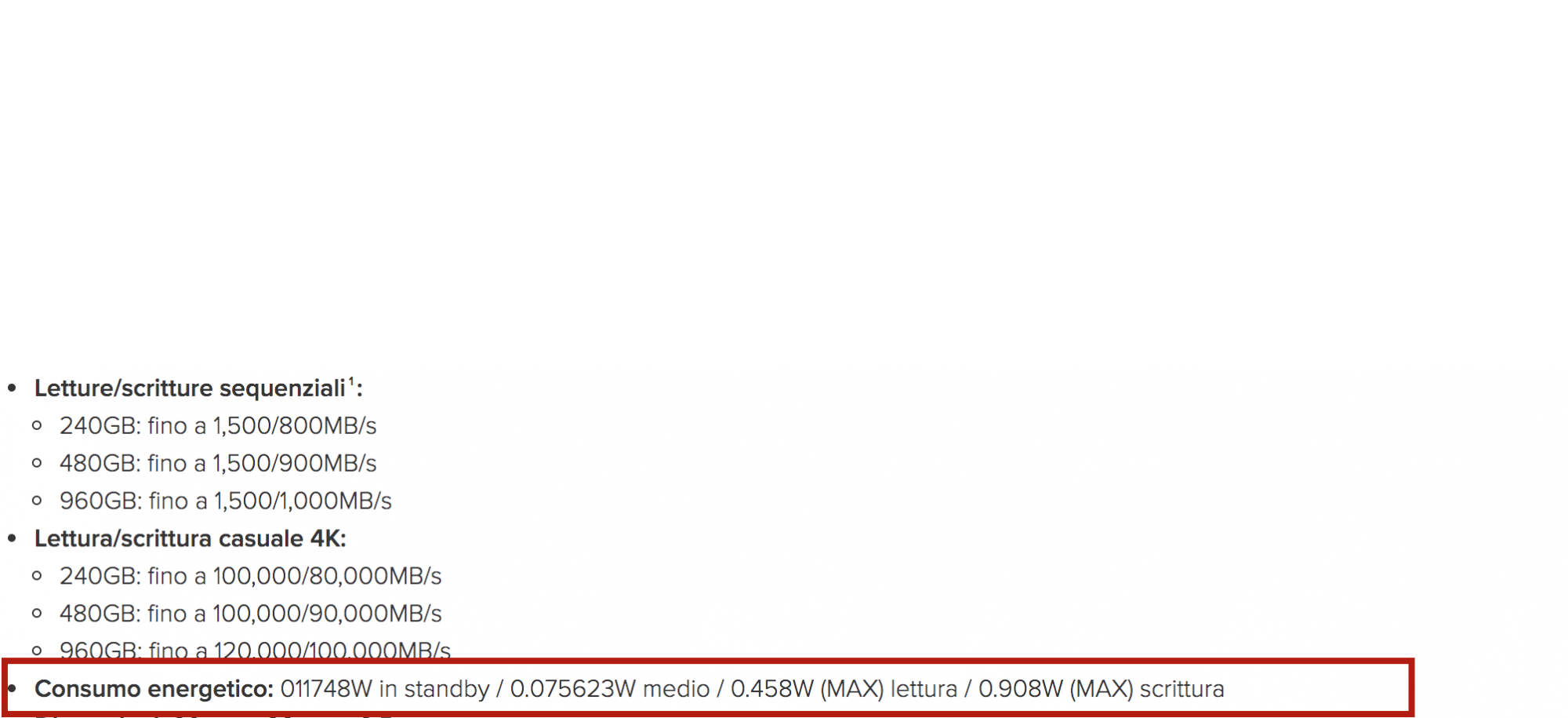

I was looking at the various ssd to get an idea on what consumes less. And it appears to be the sabrent rocket. There are currently many update of the sabrnet rocket, many other version.
But i don't know where to look and whether to choose the updated version or the version in the table.
The various consumption are not easy to find in the web.
And i don't know why, when i found the consumption on some page, they don't Correspond to the consumption in the table. I have a lot of confusion. Help.
In the example i report the consumption of KINGSTON A1000 ( original site) that is different from the consumption report on the table in the first page.
