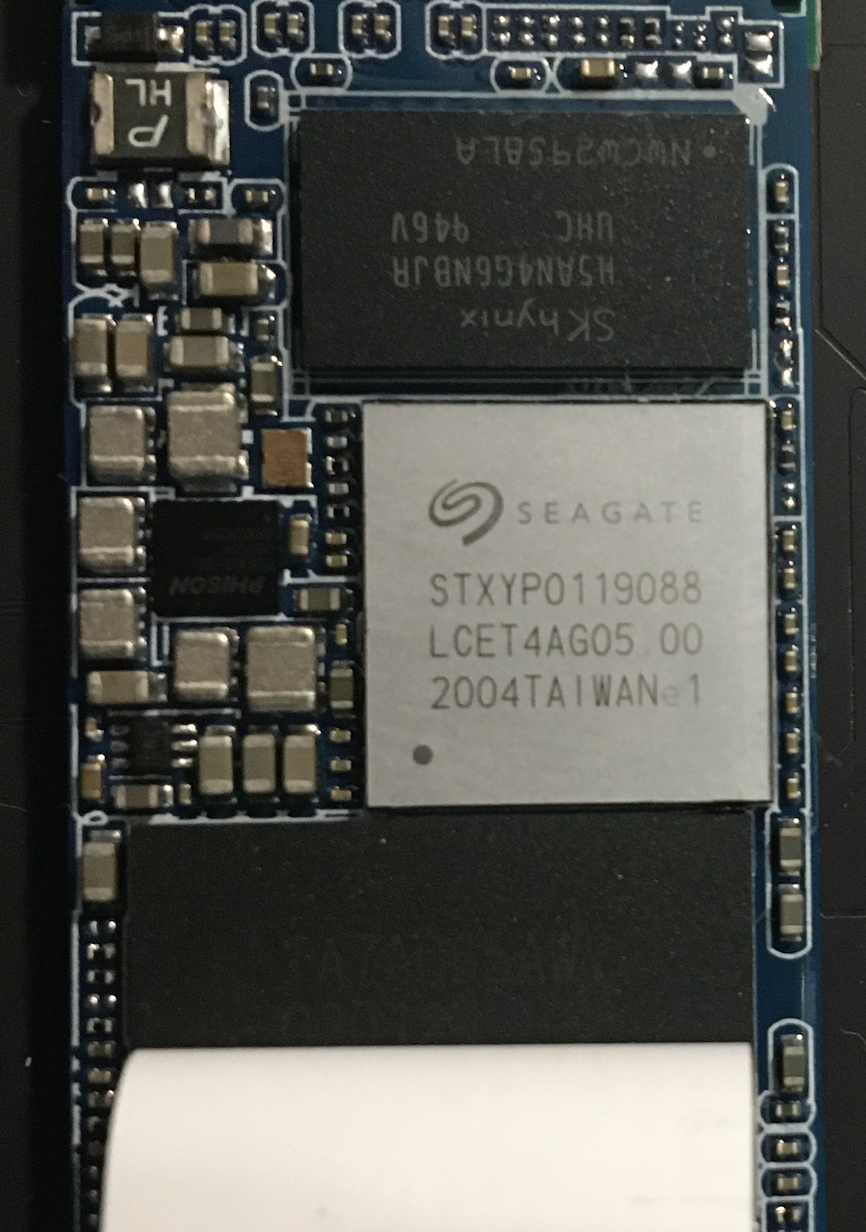

I've run the Flash Identifier tool from: http://vlo.name:3000/tmph/phison_nvme_flash_id2.rar
I can confirm the silver chip Seagate is still an E12:

Interesting. Can you confirm the model code printed on your chip?

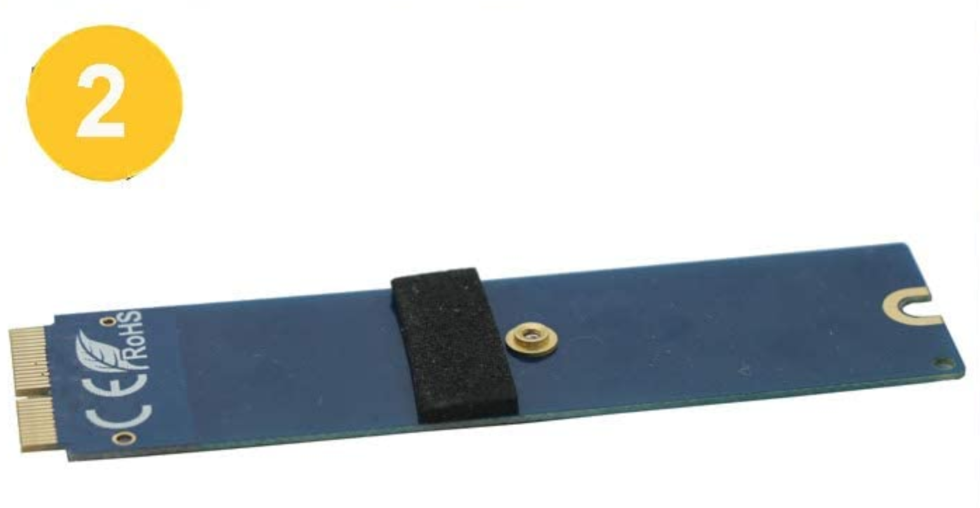

I have bitten the bullet and decided to upgrade the ssd in my late 2013 15” MacBook Pro. It currently has the 512GB SSD running Big Sur with 427 firmware. Has windows 10 running through bootcamp.
I have ordered the Sabrent Rocket 2TB and the sintech adapter off Amazon. The Rocket Q 2TB is £20 more but being PCie 4.0 not really necessary. Anything else I need to be worried about?
Yesterday I replaced the bulging battery with the ifixit kit as well as redoing the thermal paste.

It's straight forward. Can't think of any pitfalls. Perhaps double check on contacts between SSD & adapter, then adapter and Logic Board's socket. Make sure no short circuit.

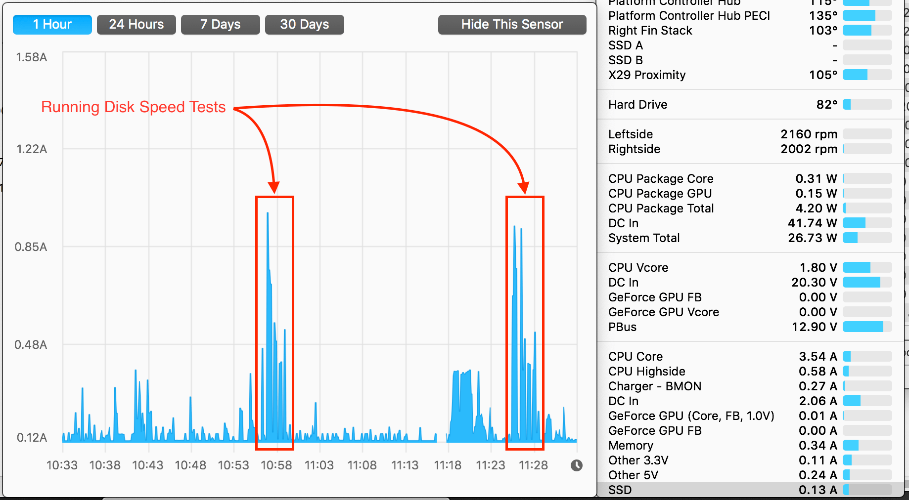

When done and you feel joyful, share with us a chart of the SSD current from iStat Menus and whatnot. There are a couple of examples in previous pages.

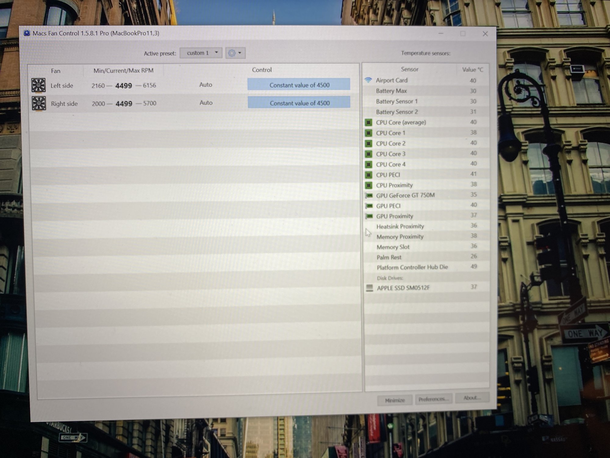

Personally I haven't run BootCamp. Is there iStat Menu equivalent to read Apple sensors in Windows 10? A chart or readings of SSD current similar to iStat Menu from Windows will be quite interesting to see.

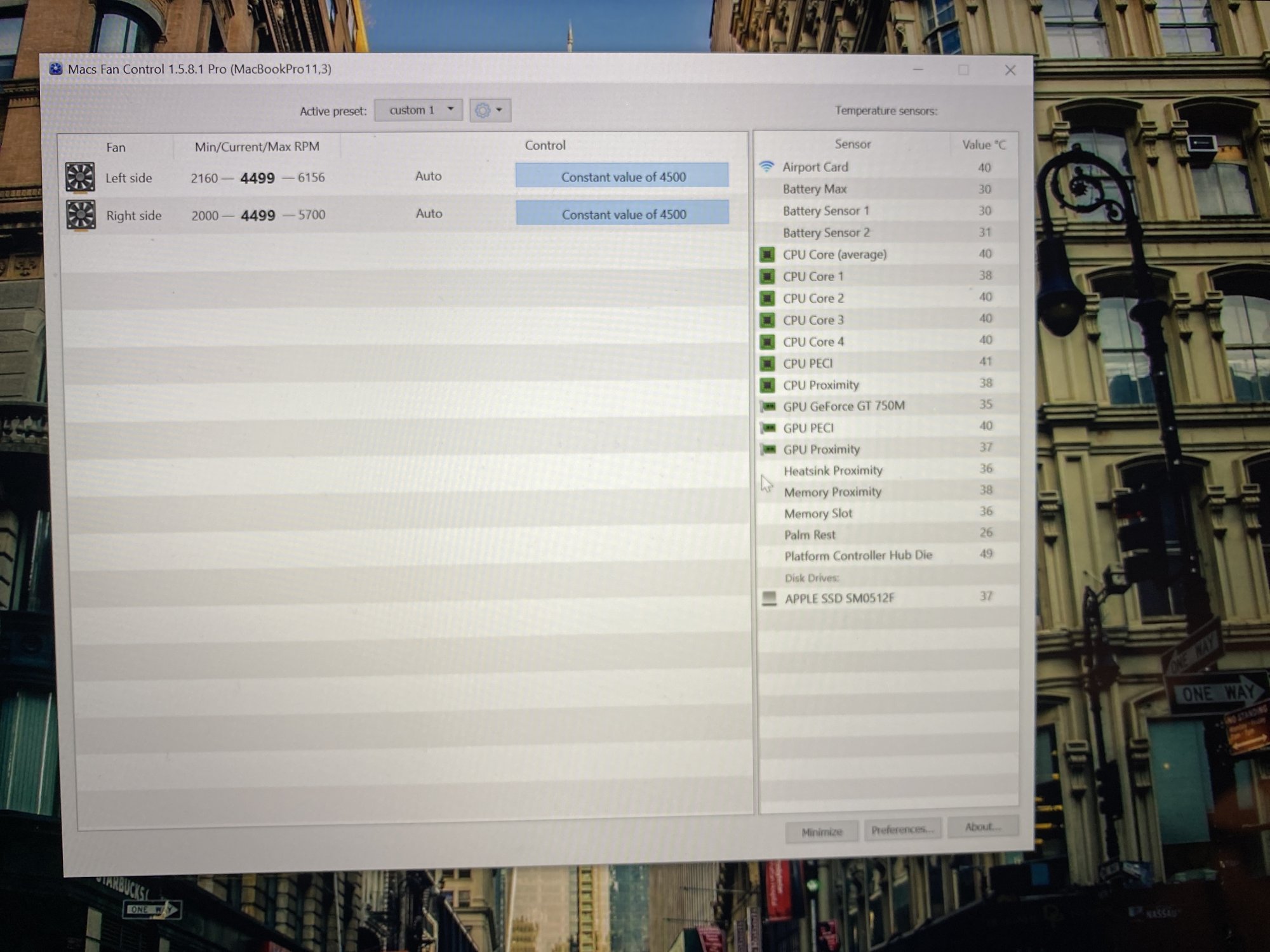

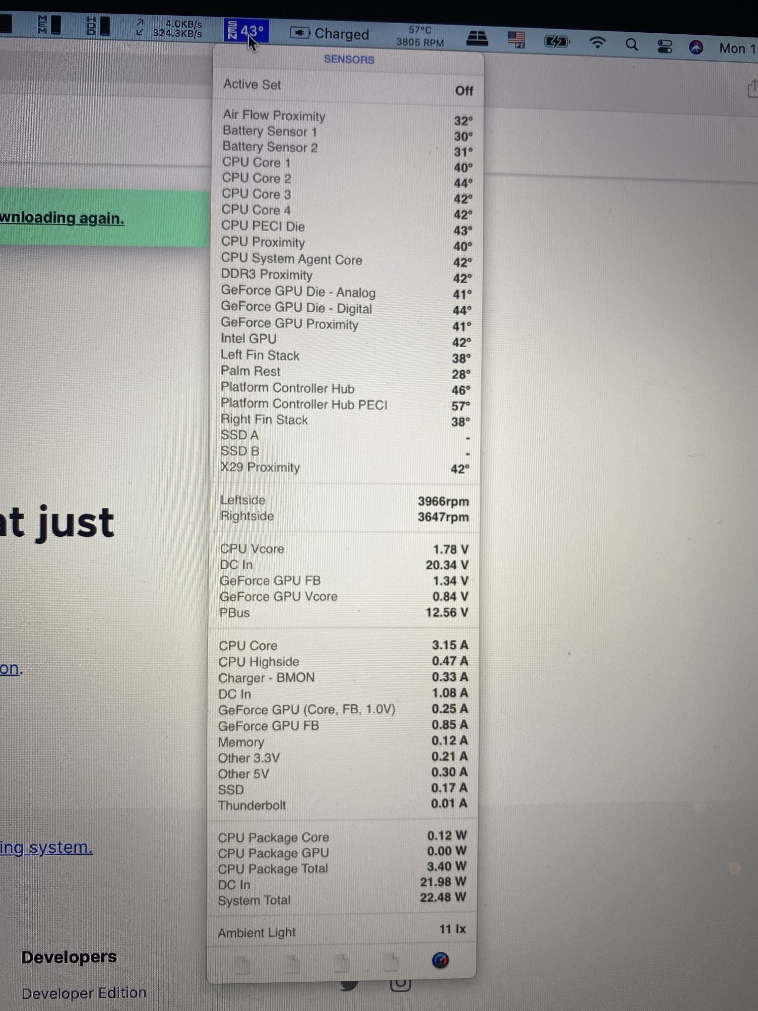

I’m using something called Macs Fan Control Pro. Gives me temp sensor readings. The Pro version can be used on Windows and Mac. On Mac I use TG Pro instead.

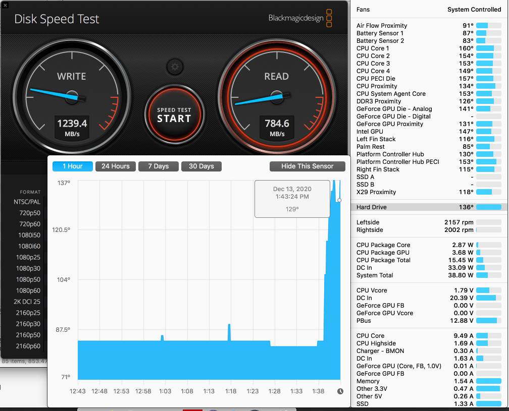

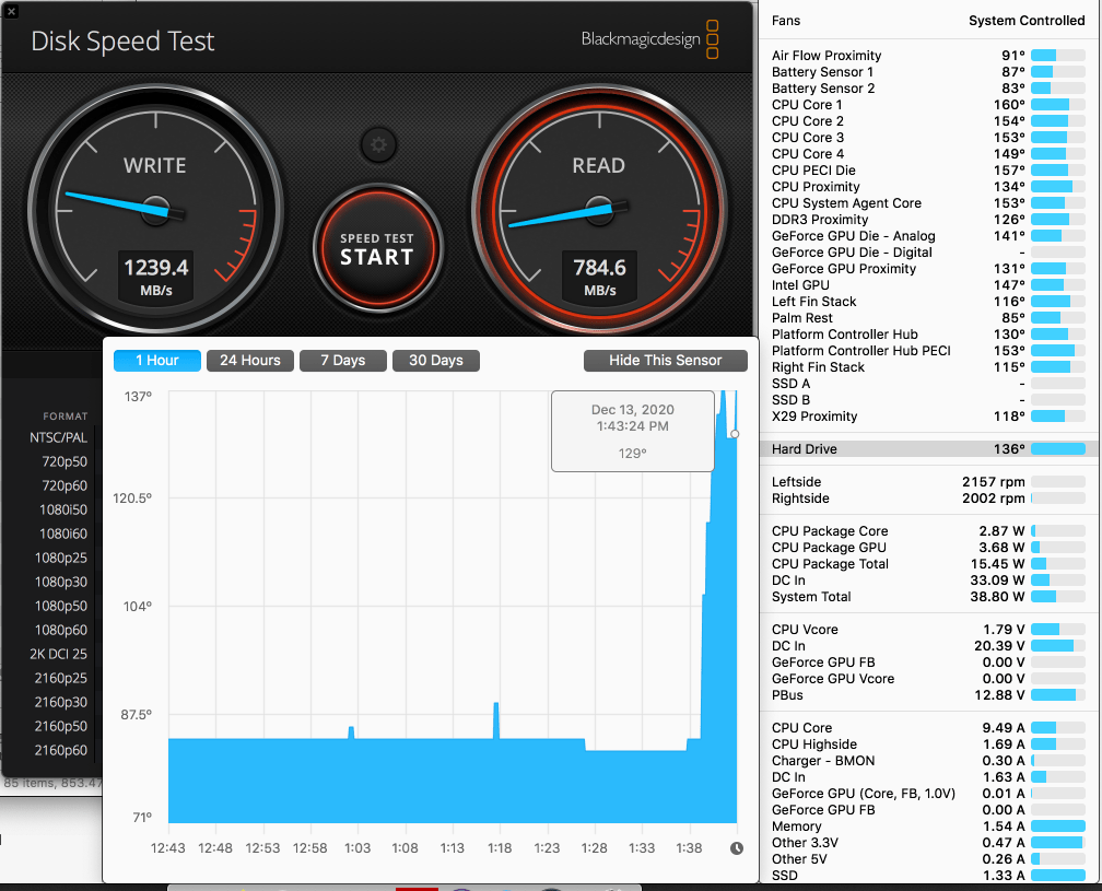

100° is terrible. You might want to check your fan or thermal paste as well.
but if you really into an experimentation, i suggest you to try another SSD available out there.
970 can be easily shipped off again to a PC or windows user. So you wont be at much lost there.
100 degrees Fahrenheid? Or Celcius?

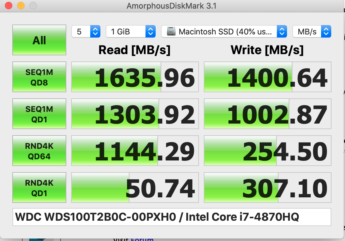

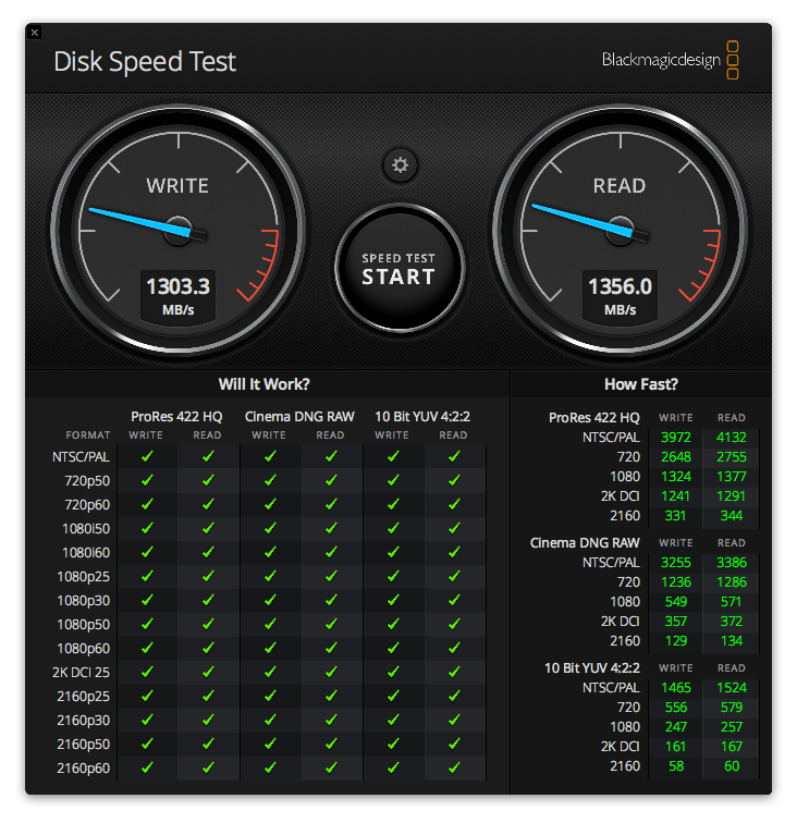

I recently upgraded my Late 2013 MacBook Pro's original 1 TB SSD based on information from this topic and I wanted to share my experience.
I bought a Sabrent SB-ROCKET-2TB (the version with the dark blue label that has TLC RAM) and a Sintech NGFF M.2 nVME SSD Adapter.
The SSD module is covered by a label/heat-spreader that I did not remove, but it appears to be the same as the photo in post #7,853, meaning it has a Phison E12S controller. The module is populated on both sides. I believe the block size is 4K (diskutil says "Device Block Size: 4096 Bytes").
I am running macOS Catalina 10.15.7, but I ran the Big Sur installer on an external drive to upgrade my Mac's Boot ROM firmware to 427.0.0.0.0 before installing the new SSD.

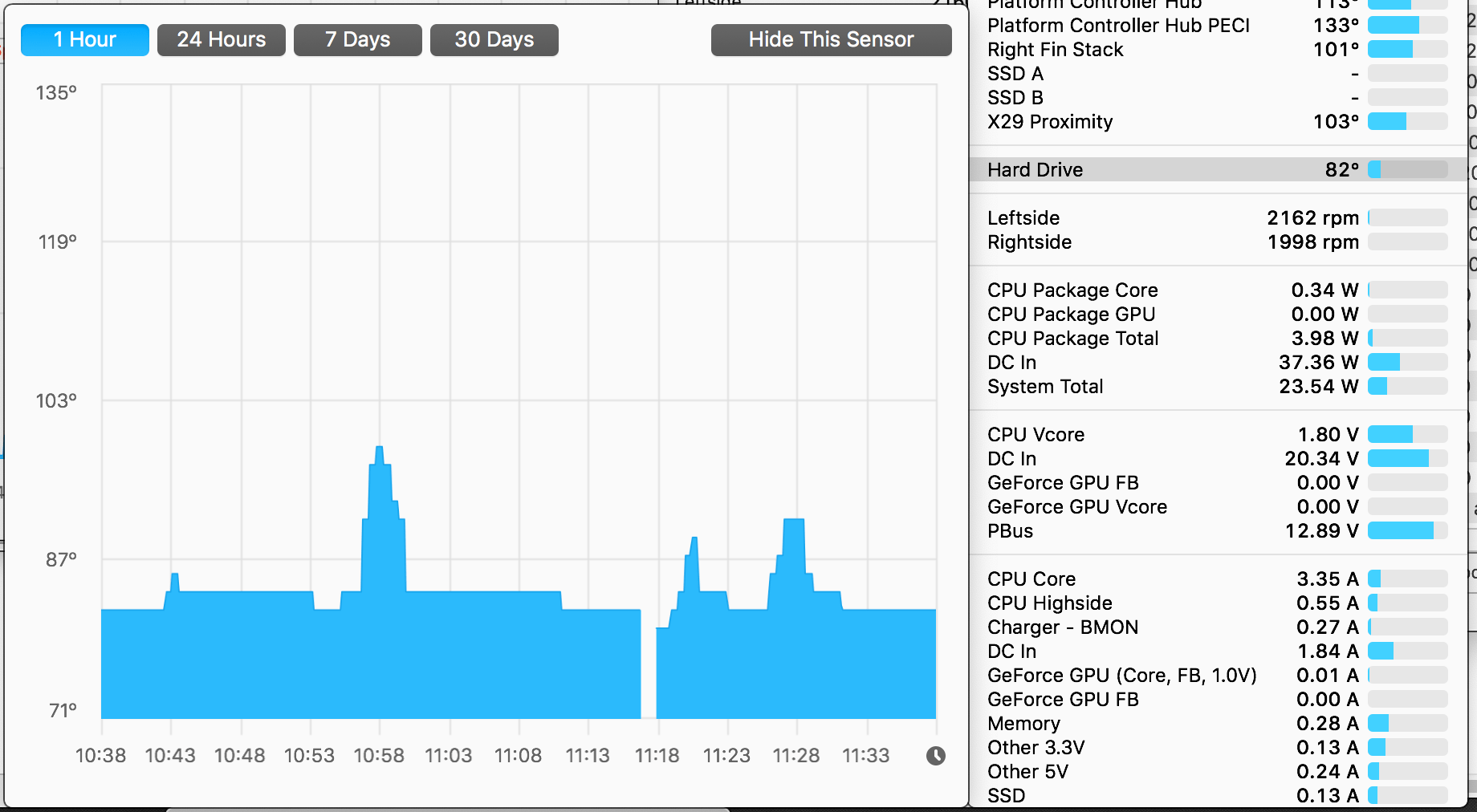

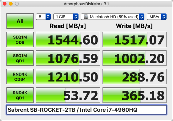

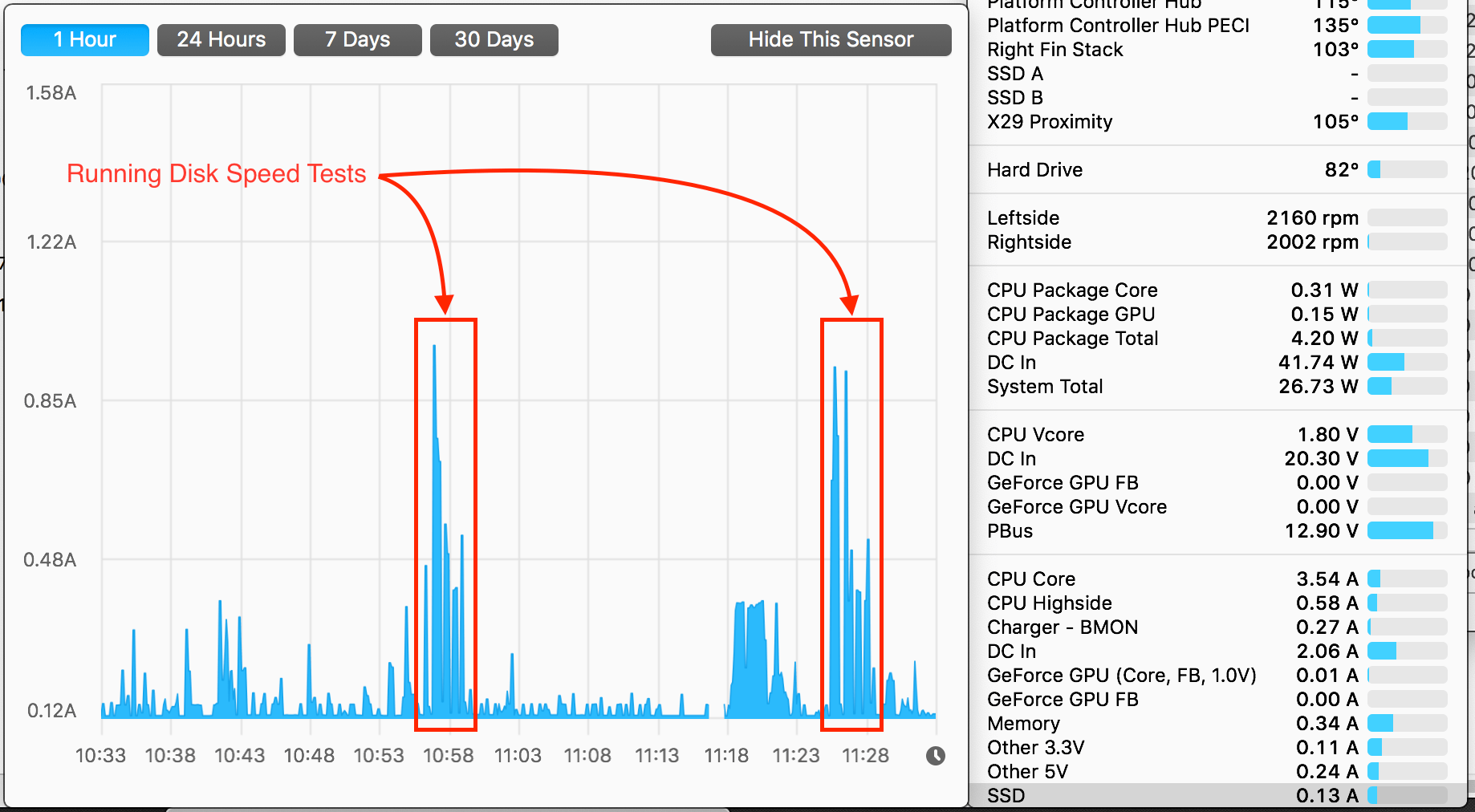

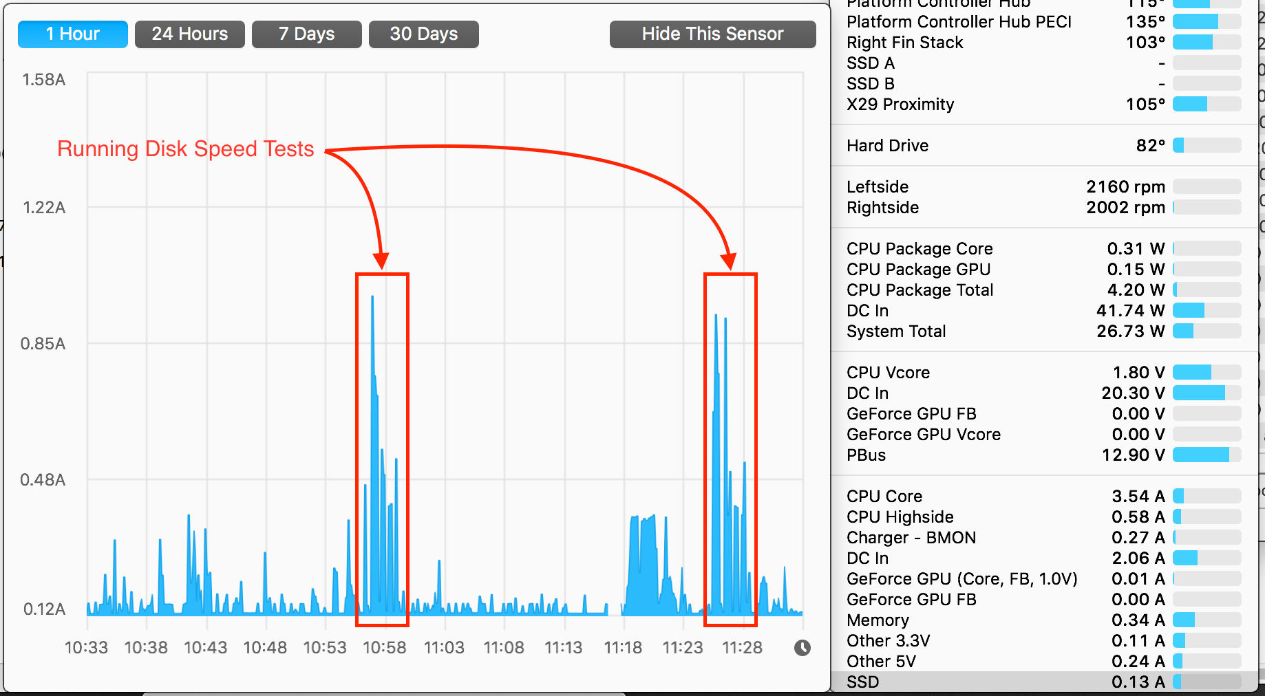

The idle power use appears to vary between 0.13A and 0.20A. I did not (and don't plan to) install the NVMeFix kext.

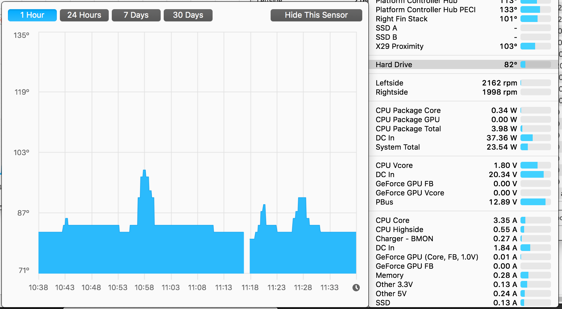

Temperature
AmorphousDiskMark shows that the read and write speeds are around 1500 MB/s.
Sabrent SB-ROCKET-2TB : Intel Core i7-4960HQ-power.png

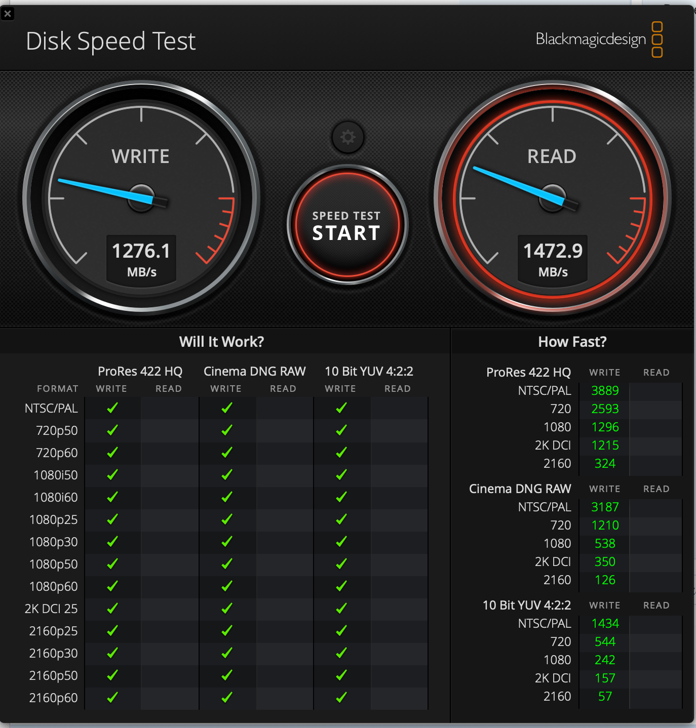

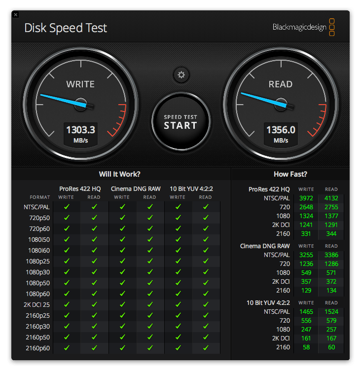

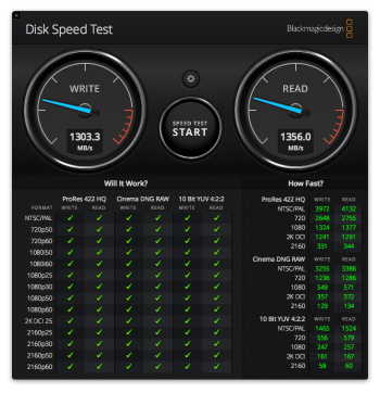

I also ran Blackmagic Disk Speed, and with its default settings it shows an initial read and write speeds of around 1300 MB/s, but interestingly after a minute or so the read and write speeds sometimes slow down for some runs, usually the read more than the write. I wonder if this is due to the module getting hot and throttling itself. (This is also the only speed test I ran on the Apple SSD before I replaced it.)
Apple SSDSabrent Rocket
idle0.1A0.12A
write842 MB/s1.6A1320/1200 MB/s1.5A
read800 MB/s1.1A1360/840 MB/s1.4A

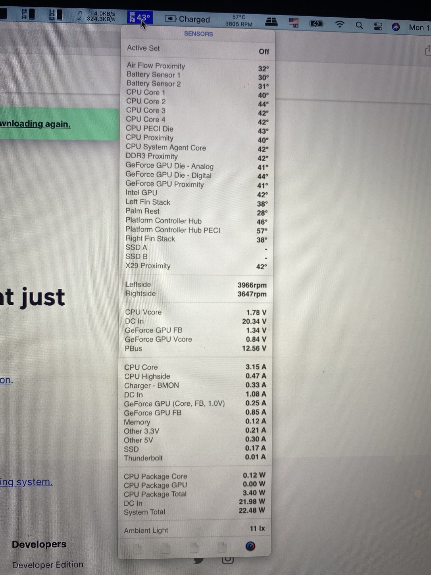

I did the upgrade a week ago. Overall I'm happy; my SSD is now twice as large as the original, is around twice as fast (for smaller reads and writes, anyway), and uses about the same amount of power.

Yeah, I had just looked at some reviews of the Firecuda 1TB which had a rebranded black chipset. My gut says that these silver chips are the E12s, and everyone likely switched to them because Phison revised the E12 and stopped making the original. Hopefully these new chips (and the boards as a whole) are just as good at power usage as the E12. The 510 I have uses the Toshiba 96L 3D TLC NAND, so I think it's still high quality memory. I'm not sure how power consumption differs from the older 64L TLC NAND used before.
Same main part number as your post above:
STXYP0119088
Temperature
idle0.1A0.12A
View attachment 1693360View attachment 1693362

Speed is much, much, much better than I was expecting. Writes drops around 800 Mb/s after a couple iterations but even then still much better than what I was expecting.
Seems like I lost temperature sensors on SSD within iStat, but I can live with that.
Here are the sensor readings I got using Istat menus on Big Sur

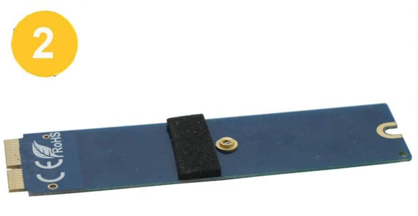

I know the general consensus is to use the sintech short black adapter --> https://www.amazon.com/dp/B07FYY3H5F?tag=mrforums-20#customerReviews&dtb=1
And I was considering either this WD Blue SN550 (500GB) --> https://www.newegg.com/western-digital-blue-sn550-nvme-500gb/p/N82E16820250134
Or this XPG SX8200 (512 GB) --> https://www.newegg.com/xpg-sx8200-p...ate disk-_-xpg-_-9SIAJNU95S3647&source=region
I was wondering if anyone else had any other suggestions or if their is a consensus between these two SSD's. Thank you in advance for any help!
Thank you. I take it as your Sabrent Rocket 2T hovering around 0.15A at idle in BigSur. Would be interesting to check out the idle current in Windows 10 in future when you can.
