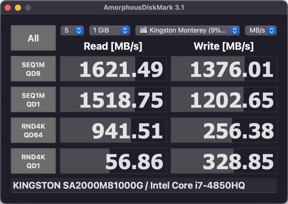

KINGSTON SA2000M81000G : Intel Core i7-4850HQ.png
I had it for about a week (testing it out) last year.
I found it to be much faster than both the Intel 660p and Seagate (Phison-based) SSD I currently use (but not by much - my MBP 13" is limited to PCIe 2.0 x4 speeds).
The tradeoff for the speed was power consumption and heat. With NVMeFix, it could not achieve the lowest power state and ran typically warmer than the other two SSDs I tried. SsdPmEnabler didn't exist at time, so could not comment on how that may improve the situation.
