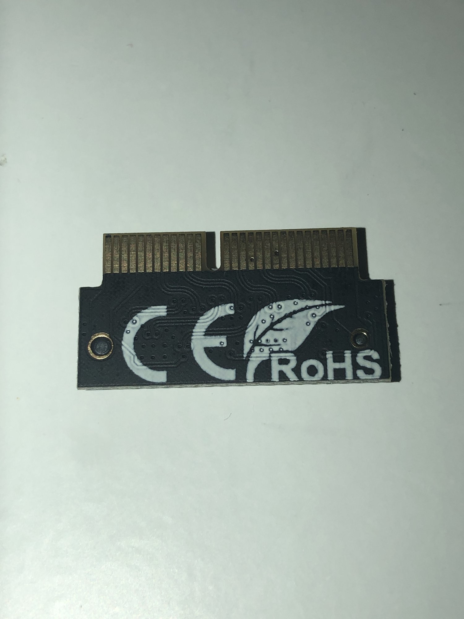

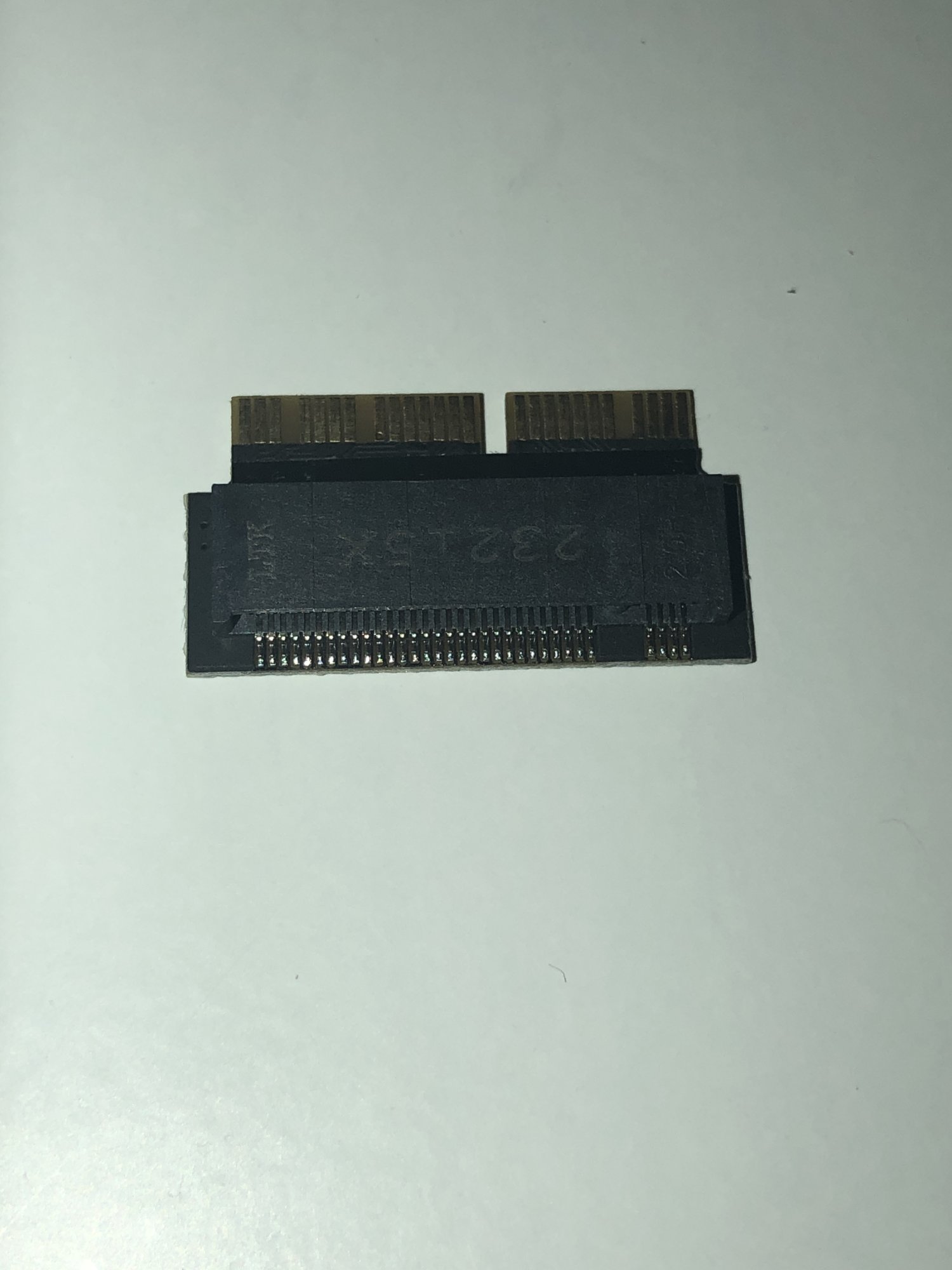

Thanks for the reply.
My current OS is Big Sur 11.7.10
I have included a photo of the adapter. Here is the link to the one I purchased as well:
https://www.amazon.com.au/Sintech-Adapter-Upgrade-2013-2015-MacBook/dp/B07FYY3H5F/ref=sr_1_1?crid=1B00255DC2SFL&dib=eyJ2IjoiMSJ9.xxdB99dqvjnI2x7FwHGIq92m0qAuwM5WFmmSHBZ-dxnl0JH7I0BTRC7tXEr2A16mVSqHPaDTidPADQWQBLLrpBUsOwTMlFhIZCynbgElv4L4QcfUSzkkJkXkrEE6A4lPwELY6GbWNZi5CKsWIEjrKGynmdT8D-26XSfxbgN2a5A5TMpBnmGBqYRSQbleNAswqz9SWomPJP_kdLVVQI1dBwKj2-PE8m24pd9UMkmf2_noX6tyUQ70ajY6kxcMVHvWkkK1wrptjaHotwxfUQaUyd3AjnK5XlOi31eaQ-Tpx6Y.Nfl2_Cn4b_PUfdue8wewcD2lsUOfDk3giylI5rkazgY&dib_tag=se&keywords=sintech+adapter&qid=1721997954&sprefix=sintech+a,aps,305&sr=8-1
I actually have an old Dell Latitude 3490 laptop that supports nvme drives so I installed the SK Hynix into it and it was recognised in the bios. So at least the drive works.
The adapter is the Sintech short one so unsure why it is not being recognised.
I will read through this thread again to see if others have had issues with the Sk hynix p31 with the short sintech adapter.
Edit. I also made sure the drive was seated properly. It made a click sound when it went all the way in with the adapter.
View attachment 2400053View attachment 2400054
In addition to checking for firmware updates, there was a known issue with some older Hynix drives where the firmware did need updating in order to work with MacOS (the Dell should be able to use those tools to do so..)..
Adapter fit sounds OK, once you’ve cleared the SSD firmware I’d see what else is left over..
I suggest you run SilentKnight from SilentKnight 2.9 (Universal App for Catalina to Sequoia) to see if you have to install any update prior to use the NVMe drive.
Hey guys. Good news I managed to get the drive to work somehow.
I did plug it in the Dell laptop and tried to do the firmware update but it seems like the software version was the latest. I couldn't tell if it wasn't but looking online I think it had the latest one.
I then made a bootable usb with Mac OS Big sur on it and pressed option on startup and followed the setup. It found the nvme drive in disk utility. I then completed the install of the OS.
Previously i was pressing option on startup with the Sk Hynix installed inside the Macbook but not using any bootable usb. I thought i could get into disk utility and setup the drive then shut down and stick the usb in and set it up after. This method didn't work.
So looks like an error on my part.

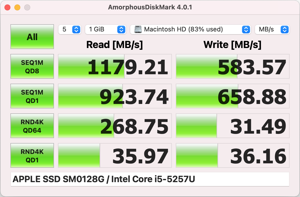

Hey guys.
Here are the before and after disk speed tests for my laptop.
For reference my laptop is the early 2015 13" Macbook Pro. I bought it used like 4 years ago from eBay. 8gb ram and 128gb storage.
Before stats:
APPLE SSD SM0128G : Intel Core i5-5257U.png

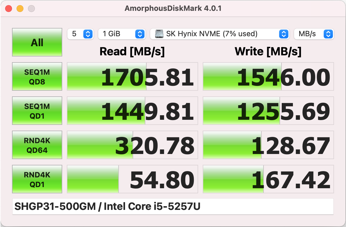

Here are the after stats with the SK Hynix p31 500gb nvme installed:
SHGP31-500GM : Intel Core i5-5257U.png
So overall it was a success. I am happy with the upgrade. I also chose the 500gb model because I rarely download anything on my laptop. I really only wanted a performance boost for the laptop since it was slowing down a bit. That issue seems to have disappeared now after the upgrade.
Also after I opened the laptop I have noticed tonnes of dust so next week I am going to open it back up and do a thorough clean. I recommend others do it when you think about changing the hdd.
Reactions: macpro_mid2014

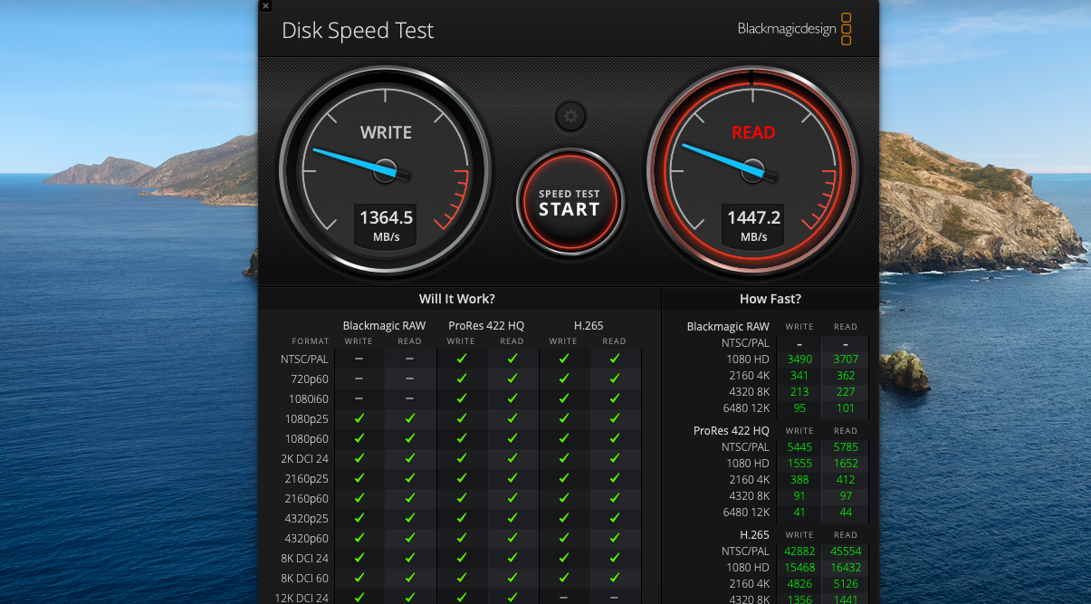

Hey guys.I updated it last year 2013 11" Macbook Air. to a 1TB WD SN570.
My environment:
Macbook Air 2013 (MacbookAir11")
macOS Catalina 10.15.7(firmware 478.0.0.0)
During this period, there was a problem of sleep and system crash, and the probability of it occurring was very high. The sleep and wake-up would result in a black screen, requiring long pressing the power button to forcibly shut down,Although there is a large amount of data to prove that sn570 can be installed smoothly, it does not mean that all 2013 Macbook Air,Perhaps SN580 would be a better choice。
In addition, the Hynix Gold P31 is also a very popular choice, but I don't want to have sleep problems again. In the end, I chose a conservative solution to replace Intel's 7600P (760p OEM), which has the advantages of lower heat generation, lower power consumption(RATED DC 3.3V 1.51A), and similar read and write speeds to the Hynix P31. Although it is difficult to purchase, I still think it is a good solution today.
Finally, please find attached the 7600p SSD running speed test.
Reactions: Flyview
My environment:
Finally, please find attached the 7600p SSD running speed test.View attachment 2401815
So the aforementioned power/sleep issues are fixed or not with the 7600p (OEM)?
From your response it is slightly unclear as to whether those issues are fixed or not (especially considering there are ways to fix the NVME firmware section via patch or whether it is a controller/bus issue..)
Reactions: nordisk
