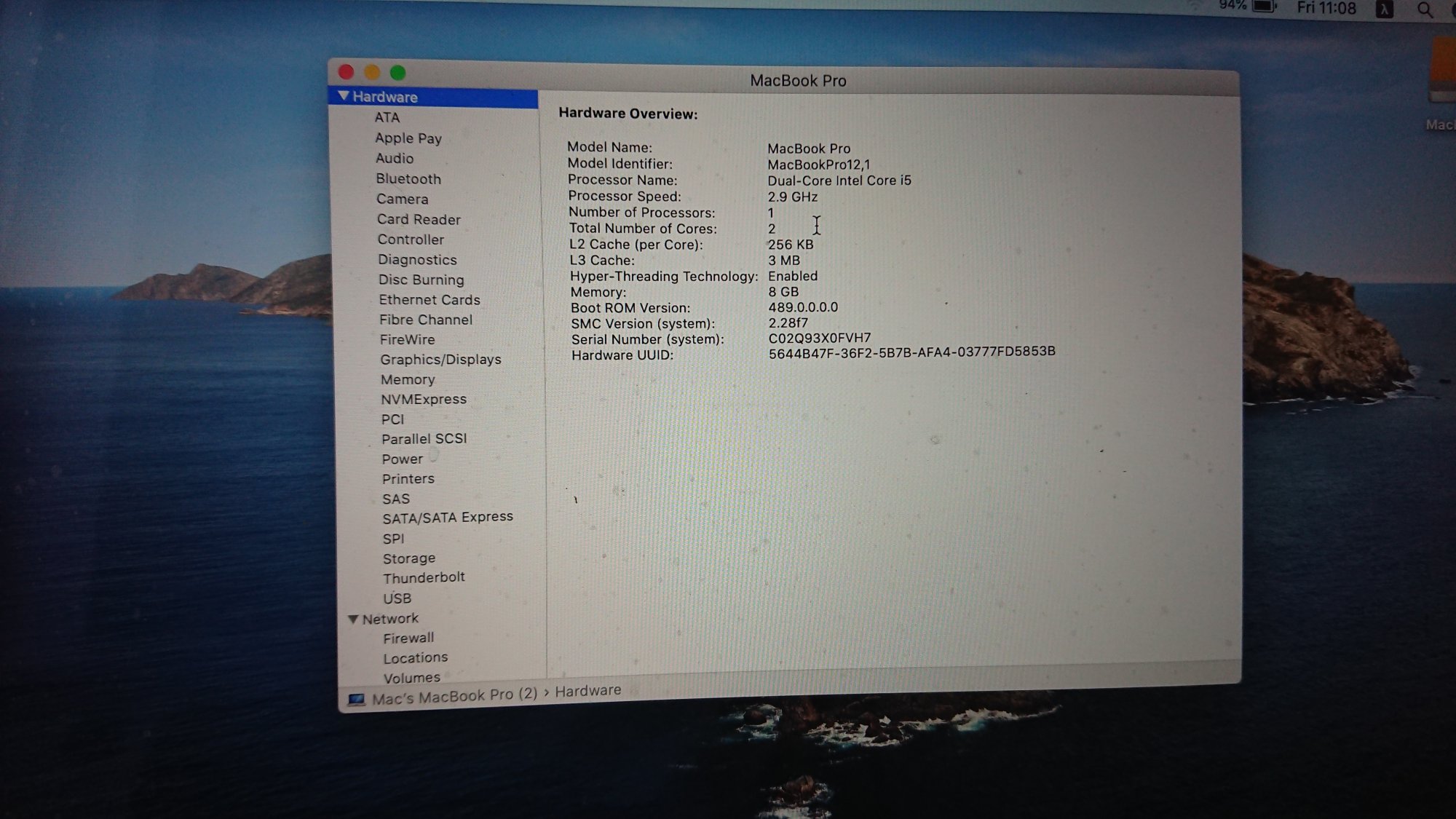

Please, post a System Report screenshot (the part where it shows your firmware version).

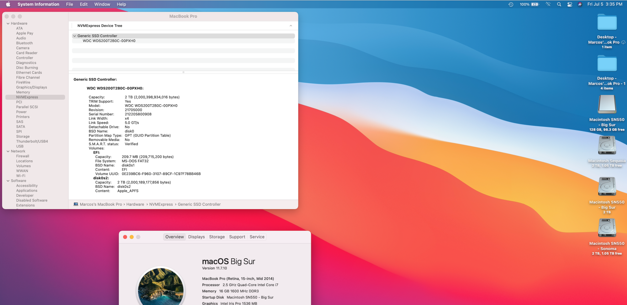

With the adapter+SN580 inserted in the slot inside your MBP, boot the MBP using a USB with Monterey.
Then, go to the System Report page and click NVMExpress.
Attached is the screenshot when I boot my MBP running Big Sur using a USB stick.

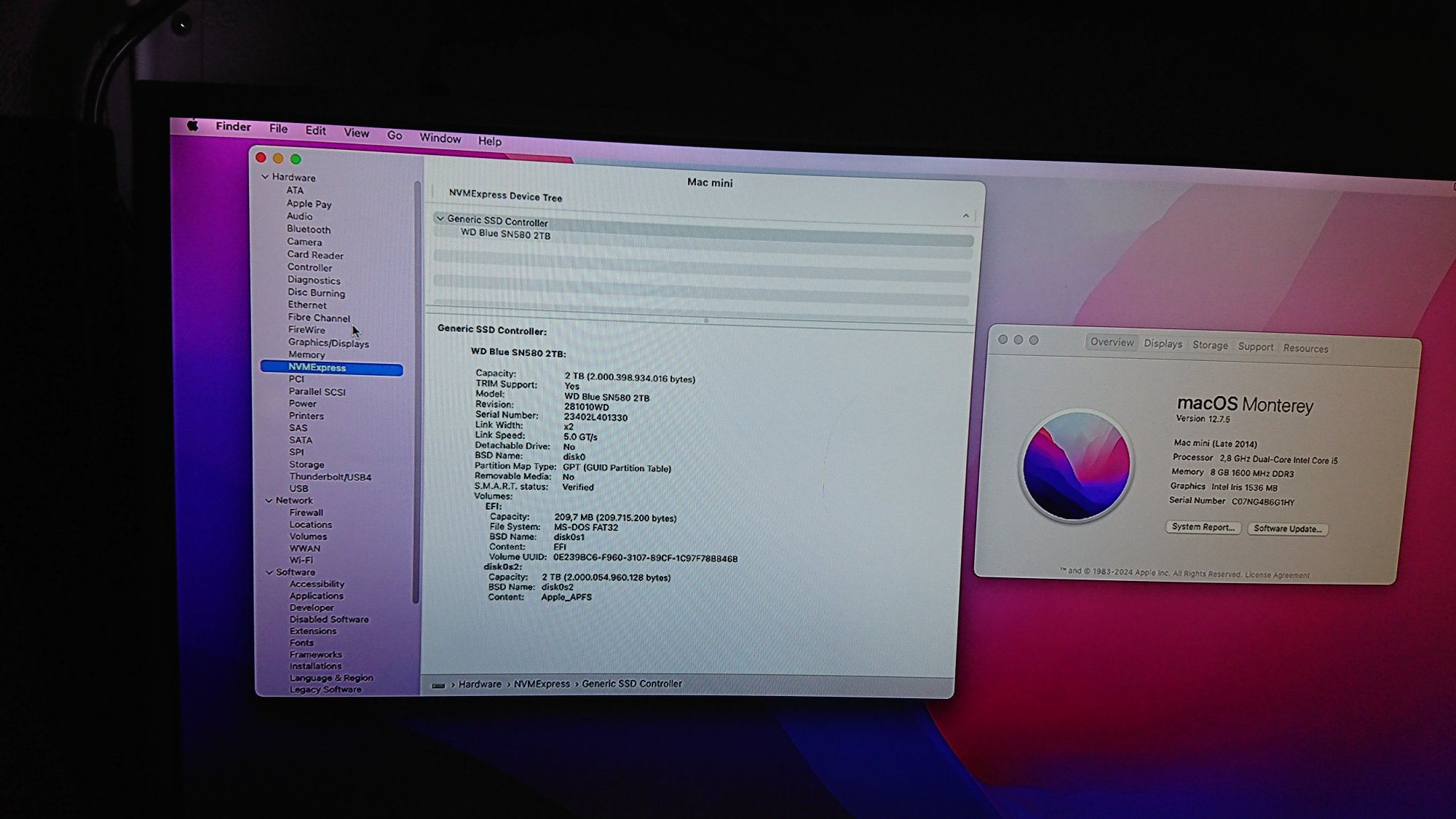

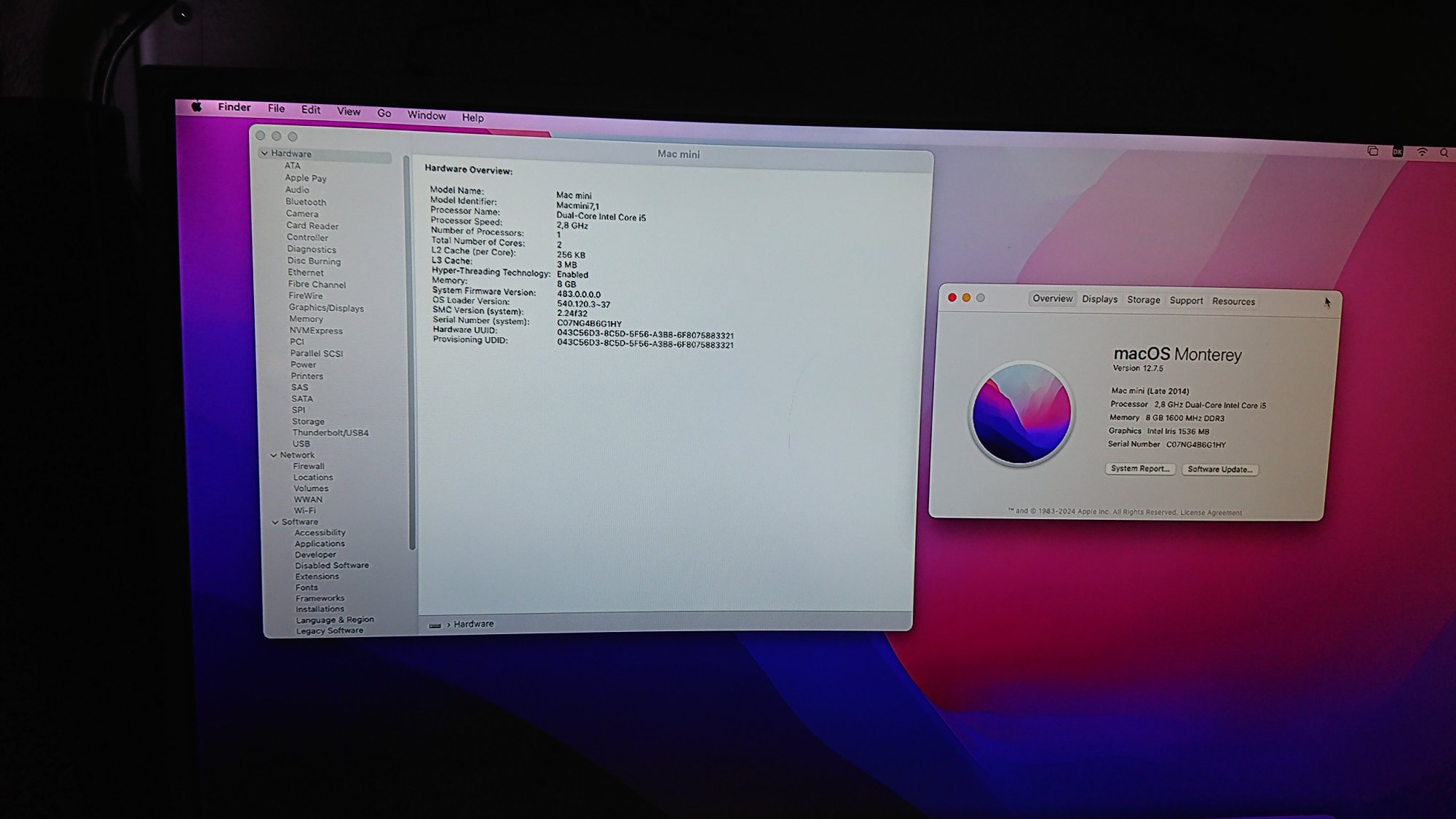

This thing is going to make me crazy!!! This morning i installed the SN580+Sintech short to my MacMini 2014 and worked like a charm. Booted in Monterey instantly like the Apple 256GB. The disk is on Nvme devices as expected. See photos
If I recall correctly, the adapter used in the MacMini is different from the one you use in your MBP. As I suggested above, try a third adapter with your MBP, because the SN580 is working (I am considering that its firmware is updated to the latest version).
Moreover, just a clarification: how did you update the MBP firmware to 489.0.0.0.0? Using the stock Apple SSD or the SN580? If the update happened when you tried to install Monterey using SN580, the update process might have corrupted the firmware somehow (very improbable, but possible).
No the disk is installed with the same adapter. I have found many reports that Monterey is difficult to install in third party NVME ssd so i will try to install Catalina or Mojave to SN580. I will report.

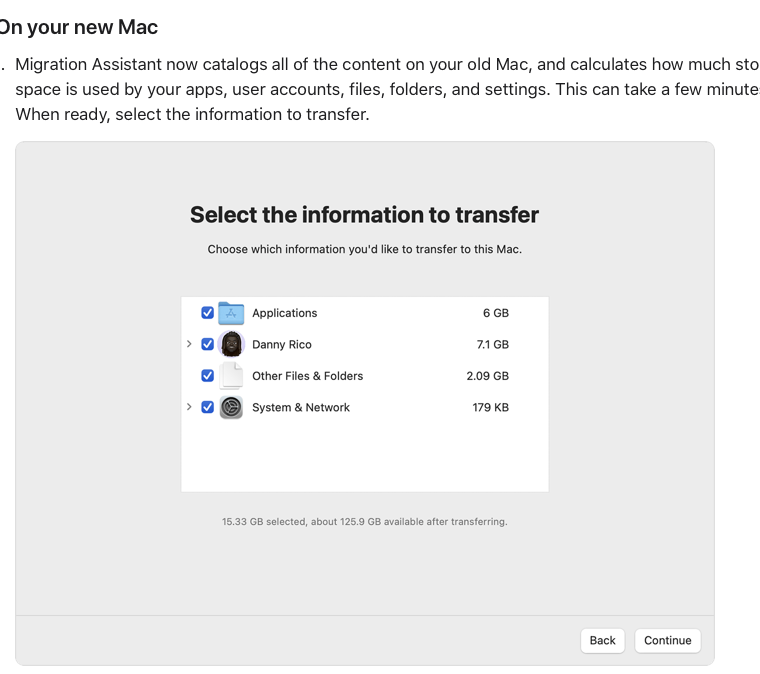

Now my Question is, what is the best and easiest way to transfer my data from 2013rMBP
(SK hynix Gold P31 2TB PCIe NVMe)​
to this M3 without too much hassle. I also have bootcamp on my 2013, but not planning to transfer it and not even sure if it would transfer anyway.
I already deleted too many unwanted files when transferred from original apple ssd to NVMe and my main concern is apps. should I only transfer USER? or shall I transfer files and folders too? and what is the best way to do it? Migrant assistant over WiFi? I don't have a cable yet and planning to do it over weekend hopefully. Thanks in advance.
Yhe best way is to pull the ssd out and buy a m2 sata/nvme blade drive adapter and connect it via usb c do the m3.

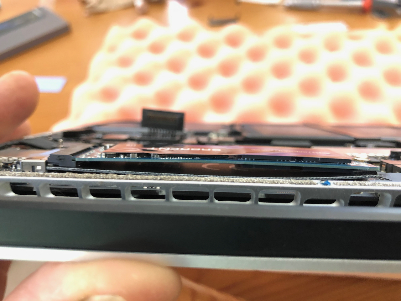

The only issue with the long one is whether it fits well in your laptop without forcing the SSD when you close the bottom pane. That is why short one recommended in most scenarios as there is minimal pressure on the drive, I also got the long one 1st but then purchased and used short one.
While I have had no issues with the long version...
. . . it does seem OOS. On the + side, it definitely makes contact with the case thermal pad ;)
