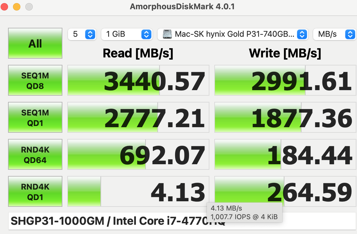

I personally have the SK Hynix P31 Gold (2TB version), several others use this nvme drive as well.

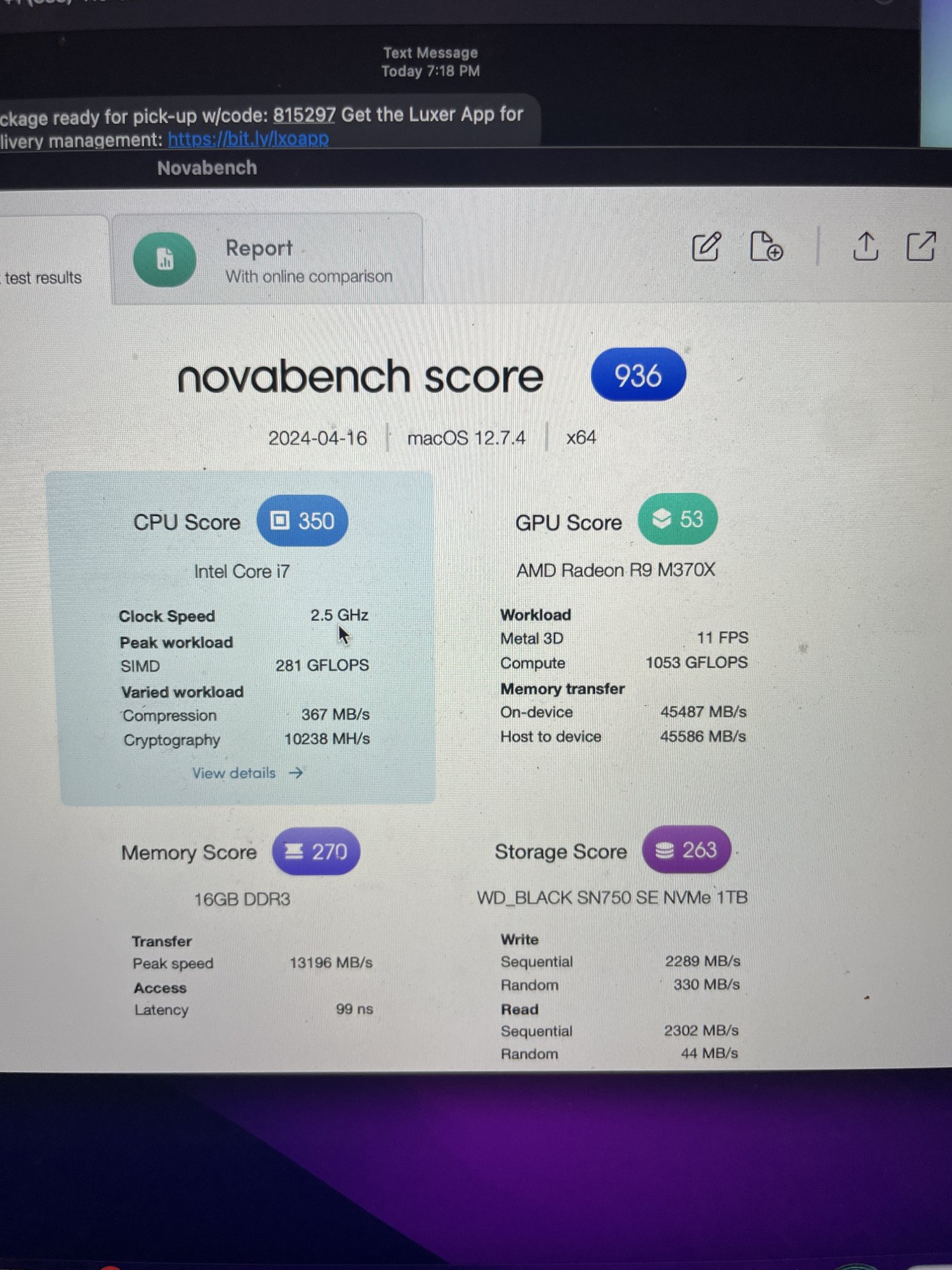

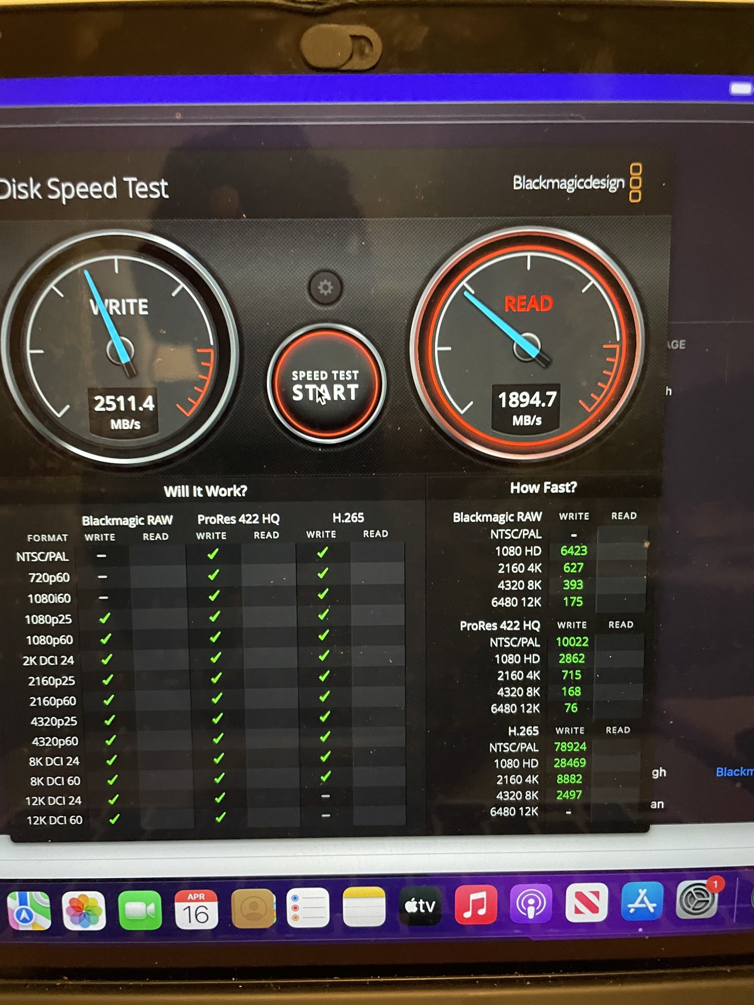

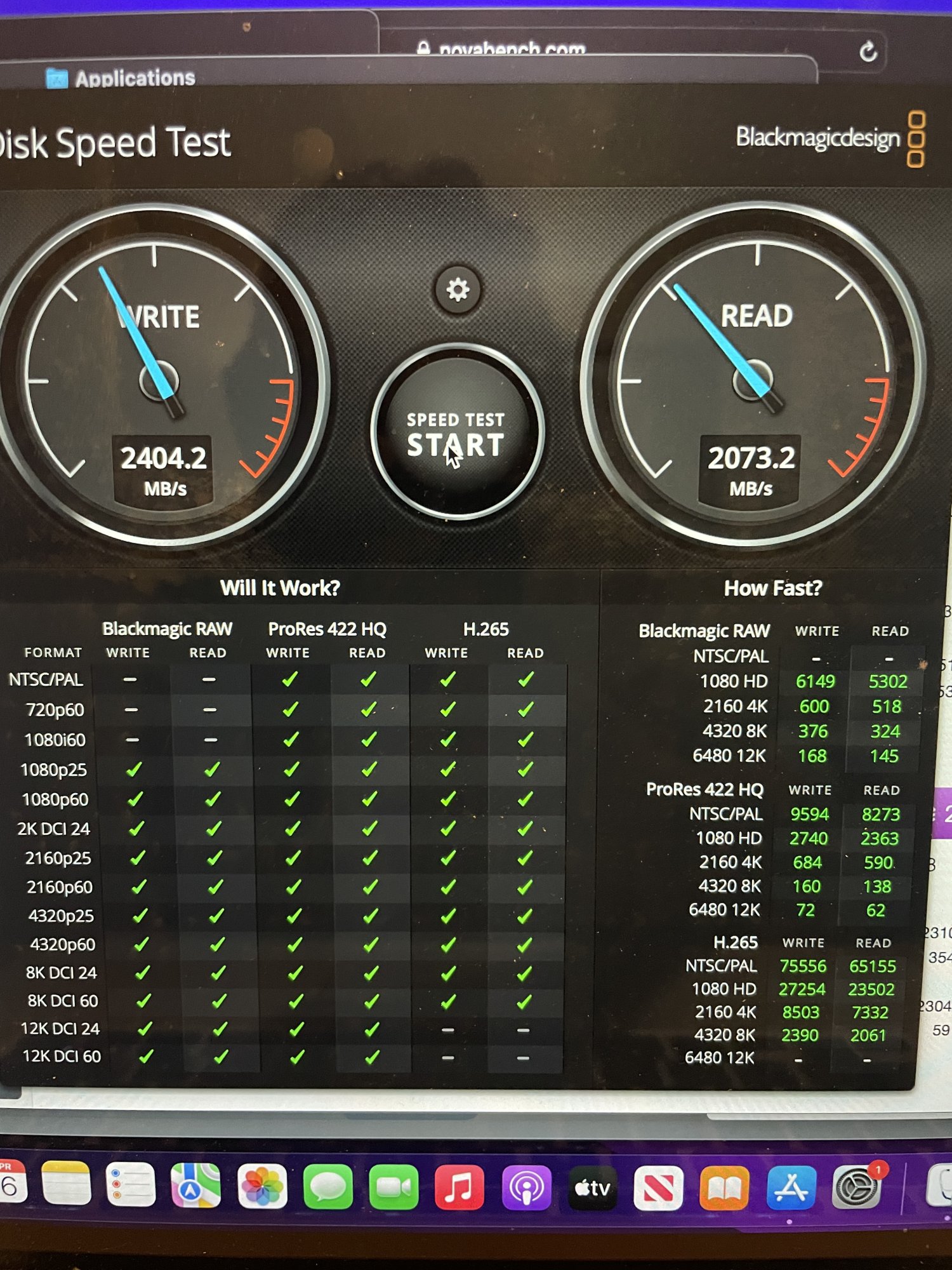

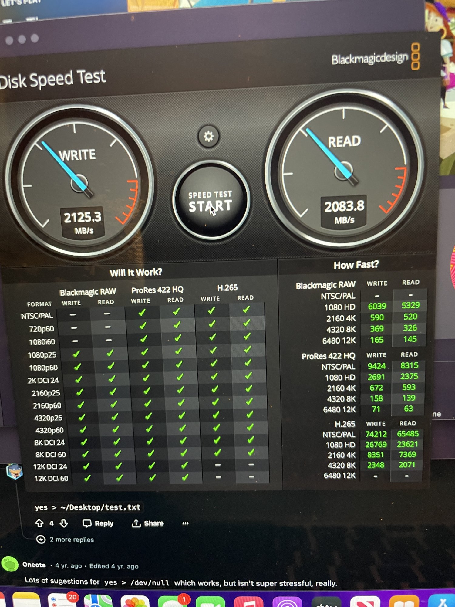

Summary, mid 2015 MBP A1398 15 inch with these stats. Basically my Apple SSD was KAPUT, so I only loaded Monterey straight from Internet recovery onto my SSD's using an enclosure after formatting them. No need to have load the OS onto the firmware before changing the SSD internally, in fact I even removed the internal SSD when doing the OS loading so, as long as you have the same computer I do have no fear. Otherwise eh.
Crucial P3 with Long Sintech Adapter
Had the lowest temperature running so far.....will Test P3+ Tomorrow
WD SN750 SE works ONLY with Long Sintech adapter linked above
And the Sabrent I connected with the Short sintech https://www.amazon.ca/dp/B08QF7MFB2?psc=1&ref=ppx_yo2ov_dt_b_product_details, ran the hottest from the loading in the SSD enclosure to internal.
I will be testing the Crucial P3+ and Hynix Gold P31 tomorrow and will settle on a card based on power draw and read write speed. From the look at the moment, it might be the Crucial p3+ but we shall see
