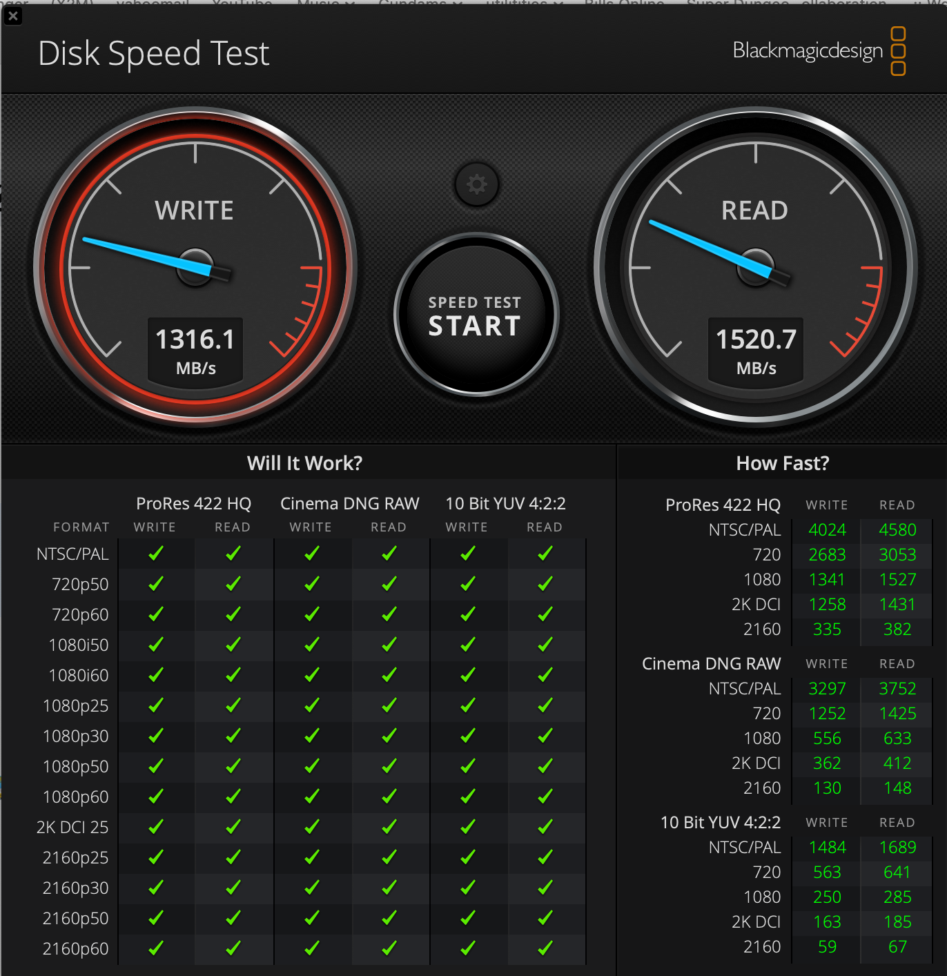

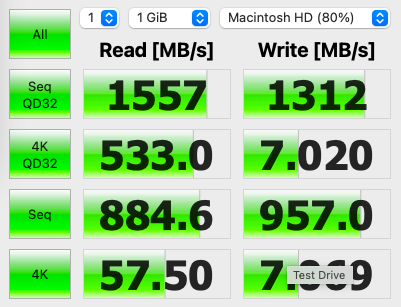

I have received the tiny Sintech adapter and installed the Teamgroup SSD (which actually is the MP33, not the MP44).
I booted off a Monterey USB installer and the installation went without hitch and slightly faster than it normally does on my 11" MBA (2015). I haven't had the chance to test if battery life is affected but sleep seems to work normally. Startup is ever so slightly faster.
I then ran Amorphous Disk Mark to check performance...and it never completed the 4KQD32 test. I waited two hours without change. The same happened when I ran the test on the original SSD which Etrecheck claims is failing.
This makes me wonder if that SSD is actually OK and it is the logic board that's causing the errors. Any thoughts on that?
When I re-ran Amorphous just now it – of course – completed. I first ran the quick 50MiB test and then the 1GiB. This is the result from the latter test:
I have no idea why the program does not recognise the name of the SSD ("macOS" not "Macintosh HD") but how are these numbers, ok or strange?

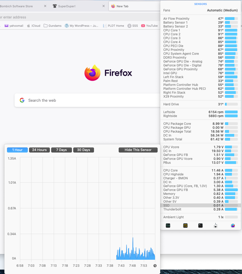

UPDATE I:
Migration took about 4~ hours (from the rated 16 with the NV1, and later on 10 hours for the SX8200). It ran into a boot issue (stuck on start up progress bar), but, after a little bit of googling, solved it with the bless fix from the OCLP guide. It's now installed internally and running smoothly, with slightly better R/W speeds as the A2000, testing some of the regular apps I use.
No hibernation issues, and power consumption goes as low as 0.01A and 0.0A on idle.

I think I may have found the reason for the slow random results at 4K, see this TechPowerUp review.
They note that the Teamgroup MP33 probably has "some kind of small, fixed-sized buffer is used (in the controller) that gets overwhelmed" by random writes (Tom's Hardware wrote that it uses a 150GB write cache).
I suppose such heavy random writes won't be common in ordinary use but it's worth noting the effect. There are better drives out there, methinks. But for a test of the machine this is still OK.

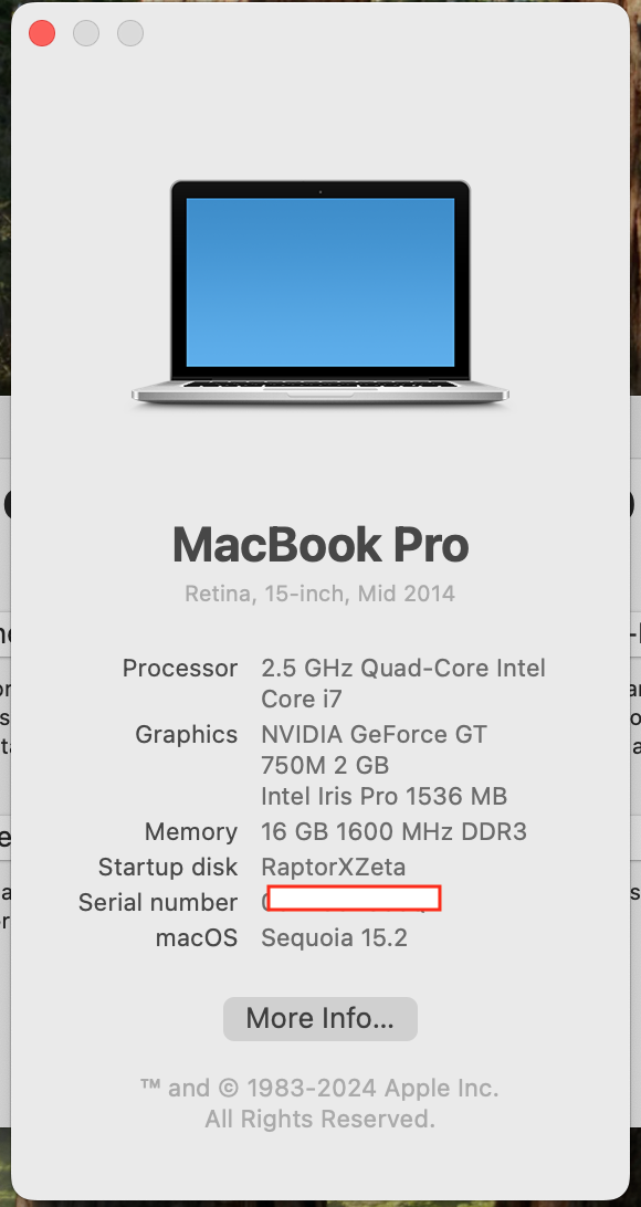

Hi everyone.
I posted here a while back, when I upgraded my MBP15mid2014's stock 512 SSD with a Kingston A2000 running on Big Sur. I tested a 2TB Kingston NV1 mounted in an Orico external enclosure earlier on running on Monterey and it worked just fine, but did not install it since the NV1 is DRAM-less and I was concerned about its overall speed over time. I didn't need the upgrade back then, so I decided against it.
But recently, I find the need to upgrade from Big Sur more and more urgent. With Adobe CC 2025 apps out, I will have to upgrade to a more recent MacOS version since CC2025 does not support Big Sur.
I started shopping around for a replacement to my aging A2000 (now at 84% lifetime, but based on DriveDX, is still very healthy after 2 years of constant heavy use and abuse), and I was considering getting another A2000, Samsung, WD, Crucial, Teamgroup and even a few others. I wanted to get a 2TB SSD, but I'm currently on a very tight budget, so it's just the 1TB for now. After a few days of consideration, I decided on 1TB ADATA SX8200, which I got cheap at only about $60, way below its original price point of $219.
As usual, I ended up choosing the SX8200 primarily because of the price. It was dirt cheap, a lot cheaper than the A2000 when I got it 2 years ago. Seeing the other choices, R/W was irrelevant, since it won't go beyond 2k speeds anyway, though there's a slight improvement in the speeds. Since I do graphics, having a DRAM was also a very important.
I was still a bit apprehensive if it's going to actually work (even though it was listed to work), but, if it doesn't, I'll just relegate it as backup storage. If I get enough funds, I'll spring for a 2TB KC3000, Kingston Fury Renegade or Crucial P3, but seeing here that Crucial has a few issues, I might opt for either the KC3k or the Renegade, unless I find something better that my MBP can handle.
The current versions of OCLP (2.1.2 - 2.2.0) have become a lot easier to use compared to the earlier versions a couple of years back. I made 2 USB installers, one for Ventura and another for Sequioa. I've tried Ventura earlier last week on one of my External NV1s and it worked. Last night, I was able to install Ventura into the SX82000 quite easily though it took a while since I thought it was cycling on restart. I won't be touching the A2000 afterward, I'll keep it around as a backup.
After realizing I had to start on the <new> installation drive during start up, everything else was okay, though I haven't migrated my data or have installed it internally as I have classes and stuff to do. I'll do that over the weekend, letting it run overnight and while I am out since it requires 16 hours to transfer the entire thing.
I had at least one minor issue: my generic multimode BT mouse won't work (it works fine on Big Sur), until I saw an article somewhere to <pair> the mouse again with the new system.
I'll update this later when I've installed the SSD internally and have migrated my data.
UPDATE I:
I will replace the older stick adapter with a short one later, since the SX8200 is slightly thicker, it's slightly bent when mounted on the adapter.
Update II:
I've purchased another SX8200 and will install Sequioa on it, for testing. I'll keep the A2000 drive system and Data intact, for back up, just in case. It pretty much has been cloned into the current SX8200/Ventura.

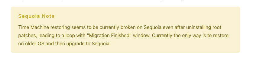

Always undo root patch before migrating data. https://dortania.github.io/OpenCore-Legacy-Patcher/TIMEMACHINE.html
Reactions: dogen
Apparently, this might be the issue. Time Machine restore, and most probably, Migration, is broken in Sequoia. So, what I have been doing, Clean Install > Migration isn't working. I'd have to duplicate my current Ventura drive and update that.
Last time I had to restore, the loop issue happened and migration was not successful.
In addition to the Time Machine approach, I also use Carbon Copy Cloner and backup the whole system every couple of days. The Restore task created by a newly downloaded CCC (didn't even bother to register the copy) was able to restore everything.
In my opinion, it is wise to keep a second backup method of these old machines just in case your default restore approach does not work.
CCC saved me more than once in the past.

Update:
Didn't need the extra cables. I've done the CCC Route, but it took a few tries. Tried to do a Legacy Bootup Copy of my current Ventura drive, but it didn't work (it didn't become a startup drive), still, it was fully cloned into the new drive. Earlier, the drive kept unmounting and renaming to ASR something, so I decided to clone the drive as is, then renamed it later.
I installed Ventura, which was successful, then without applying root patches, proceeded to install Sequioa on the new drive.
I had a couple of hiccups (update failed once), so I just restarted and booted via EFI, then continued the Sequioa 15.2 install (instead of restarting). I suspected it might also be 15.1.1 that might have been the issue, but, didn't want to do another bout with that version, so I recreated the installer with 15.2.
I'm posting this now on Sequioa booted on external. No need for the bless fix anymore.

There are reports of a buggy asr (# man asr) in the latest versions of Sequoia. Maybe that issue was also propagated to older updated versions of macOS too like Ventura.
The appropriate approach I use is to do a simple clone (not the bootable one) of the partition you want to restore; then do a clean install of macOS; then install CCC and create a Restore Task on CCC; run the Restore Task, reboot and you have your original system running.
I installed an Intel 256 GB 6100p series SSD on my 2015 MacBook Pro A1502. Will this computer not work with this SSD. After installing it I tried to install it with alt and alt with CMD r and CMD r but nothing but a black screen. It works when I install the old SSD.
Maybe I'll try that later. Right now, the new SX8200 has been installed internally and is working just fine. I'll get another 2TB drive later on to back everything up.
