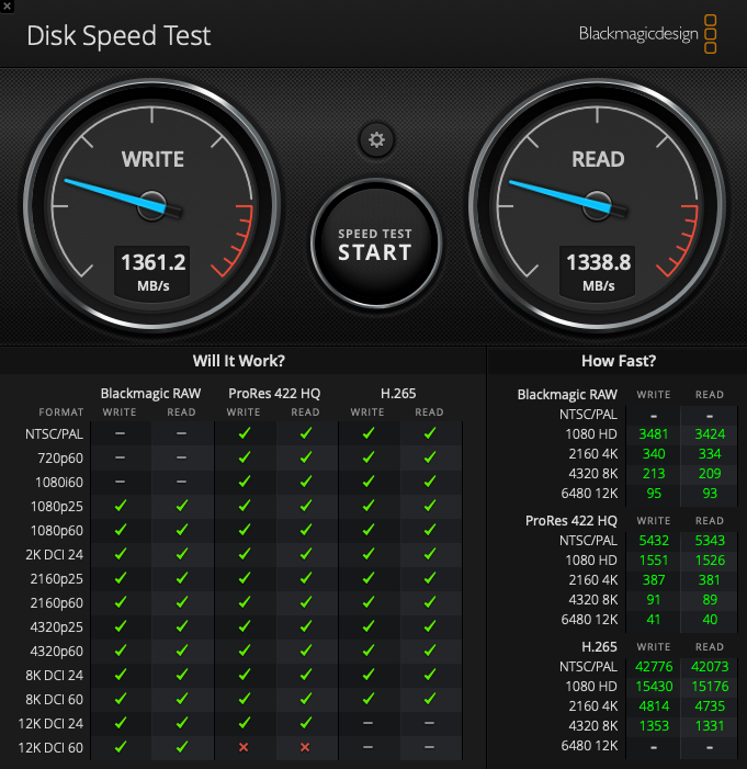

Everything’s working nicely, with a lot more storage now and about 6x speed improvement at writing, almost 2x at reading. Read & write both maxing out at about 2800 MB/s (Before it was write: 470 MB/s and read: 1490 MB/s) All measured with Blackmagic Disk Speed Test.

I really should have tested this before OCLP and even before that with the Apple SSD, but after patching I installed iStat Menus to get the following readings of the SSD amperages ( Amps times 3.3 V for wattage):
Booted up, Idling: 60-80 mA (~ 0.2 W - 0.26 W)
Simulated office use, browsing, moving smaller files: 200-300 mA (0.66 W - 0.99 W)
Heavy use with Blackmagic Disk Speed Test: 500-600 mA (1.65W - 1.98 W) average with peaks up to around 800 mA (2.64 W)
(Temperatures were 35°C at idle and plateau-ed at 45°C when in heavy use by Disk Speed Test after a few minutes.)
Comparing to the charts in the first post, this looks really good. I’m happy with that!

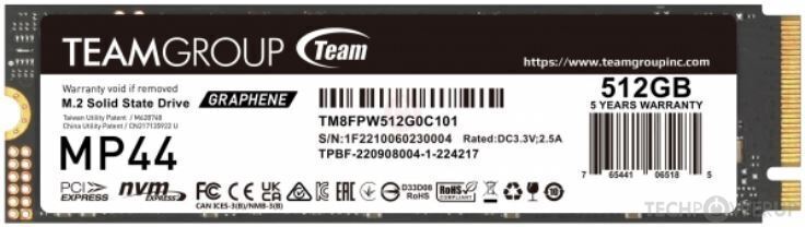

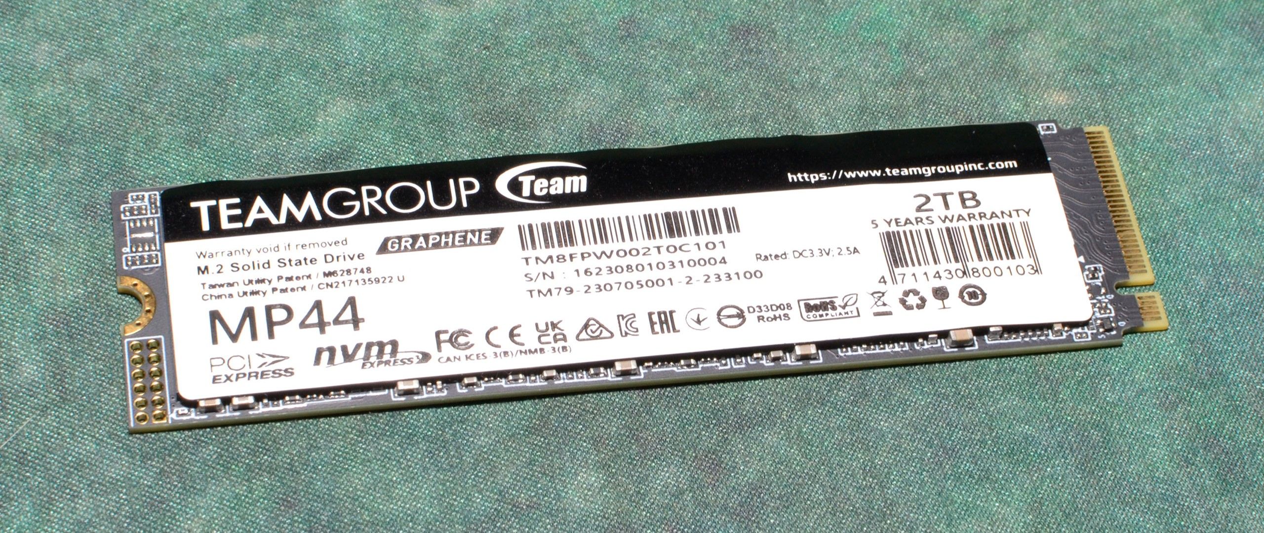

For now I'm waiting for the NVME adapter and I'll try that out with a Teamgroup MP44 I have lying around. Then I'll get the P41.

If that is the case it appears the MP44 should be more than sufficient for your usage case, you may not need to buy the P41 unnecessarily..

That drive is very similar to the Lexar NM790. Fast and relatively cool, with Chinese NAND and Chinese controller, but no DRAM.
Yes it might actually. I'll see how it goes when the adapter arrives. I actually had no idea about that stick but only wanted to try a cheap one for an enclosure.
