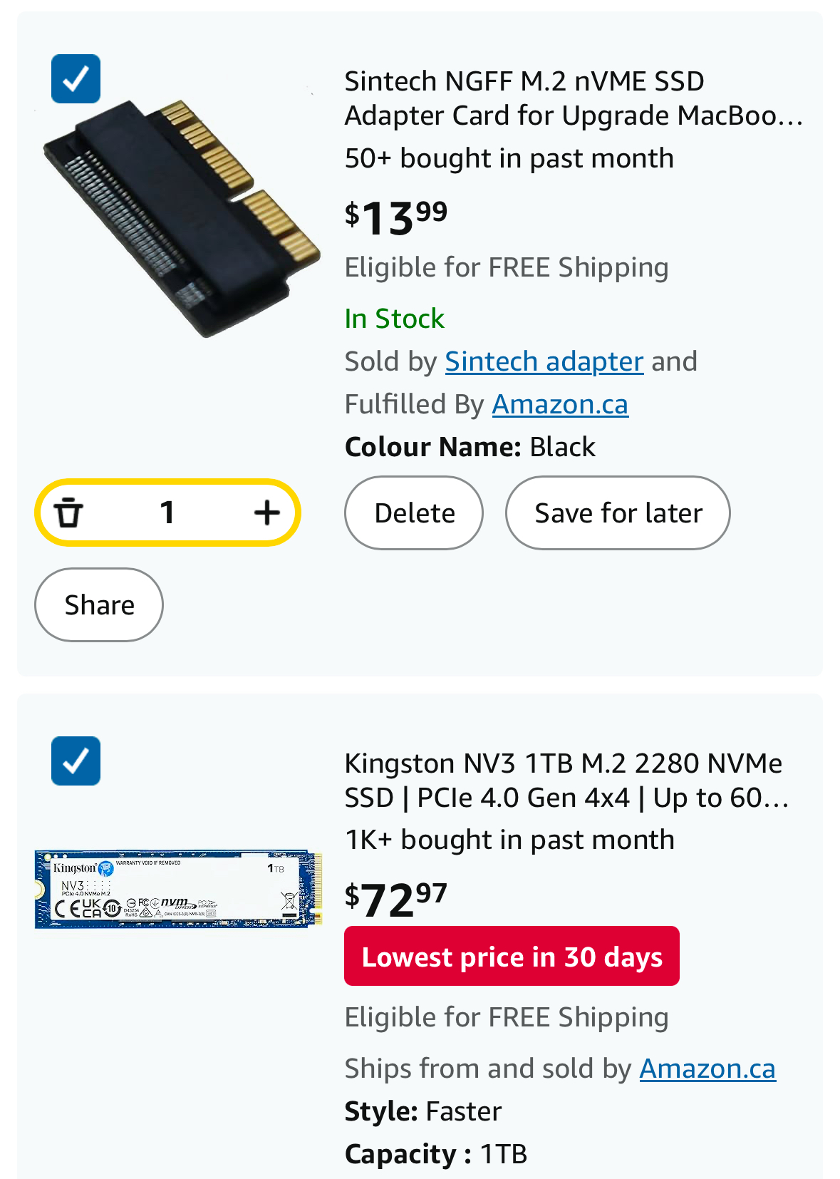

Hey folks. Just a quick check in. I’ve read the threads I could find on MBA SSD blade upgrades, I just want a second opinion on whether these parts will work. I believe the Sintech adapter is the best regarded. Will a Kingston drive as shown work with the unit? Boot Camp is not a priority.
Also do these drives physically fit to the mounting screw on the MBA logic board or does it need double sided tape or some other trick to stay in place?
Thanks. Screenshot of my parts order from Amazon, not processed yet.
I believe the drive you've listed is quite a bit overkill as the machine will only do PCIe 2.0... Has that specific model been listed in the upgrade thread as working? I haven't looked in so long..(https://forums.macrumors.com/threads/upgrading-2013-2015-macbook-pro-ssd-to-m-2-nvme.2034976/)
But the adapter looks right..update: I just saw your sig.. I assume you mean for the 2017 MBA? I've got the 2015 at PCIe 2.0. Not sure what the 2017 has.
Good point about overkill, just checked EveryMac, the 2017 supports PCIe 3.0. My understanding is newer PCIe drives just run at lower speeds in older setups, which is fine cause it’s still gonna be a big speed boost from the 300Mb/s I clocked the Apple drive at. It’s actually more expensive to find an older 2.0/3.0 drive than it seems to be to get a 4.0.
I don’t see that specific Kingston module on the support list so I’ll keep looking, just wondered if anyone had done it. I can grab a Samsung 990 1TB, it’s more money but I know it’ll work according to the list.

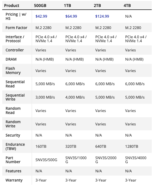

I had a Kingston A2000 as an initial upgrade from the original SSD and installed Big Sur on it without any issues. I had it in BS for a while, I didn't upgrade to Monterey since the OS was really buggy, and OCLP was not as robust back then as it is now. I upgraded to Ventura with an Adata SX8200 just a couple of weeks ago. Then I got another SX8200 for Sequoia so I have a fall back. Ventura is working quite well on the SX8200 and it's always been practical for me to install on an external before switching the drives out.
I would have opted for another couple of A2000s, but it's alreadt phased out and can't really source it out anymore. My other option was the KC3000, but it's almost twice the price of an SX8200 where I am at.
The 1TB SX8200 is rather cheap now where I am at (around $69, down from $219 on first release), and since my MBP is PCI 2.0, any drive with higher than 2K transfer rate is already a waste.
BTW, One of the reasons why I didn't choose the NV3 it's because it's DRAMless and has inconsistent controllers and flash memories. DRAM, for me, is important since I use my MBP for heavy graphics.
Tom's Hardware NV3 Review
