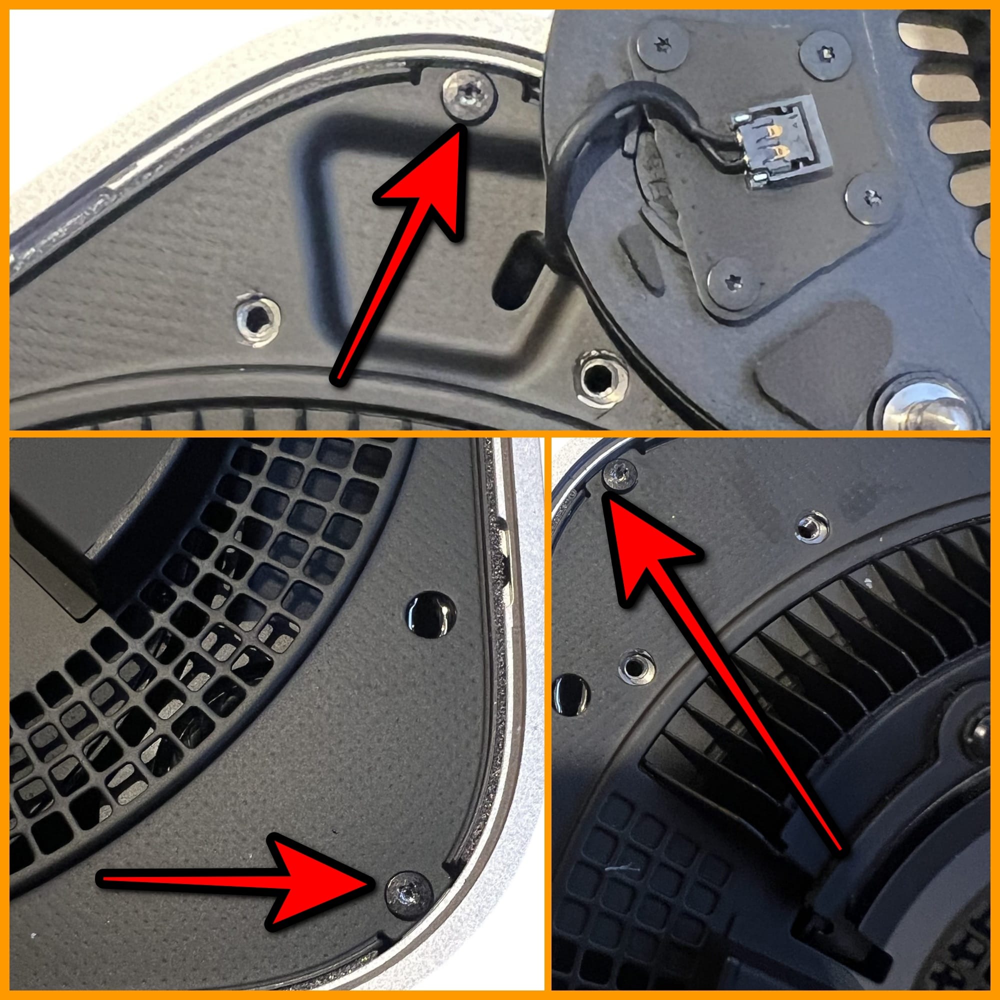

I was disassembling my Mac Mini M4 and got to removing the eight T5 screws. The first five came out without a problem, but the last three are completely stuck—they won’t budge. I tried not to strip them too much... but probably failed.

I walked away for an hour or so. Came back—still nothing. I can get the tool to lock in and try with all my might, but it won't budge. Sigh. Why is everything a whole thing?
Any ideas?
I had one screw that was super tight. I used a screw driver with a bit set. The bit got totally damaged. Luckily not the screw. I had another bit, then tried again with all my force, and finally it loosened. They have this lacquer on the thread; some may have more, others less, that makes it difficult to open.
My advise would be to use a hardened bit, and press down on the screw as hard as possible to avoid slip; then turn. Avoid damaging the screw, otherwise you may have to drill it out.

Somewhere in all of the YT videos I've seen, it was mentioned that some of the bits are actually of slightly different size.
Not so different that the supplied tools wouldn't work, but perhaps in this case the bits were tightened more than usual; causing the tool to slip and strip the bit.
Not accusing the poster of doing anything wrong, of course, just that we need to be cautious on these particular bits.
It seems like the problem is that the screws in the mac mini M4 are not Torx, but Torx plus. These are slightly different and although you can use a normal Torx bit to unscrew a Tox plus screw, the fit is not perfect and can slip, and you risk to damage the screw.
I recall the screws being attached tightly, but not overly so. One can't help but notice the precision engineering of every piece of hardware in that Mac Mini assembly. It was nice to marvel at while I was in there. I think each screw was torqued exactly the same. Given that, I don't think the issue lies in Apple's screws.
I think it's far more likely the fault in ShaunParty's effort lies in the tip of the 'free' screw drivers that came with the drive kit. Maybe they added the wrong size, or more likely, the quality of the free screw driver is what you'd expect.

I appreciate all the advice—it’s been really helpful! That said, I want to clarify a few things:
  1. I removed most of the screws quite easily!
  2. I’m not even at the rubber band phase yet! My tool still gets traction on at least one of the remaining screws, but it just won’t budge. It feels like it’s glued in place. And yes, I’m applying a lot of pressure—so much that I feel like if I press any harder, my table might collapse (only half-joking here).

Thank you for mentioning the Torx Plus thing
Just ordered an appropriate bit set to cover this situation for later this week when I give it a go

The reason why is because they are not T5 screws they are 5IP. If you follow the guide, it tells you exactly what tools you need down to the torch spec. https://support.apple.com/en-us/121140
“Use the 10–34 Ncm adjustable torque driver and 5IP bit to remove the eight 5IP screws (923-11047) from the antenna plate.”
Using a T5 bit on a 5IP screw can damage the screw because the T5 doesn’t have the hole needed to fit over the 5IP’s center pin. This prevents the bit from sitting properly, leading to slipping and stripping the screw’s head. It can also bend or break the center pin, ruining the screw’s tamper-resistant feature. Always use the correct 5IP bit to avoid these issues and ensure a proper fit.

It was an oidd experience. I'm not sure why just three screws would not work. Anywway, a friend helped me with a dremel. We got the screws out.
