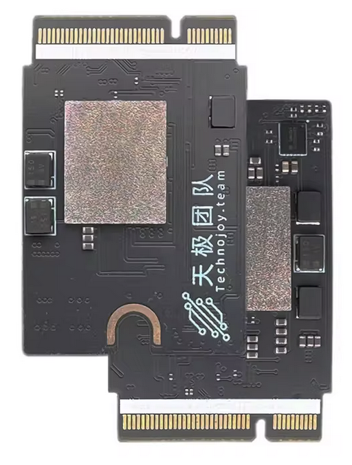

It was shown here several time, but it still seems some are unclear what the modular SSD in the M4 mini is:
It's a small PCB with NAND (=non-volatile memory) chips. It plugs into a socket on the motherboard. So it is the same as what has been done in the past over decades in iMacs, macbooks, PCs, etc.
Just because Apple solders the chips in (other) Apple Silicon computers directly onto the motherboard doesn't make them any better or different. So finally Apple heard the voice of customers and started making user-crucial parts modular again.
This is a first, tiny step for Apple towards sustainability, after having taken so many steps backwards.

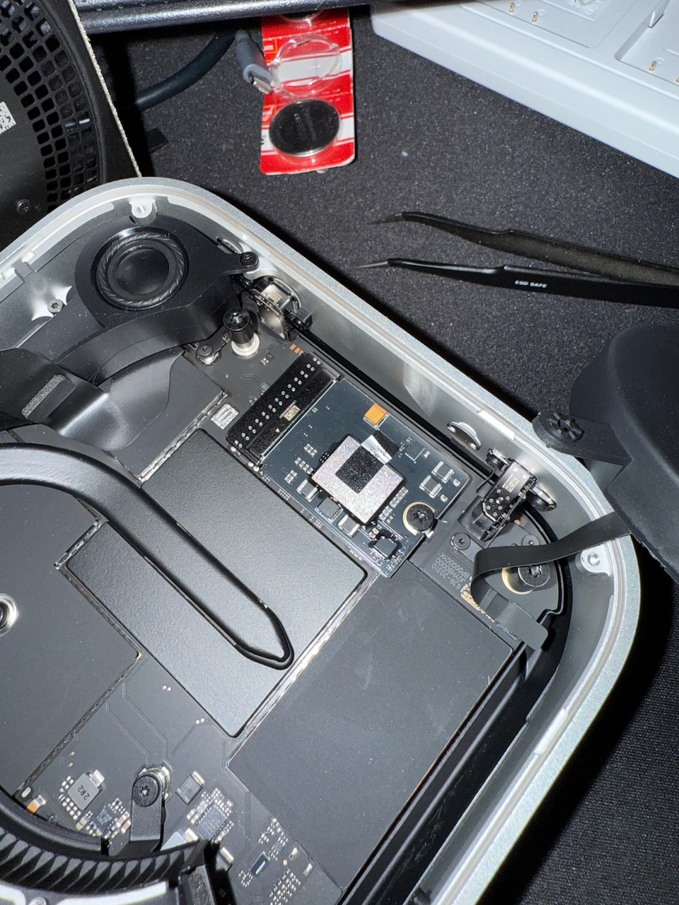

Has anyone tried to replace their upgraded SSD card with the original SSD card to verify it still works?
Reactions: QuickDraw
Why would anyone want to do this in the first place? If you can replace a 256G with a 2T, you can certainly replace a 2T with a 256G. You can also buy a replacement 2T if your 2TB is defect.
This thread talks about Apple offering replacement SSDs for self-upgrade/repair in the Apple self-repair shop.
This user (top comment) confirms you can buy a 2TB SSD even if your original configuration does not contain this part. So this is the same as buying 3rd party.
Edit: Apple's "Repair manual" steps to replace SSD: https://support.apple.com/en-us/121003

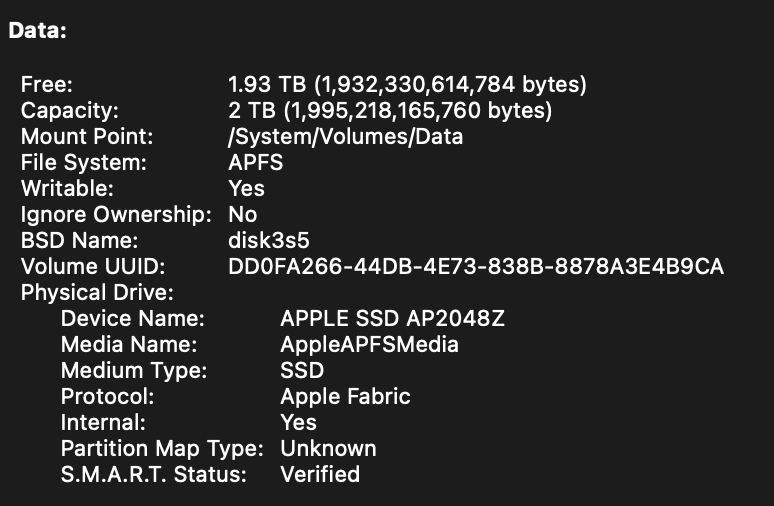

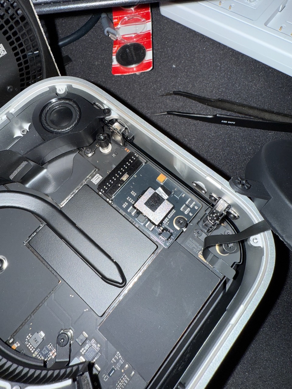

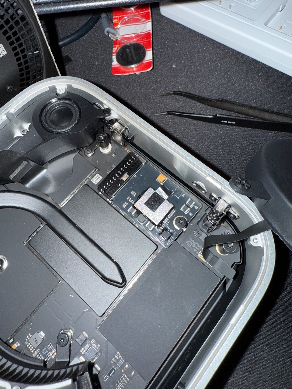

2TB drive installed!

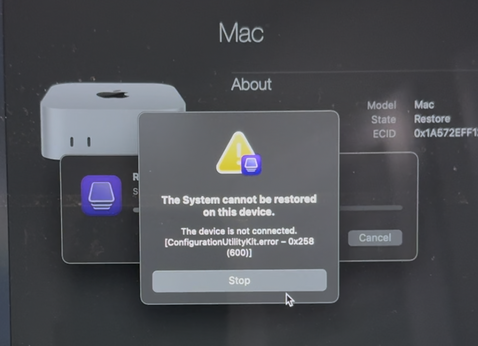

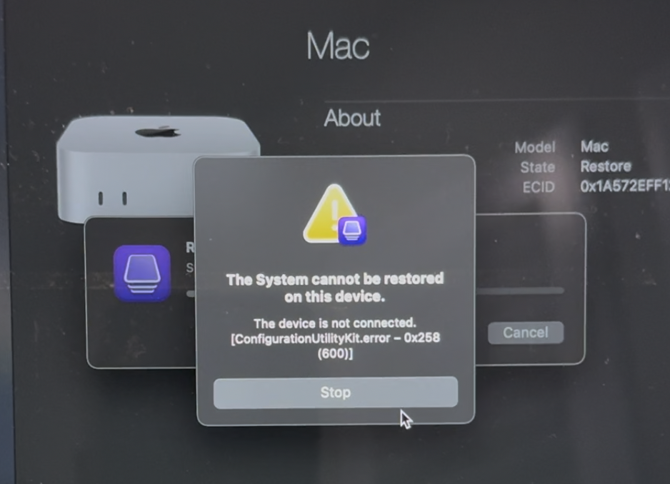

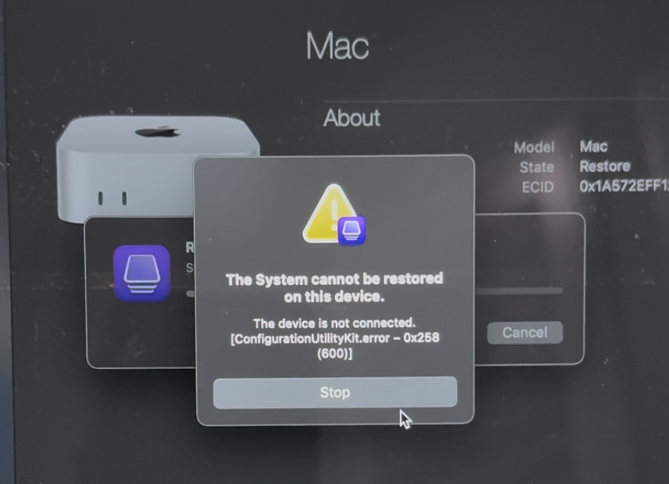

Well, we've hit trouble in paradise. Worked well for a bit after install and DFU, but when I was transferring files from my external drive the Mini just went blank and white light started flashing in front. Tried another DFU restore and this is what I got...
Aliexpress contacted and they've provided me a free return label for a refund. I guess I'll try again, maybe just got a bum drive. The original 256gb SSD got my mini working again, but had to do another DFU so I had to reinstall macOS. You can't just swap in the original drive and expect it to boot...
Well, we've hit trouble in paradise. Worked well for a bit after install and DFU, but when I was transferring files from my external drive the Mini just went blank and white light started flashing in front. Tried another DFU restore and this is what I got...View attachment 2483799
Just a bum drive I'd bet
My 2TB from Ali has been flawless for weeks now
Sorry to hear. How long did it run for before having problems?
