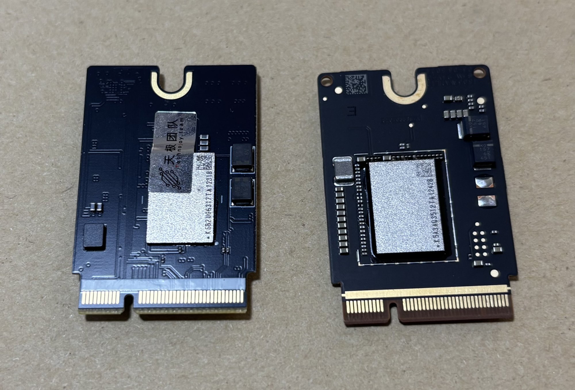

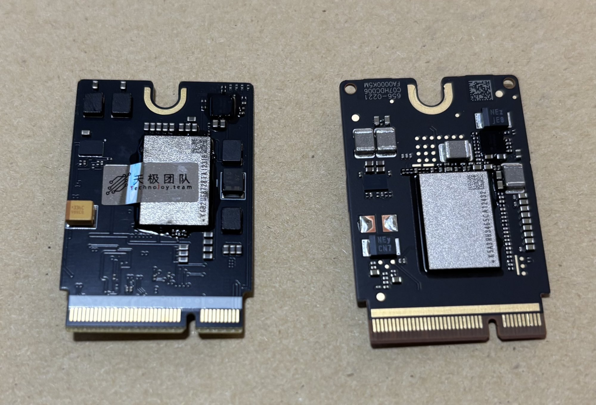

I just had the 16/256GB base model, comparison pics between the Apple stock and the 2TB replacement below.
Have looped a few benchmarks as a kind of stress test as well as copying a couple hundred GB of files to and from, couple DFU restores, zero issues so far.
Today I copied 1.5 TB to and from the system without issue, needed to consolidate some external drives and decided to use the situation as another kind of test by copying everything to the Mac first and then onto a single external drive and backup NAS, double checked the files after and they are not corrupt etc.

A bit surprised how different the boards look from each other. I thought the Aliexpress boards would be more or less clones of the Apple original.
Apple's own version has more layers. The copy is down to 4 layers I believe and thus are cheaper to produce.

The Apple vanilla board has been x-ray'ed to show it has 10 layers of traces. On a technical viewpoint it shouldn't be too difficult to copy, in fact months ago the 4-layer makers already claimed they were working on it. The problem is probably more economical than else, since the 4 layer board already does the job, so why bother.
