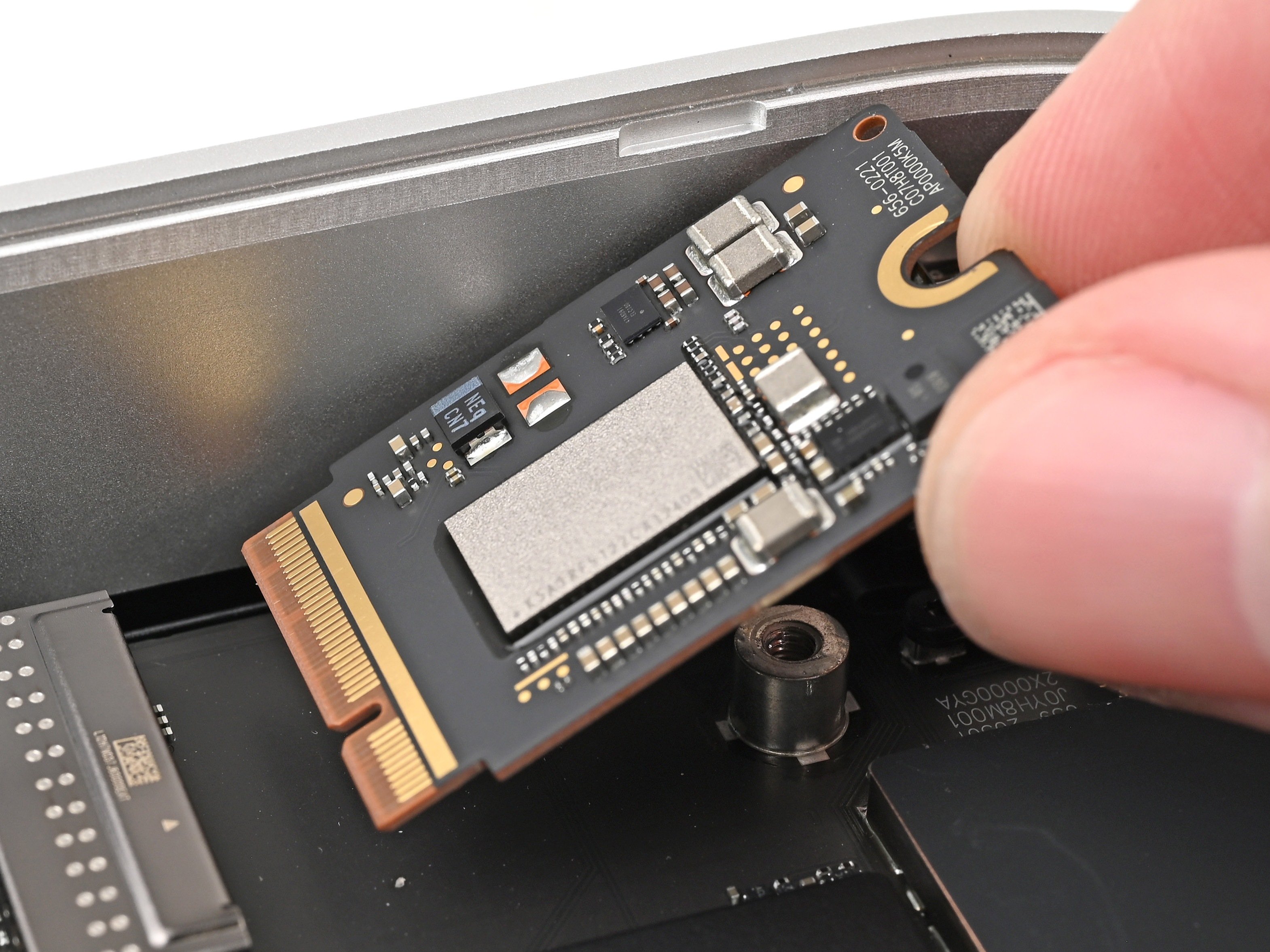

Many hard drive upgrade chips come from China. My M4 Mini was replaced with a Toshiba 2TB chip at a third-party Apple repair shop in Beijing. After two weeks of stable use, it crashed and the computer could not start. Because it was under warranty, I went to the repair shop to replace the chips with new ones, but my data could not be retrieved. After the replacement, I wrote about 300GB of data to the hard drive, and it crashed again. I don’t know if it’s a chip problem. The repairman said that there was a problem with the power supply of my computer hard drive chip. I plan to go to the repair shop again on Saturday to let the repairman check it.
Replacing third-party chips is risky, please consider carefully

Just to clarify, you had the repair shop keep your SSD modules but have them swap out the chips? (like they usually do with MacBooks that don't have SSD modules) Or did you keep your original modules and install 3rd party ones like we're doing in this thread?

I'd bet since he physically visits the shop, 99% it is a soldering job, not a card-only purchase. Ironically that's meant to be the more stable way to do it since you'd still be using the vanilla Apple card.
It seems to me the NAND supply is under huge pressure now, not only the quality issue above, but the price is rising not dropping. You know with the M4 MBA being out and base is only 256GB like the mini, lots of people bring their new base MBA to these shops to upgrade too. It is said that for a 2TB upgrade it costs 1400 RMB.

Only the chip was replaced, and the original Apple module was used. I went to the repair shop to check it out over the weekend. They checked all the possible problems for me and fixed them. I wrote about 1TB of data on site and found no problems. This matter has come to an end for now.
That's pretty gutsy move to do that instead of just swapping out the modules. At least it's working now for you. Sounds like there's some bad NAND chips going around. These chips might be factory rejects that somehow don't get destroyed and end up on the gray market.
Maybe from the second-hand mobile phone or computer market
These posts about using the bare NAND chips should really be moved out of this thread...
The process the rest of this thread talks about is using a new board and simply removing the factory board with the new one, which is a safer and easier path.
Agree, but is so entertaining to know that some of these chips replacements are performed manually wo precision and consistent machinery.
Only in Shenzhen and some third world countries can one go down to a local store to replace the chips. All western, is about customer DIY-replace the board.
